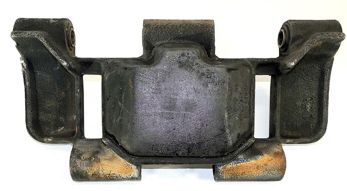

There is nothing wrong with the tracks that comes with the kit. The tracks in the kit are T130 which was first used on M113 and the tracks that Jacques is making are T130E1.
Almost all the M113s you see have T130E1, so an aftermarket for the tracks was predictable.

Addressing the kit T130 tracks:
The T-130 tracks in the kit are fine, but they have two issues I wanted to address:
- They look a little off for T130 tracks. I’m NOT an expert on these tracks, and I do not have immediate access to a M113A1, but I wanted to address this for my own build. The main issue is the track pad in my opinion.
- I was not happy with how the kit tracks build. The sandwhich method (which is understandable and works) means they leave seams that are almost impossible to deal with and are noticeable/should not be there.
I will illustrate these issues once I am home with my parts. This is not a criticism of the kit tracks, more my plan to deal with them in my upcoming builds and I am willing to share with anyone else that has my AMS affliction.
In regards to the T130E1 tracks:
As has been mentioned, a LOT of the photos of the M113 series vehicle show them with the T130E1 tracks. Like, a LOT. The kit tracks are the initial T130 version. The US Army decided to make the track pad simpler and change some of the details on the metal track (not sure of the reasons) to the point it received a new designation and NSN number.
And since I THOUGHT that the T130E1 where just T130 tracks with new pads, I threw them together BUT, it has been pointed out that I need to adjust the actual steel track details for a proper T130E1. Didn’t know that, glad to have people help correct it.
I REALLY want proper T130E1 tracks, so I am going to put in the work to make them correctly. So new prints/pics coming in the next few days.
Great, thx did not know that they were the older tracks…wonder why they went with them instead of the more common tracks.
T130E1 tracks were not introduced until 1974. The vehicle represented in the kit is an earlier version used during the Vietnam war, so the T130 tracks are correct.

I have finished the 1/16 T130E1 tracks (several revisions later) and have them up on ebay. I think they will look great for a POST Vietnam vehicle (the T130E1 track was not used in Vietnam).
I will have the T130 tracks up shortly.
Nicely done with the casting marks on both steel and rubber.
For those of you looking for the T130 tracks, I also made a new set of those. The kit tracks are fine but I wanted something better (I did not like the assembly of the kit tracks and the shape of the pad seemed wrong and undersized). If you like them, you can get them too.
