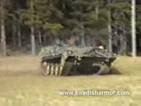

Hi!
You would be surprised to see how fast Strv103 could manoeuvre and change direction at high speed for escaping or aiming. Search for “clutch and brake manoeuvring”
Bad picture quality due to old video technic, but quite impressive. This is why people say the tank turns faster than a turret of a tank can turn. Consider that ALL crew members can drive the vehicle from their positions, one of which is facing backwards. Two crew members (driver and cdr) have gun and aiming controls. After firing, the tank can really fast switch to another target that was observed in sight by the other crew member. Also, swedish tactics of that days rely on fighting from a prepared position, which could be dug out by the tank itself-every Strv103 had a dozer blade fitted. Digging such a firing position did only take a couple of minutes due to the fact that the tank is quite low. In addition, if only in standby in an emplacement, the tank could be lowered down by 12cm, however it lost its aiming capabilities then. It ws the only MBT that was able to swim with approx. 30min of preparation using onboard equipment.
Anyway, the concept had also its cons. For example, an engine change needed the gun barrel removed and took some hours. Fuel consumption was quite high due to a gas turbine.
