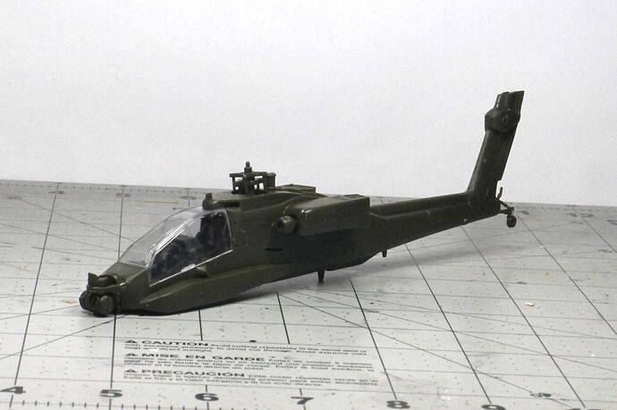

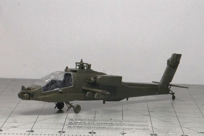

I have more done, nose turret, engines and canopy installed.
I have everything on to mask and paint O.D. except the grab handles.I will put them on then mask and paint.
Looking good. Before you paint it, a bit of advice. OD is not the right color for modern (post mid-'80s) Army helos. The actual color is a darker green known as Helo Drab (FS34031) and is available from various paint makers.
I use no air brush so if FS34031 is not in Tamiyas’ AS or TS paints it is what it is. Thanks.

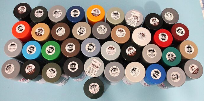

In have lots of TS and AS paint, to me AS-21 is closest to that picture. That’s GREEN no brown to me in that picture! Wasn’t there once a color “Marine Green” ? LOL!
My current Tamiya “collection” of AS and TS colors.

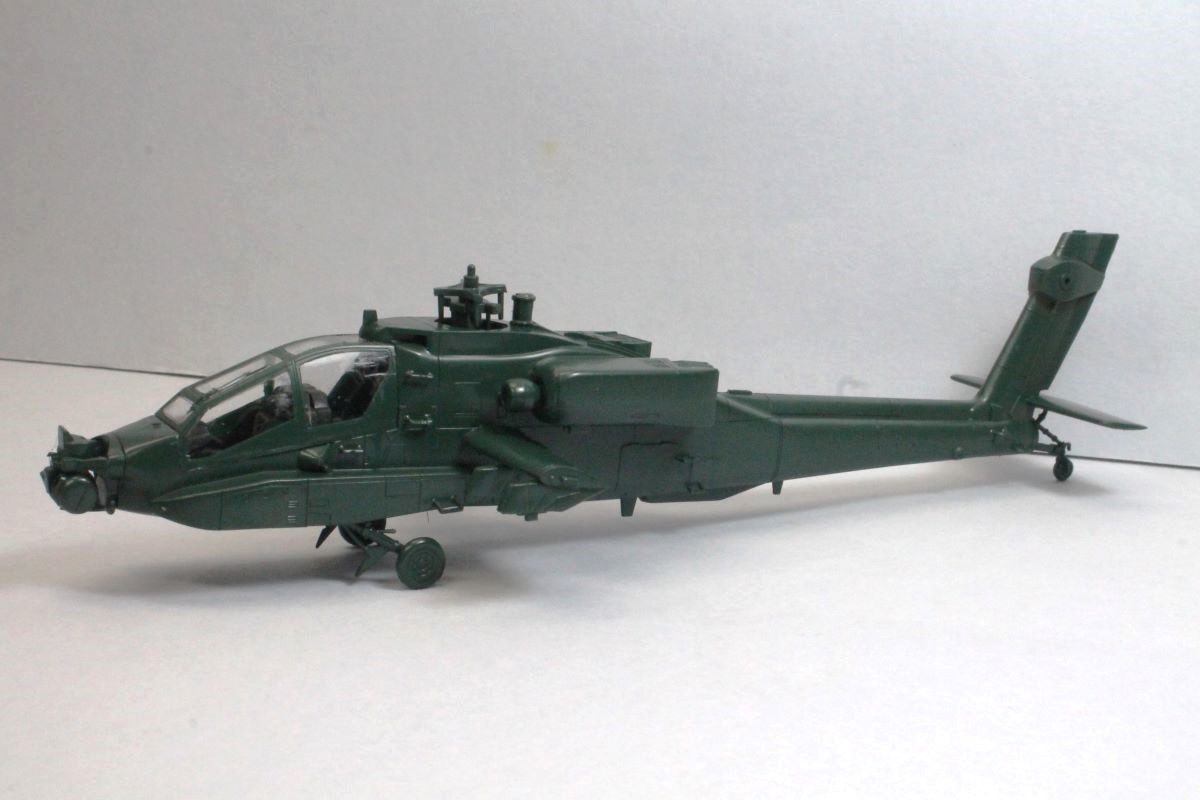

Looks good. What Tamiya color did you end up going with.
Tamiya rattle can lacquer, AS-21, IJN dark green 2. To me it sorta looks almost Euro green or close to dark dull green, kinda sorta.

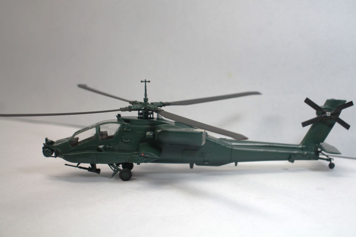

Build done, waiting for decals to arrive.
