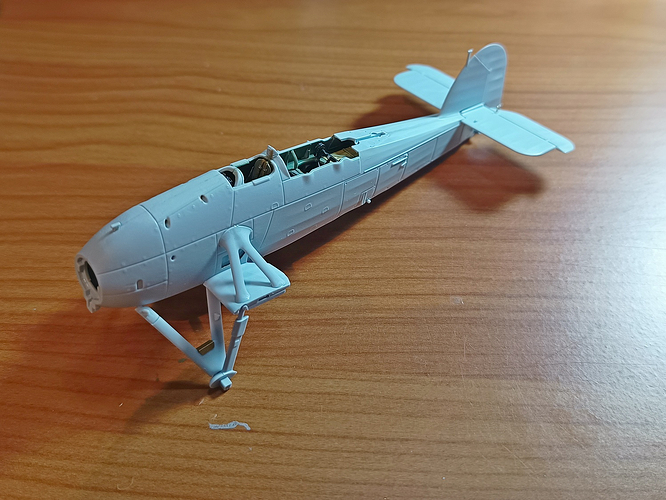

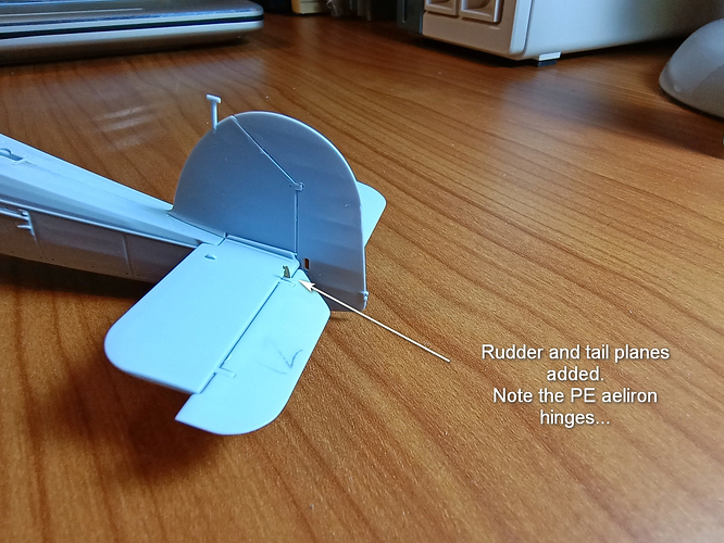

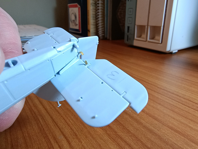

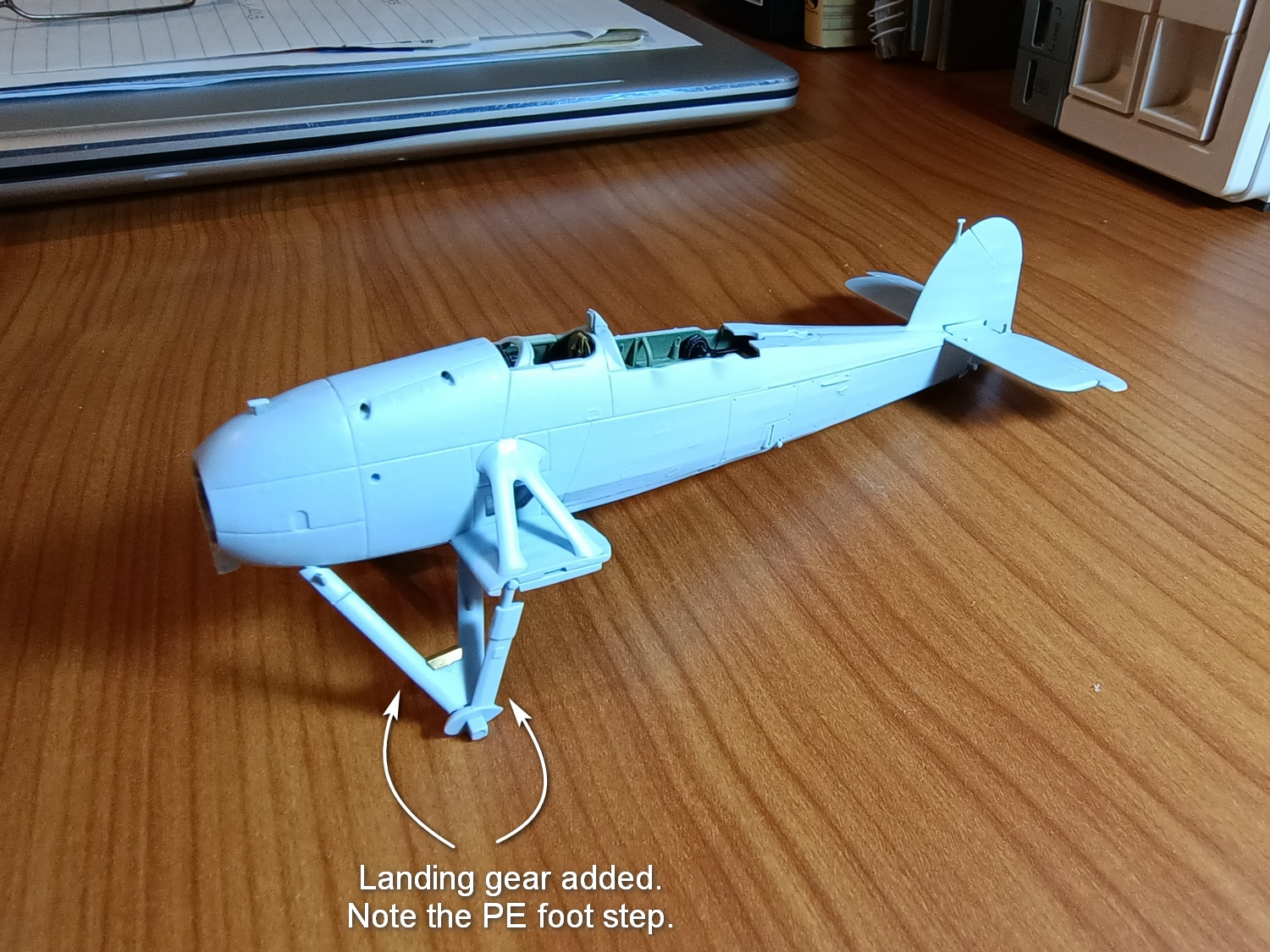

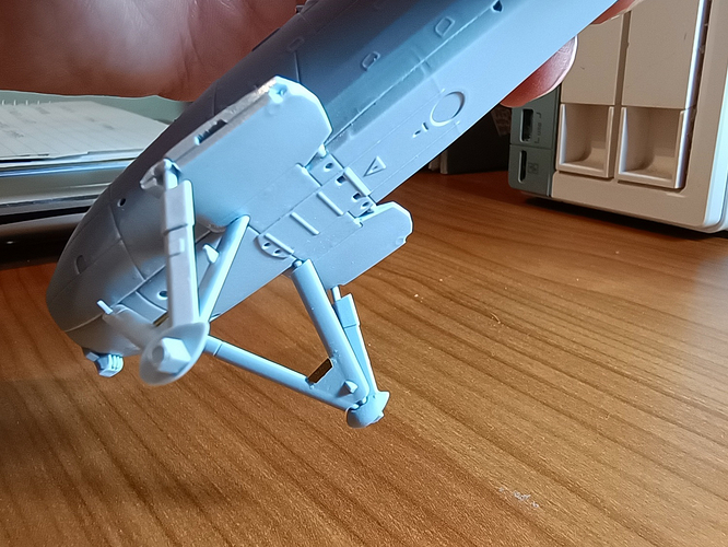

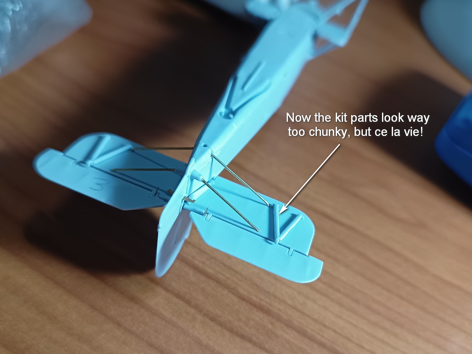

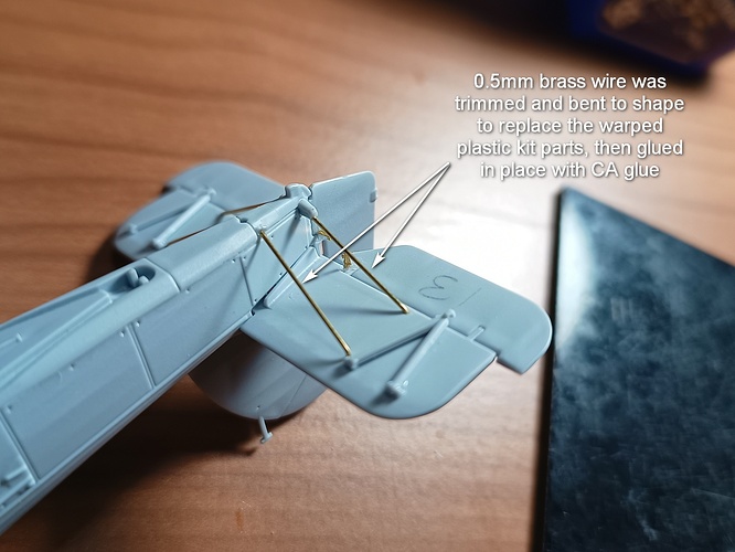

@wunseventytooth Hi Ian, thank you for the head’s up. I hear what you’re saying. It’s so easy to mix the parts from one side to the other leading to a irreparable error as @Biggles50 Leo mentioned.
Fortunately so far, so good with this build and all is going together ok…
So, a bit of an update to that end…
And an overall view…
The main fuselage is nearly ready for paint, along with the other main parts, but I am going to prep all the remaining small parts prior to heading to the paint shop…
Thanks for looking…
