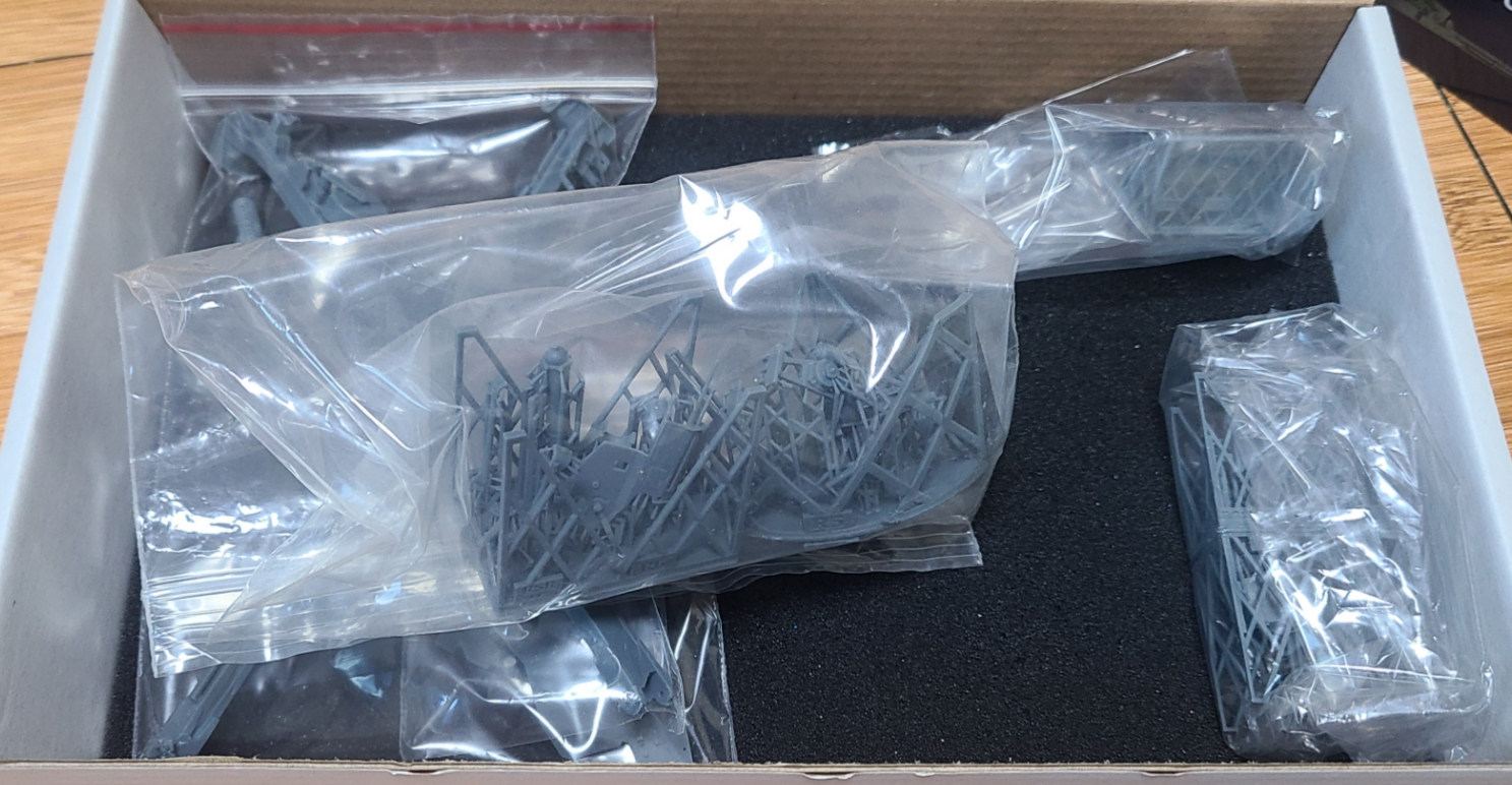

I just got Ukraina’s kit maker Spalah’s MT-12 gun.
This is a full resin kit. This means there are no mistakes, if you make one wrong move, there is no turning back. always dryfit first! This type of full resin and 3d printed kits has disadvantages. The major problem is that’s not a definetly for novice modeler. only for expert. Because you have to use Cyanoacrylate glue, and once you make a mistake, it’s very difficult to undo it. But I’m not a expert, of course. but neither newbie modeler.

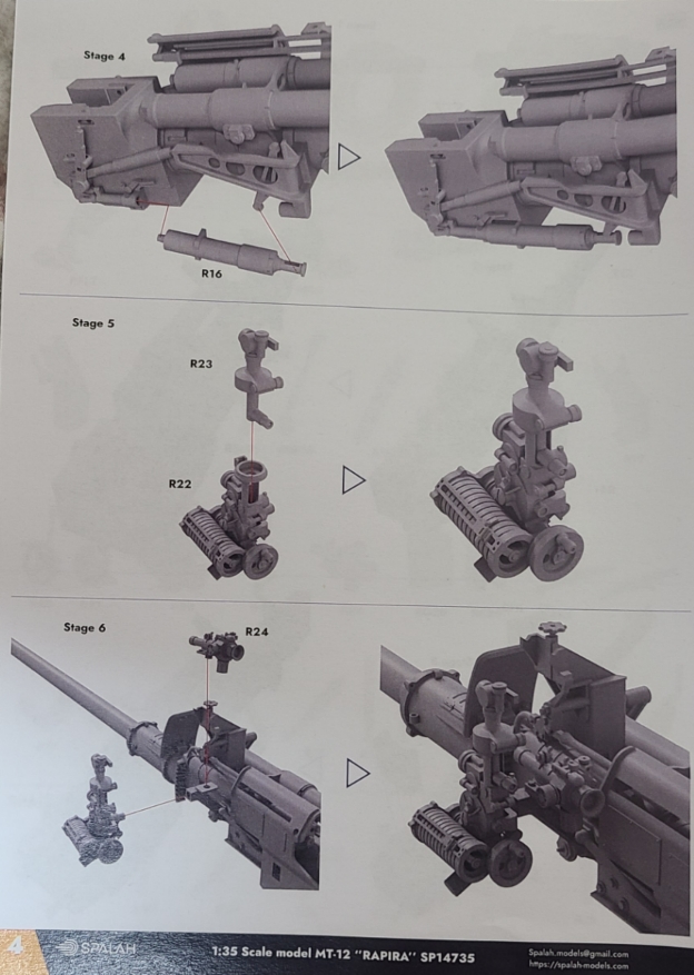

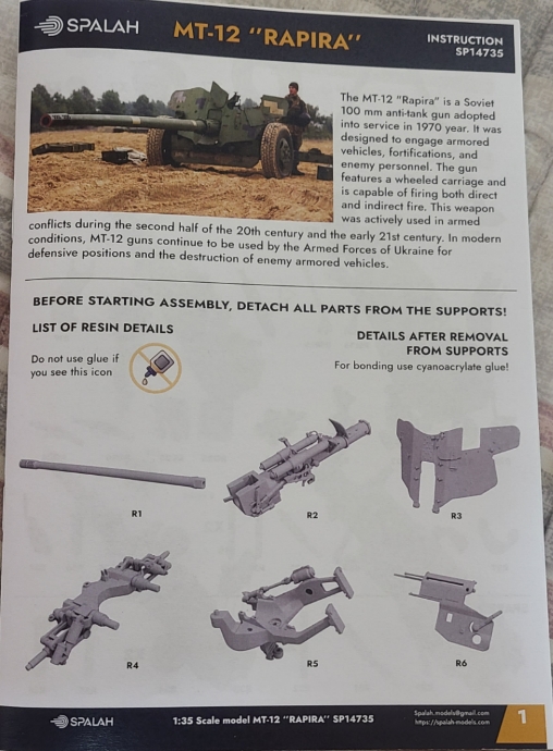

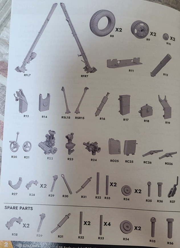

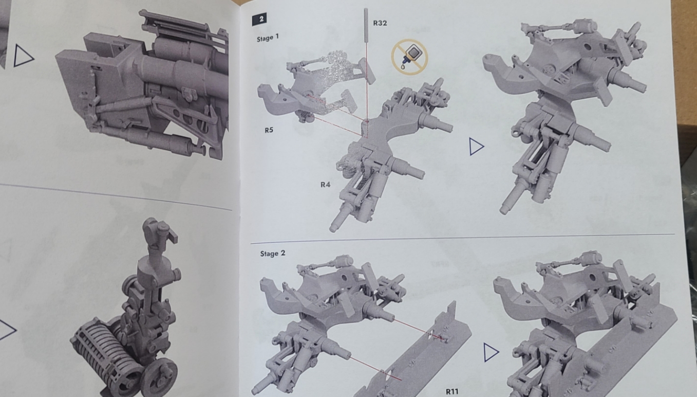

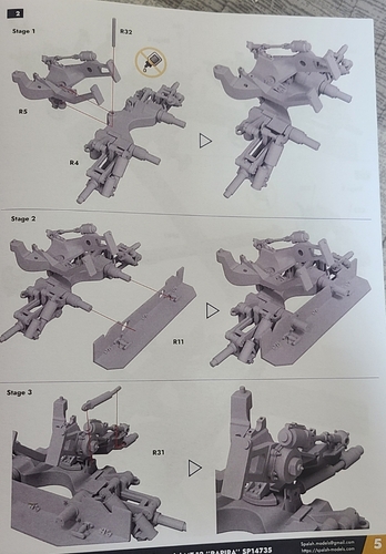

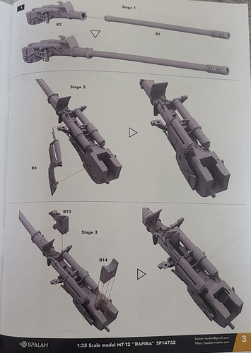

What does the instructions look like? Can you show a page?
Instruction are 19 pages.

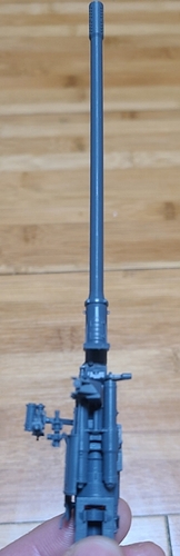

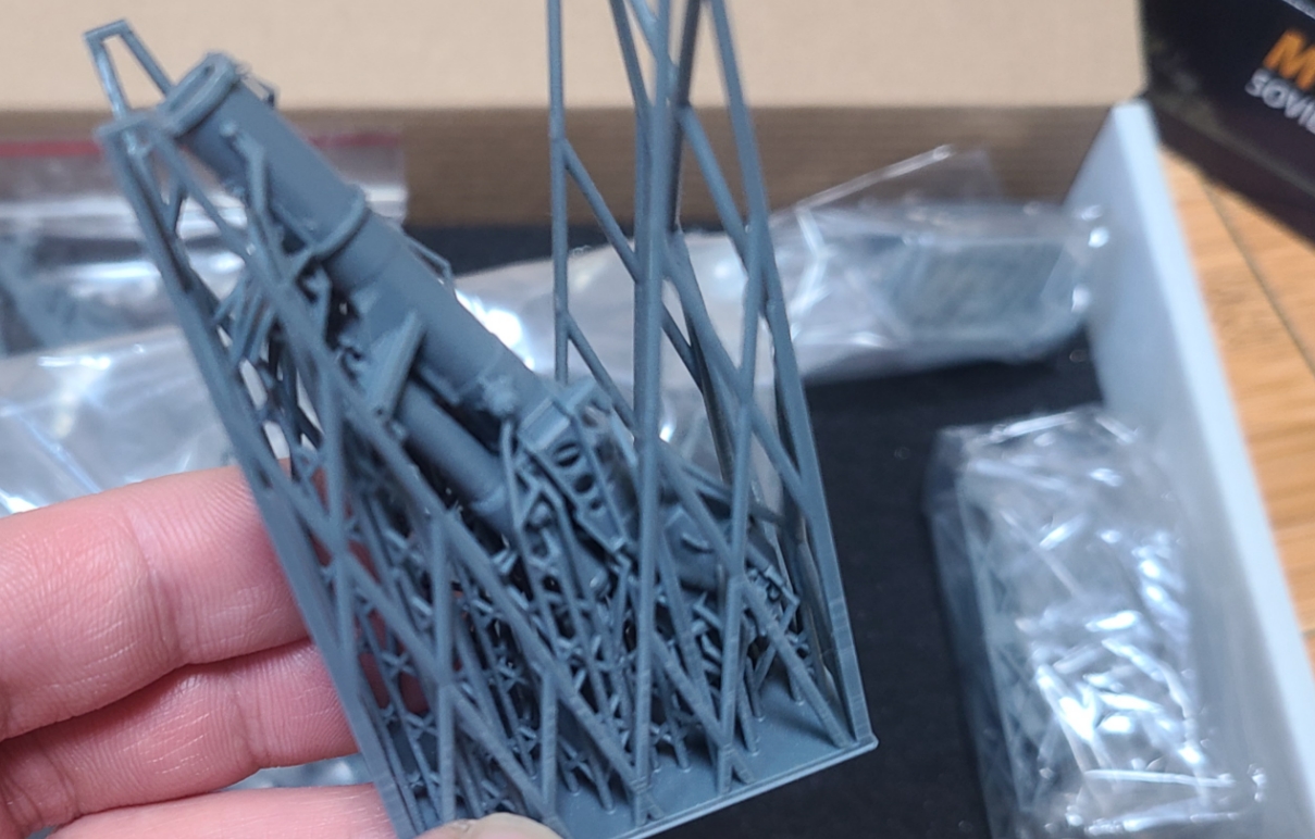

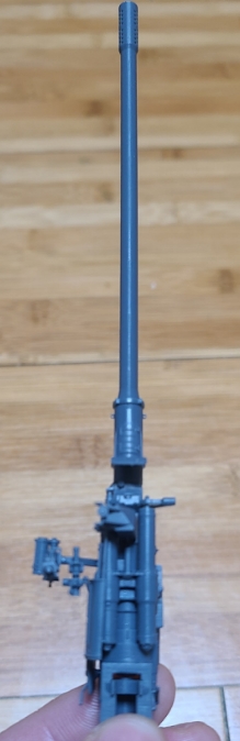

Thanks! I think this build requires a lot of dry fit. From my experienes with other 3D printed kits, I am afraid that I would damage parts during careless removal from the “sprue”, I wonder if the long gun barrel comes out straight?
Me too, I’m really afraid of removing from sprue. the 3d printed kits are so fragile.:grinning_face:
Gun spade and gun shield/barrel are comes out straight. no removal required.
Last year I posted a method for removing very delicate pieces. There is such thing as a “sonic” remover. So I figured out how to do it myself.
Cup your hand over the part(s) so you don’t lose them. With nippers, clip a big piece of the support base, not this thin supports. Very often the snapping will instantly dislodge your piece(s) with no damage.
I’ll try that. Also in Youtube, lots of folks are recommend using a hot water.

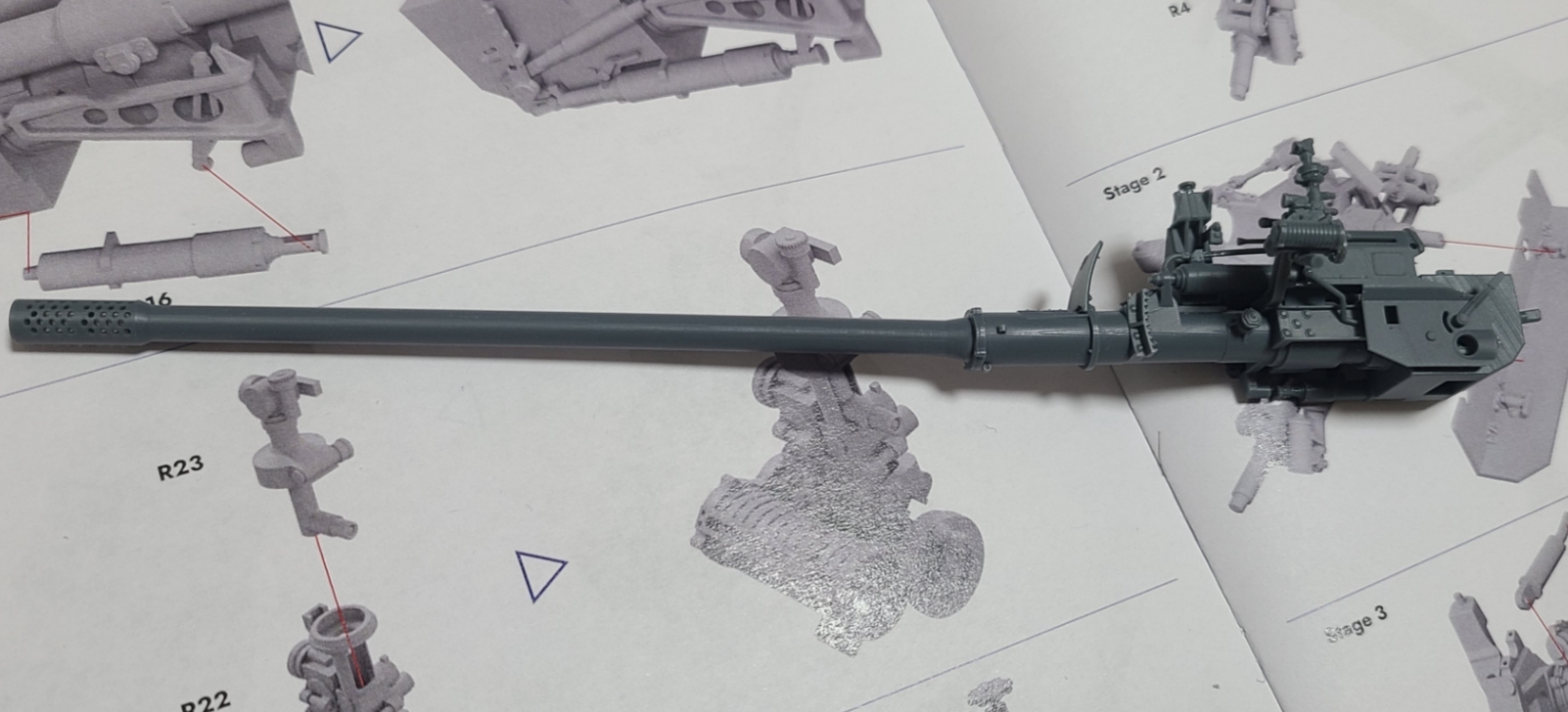

So far so goood.

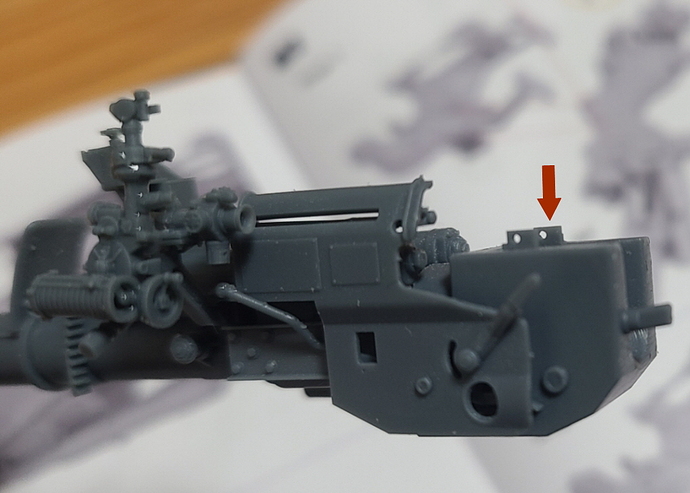

After applying the cyno glue and placed it, Then I grabbed the tweezers to press it down. and in that brief moment, it stuck! How could it happen so quickly! dayum. That breechblock is supposed to be a little lower. Of course, I dryfitted first. man, and I cannot fix that. cuz I’m afraid of breaking the parts, so I leave it that way.

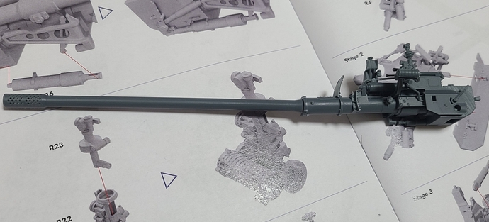

I completed the kit. now it’s time to paint. Since there weren’t many parts, it didn’t take long to build.
I’m not sure if anyone will actually build this, but I discovered several precautions and wanted to share them.

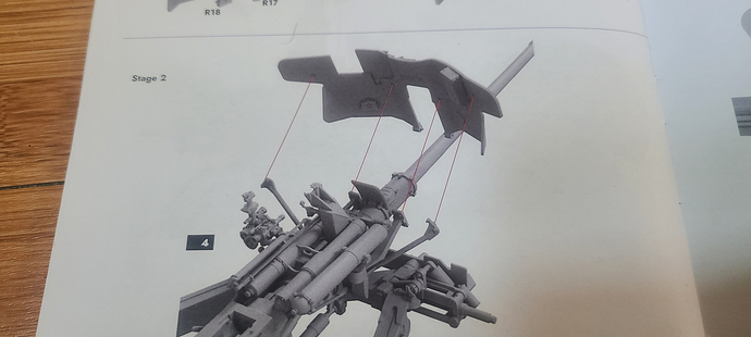

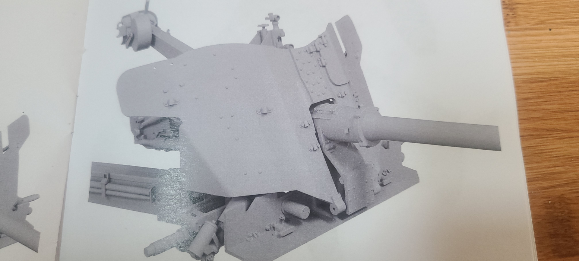

Attaching this shield is the most difficult part. You need to be careful when attaching it.
Although I was carefully and delicately, the result ended up like this. I’m sad because there’s no way to undo it. (As advised above, there are products like acetone or super glue removers, but I don’t have them at the moment.)
End of result should look like this.
edit - but wait, come to think of it. that part is automatically folded when the gun barrel is lower or upper position. ohh, I found a solution then. I mean a more convenient method is to ignore the manual, cut this part into two pieces, and then adjust it freely to match the cannon’s angle.
And another thing

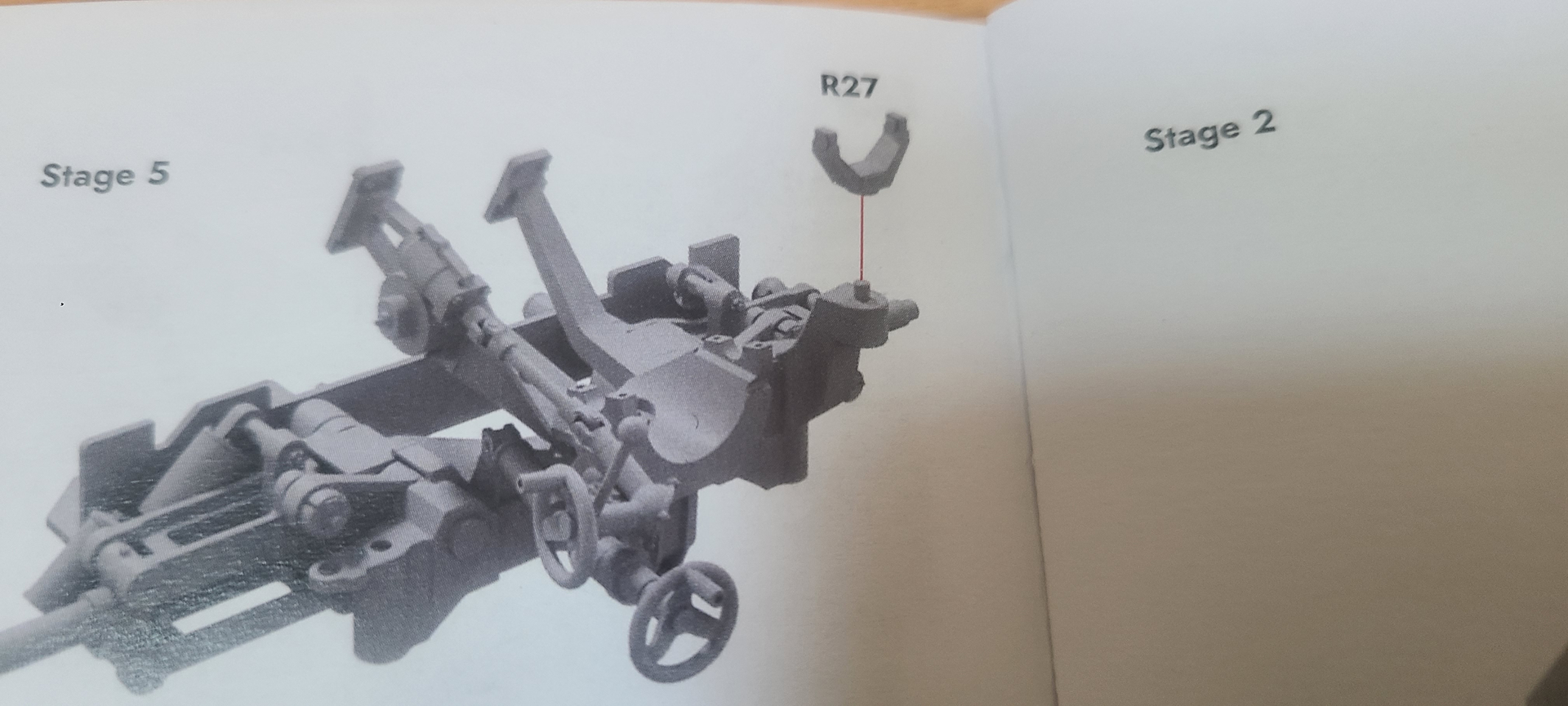

The R27 part. You need to set the direction of this part correctly.
Since part R27 is linked with R12 and R29, so if you misalign the R27, you screwed up! Because as mentioned, this is a 3d kit which requires cyno glue. So I suggest install the cannon to the cradle first, and then gluing the part R27 etc.
