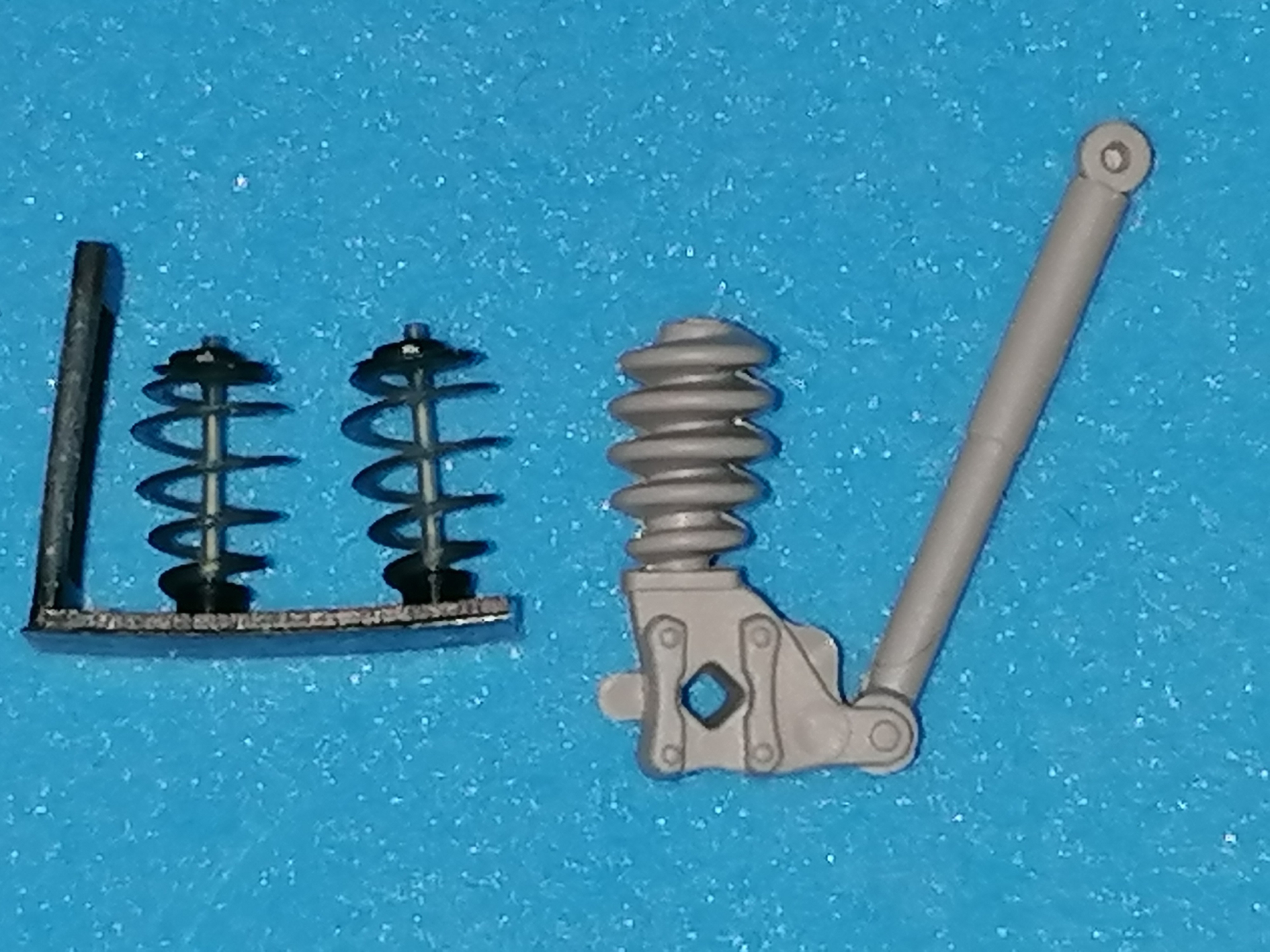

PSM’s resin update set for the ICM Unimog also contains 3D printed coil springs for all wheels that look incredibly much better than the kit parts. The ones for the front wheels, however, have a printing support rod in the center that I think should be removed – just how? The base plate is of hard, brittle material about like clear plastic, so I’m afraid to destroy the springs. Any suggestions are very welcome.
It does look like the bar in the middle should not be there:
(source)
No idea how to remove it, though. I must say that I do think the 3D-printed spring looks rather flat, however, like it’s not made of round cross-section material

Yes, Jakko, the bar must go, as otherwise, the spring on the prototype couldn’t be compressed. And I intend to thicken the 3D part with thinned white glue - once the bar will be gone.

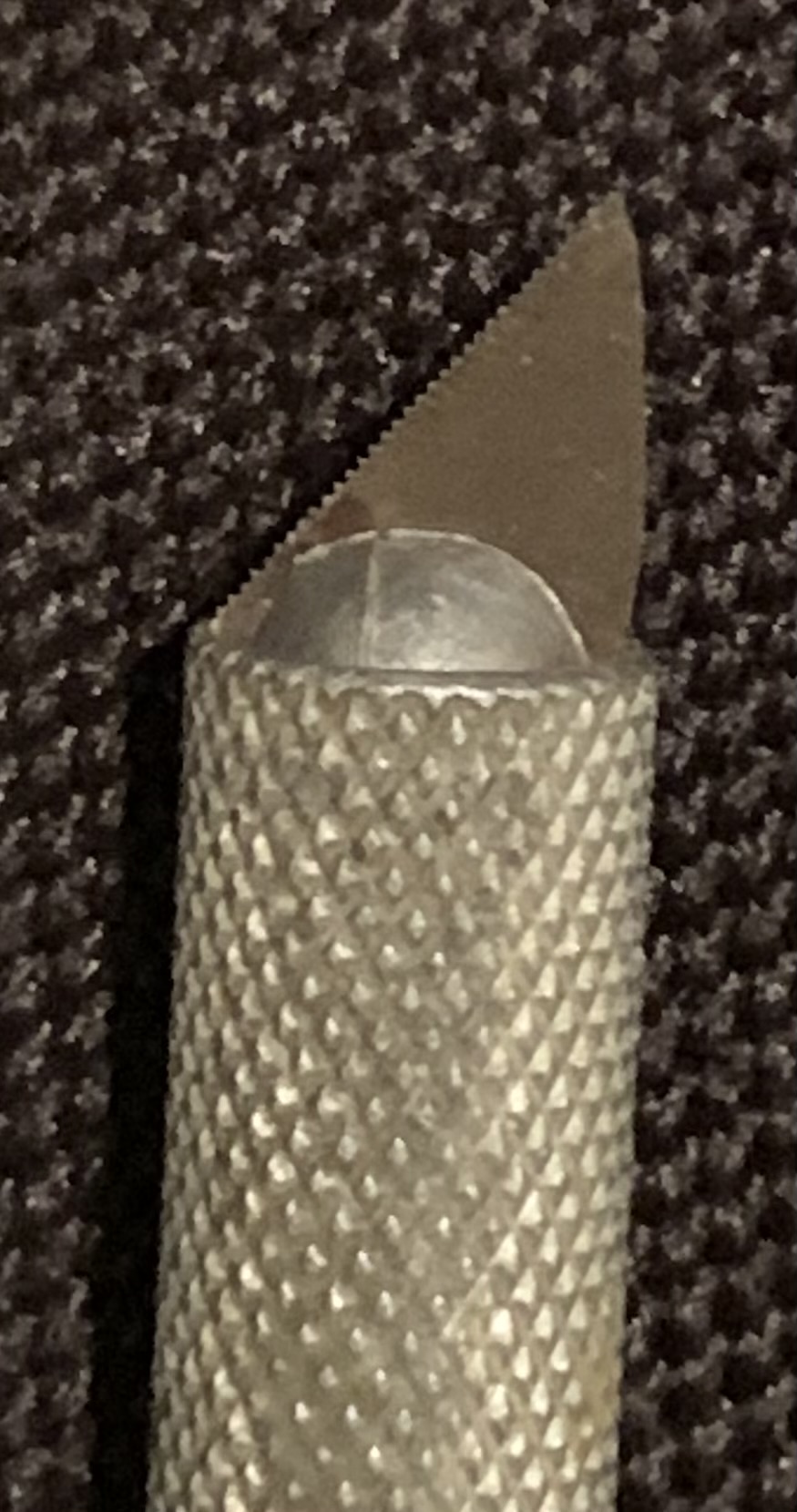

“What a drag it is getting old” sang the Stones, and I can confirm that: It took the search for something entirely else in my tool drawer to stumble on this set of saws. Bought them a few years ago and never needed them, so I didn’t remember. Their teeth are even finer than the fine-toothed side of the razor blade saws we all know, plus they come in very handy shapes:
That made removing that strut easy enough, so I could start ”rounding” the coils.
