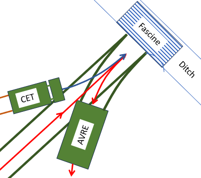

Now there is a larger and potentially more interesting diorama,
AVRE backing out while turning to clear the approach and a CET approaching, turning towards the ditch
Should the CET come in straight instead, following the tracks of the AVRE?
A straight approach would get visually cramped. AVRE closer to the ditch and the CET on a straight approach but a little further back? Cramming things into a limited size diorama implies making some “adjustments” to the 1:1 scenario.

There was usually a minefield in front of the ditch, so the AVRE would plough up to the ditch, drop the fascine, and reverse out in its own safe lane. Then the CET would follow.
We kept WELL apart, at least 50 - 100m. Spatial awareness is hugely compromised when closed down. Usually, the CET would ‘talk’ the AVRE back out of the mission on Troop net, because they couldn’t see behind them at all.
A full bucket of soil was taken from anywhere available, but the most important thing was to arrive at the mission with a bucket full ready to go.
The CET can’t ‘doze’ in the true sense, so the technique was drop the first load on to the fascine. Then reverse up and begin filling the bucket in a shallow ramp as you approached the fascine, dropping what you had collected onto the fascine. If there wasn’t a minefield in front of the mission, this was easier as you could gather soil from further afield and make a sort of ‘funnel’ into the mission which the chunkies would subsequently defile mark.
