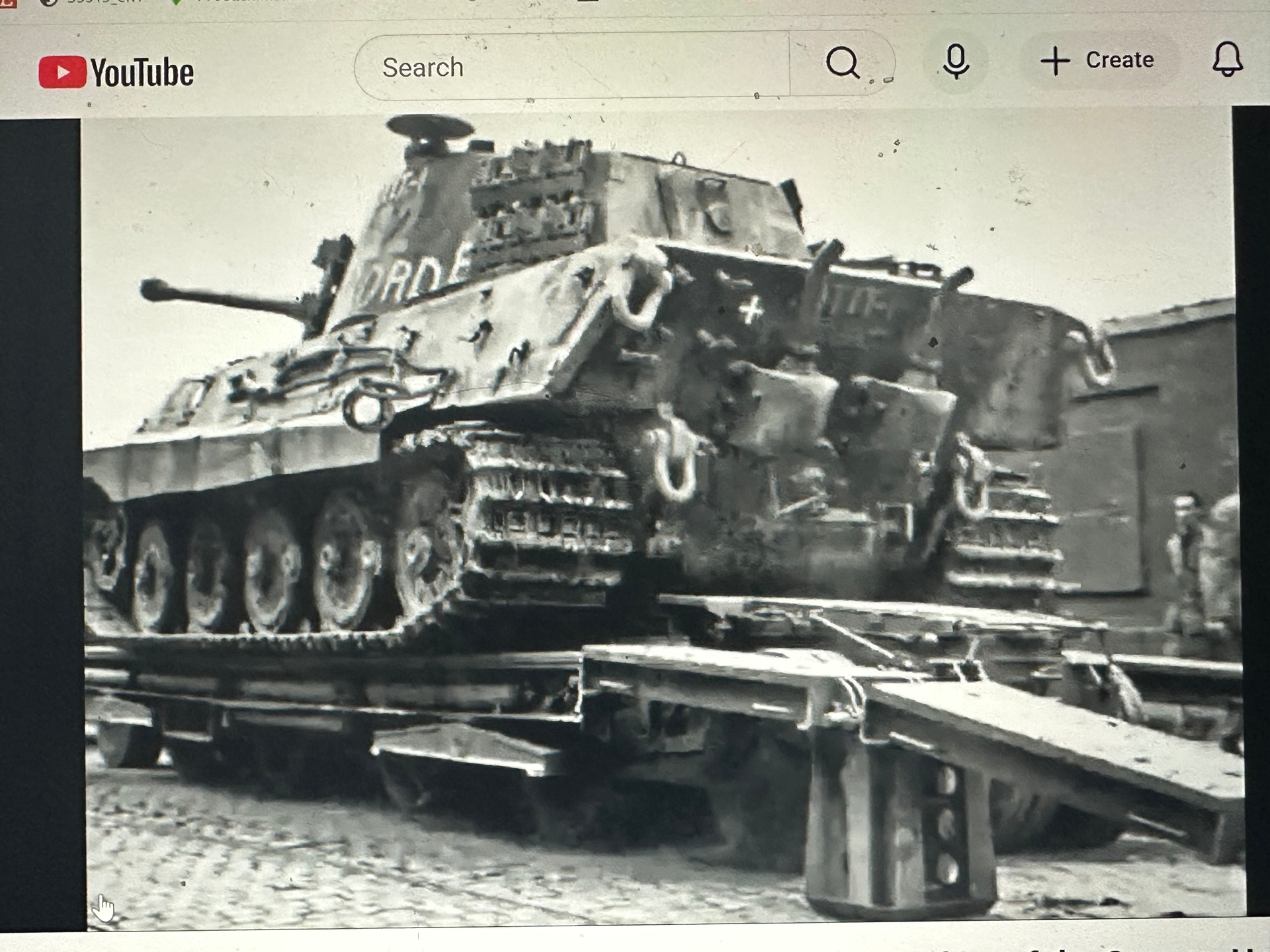

Edit to add photo - imagine your destroyed tank(s) headed in the opposite direction on the neighboring track. Good reference for how the tanks were loaded:
Just be aware that the above photo shows the Tigers with the “combat” tracks installed. Probably okay for short movements in an emergency. (Unless you’re fixated on the German equivalent of the TM)

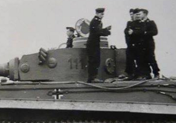

These are soldiers of the 504 training at Paderborn. They have the standard black uniforms. We don’t know when they exchanged these for more suitable gear. The Tiger is fully painted and marked with its tactical number “111”. It doesn’t seem like there’s anything further to do there.

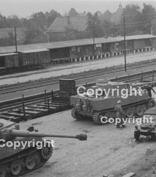

This is Bad Fallingbostel railway station. New Tigers arrived here to the training school, and we can assume that they left from here also. The station then, like today, had 4 track lines. The platform in the foreground ends in a spur line off to the left of the photo; these Tigers have driven themselves off the rail cars.
If you will pick an African Tiger unit, I will tell you who else was training in Paderborn around the same time. It’s plausible that they would ship off a couple of Tigers to different units on the same day.
