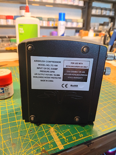

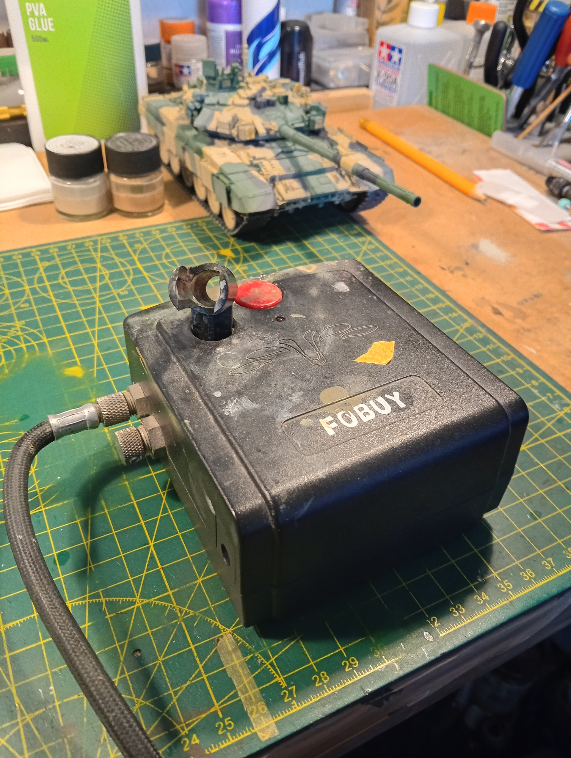

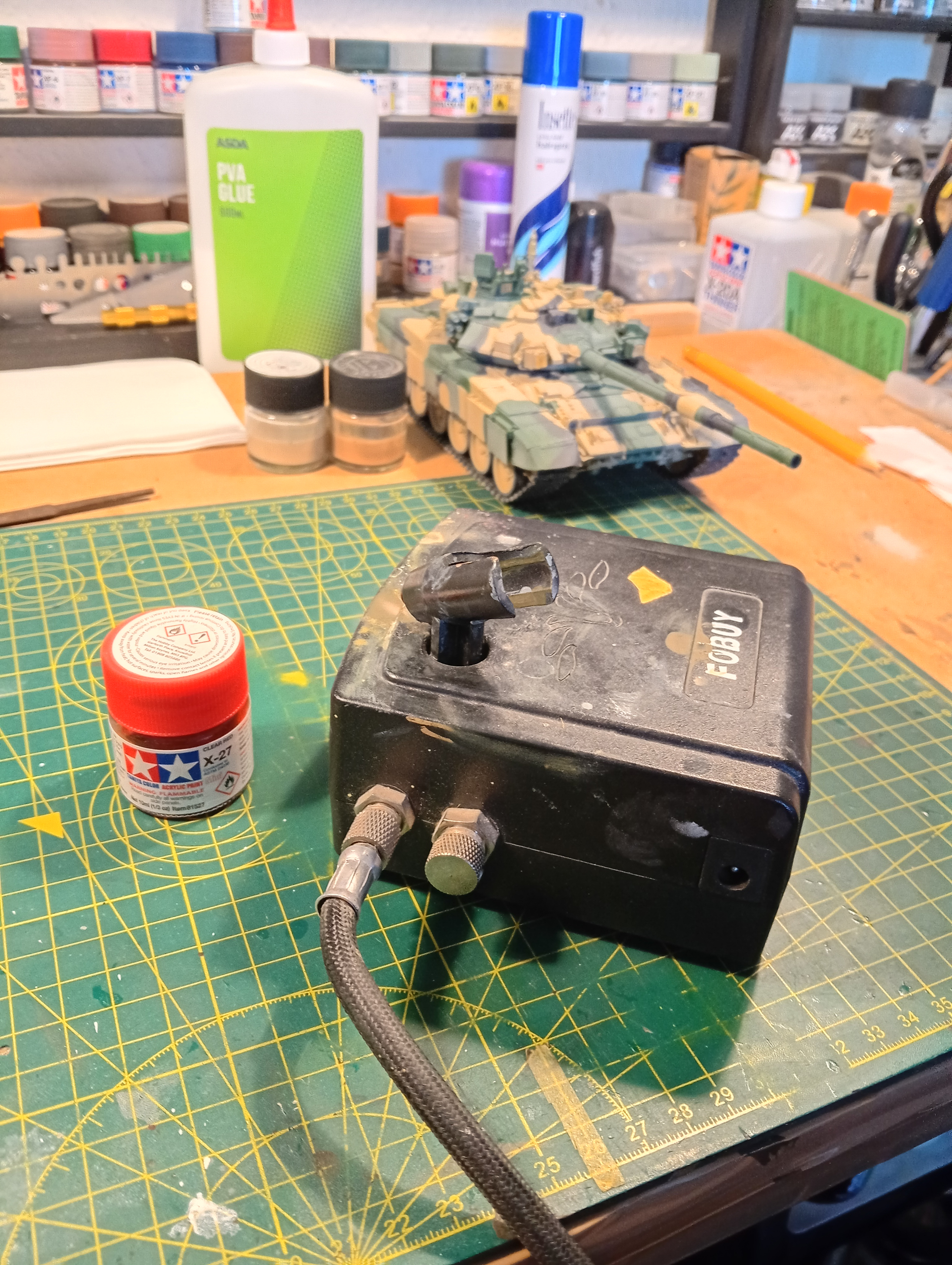

So Yeap, I went cheap and cheerful with a £45 mini kit. Compressor and airbrush with 3 needle sizes.
And this is it after 5 years …
The very famous Fobuy brand :rofl:… I’m guessing from china …seriously nothing fancy, a pressure dial to increase or decrease, on off button and that’s about it. Pushes out about 25psi…
The only things I have bought to enhance it was another airbrush which was £50 which Ryan @Tank_1812 gave me a heads up about, and a cheap cleaning kit for it. Both airbrushes have .2, .3 and .5 needles.
Now, I know this is all subjective and some people just have to buy the most expensive out there, which is fine and if that’s your thing then go for it, but I often wonder … Why.
In all honesty, this £45 set has never let me down, the only time I have made mistakes was the incorrect mixing of paint and thinners. Other than that it has coped with overall sprays, misting, hard and soft cam schemes, and I have even managed to do 2 or 3 cam schemes free hand with no need to mask and ran it at low pressure with the .2 needle. I still detail paint with brushes but I guess most people do anyway ?
And I only class myself as a very mediocre airbrusher but I have never been unhappy with any of the builds I have used it on.

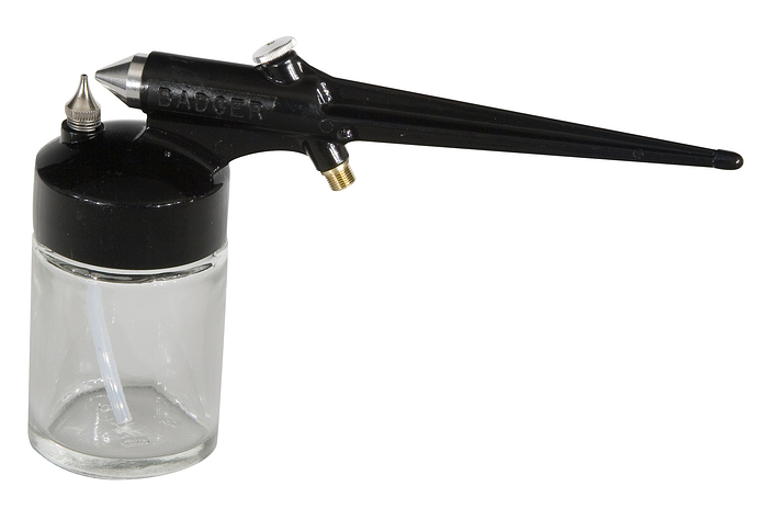

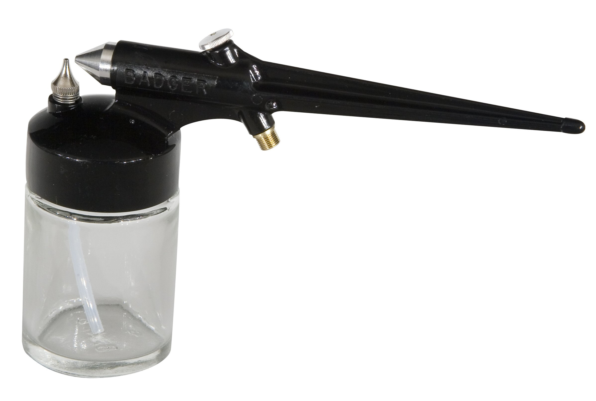

I started off with a Badger and compressed air cans when I was in middle school.
I used it for several years for base coats of German gray, olive drab and desert yellow. I then upgraded to this badger because I wanted to start camouflage painting. I worked mowing yards and had an allowance and was also able to eventually get the old brown Badger compressor.

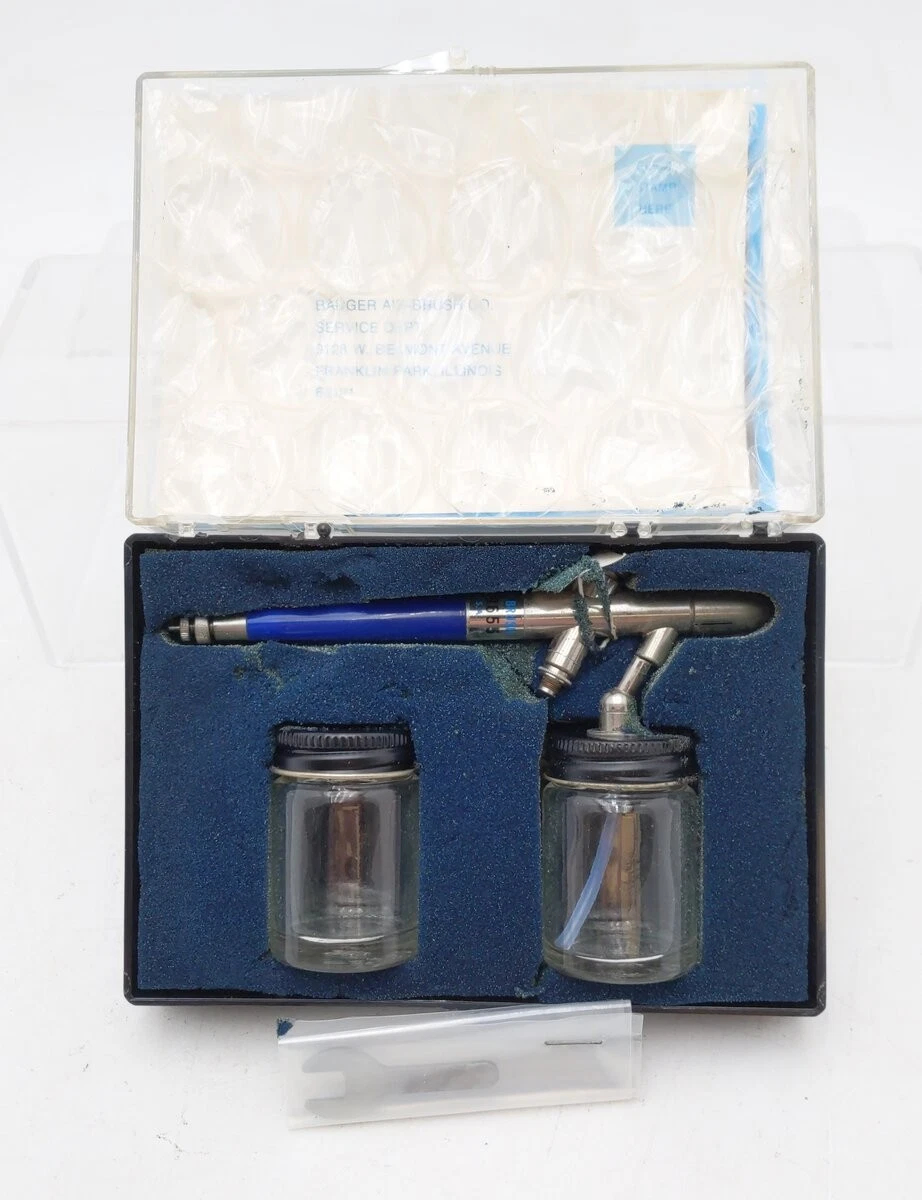

The problem with airbrushes is you can’t try them before you buy them and there was no one around to talk with so you bought what you thought would be the right one. There was also no one around to teach you so it was a buyer beware and self-taught adventure. I wasn’t impressed with the airbrush so buyers remorse, I saved up and bought a Badger 200.

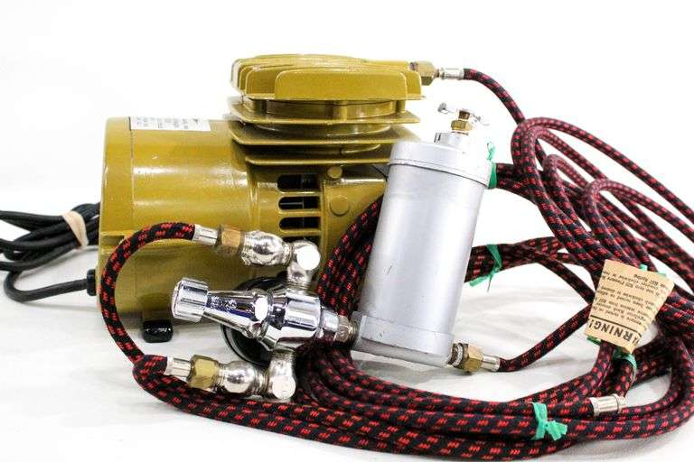

I used this airbrush and compressor for 25 years. It worked well and gave me few problems. I eventually wanted to make a more refined edge to my camo patterns and do some fine detailing and up graded to an Iwata HP-C and was happy with the results. I have since gotten two Iwata eclipses. One has a .5 mmm nozzle and needle and the other a Takumi has the .35mm nozzle. I have also pitched out the old diaphragm compressor. I had repaired it several times and fought water in the line for years even trying to make my own water collector. I have upgraded the air compressor for a CO2 tank. Very happy with that upgrade.
Your journey may have been different than mine. When I started, Badger was all that was available to me. There was no way to try out before you bought so it was a guess as to what you needed. There was no one to show you how to use the thing. No mixing ratios or paint type advice. You had Pactra, Testers and Humbrol. You experimented with what would mix with what and moved forward. Trial and error.
So, advice to newer modelers. There are many more options available today. The problem of not being able to try before you buy is still a thing. Be prepared to like what you bought and then overtime find it does not do what you need and a follow up airbrush will happen. I recommend a name brand for parts and service. My Badger and Iwata I can get parts for any time at most airbrush suppliers. Over time you will need parts as they wear and as you damage or lose them. Of the airbrushes I have and have used, my recommendation would be an Iwata eclipse. Simple and is capable of doing 98% of everything I want to do. Parts available everywhere. It is the most versatile airbrush I own. The air supply is also part of the equation. There are two directions, compressed air or air compressor. I have done both routes. If you need quiet, consistent, reliable service it will cost. If that is not important, then just buy a small portable noisy compressor. There is oilless and oiled compressors. My first badger compressor was a rubber diaphragm oiless compressor. Noisey but cheap and light weight. Quite ones are more expensive. I chose a different route. The expensive compressed air cans and a tire innertube told me to go compressor. But my compressor experience wasn’t without issues. There was noise and that annoying water issue. I discovered CO2 and research it. It was silent. The only sound is if you bang into the tank or the hissing you get spraying. There was no water issues as CO2 is a waterless gas. There is no pulsing issues as there is a constant pressure. There is not an issue with pressure because CO2 is at 800 psi in the tank and the regulator can reduce that to a couple psi if wanted. There was no power hookup needed so it is completely portable. Take it to the beach if you want. The tank is the size of a SCUBA tank. There are very few parts to wear so a lot of pros. The tank of CO2 lasts a long time because it is filled with liquid CO2 that evaporates to fill the tank as the gas is used. The con is you will eventually run out of CO2. You have to take the tank to the gas supplier and exchange the tank for a full one just like you do with your propane gas grill. That’s OK by me because I have a gas grill and it is just what I do. I have two propane tanks so when one runs out when cooking, I just hook up the full tank and next week swap out the empty tank for a full one.

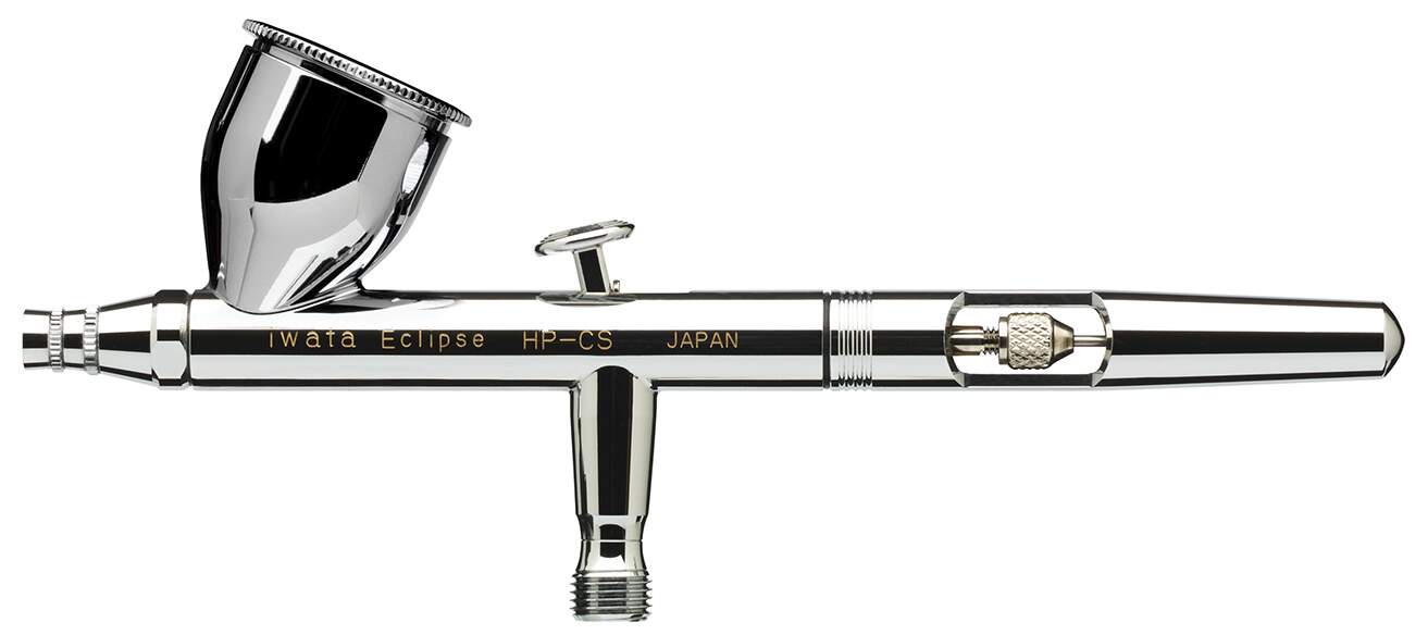

I’ve been modeling “seriously” since the early 1970s (and I’ve been “sticking together” models since 1966). I’ve only ever owned three airbrushes in all that time. I’ve owned two Badger Model 250 and one Rich Pen 213c. (I do own two Iwata’s that I use in my Cerakote business.) I used and abused my first Badger 250. I bought it in 1974 after working all summer to save up for it, but I learned a lot of lessons, what to do and what not to do - Basically I learned how to airbrush with that one. After owning it about 6 years, I bought another, 250 and have used it since 1980.
I’ve painted a lot of award-winning models with that second 250 (to include IPMS National first place winners and the models that got me elevated to AMPS Master). It’s been renovated under Badger’s lifetime warranty program, and after 40 years, it still paints just as good as when new. For those not familiar with the 250, it’s an internal mix, single action, siphon feed brush. Nothing highspeed or particularly “cool.”
I only bought my Rich Pen 213c in '05. It’s my “go to” brush right now because I’ve slowly changed how I approach most airbrushing projects. I wanted to learn and experiment with double-action as well as top feed. I expect it to last just as long as my Badger.
I tell this story because I think you can measure value (not price) in many ways. You can buy cheap airbrushes and when it becomes impossible to fix them, just buy another one. You can abuse them and not spend much time cleaning and maintaining them, and if they die, you’re not out much. If you’re just starting and learning, a cheap airbrush can get you through the steep part of the curve for an economy price. (There were no “cheap” airbrushes back in the '70s, BTW. They were all expensive.)
Or, you can go with a more expensive brush that has a solid and reputable manufacturer behind it. one that can be repaired and for which replacement parts and accessories are available. Such a brush can last you decades.
However, the number one thing to do is MASTER the airbrush you already have. Way too many modelers throw money at the problem, thinking that if they only have a “better” airbrush, then they will automatically be better painters. This, my friends, is sadly not the case.
So, make your airbrush, cheap and inexpensive or priced like a Swiss watch, “sit up and sing for its supper.” Only when you KNOW that you’re getting every last bit from the brush you already have should you consider “upgrading,” and that upgrade should be made towards a very specific additional capability that your current brush simply cannot deliver.

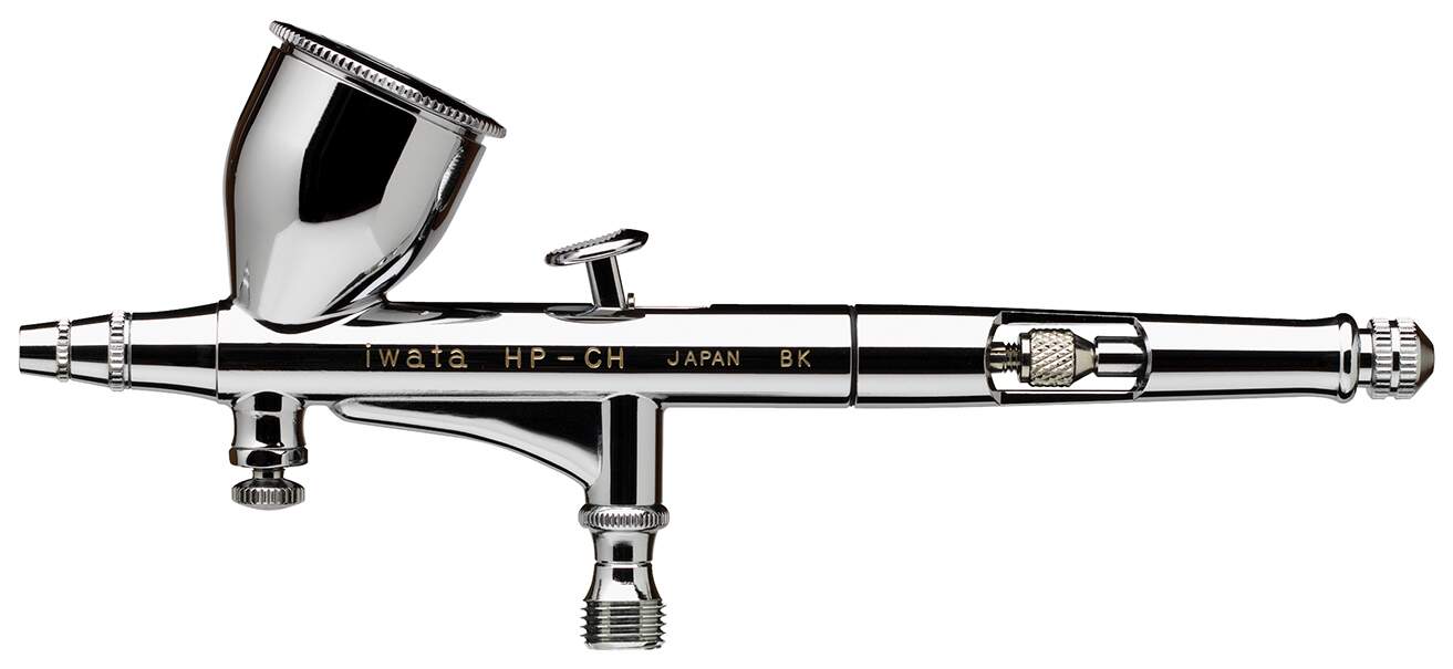

I have a couple of Iwata’s for good, and fine work. But then I bought a cheapo airbrush on AliExpress for around $20 CAN. I’ve had it for almost a year and it still works really great. It has lots of machined parts so it’s pretty reliable. I use it mostly for spraying Future (or Quick Shine, now) and acrylics that might f up my Iwata’s.

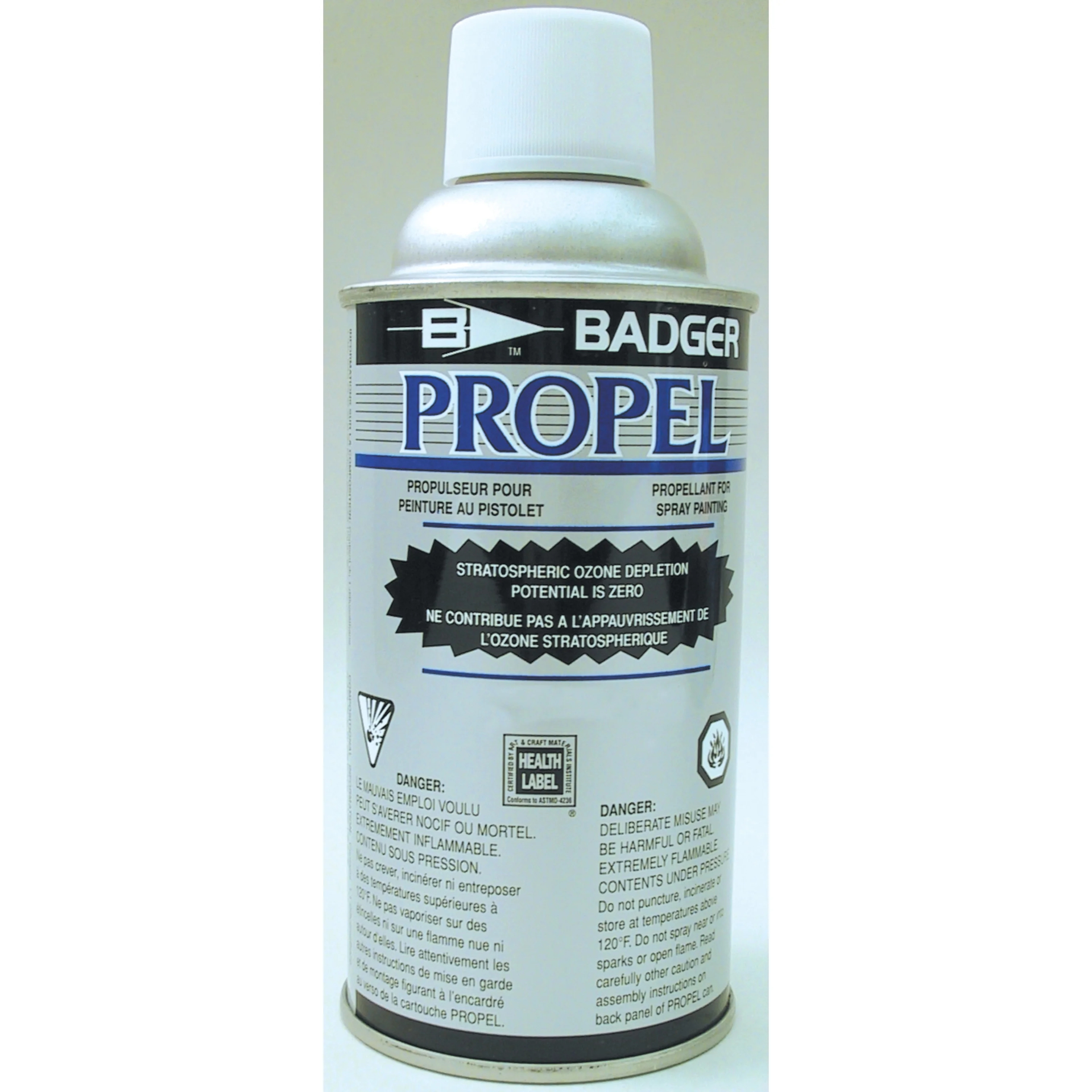

I bought my first airbrush when I was about eleven. The cans of Propel fell into disfavor pretty quickly. There were expensive and ran out of pressure at the most inconvenient times. The Badger hose I had could be attached a spare tire. I had no way to measure or regulate the pressure, but learned pretty quickly to let some air out of the tire for better results. Even at reduced pressure, the tire maintained a pretty steady flow for quite some time. And when it got too low, I could pump it back up myself.
