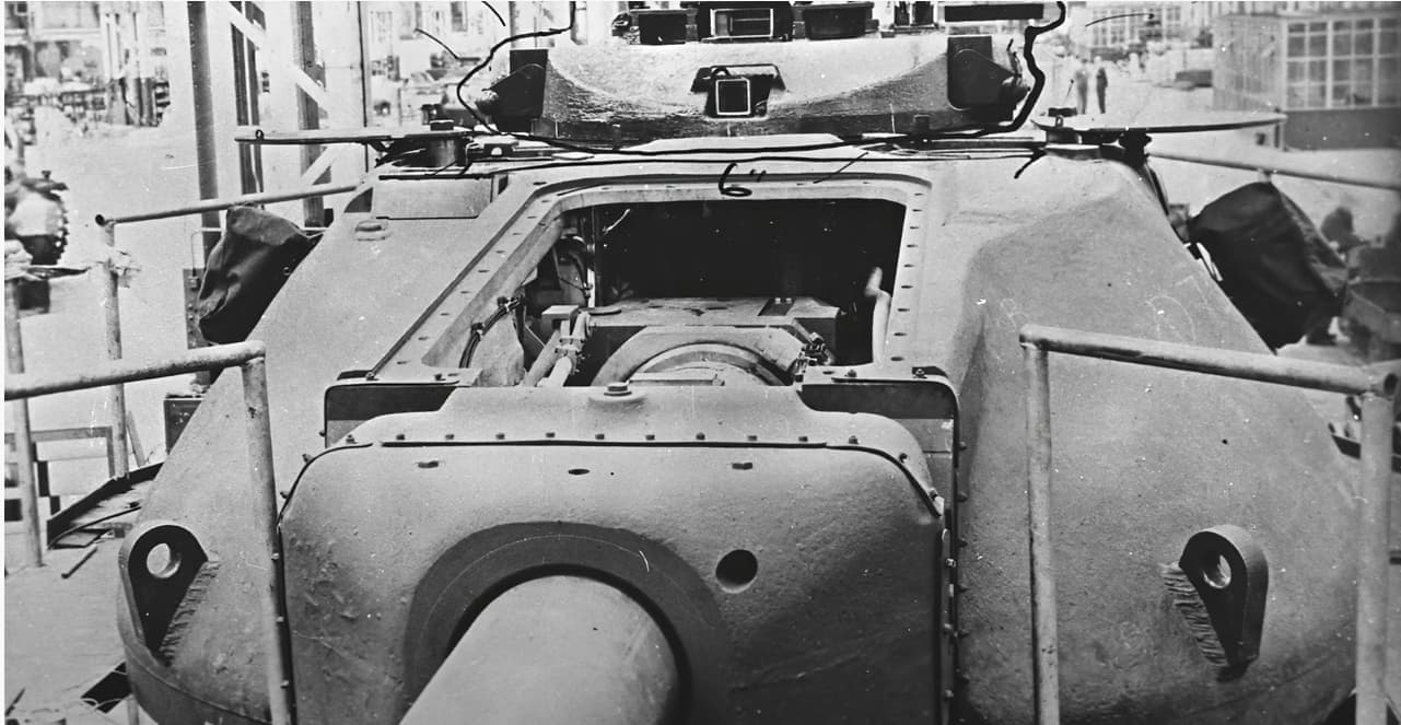

Looking at the open hatch pic, it suggests the Amusing hobby hatch is too wide, and a commonly cited kit issue. However, look at the periscope cover on the left of the hatch-less pic, and its relation to the bolt (green circle) in front of it, plus the apparent width of the triangular segment to the scope cover’s left. Then look at how the section of turret on the right of the hatch tapers slightly at the front. Compare to the pic of the kit turret. Then compare the centreline on the raised section on the right close to the back end of the turret to the area in the kit (Yellow arrow) I think it is because the sections on the kit turret beside the hatch are too narrow, not that the kit hatch is too wide at all. Also the mantlet in the kit seems narrower than the one in the pic, which means if it was widened to fit a widened area on the hull beside the hatch, the rest would be in proportion!
