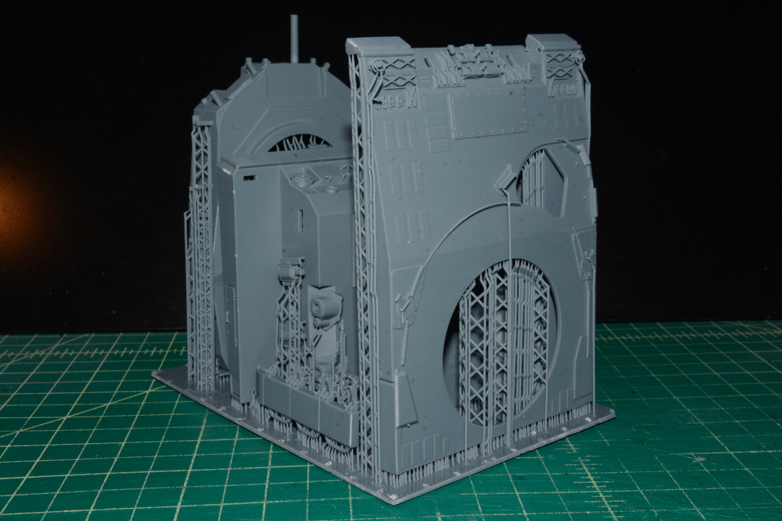

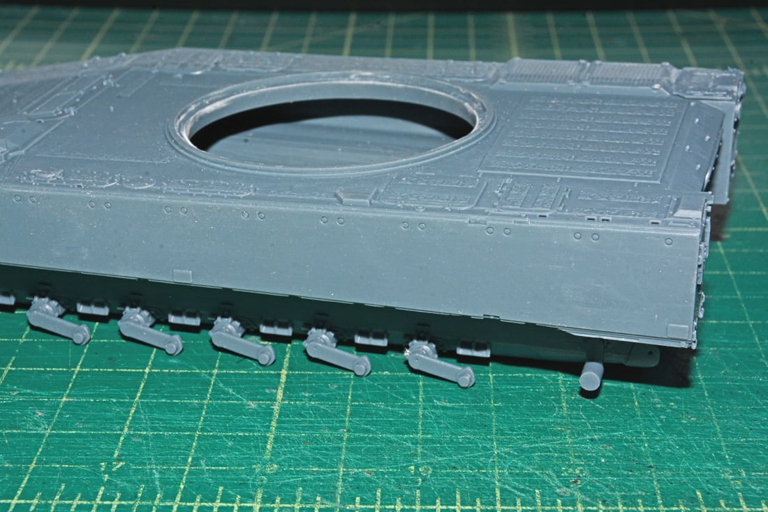

I have the SSModel 1/35 Argentine TAM and it is decent as is. The turret and hull had a lot of support stems to be removed but shown here already cleaned up. Here they are test fitted.
You can see the extent of the support stems in this photo.
The rest of the parts also had a lot of support stems as well.

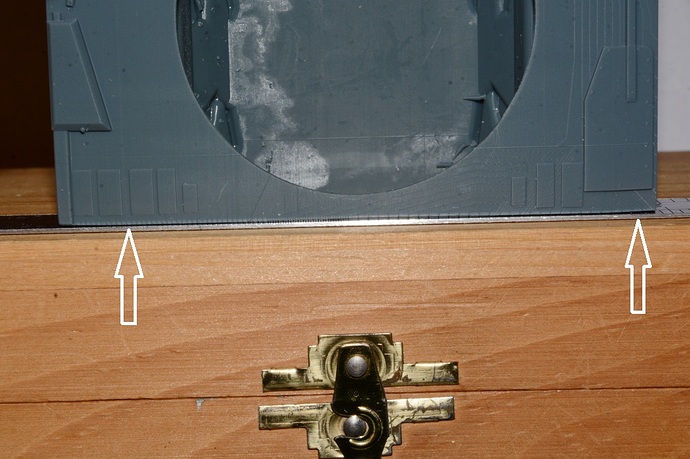

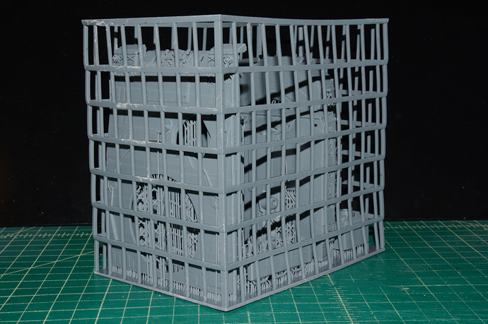

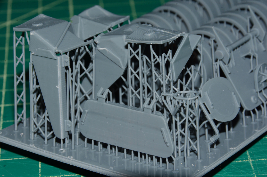

As you said, some are hit or miss. This 1/35 Leopard 2PL is also from SSModel and they printed the hull in two halves, front and back. This photo shows the support stems before removing them. This is also how the TAM arrived.

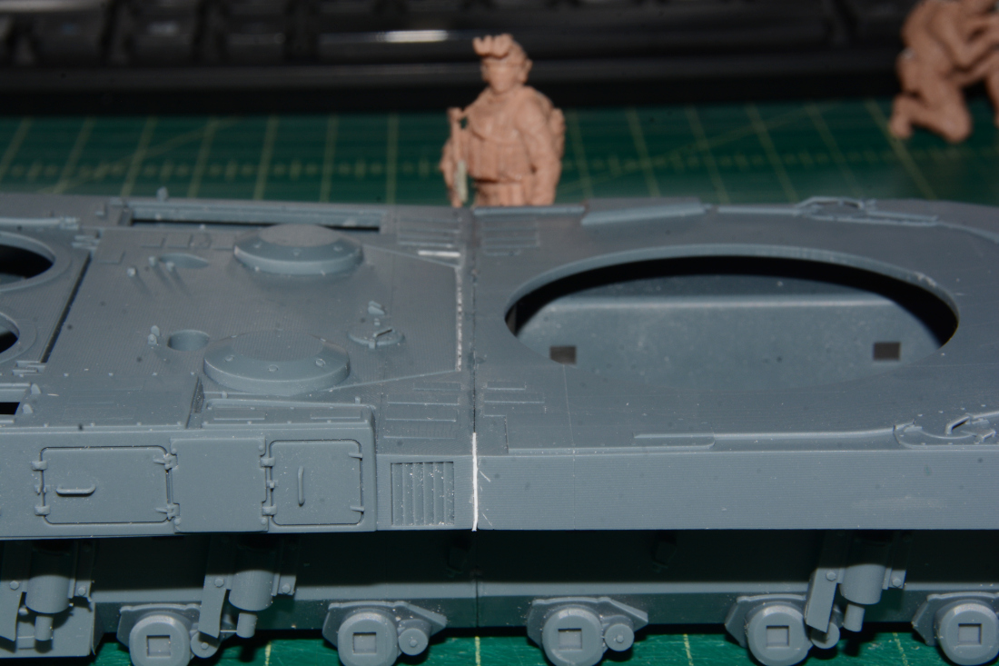

Here you can see the hull halves.

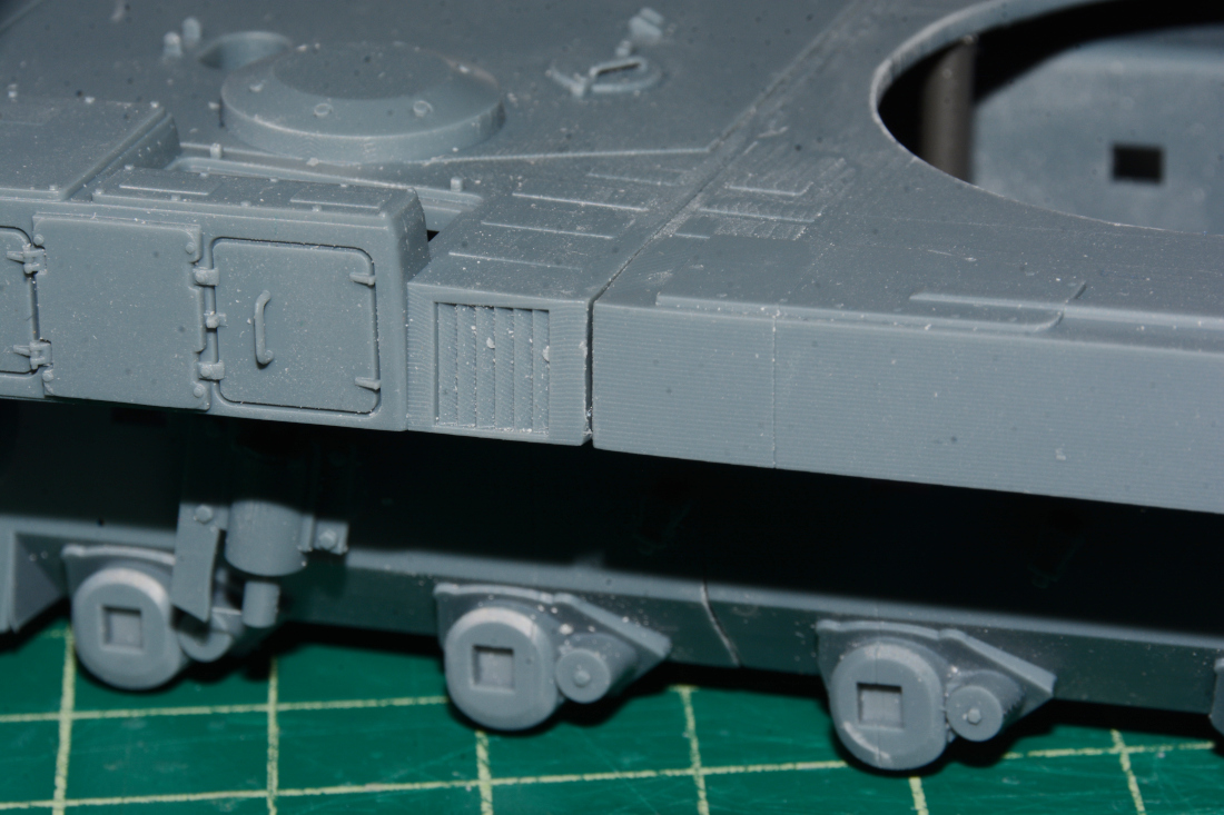

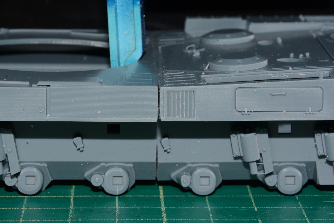

The two halves did not meet flush as seen here. There are huge gaps needing to be filled.
In this photo, you can see that both sides of the hull are raised above the flat surface.
Even after filing and sanding, I still needed to fill the gaps.

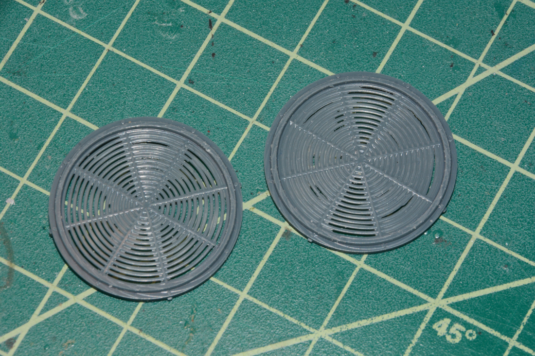

The exhaust grills were pretty badly printed and they do not include the mesh screens.

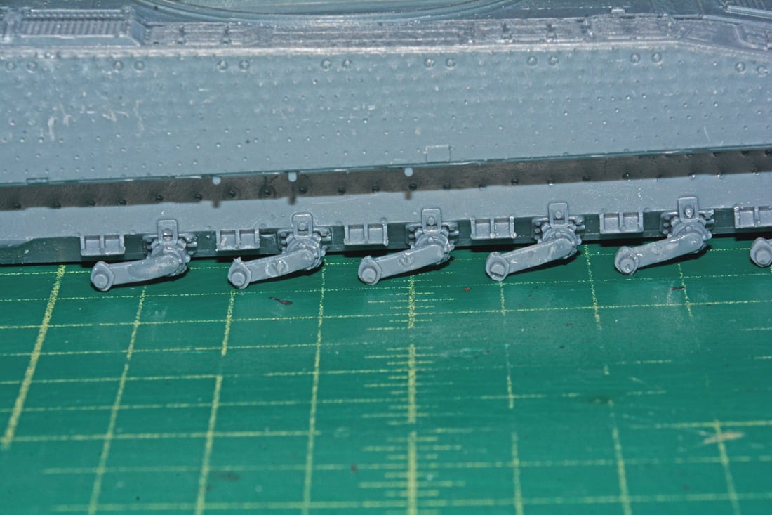

There were tons of support stems on the right side of the hull as seen here.

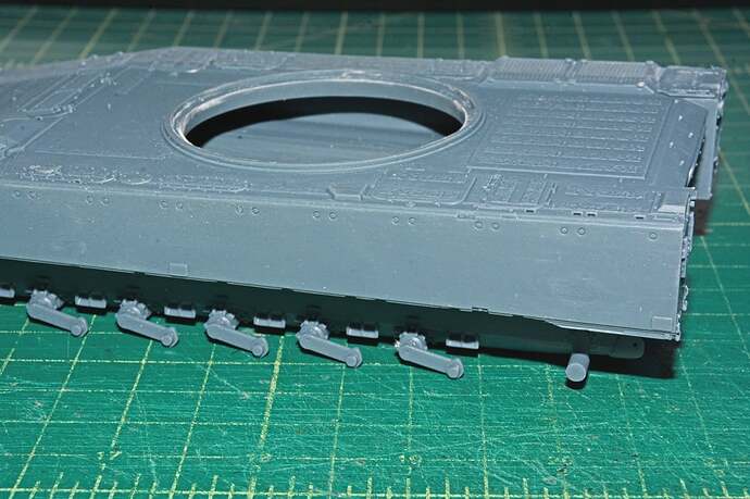

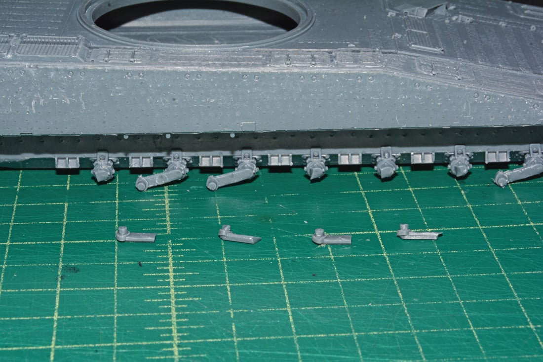

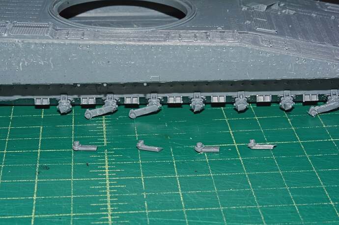

Once I removed the support stems, four of the suspension arms were broken. I did not break them, they were broken during shipping I am guessing. Once I removed the support stems, they just fell loose.
The whole right side is filled with dimples from where the support stems were removed from. I used at the time, brand new Stedi snippers to remove the stems and then a new blade for the cleanup but still left tons of dimples. I super glued the suspension arms back together. I hope that is strong enough to hold the weight once the full kit is together.
The left side had no support stems and was printed clean.

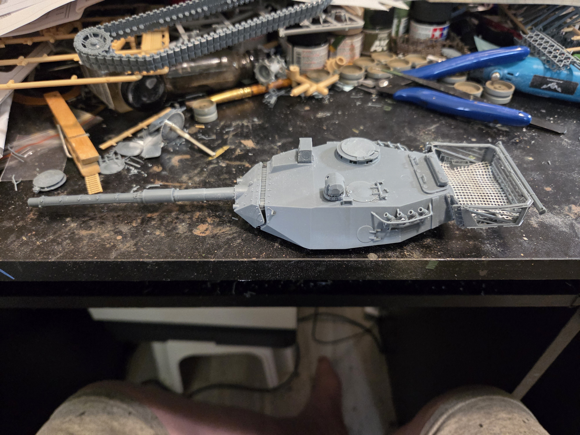

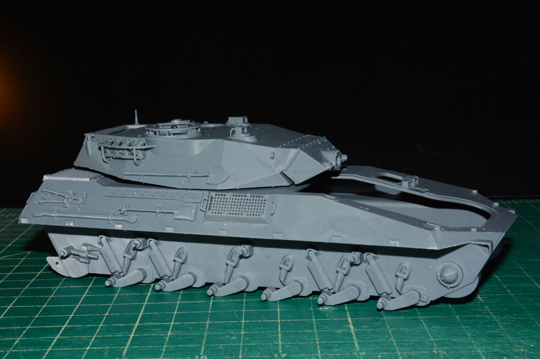

Here are a couple of pics of my SS Models in the assembly process
