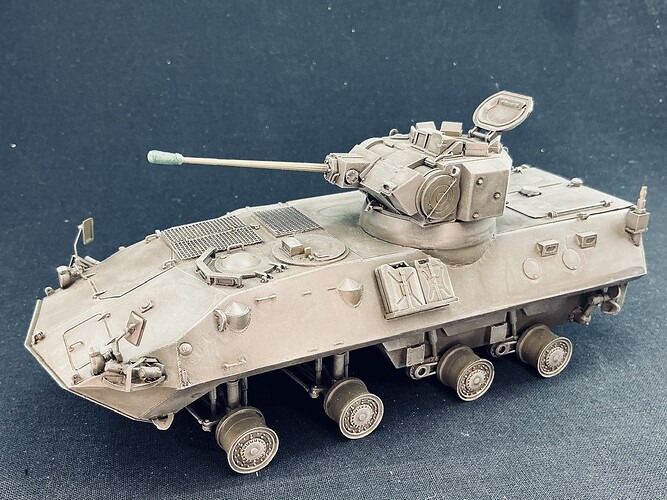

I finally did something about this model again ![]()
After the lighter patches had dried, I applied a wash of thinned Army Painter Strong Tone, and then did nothing for weeks … Tonight, I drybrushed the whole model with Revell Light Olive. I really need to finish painting it completely.
