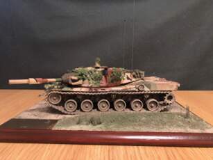

I’m actually a great fan of the MBT-70/Kpz-70 tanks. I haven’t yet built the Kpz-70 (Dragon) but I did tackle the Commander Models MBT-70 some time ago:
A Dutch variant would be great; I still have 3 x MBT-70s in the stash just awaiting that opportunity to update them in say, MERDC, NATO-flage etc(!)
