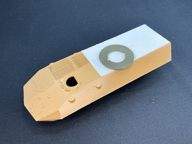

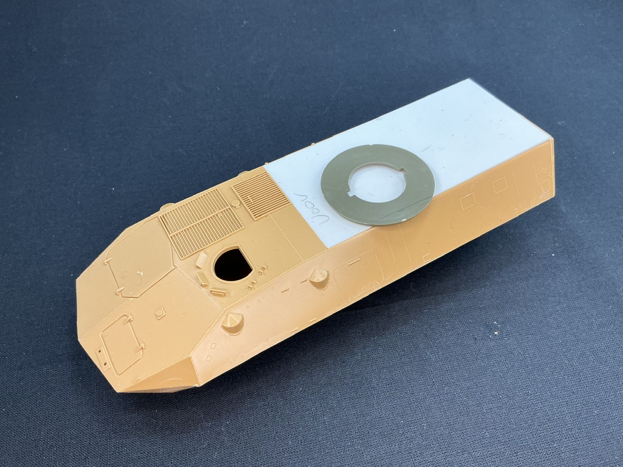

Put the three main hull parts together, and once they were dry, I cut a piece of 1 mm plastic sheet to make a new roof:
It’s still loose here, as is the AFV Club turret ring, but this is the position I will put it in. Piranha turrets tend to be offset to the left because the engine is on the right, and overhang the hull side a little if they’re more than very small, so that’s what I’ll do here too. It won’t be as big as on the trials vehicle, because I suspect that’s a standard Piranha that Mowag had at hand, fitted with an adapter for the YPR turret. A purpose-built version would probably have a bit smaller adapter ring.
Primer has had to be put on hold as I’ve added a few more details: small station-keeping lights (ET Models) which arrived today; I’d forgotten I’d ordered them. The tank identification light – facing rearwards on the turret rear, an antennae and mount, some small handles where I thought appropriate and last of all, a liberal application of model railway flock; this will represent mud once painted, after all, this is a prototype vehicle and will have been ragged over the training area, which is what I’m trying to represent. All wiring, where visible from either copper fuse wire or lead wire.
I was hoping to have it all finished for the show at Abingdon this coming Saturday, but I’m in danger of rushing it all (a relative term for me!) so tomorrow, primer and that’ll be that. I’ll still take it as a Work In Progress so it will hopefully, still generate a bit of interest from the modelling public.

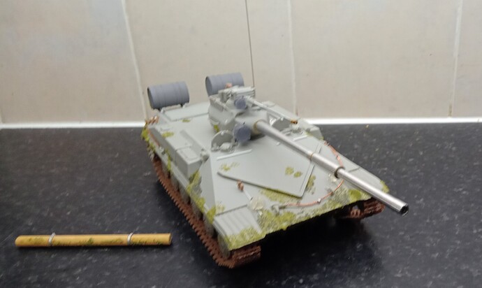

T-74 in primer - at last!
Better watch mate - those Russkies have invaded your kitchen!
These days they get everywhere.
…except Kyiv. :rofl:

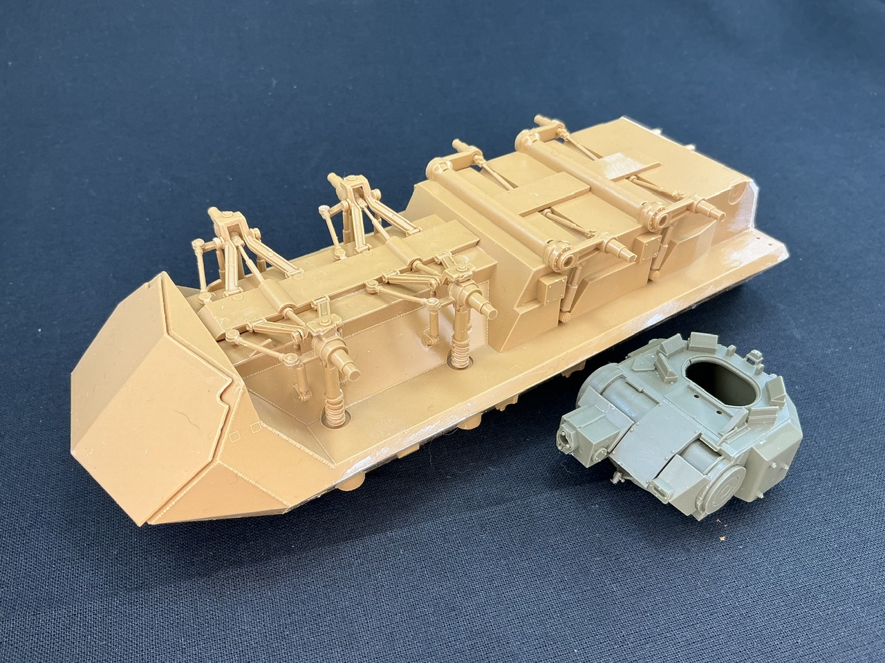

Suspension installed:
This wasn’t too easy, because the part with the suspension arms for the front two axles doesn’t fit overly well. I got it nicely in place using some clamps and a bit of wood, but it would probably have been easier if I hadn’t glued the hull halves together already, because there would have been a bit more flex in the lower hull then.
The turret is just the main parts, the details still need to be added.
Are you going to give it white fender edges for a parade dress? I think that’d add some character…
That’s shaping up, Jakko!
Not with all that clag scattered all over; however, a parade finish for a Soviet tank is always a good look - though I’ve never actually done one.
