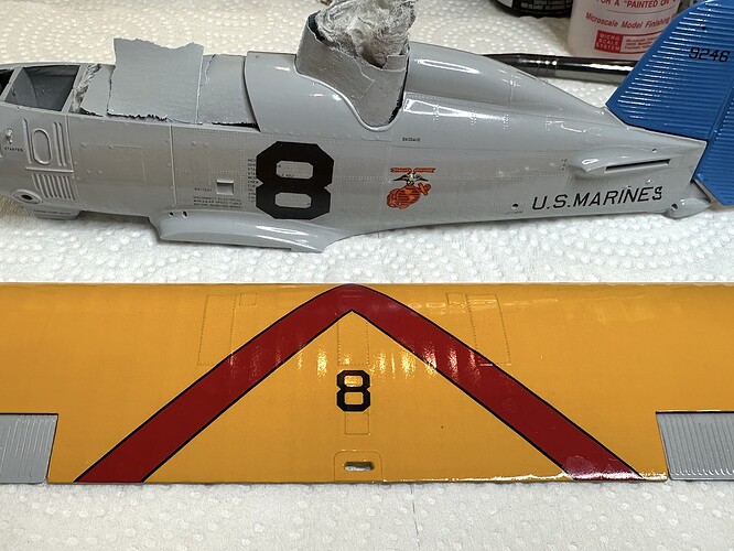

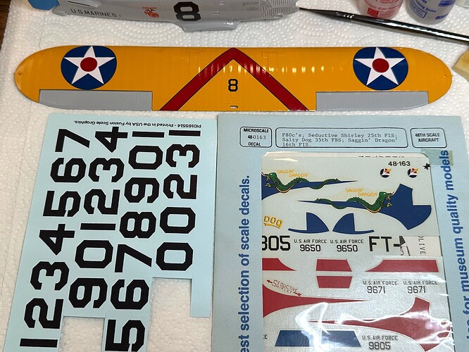

After getting the decals on the model and being very happy with all but the fold I shot a coat of Tamiya rattlecan gloss over all to seal the decals and prepare for a pin wash. All looked great except for the wings with the roundels. Those erupted with little blister like deformations. None of the other decals, even those from the same sheet had the issue. They were so fragile that masking tape removed sections of them. I got as much off as I could with tape and Micro Set which calls itself a decal remover. It didn’t touch these!
I got as much off as I could with tape and rubbed the area smooth with fingers and a cloth. New decals (I have plenty now) were applied with Micro Set. After waiting a day, I washed them with plain water and a soft sponge.
I shot the wings with Tamiya semi gloss out of a rattlecan, this time with no issues.

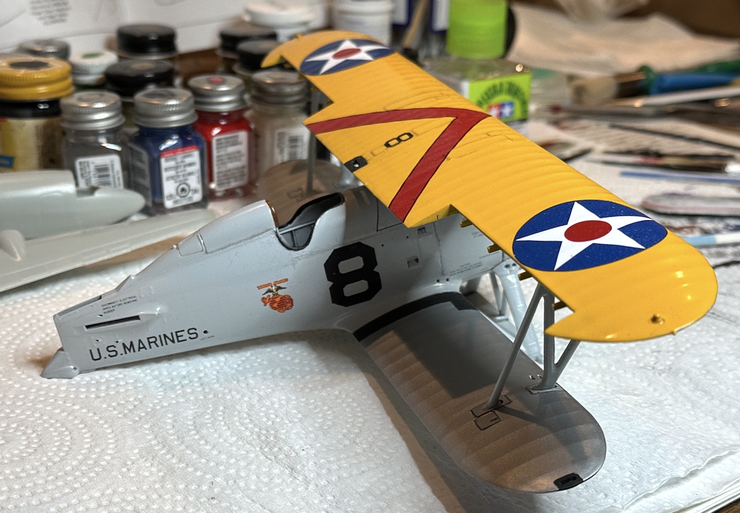

Interesting issue – My reference book has large beuatiful pictures of many F4B details including factory shots showing the top & bottom wings. These pictures show how Boeing painted the surfaces.
The text below the picture of the top wing mentioned that ALL metal panels were painted the same light grey as the fuselage. I took that to mean the ailerons too and painted mine light grey. That looked odd to me as all models I have ever seen show them painted the same yellow as the top wing. After a bit, I came to like the contrast.
The Yellow Wings sheet mentioned that the ailerons were painted yellow both top & bottom. I had another close look at the pictures trying to sort out the tones of grey in the photos. Yes, the top wing & ailerons were yellow just as the decal maker says. They have now been repainted in the yellow.

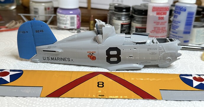

Here is one last shot showing the damaged decals on the wings.

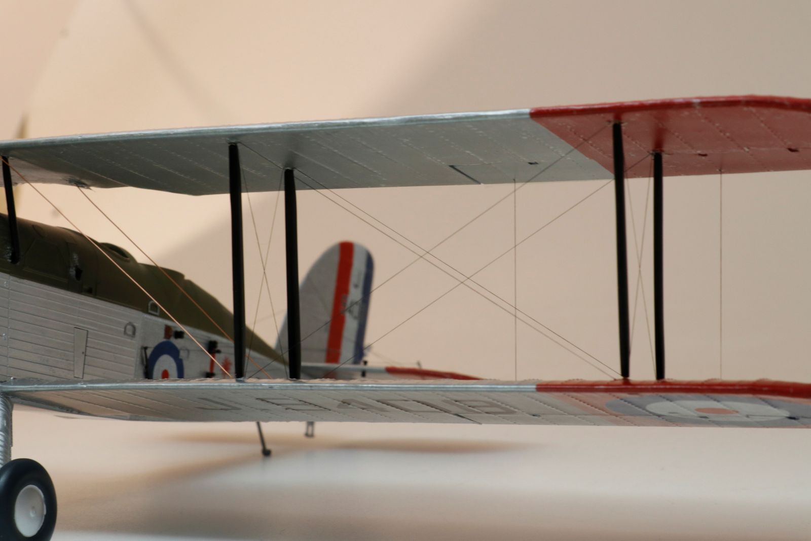

Finally got the Wapiti to its correct stance, fitting the tail skid and rudder.
And the process of rigging began, fitting the flying wires guides.
The rigging is finished on the rear of the plane now.
Wings next and then the final fit out.

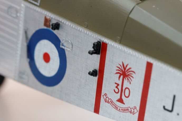

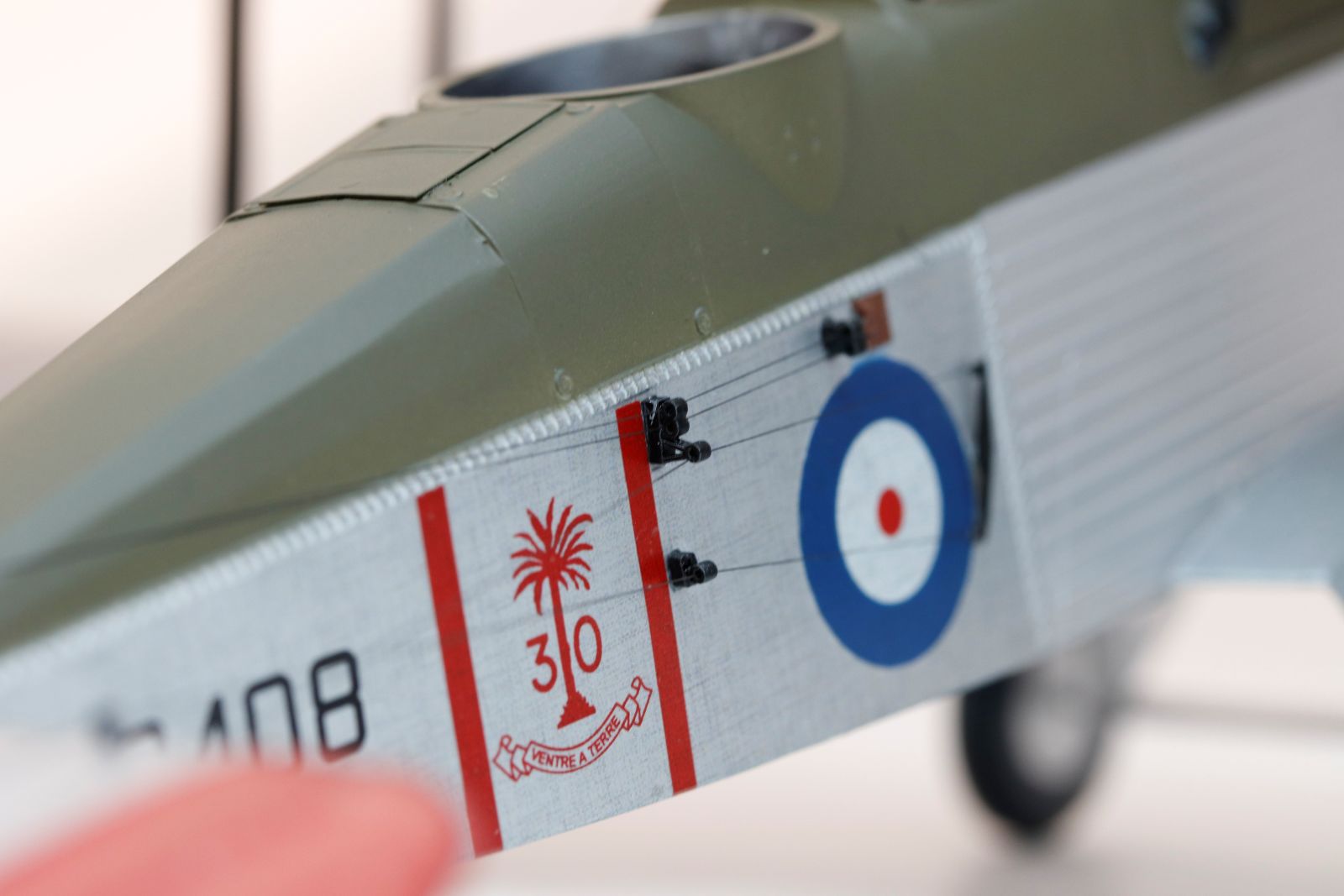

That looks properly good. I could never do this level of detail due to having tank crewman levels of dexterity and finesse. I really like the decals also. They look like they’re painted on.
Thanks for that. The markings are a mix of decals for the numbers and finer details and the roundels and stripes are painted. On the rear of the fuselage the plane was half aluminium and half linen, so the lower half is cover with a transparent linen effect decal.

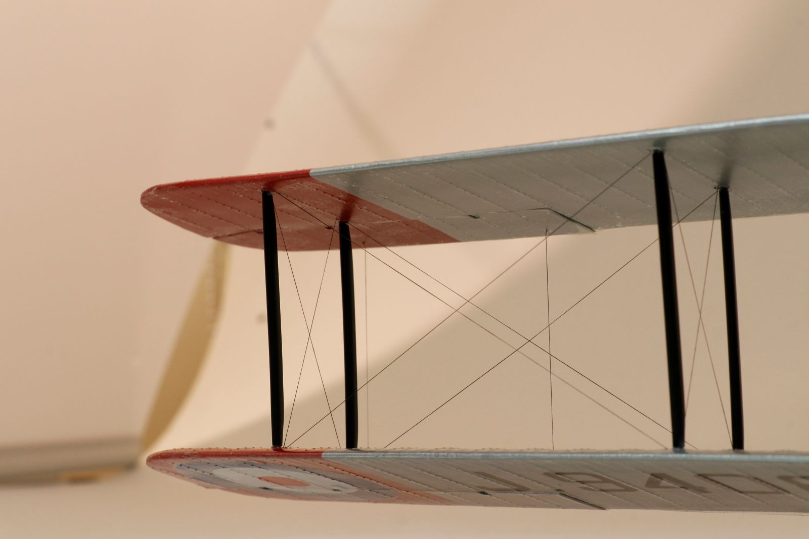

The two outer bays are now rigged. It was slow going but at least its progress.

I can see it would be slow going but it looks terrific. You choose a challenging subject and that gives the rest of us courage to do the same. Good on you!

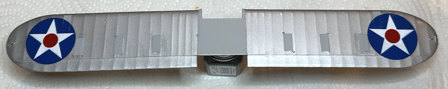

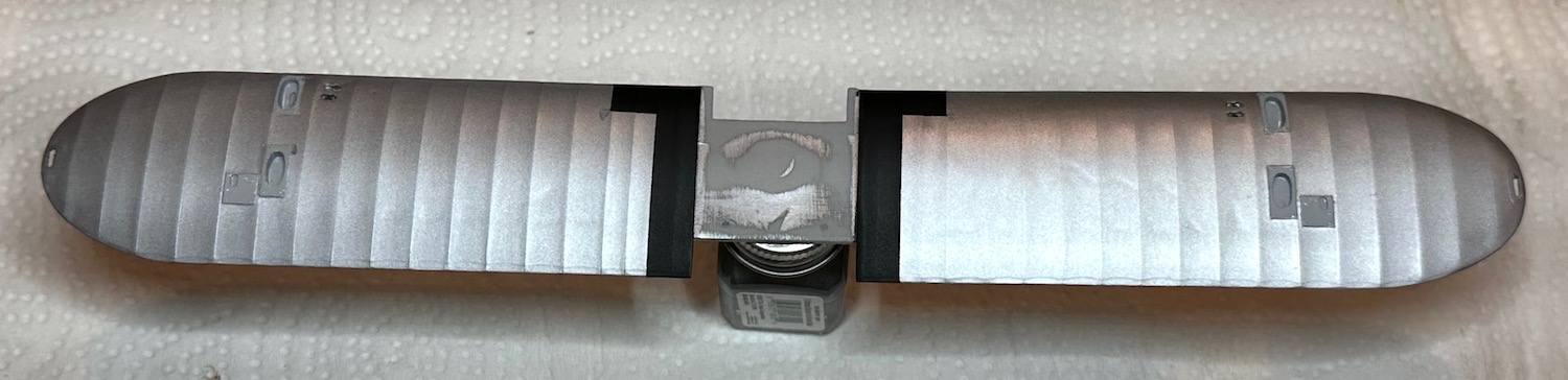

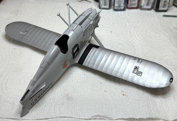

I have been working on the 1/32 Hasegawa Boeing F4B-4. Earlier, I showed how plastic card stock was used to narrow the gap between the lower wing & the fuselage. It seemed perfect but after paint and being completely ready to install, a gap appeared. Drat! A bit of sprue was used to spread the fuselage very slightly. Now it fits perfectly.

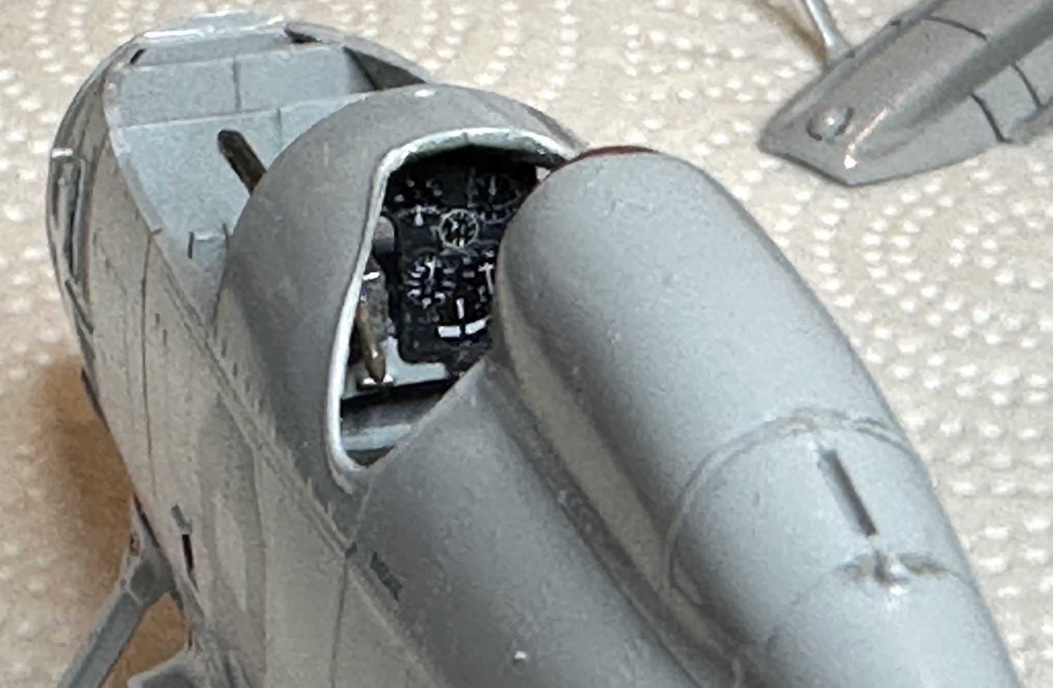

For some reason, the instrument panel with its individual gage decals was not photographed prior to closing up the fuselage halves. Now its kinda hard to see.

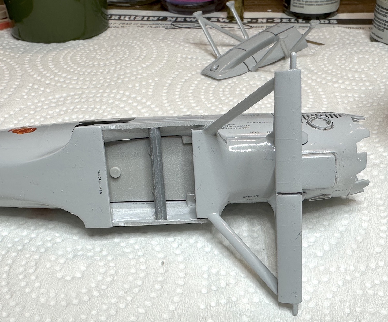

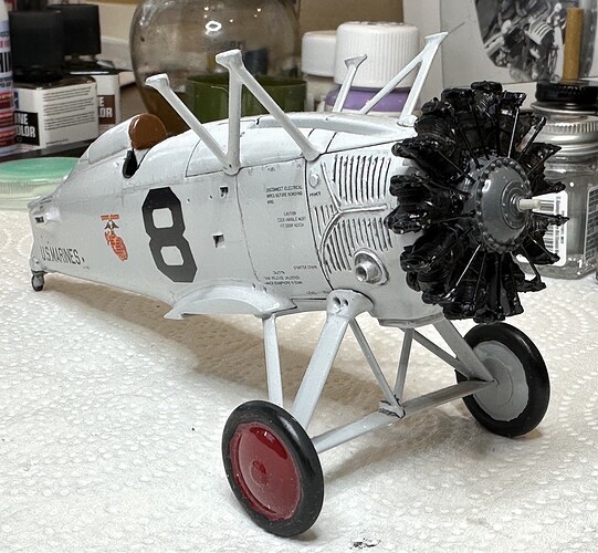

Another trial fit of the engine to make sure everything was right. It wasn’t and a distance piece was made to give the inlet pipes some room from the serrated fairing behind the engine.
Its starting to look pretty neat now.

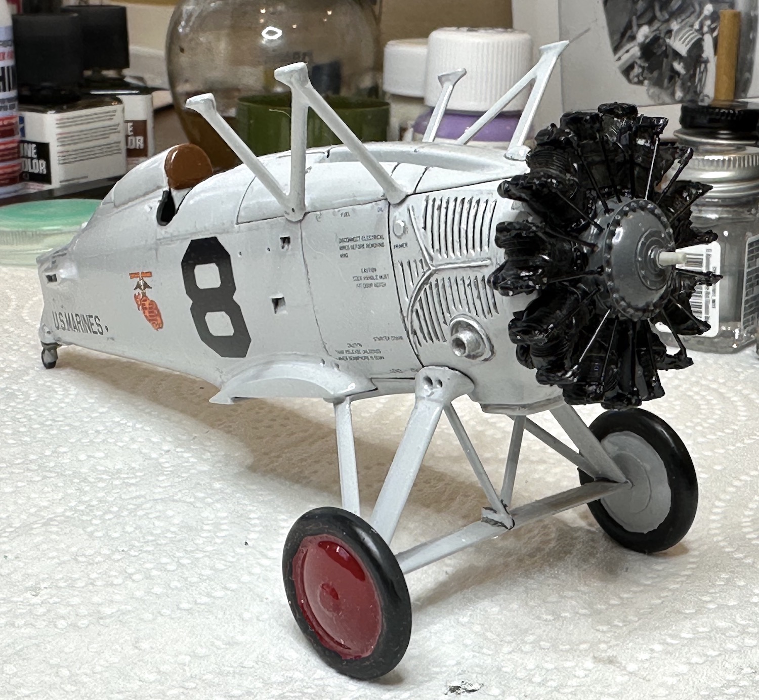

More pictures of the F4B ready to rig. I left off as much as possible to leave as much room as possible to struggle with the rigging.
