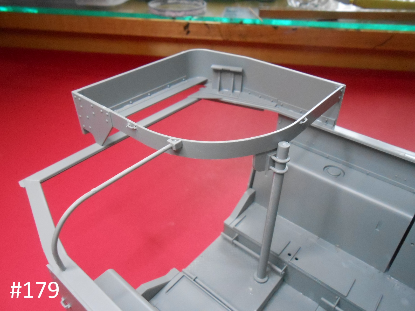

Well to continue on,

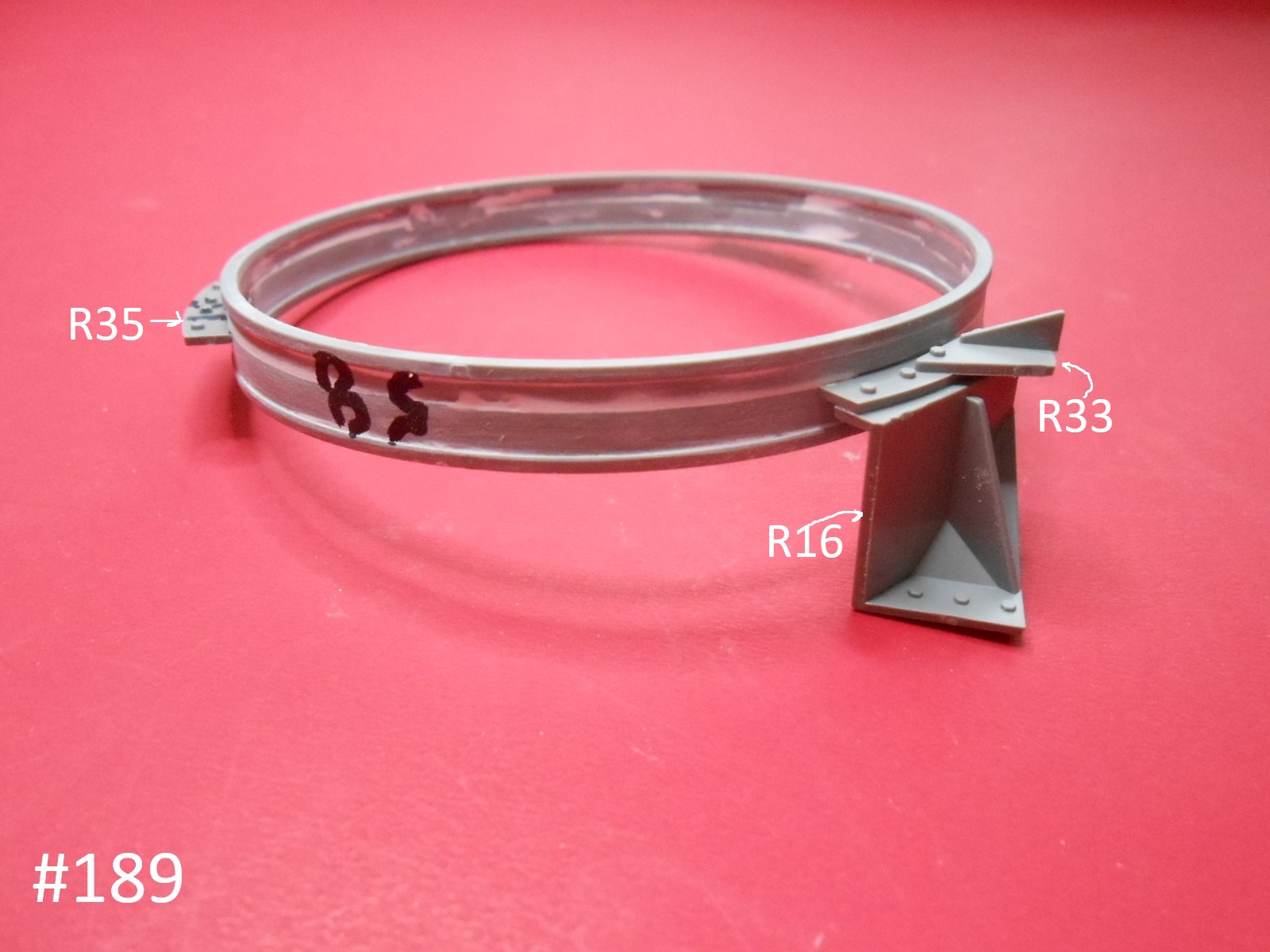

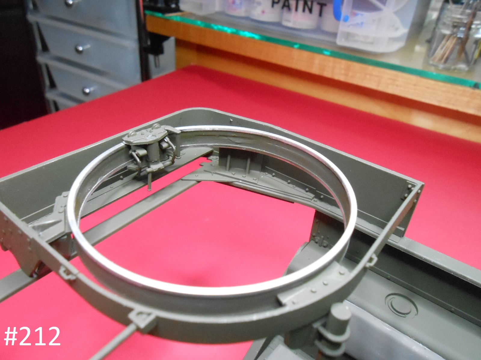

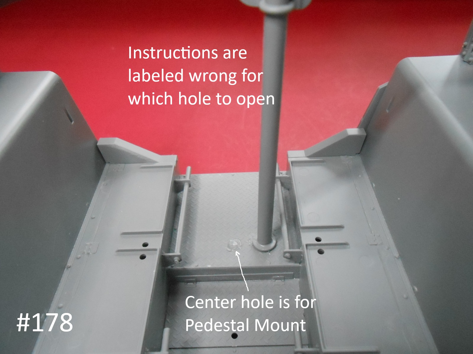

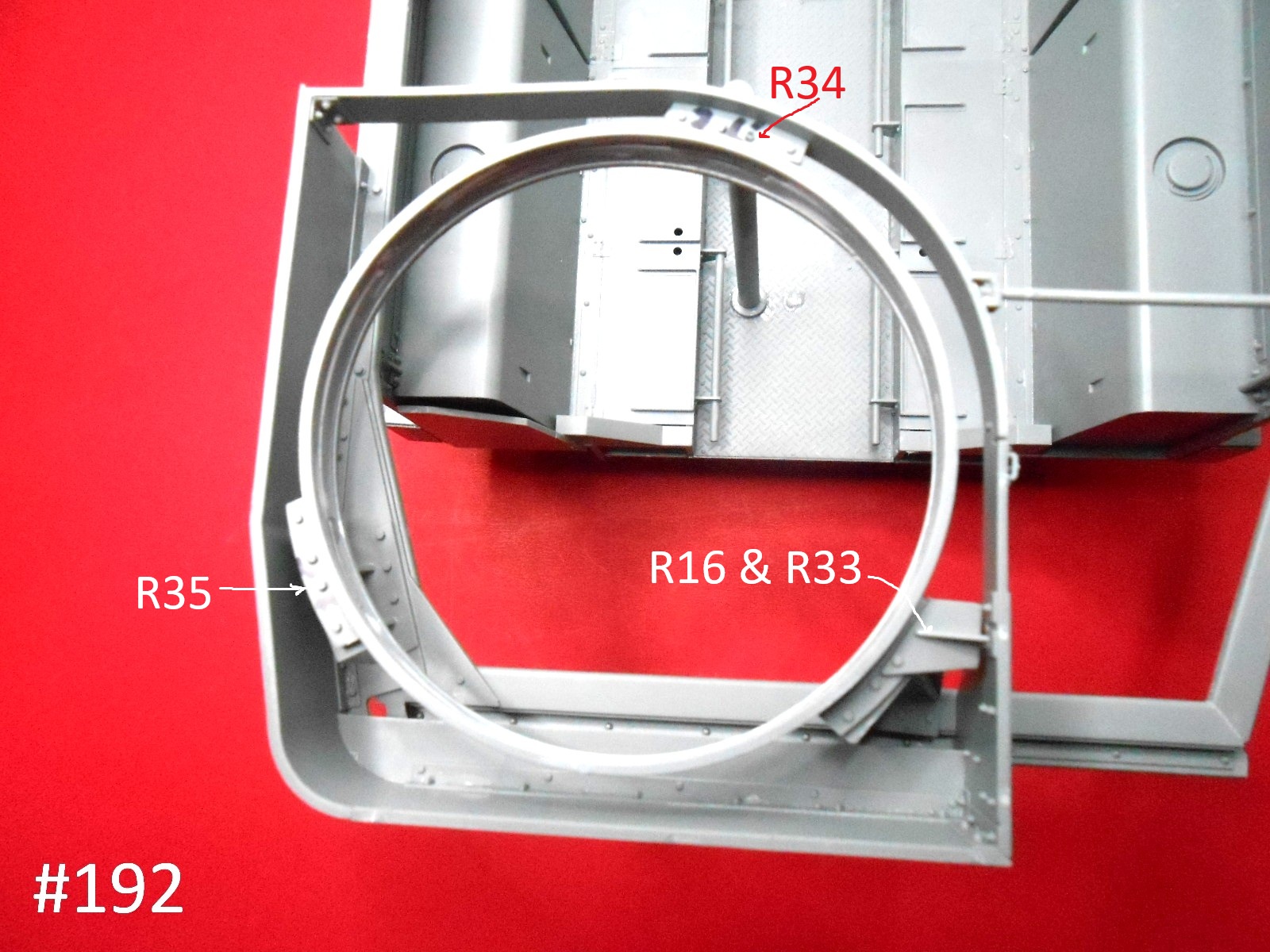

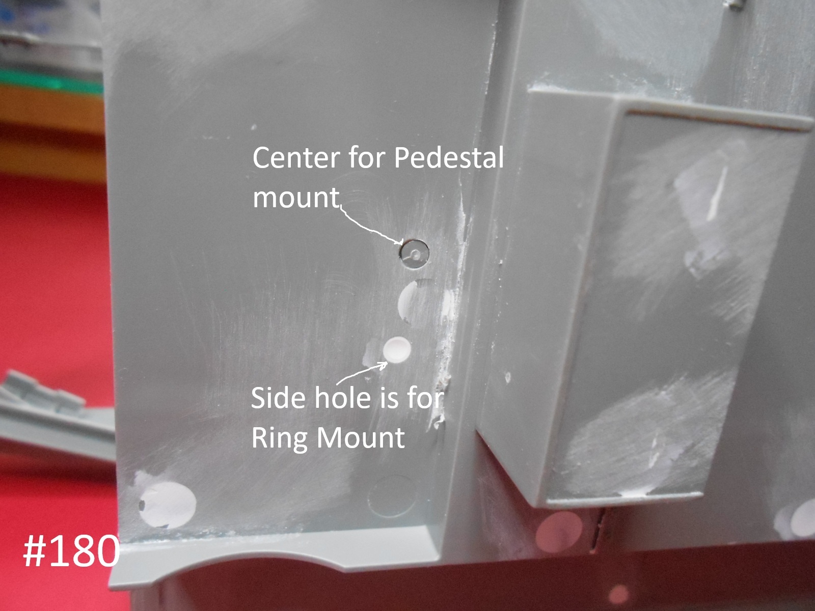

Since I am going to be using the Gun Ring mount I opened the Hole in the Deck, the Instructions have the holes mixed up. The Center hole is for the Pedestal mount and the one to the side is for the Ring Mount.

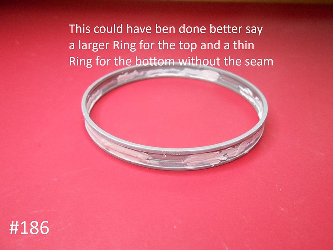

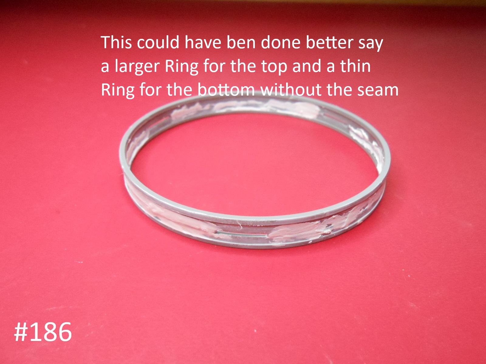

Now to sand down that darn Ring mount.

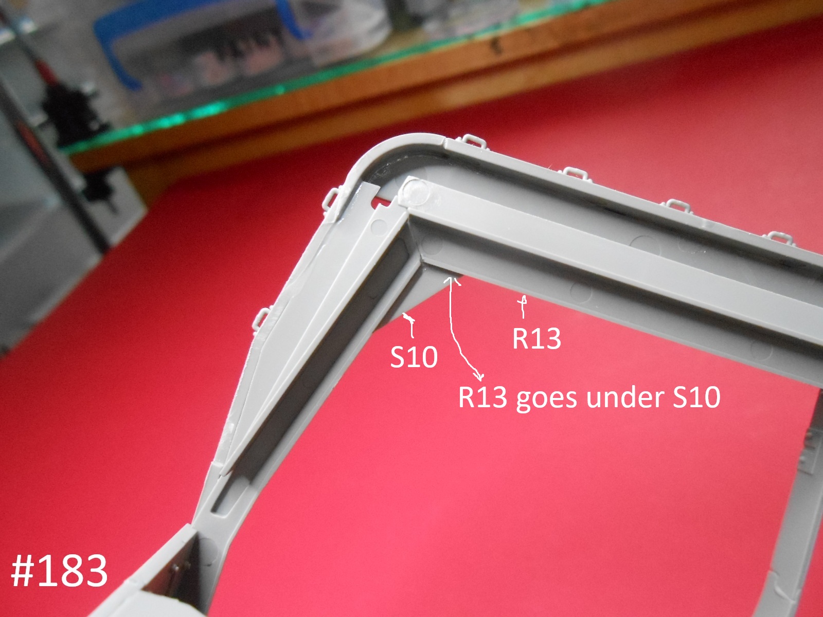

Progressing well Donald.

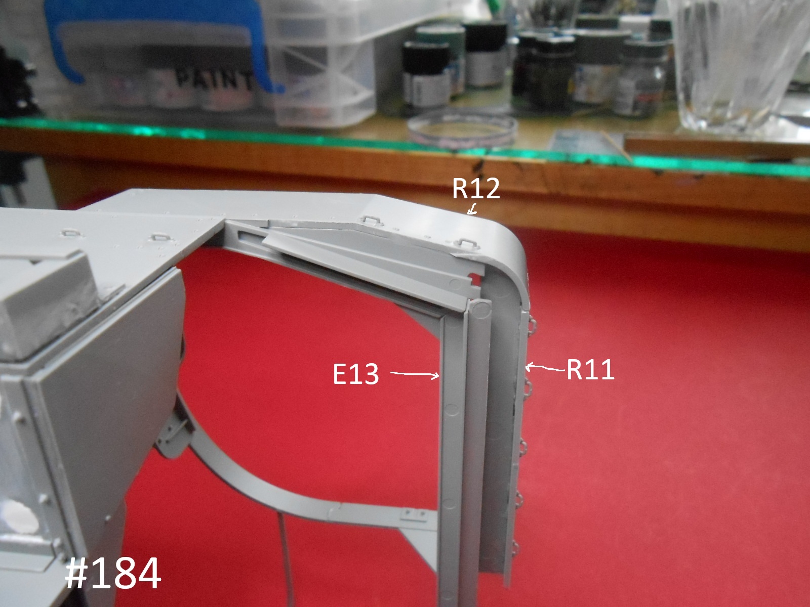

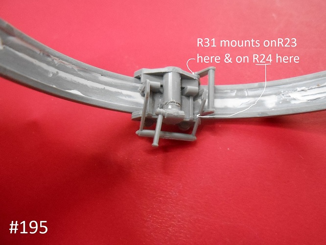

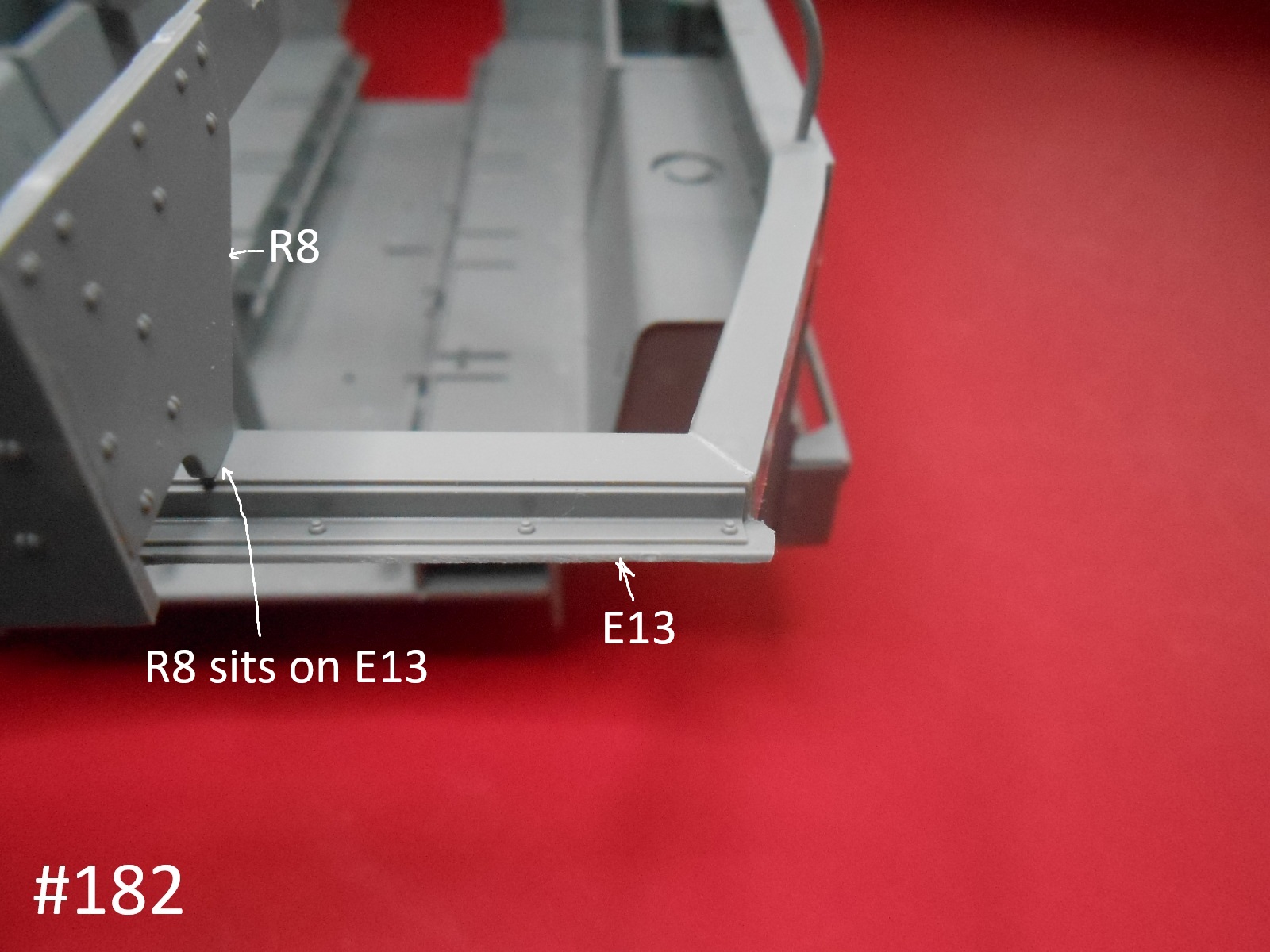

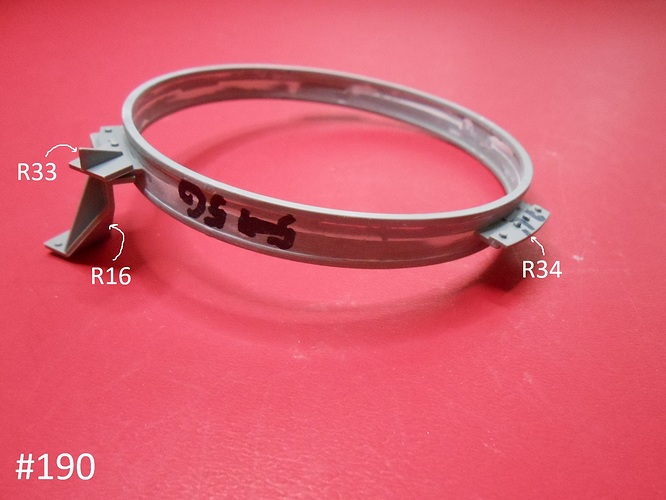

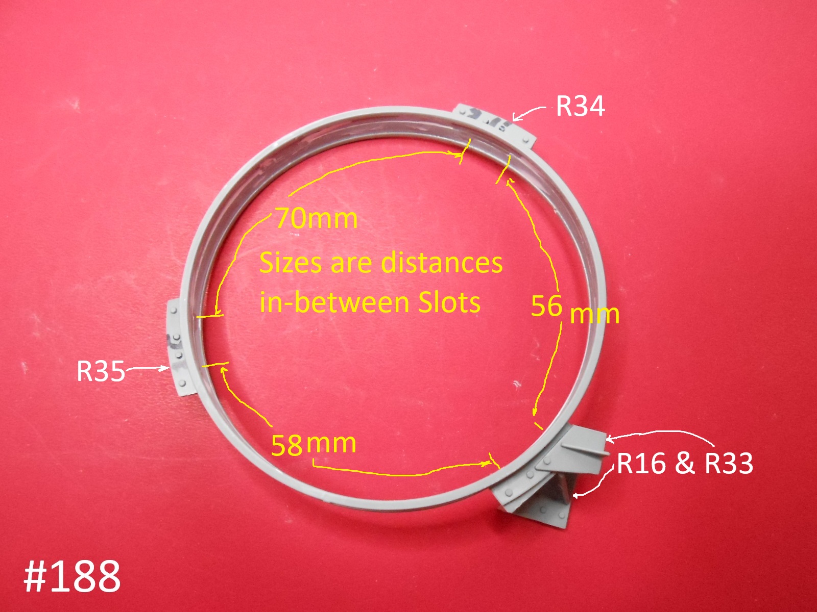

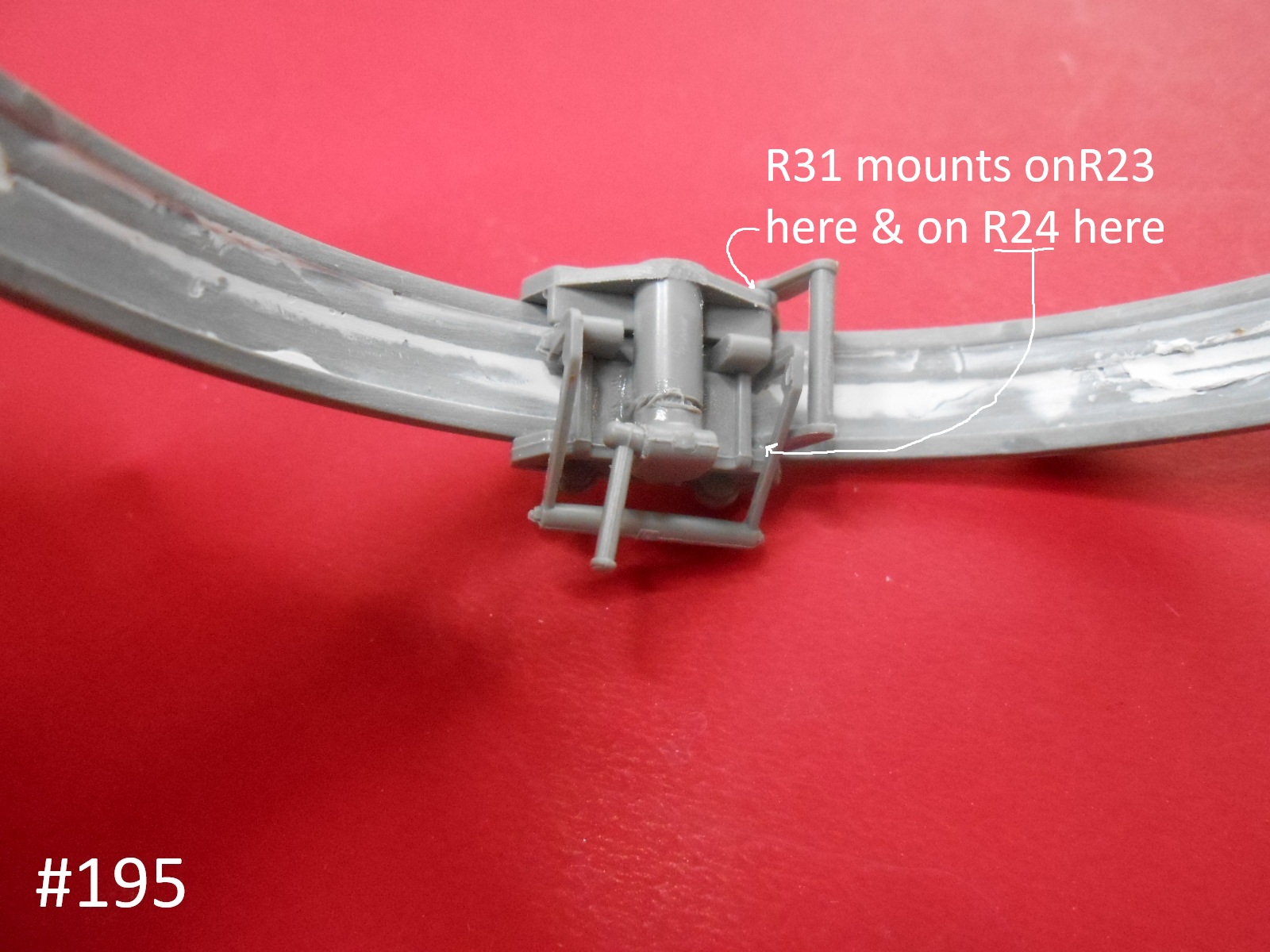

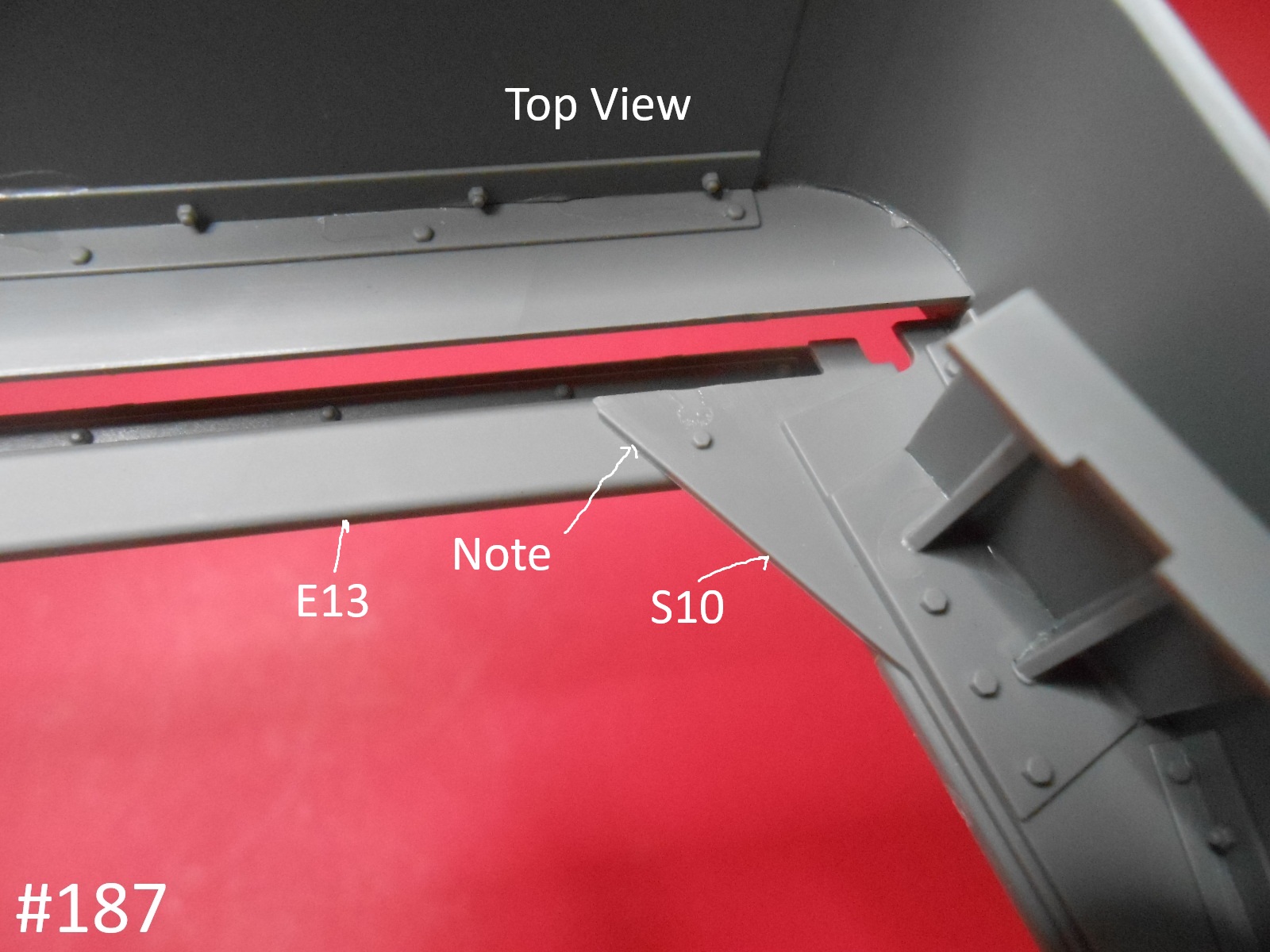

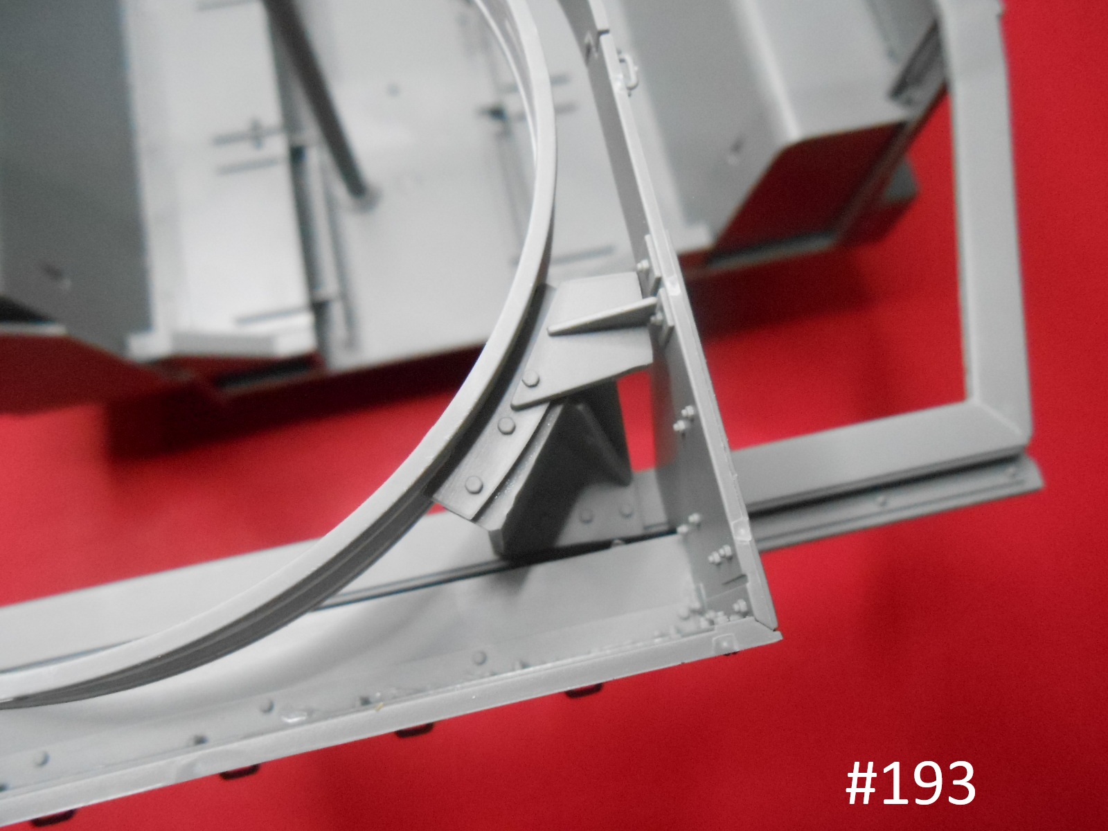

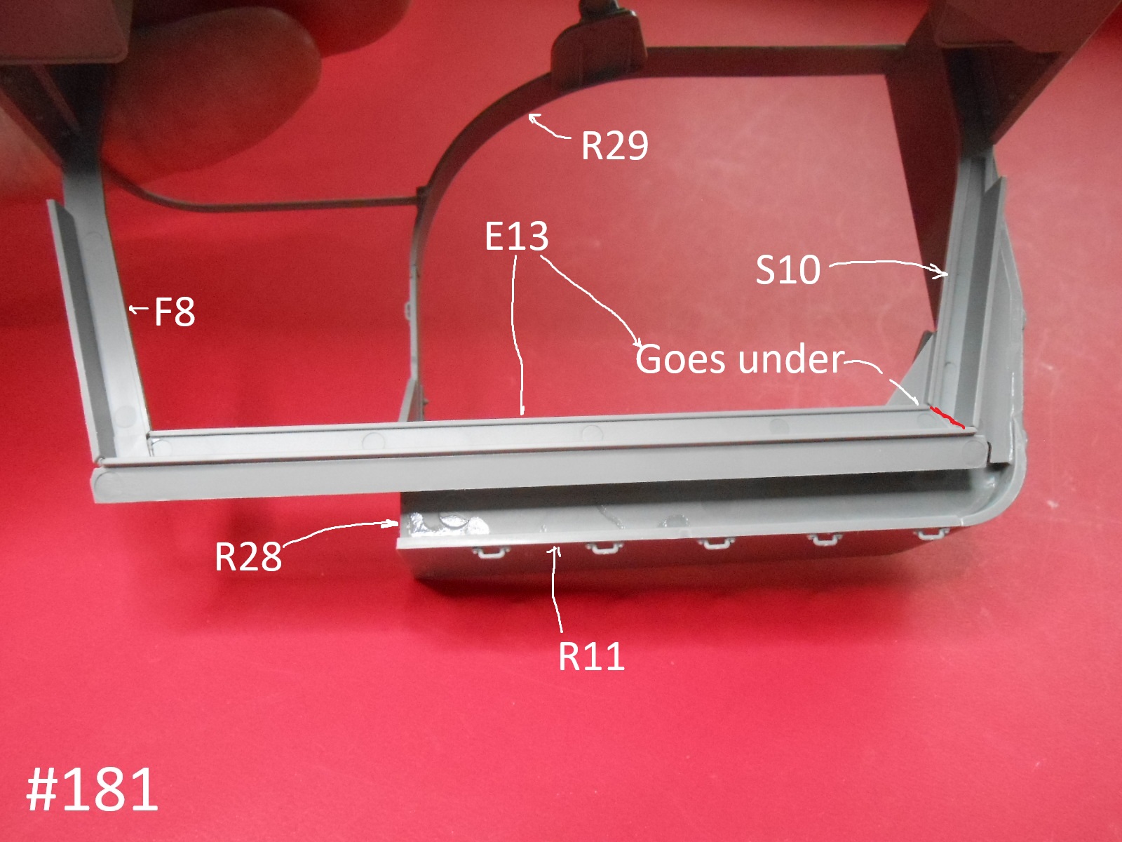

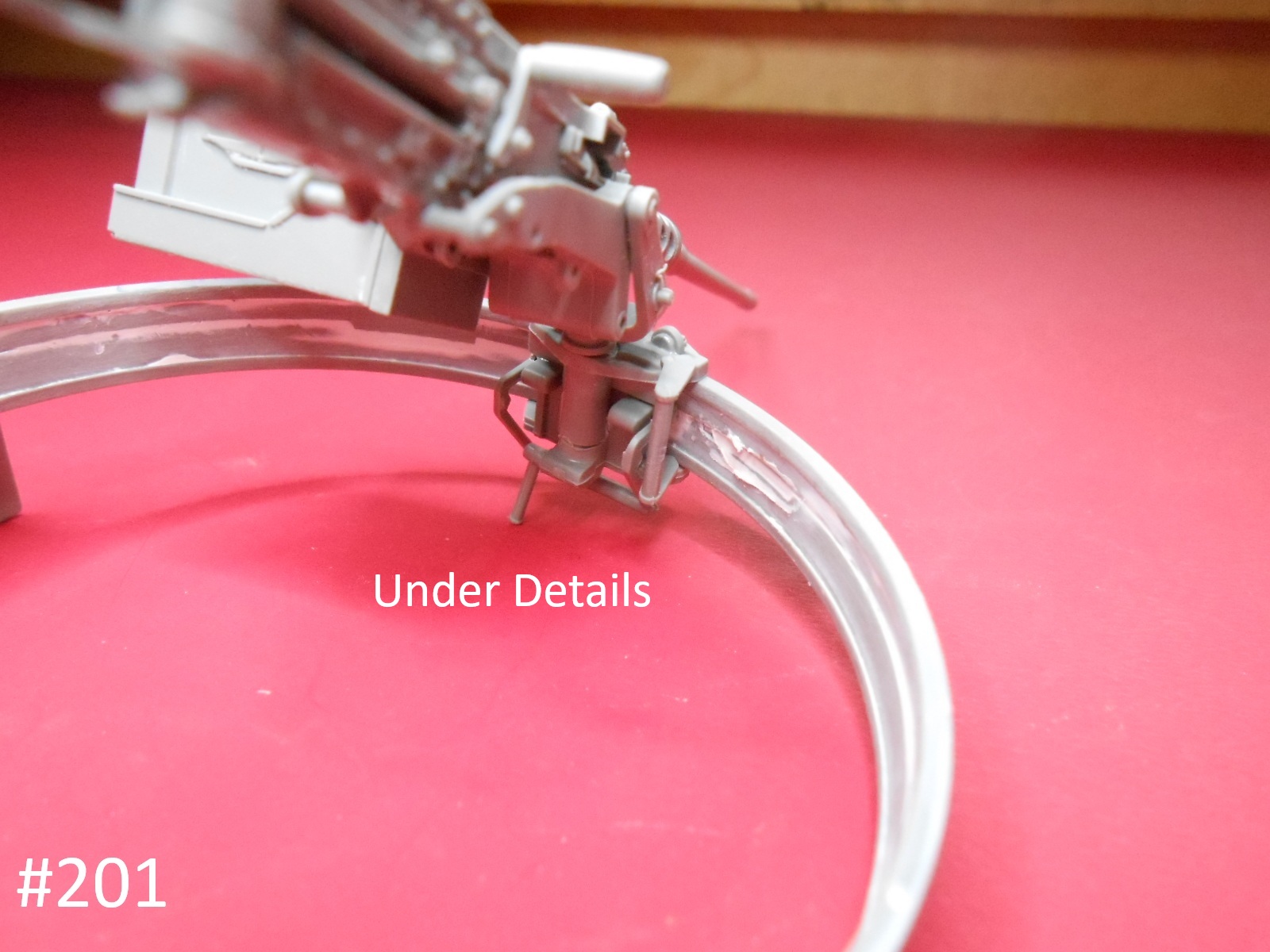

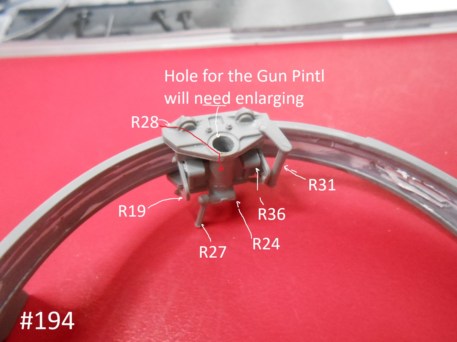

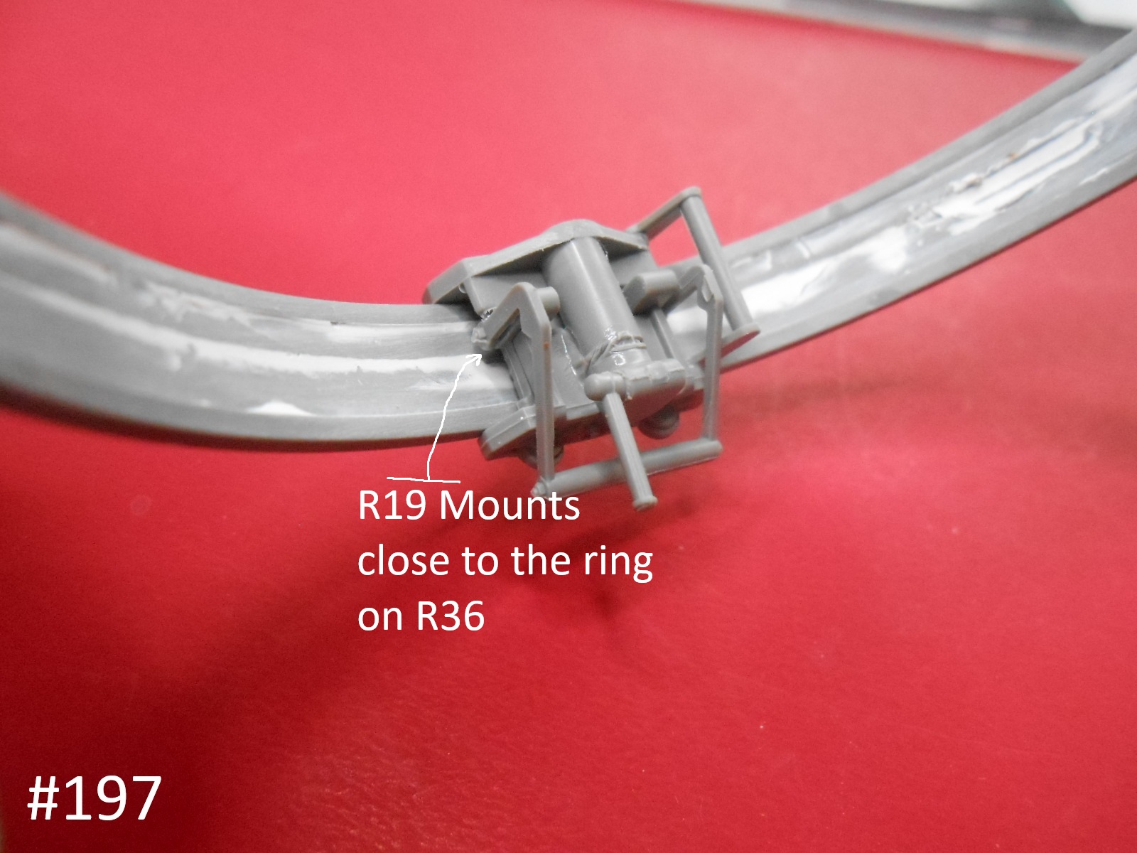

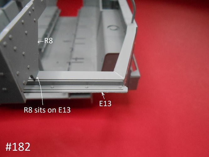

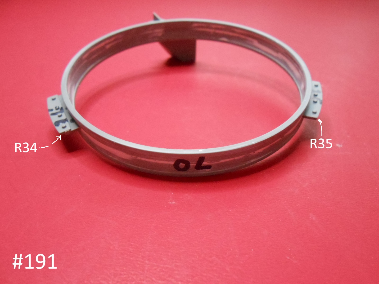

Yes the ring mount is a pain in the rear and could have been better thought out I agree. A bit of head scratching assembling the various parts at this stage too. I managed to get part E13 on upside down but realised before the cement set. Fitting the ring itself is a pain too as the slots for the mountings only fit one way
And the distances in between them vary , Well here is how I did it, I hope this helps someone.
Now to putty up and sand where the tabs came through the slots then to fit the Gun mount.
Regards
Donald

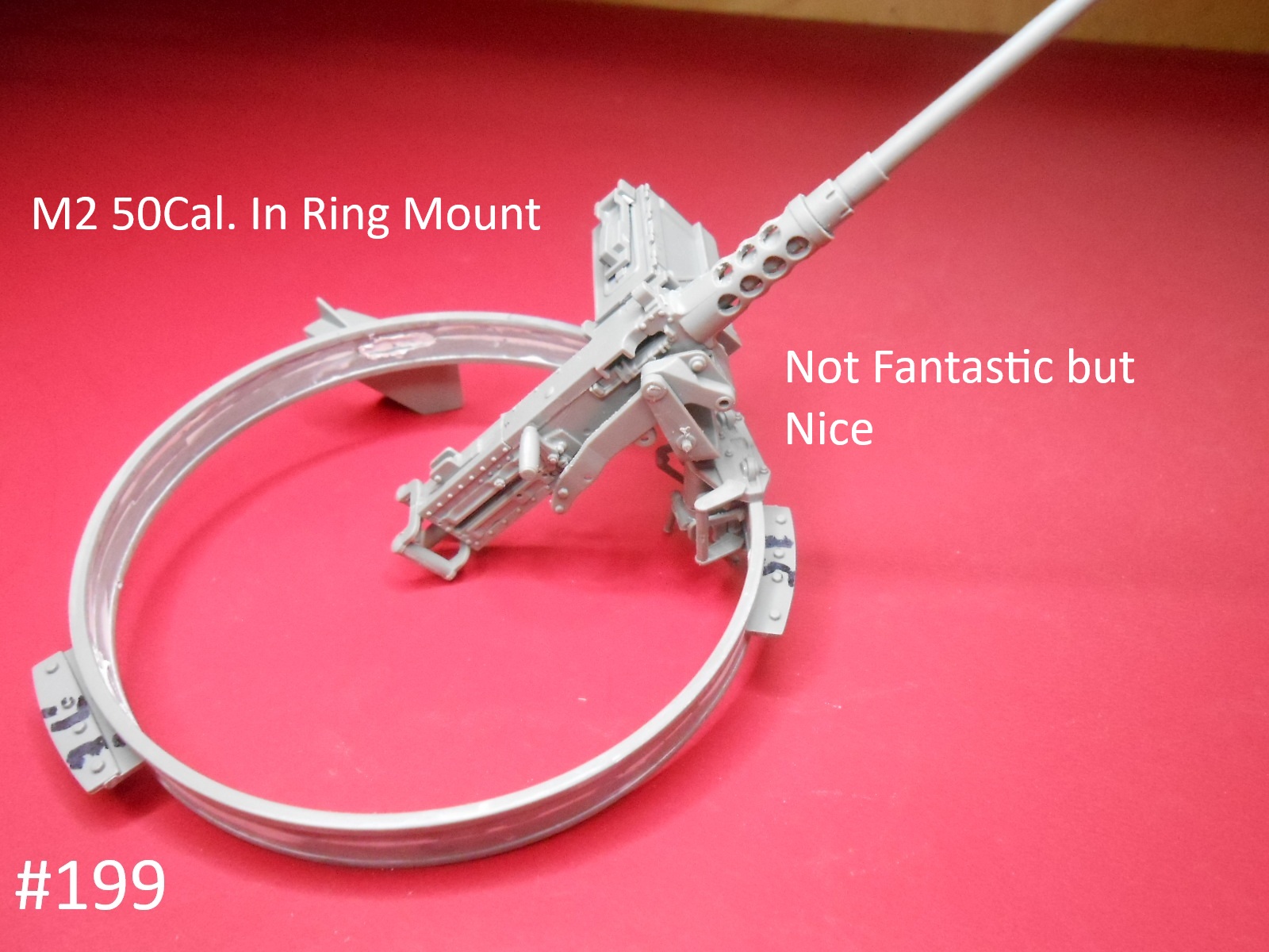

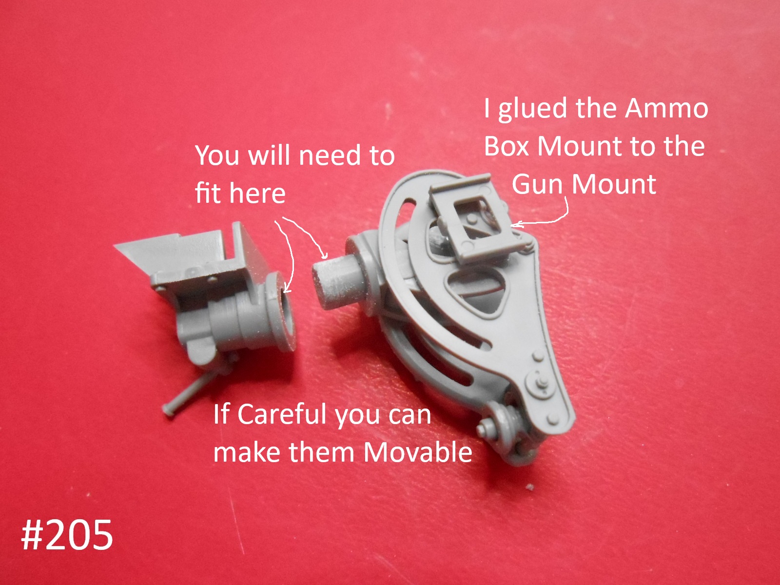

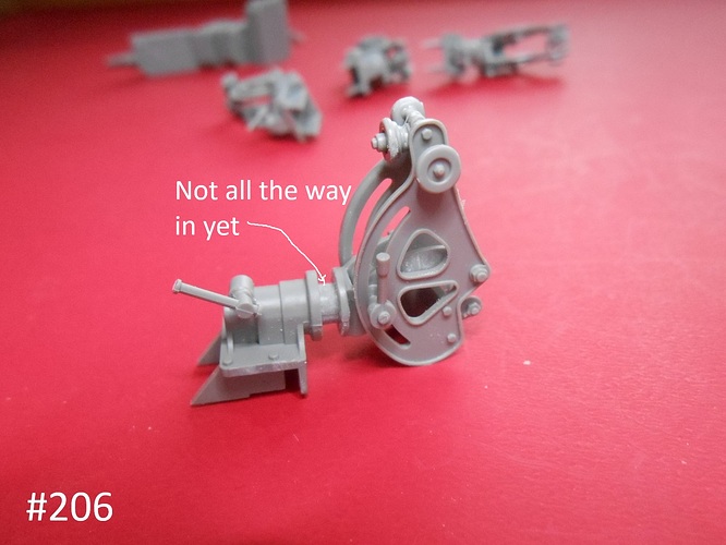

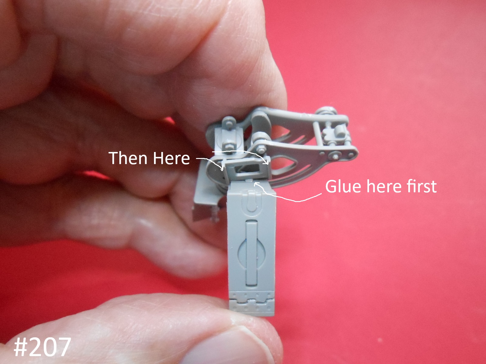

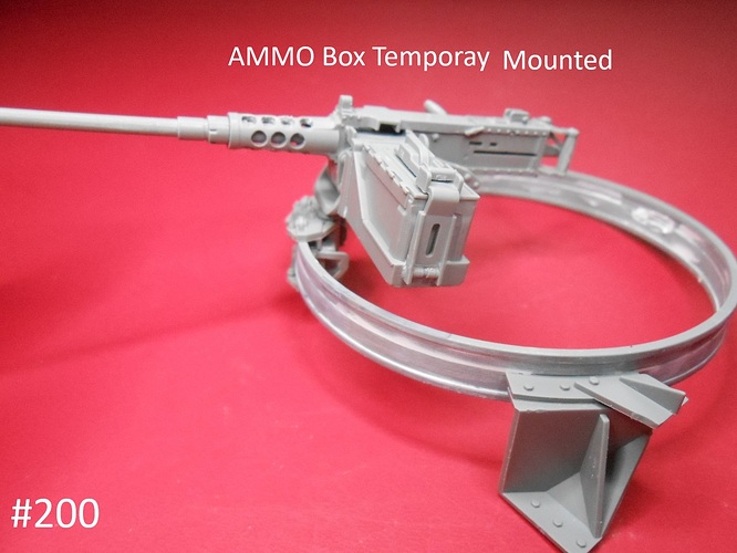

Well Yesterday I showed how I did the Gun Ring, and today it’s the Gun Mount that goes on the ring. I hope this helps someone.
Finished for now.
Donald

In regards to that ring, if you have a small, stubby curved exacto blade, it may help remove some of that filler on the inside of that ring. Just gently scrape along, pretty much using it as a sanding stick of sorts

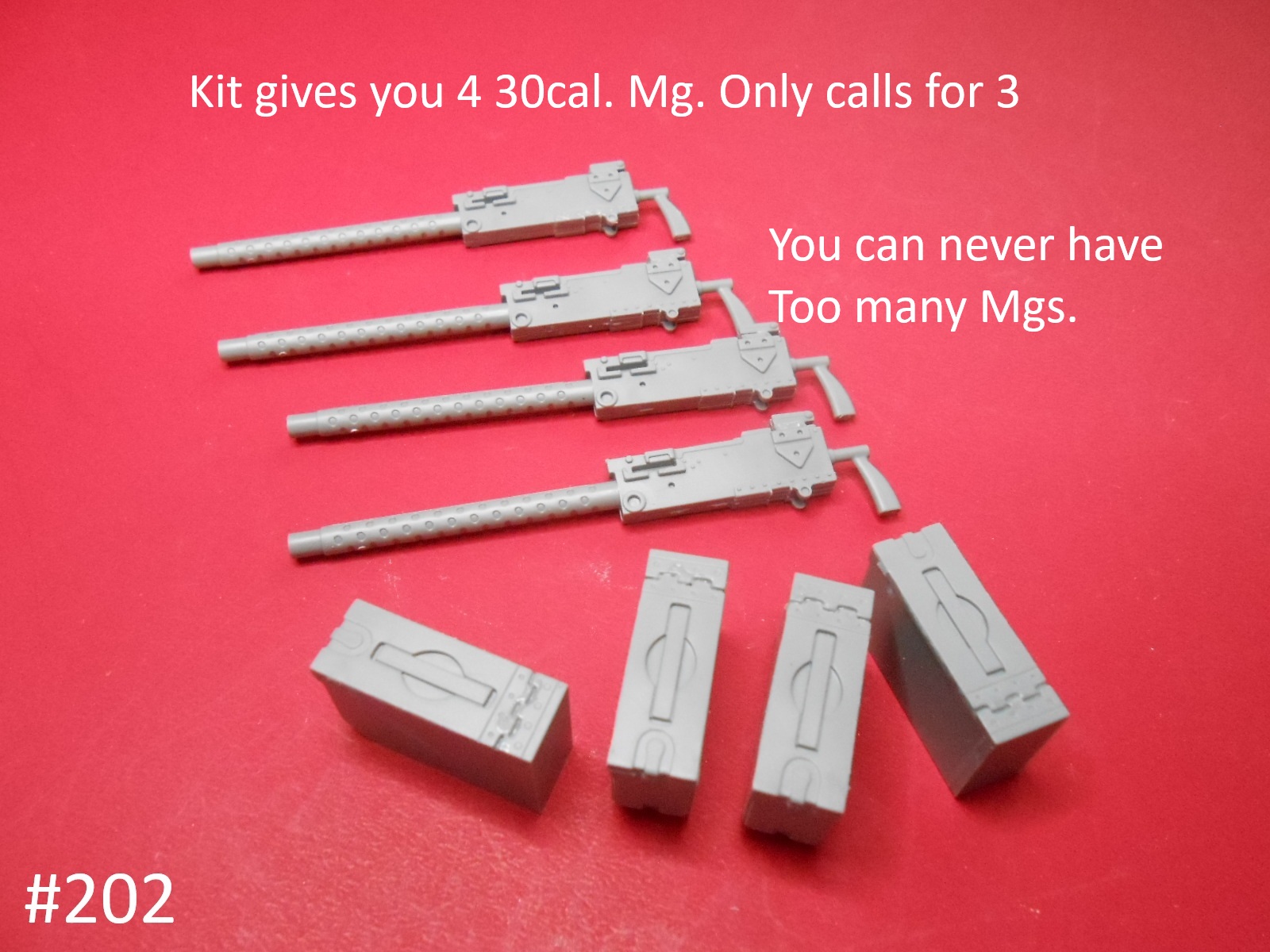

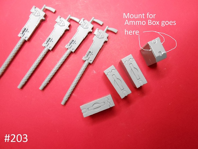

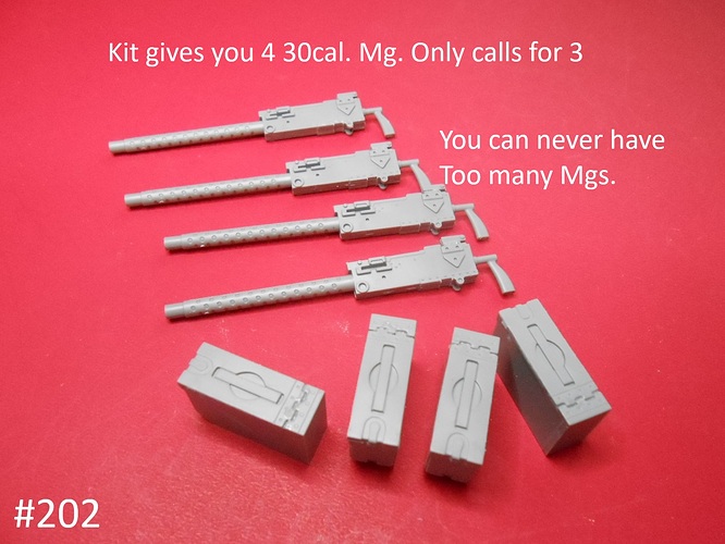

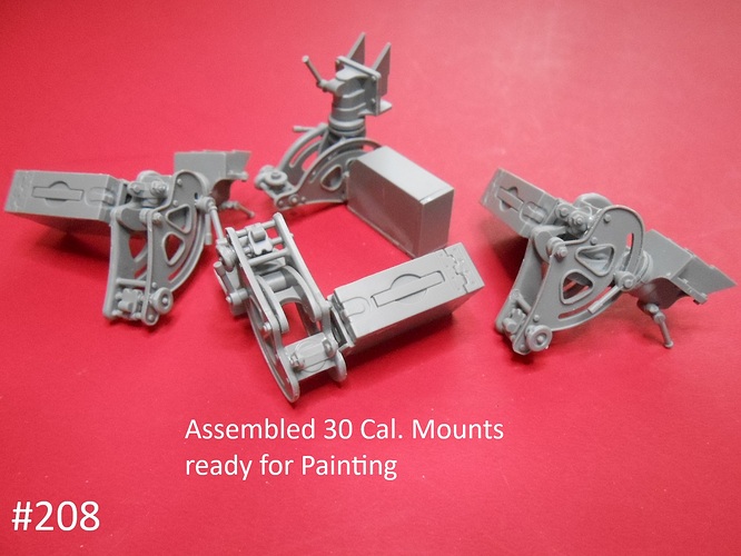

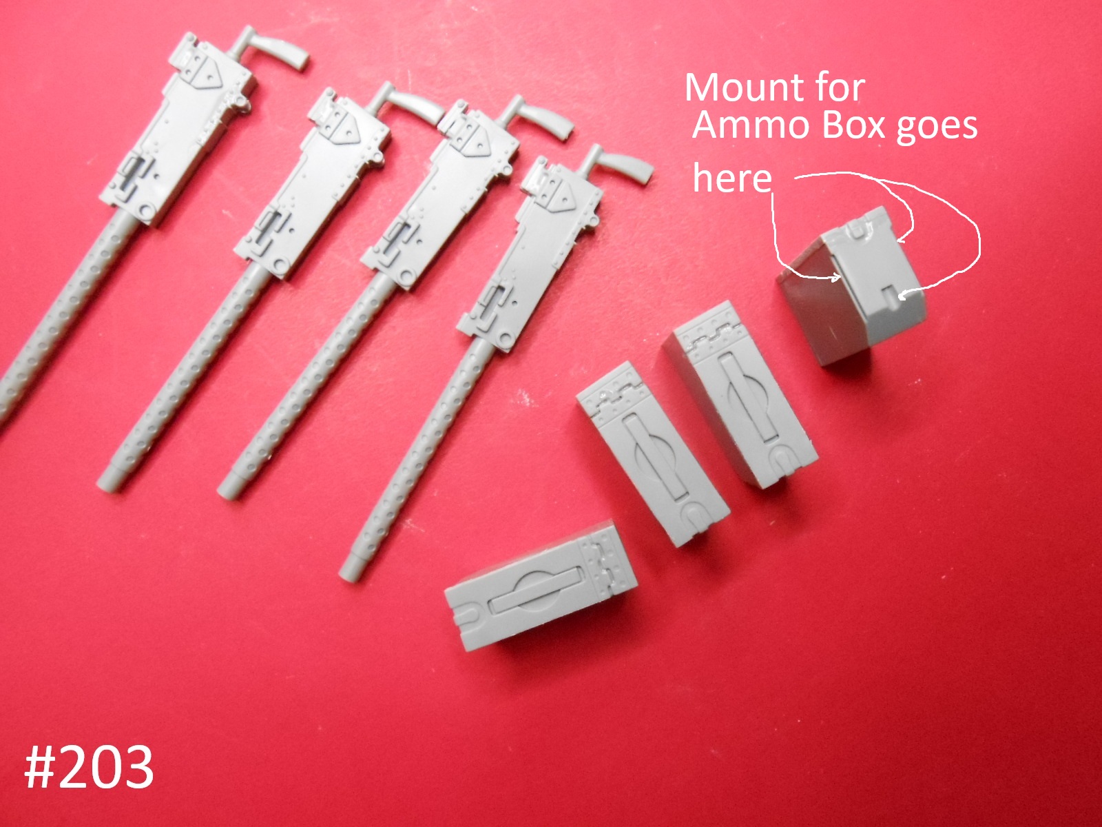

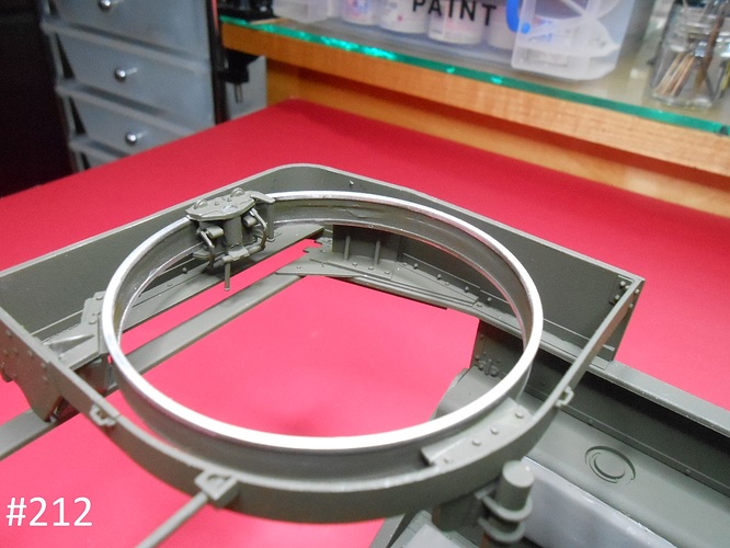

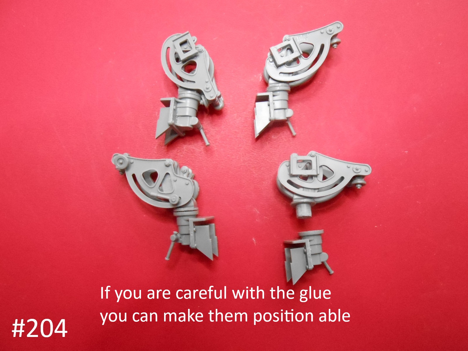

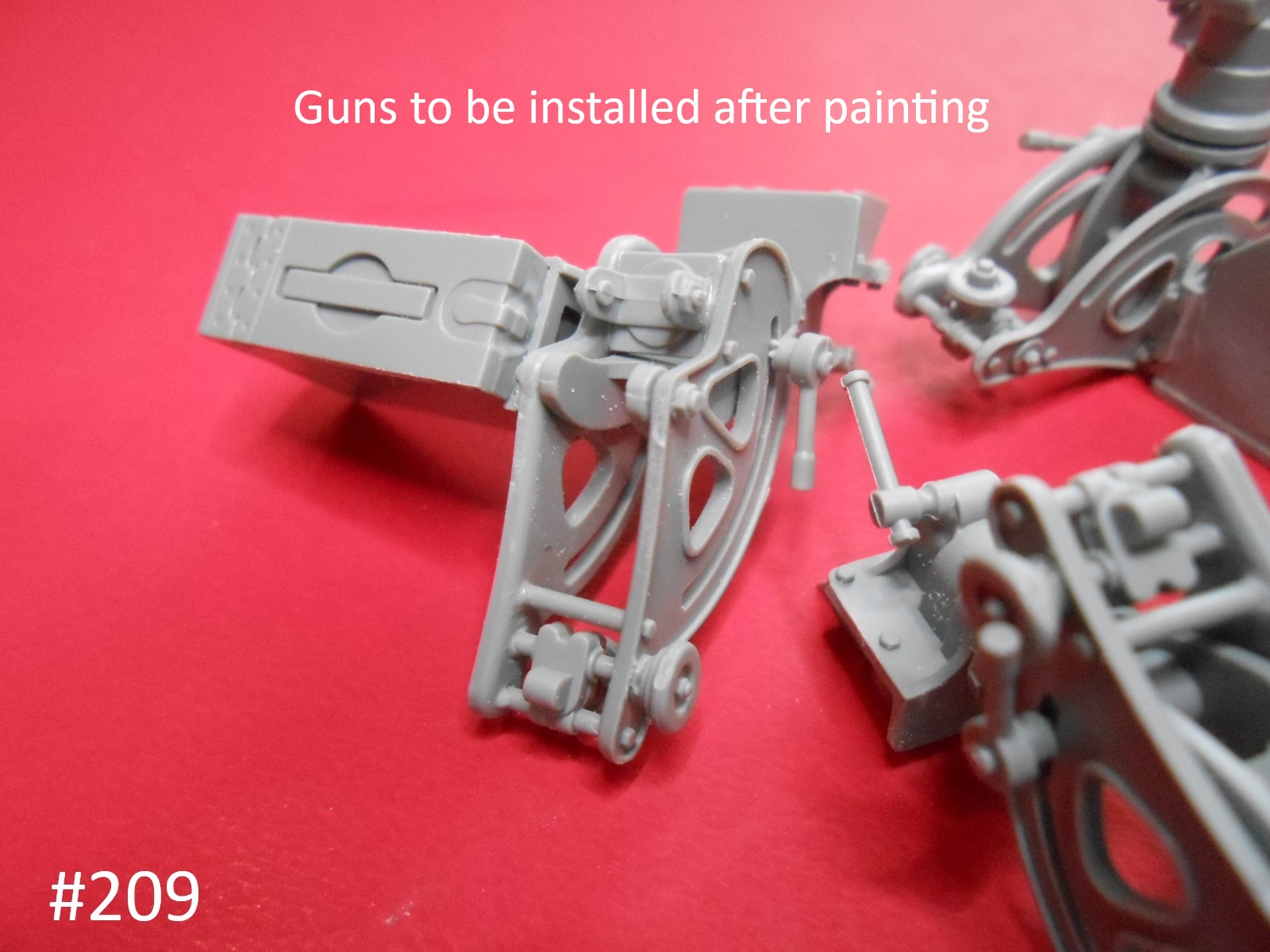

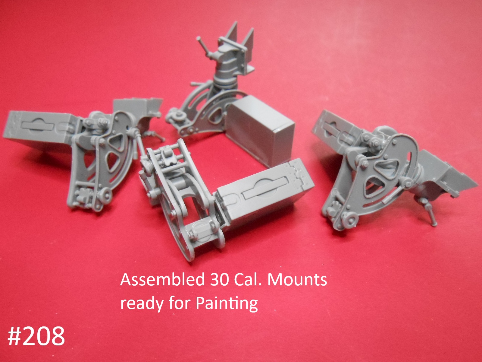

Today I have the Mgs. assembled.
Finished for now

@ Donald (oldwarloke)
Those MGs look great — interesting mini-kits on their own. Thank you for posting. Keep up the great work!

For the MG ring, my attempts to putty the seam between the upper and lower rings was unsatisfactory. I ended up covering the entirety with 0.005" styrene strip. Under a coat of paint, I’m glad I went this route.

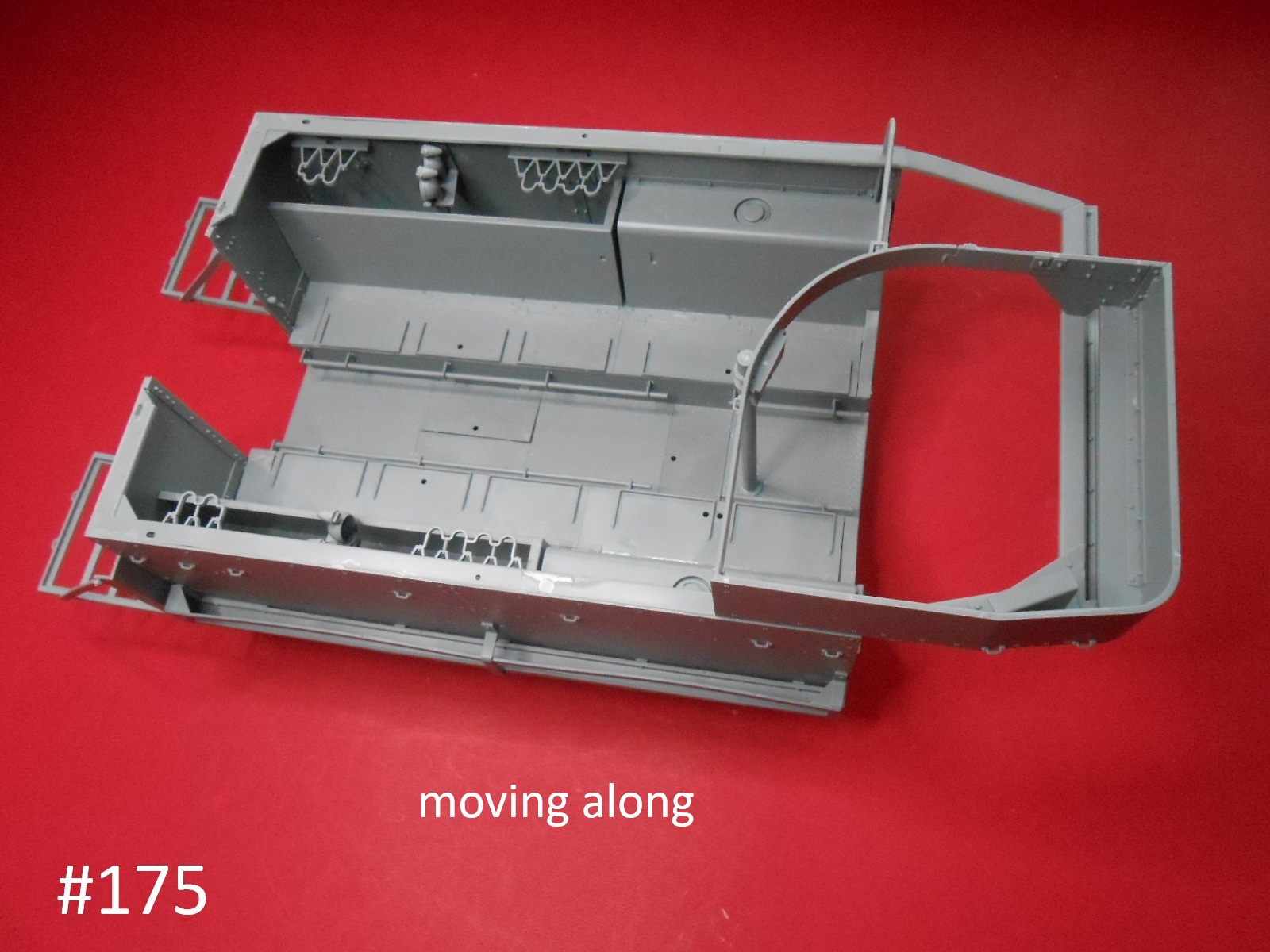

A little more finished.
It’s slow going
Donald

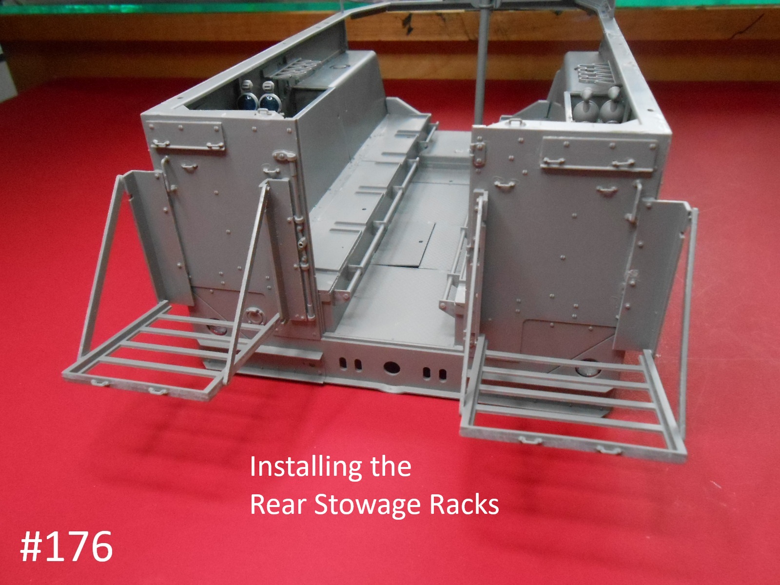

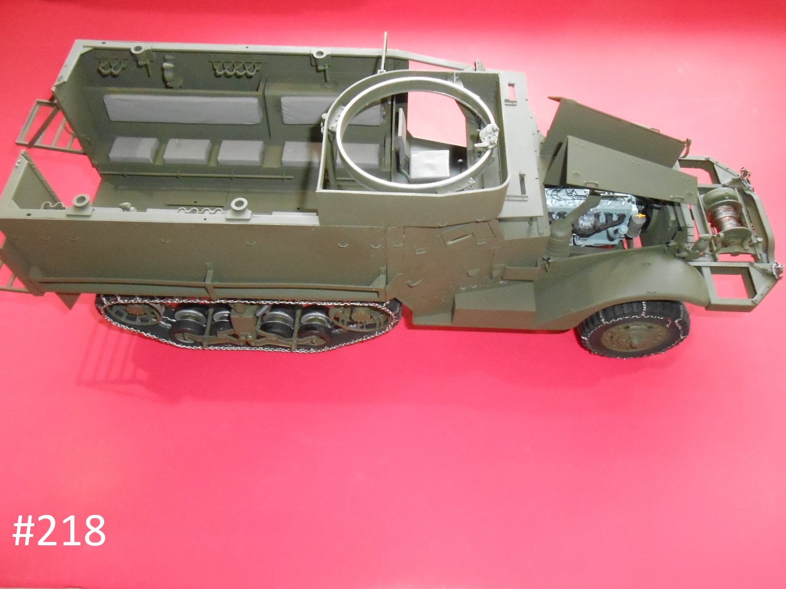

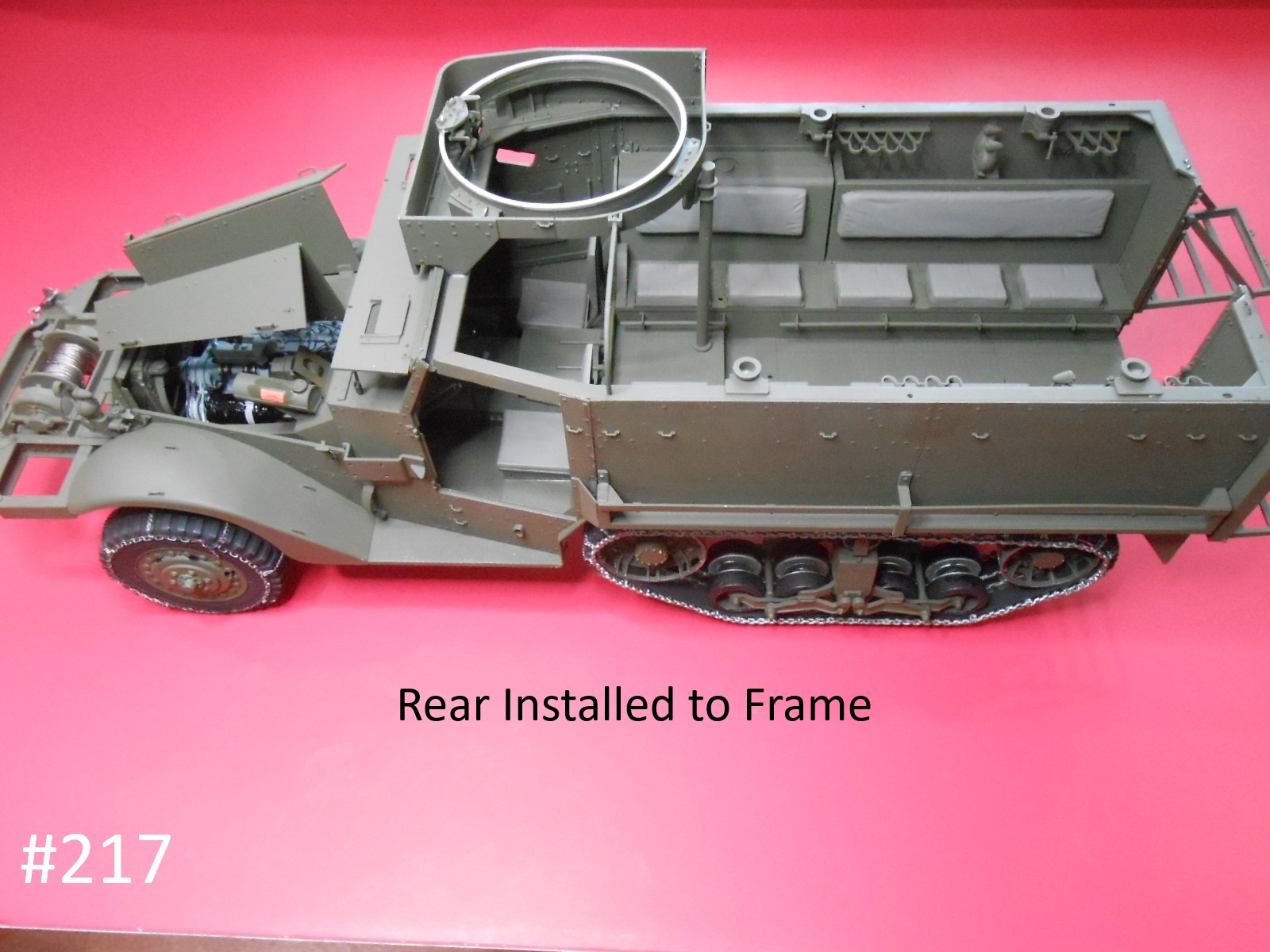

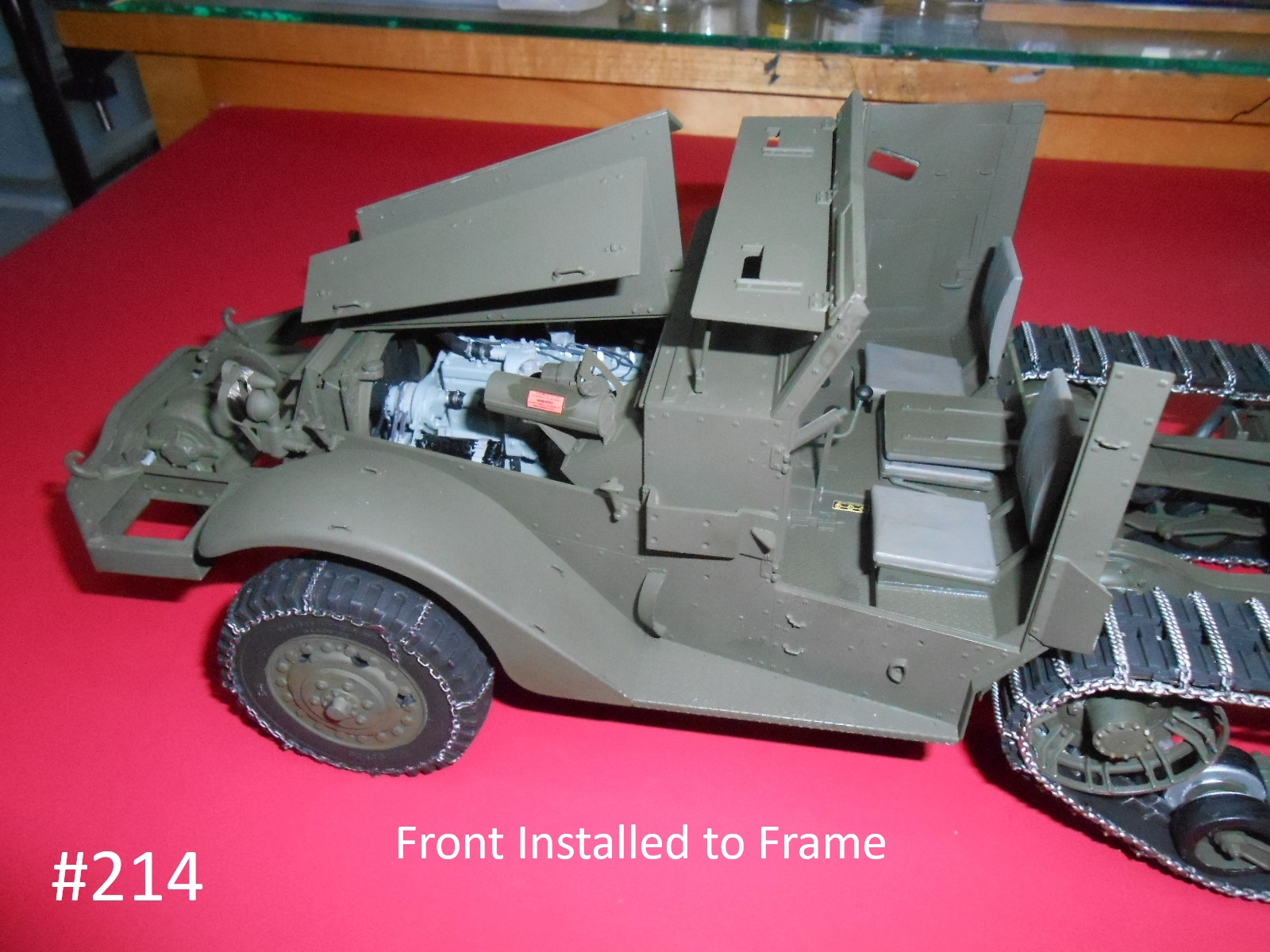

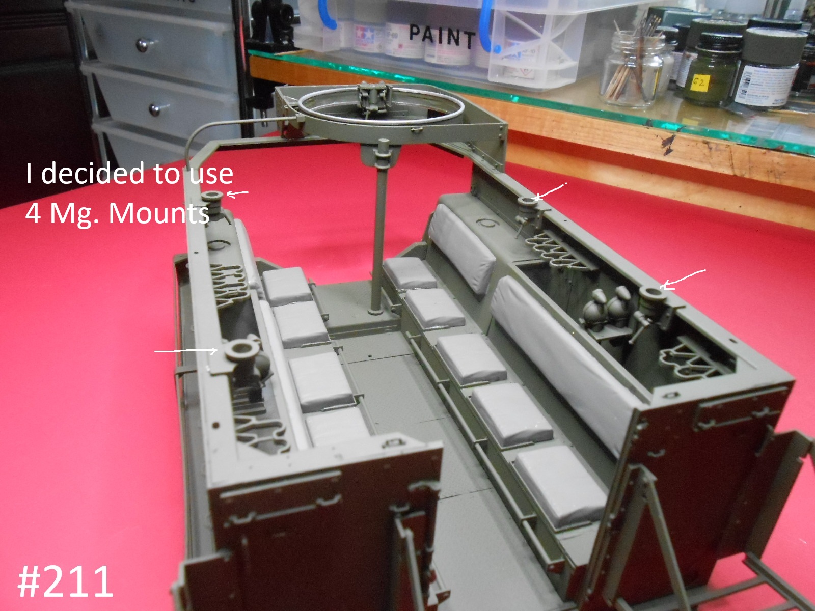

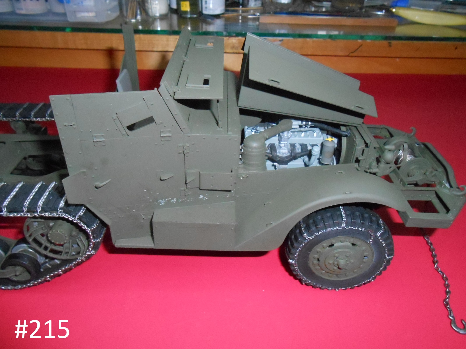

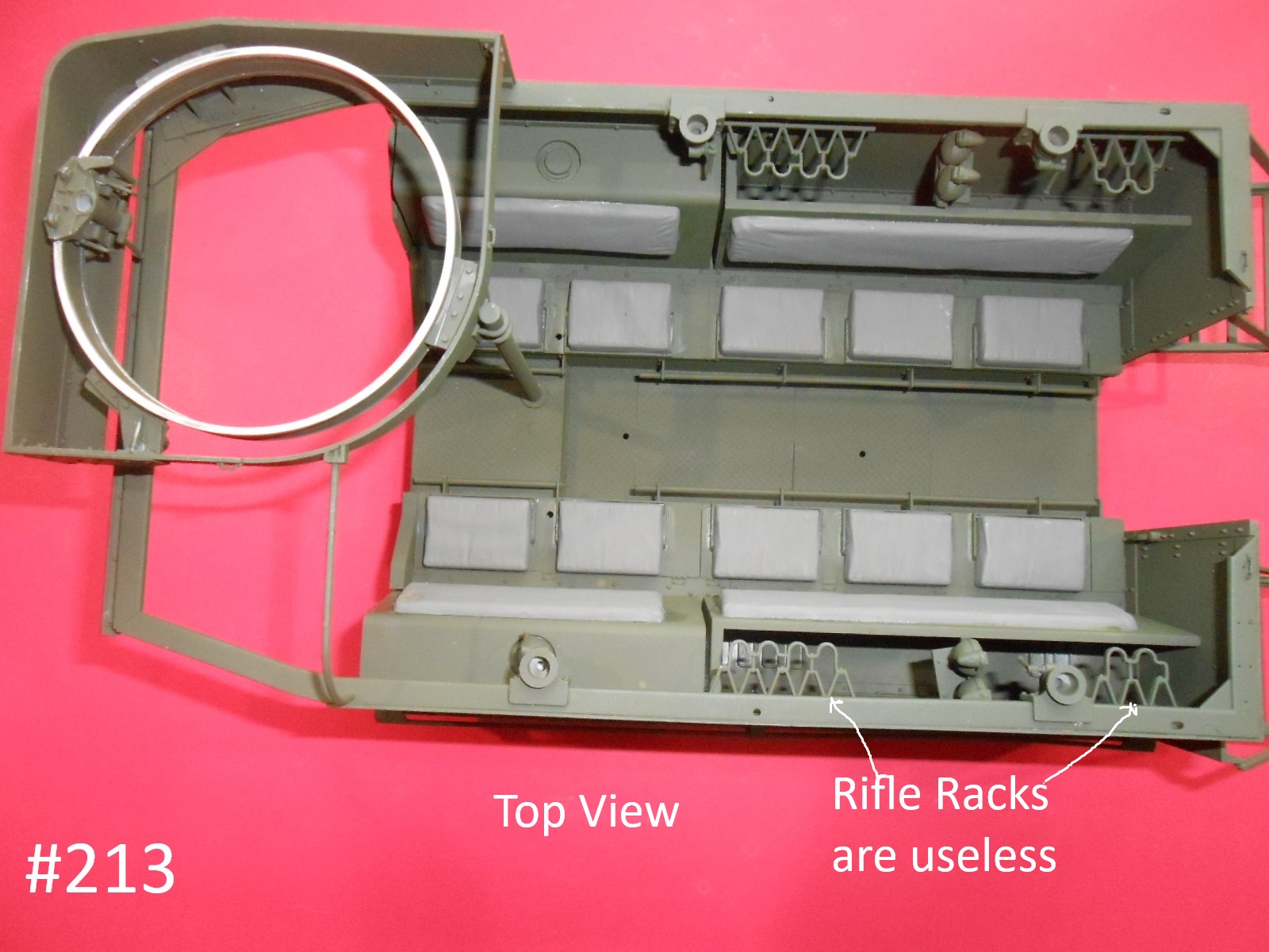

Today I have the Front and Rear Units installed to the Frame.
Next is installing the small parts.
Regards
Donald

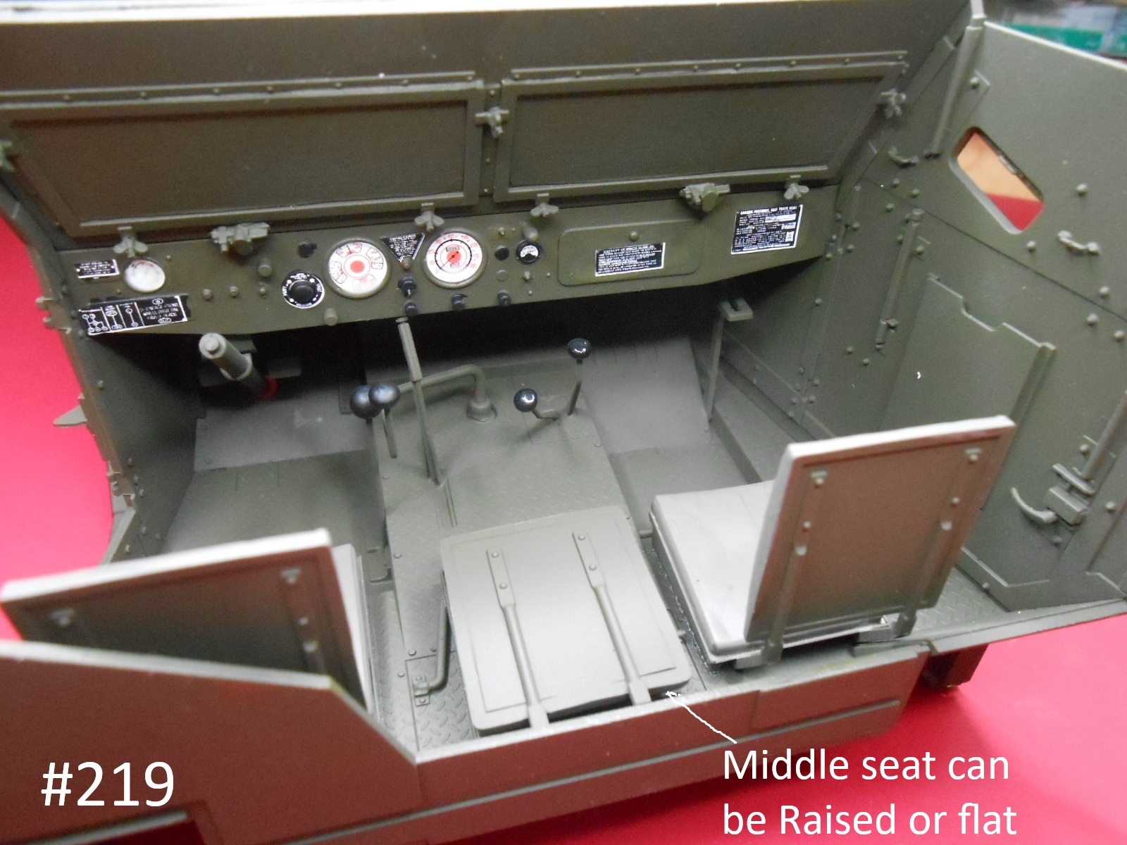

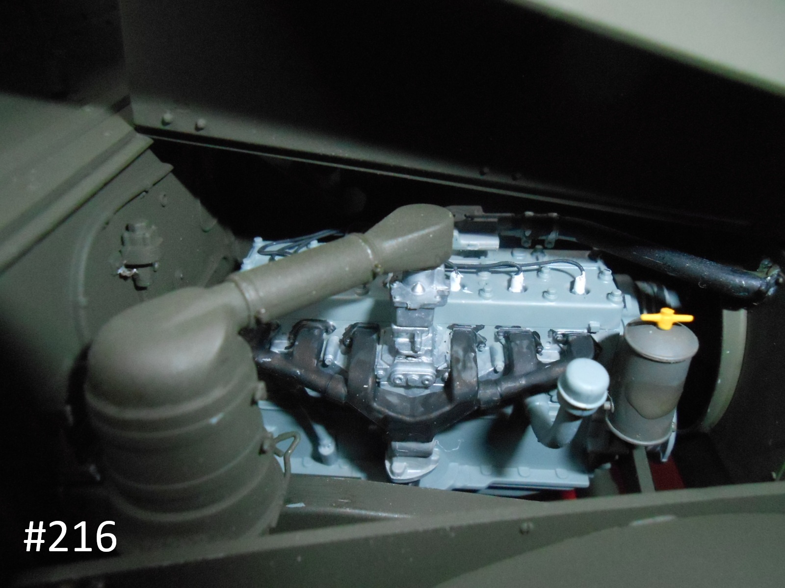

What OD do you use? its not too dark and not to light.
It’s looking great.
You’ve really moved it along Donald. Excellent.
I used Tamiya XF62 Olive Drab for the Hard parts.
I used Tamiya XF51 Khaki Drab for the Cushions.
Regards
Donald
