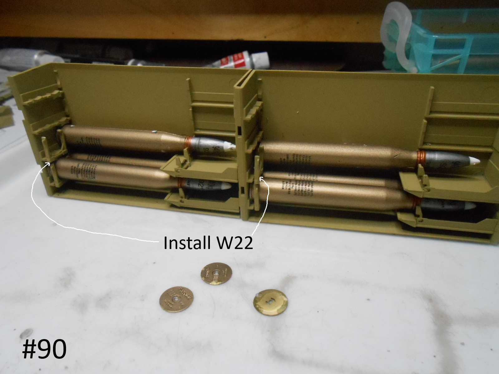

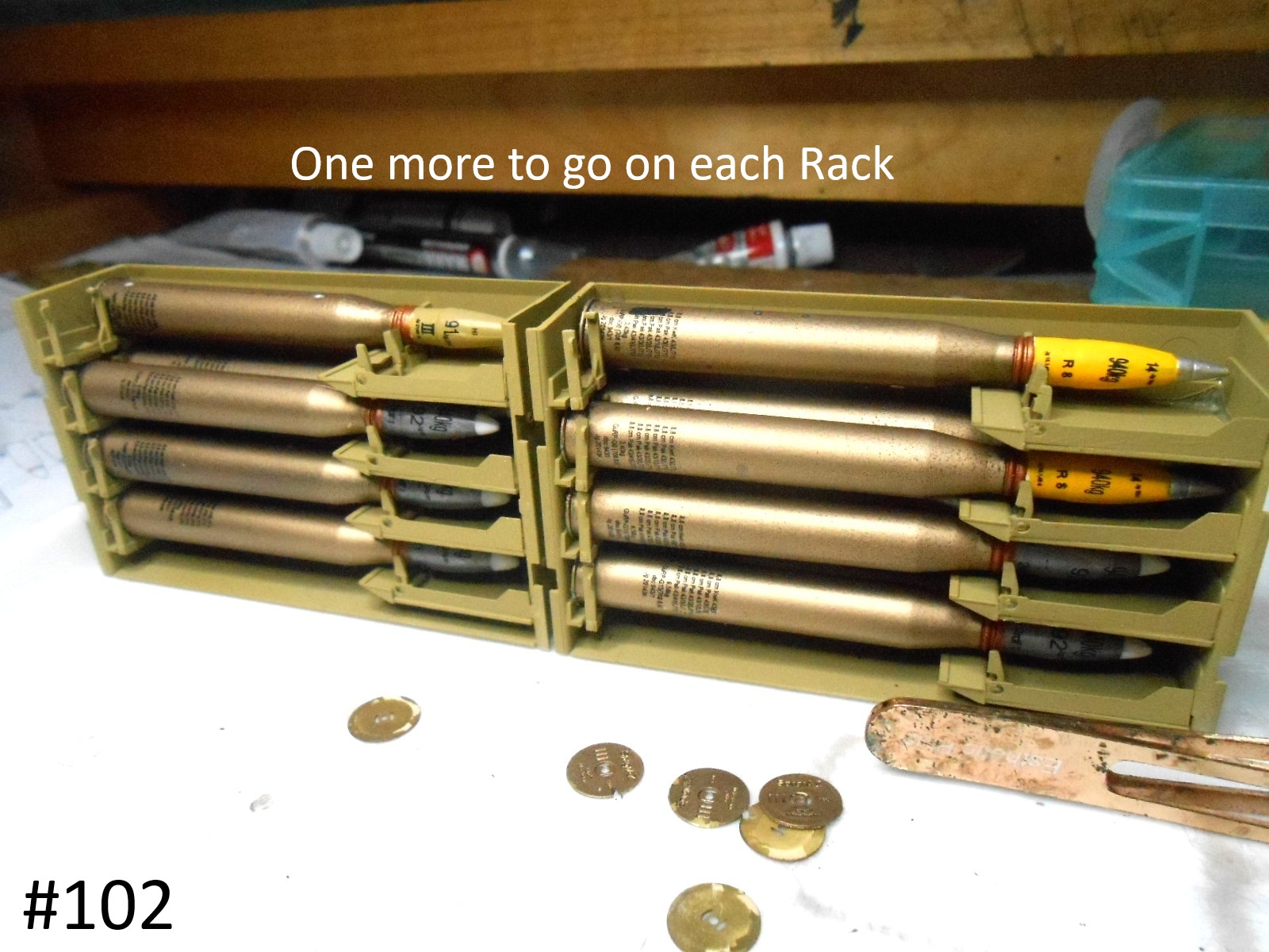

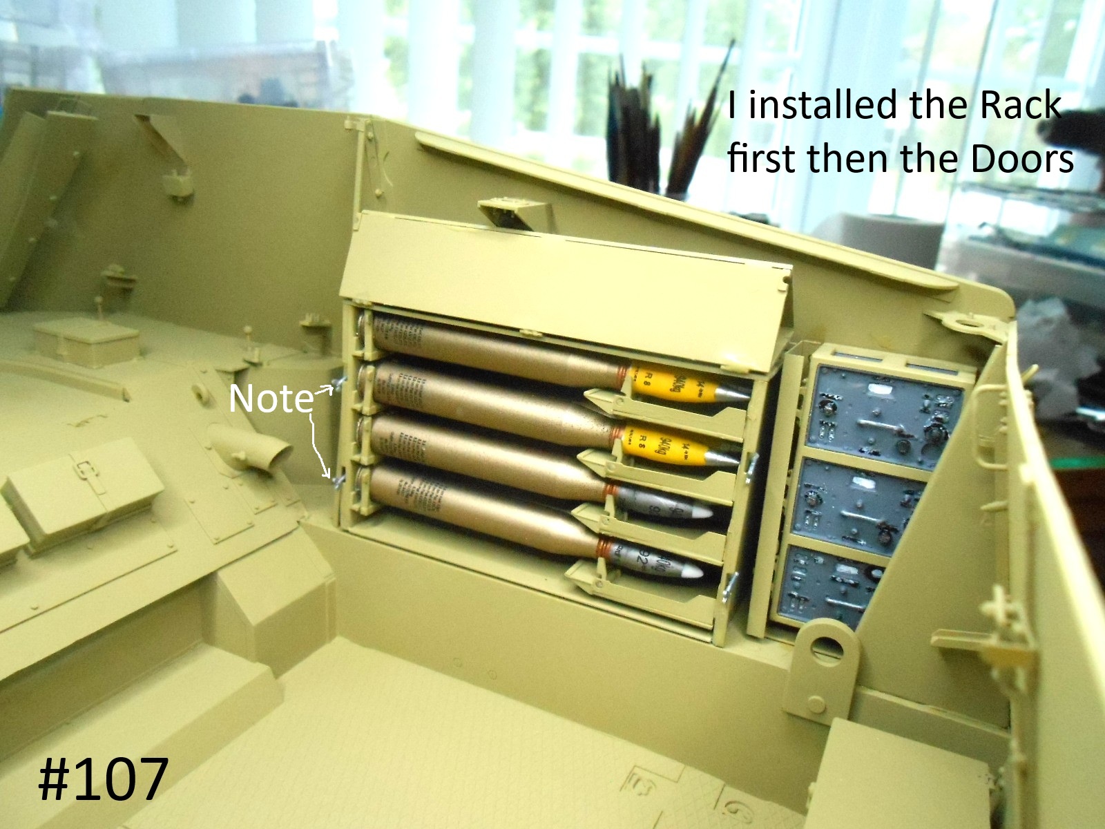

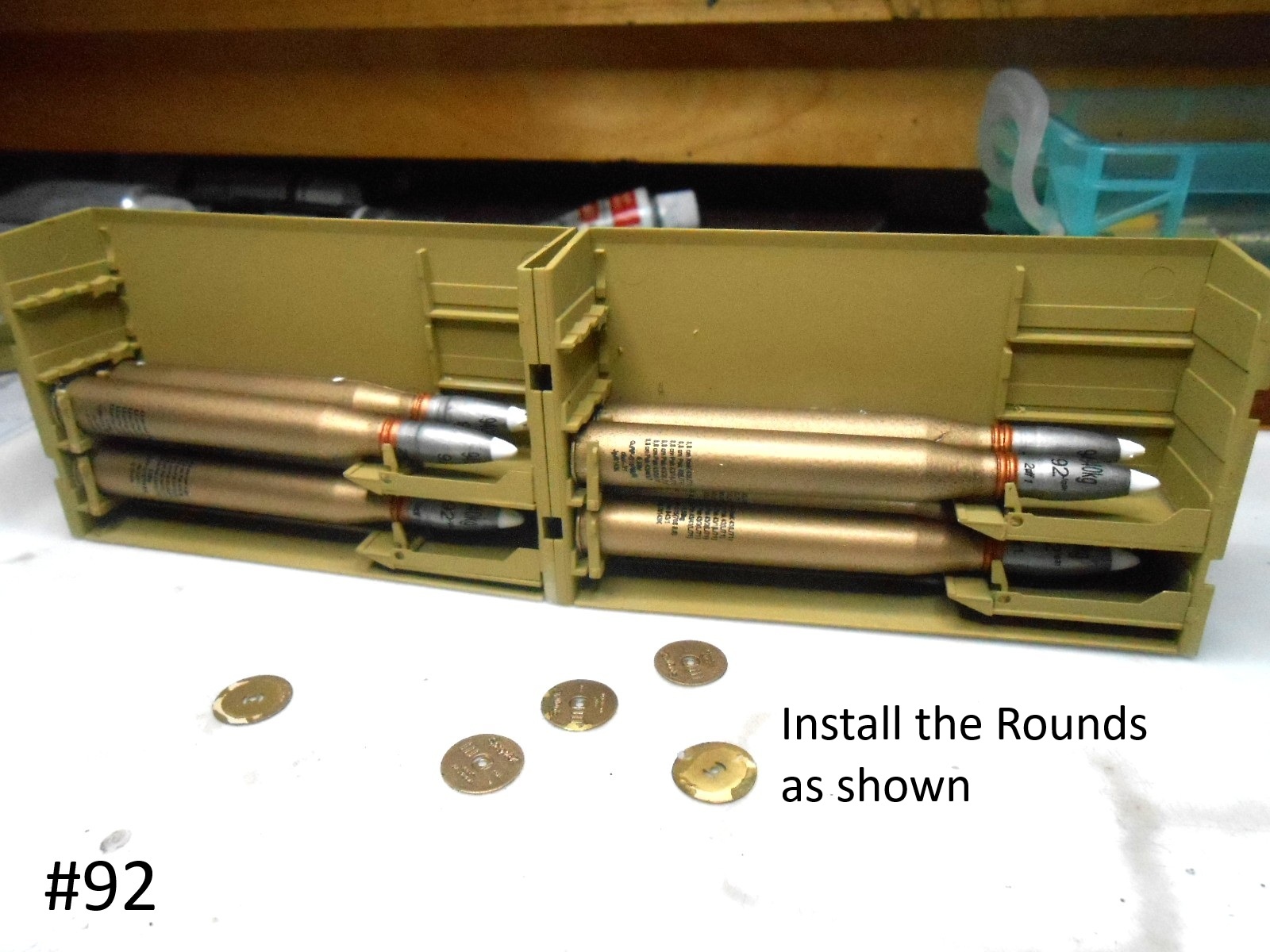

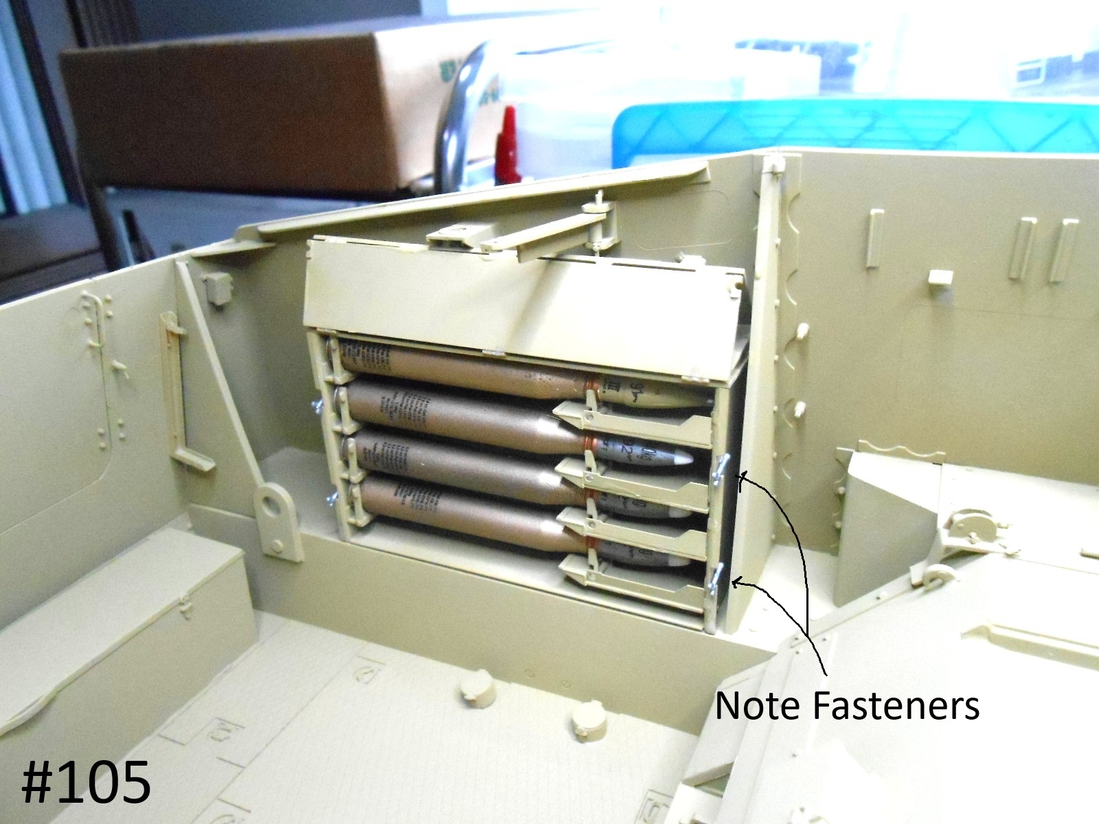

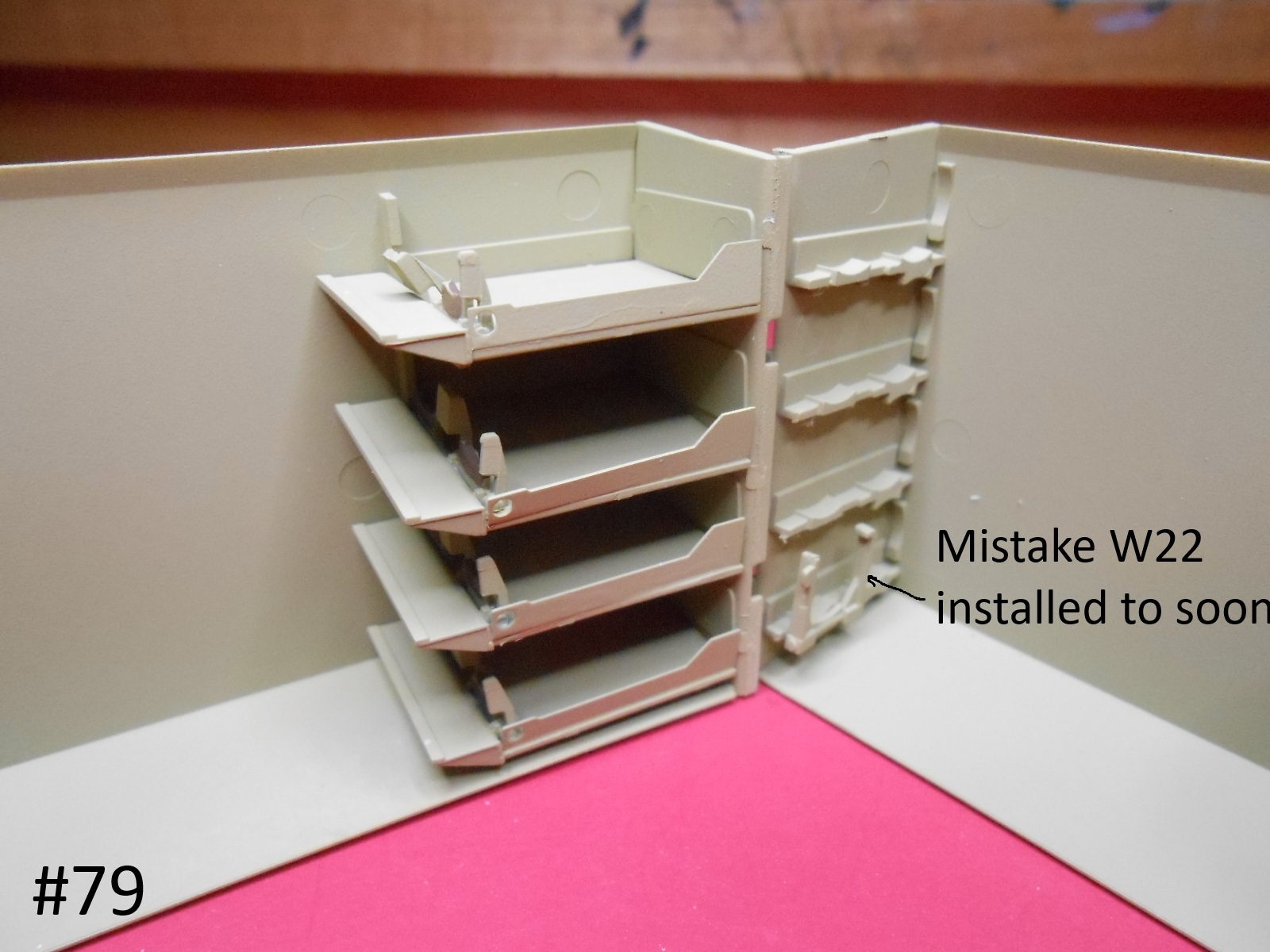

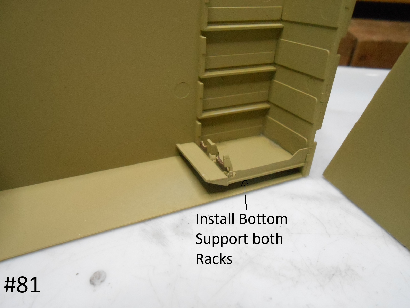

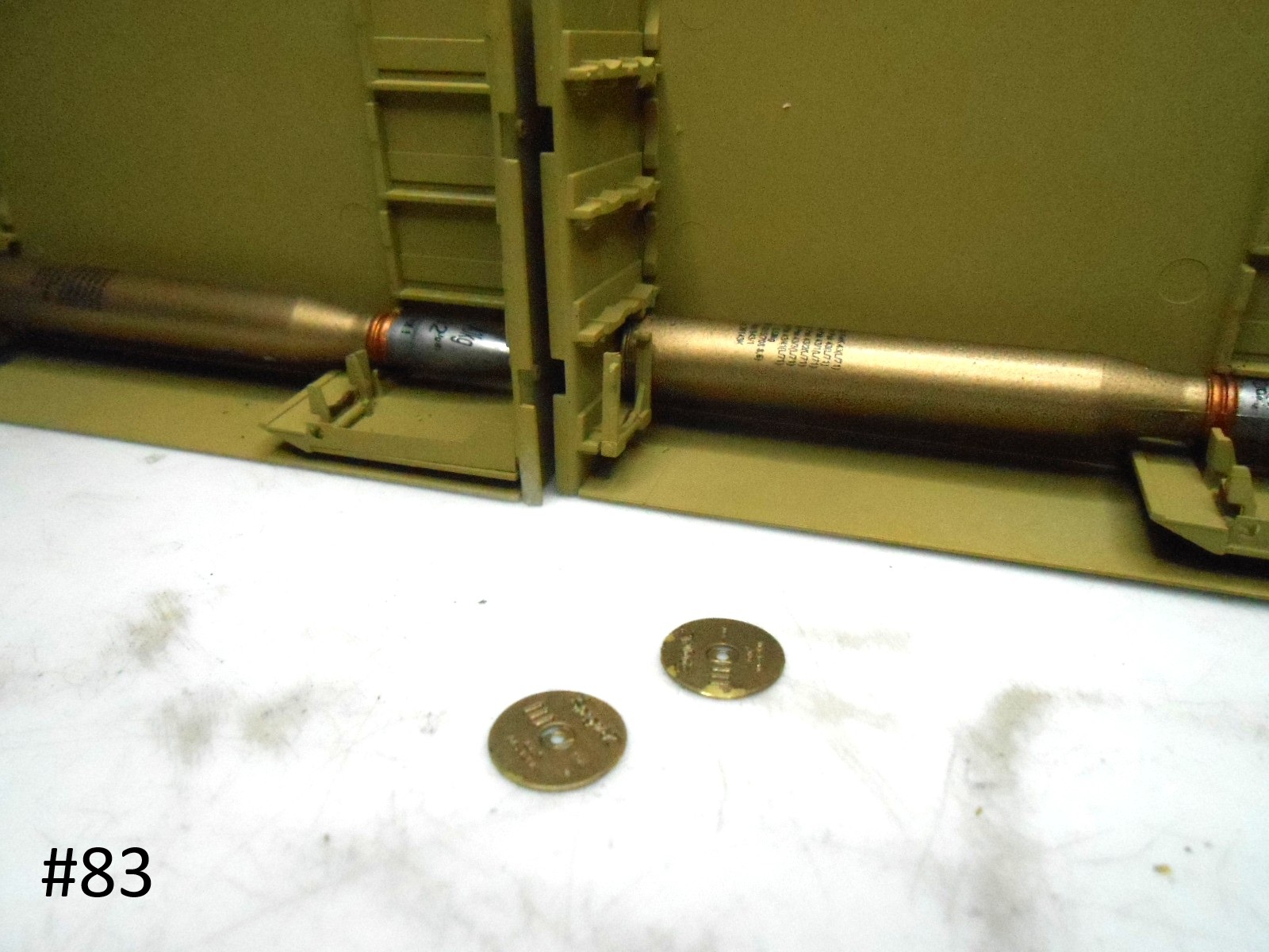

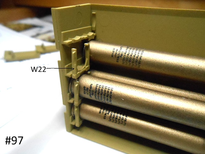

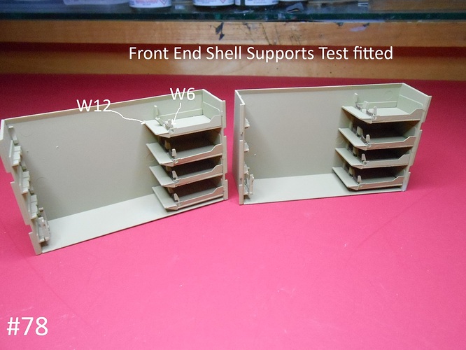

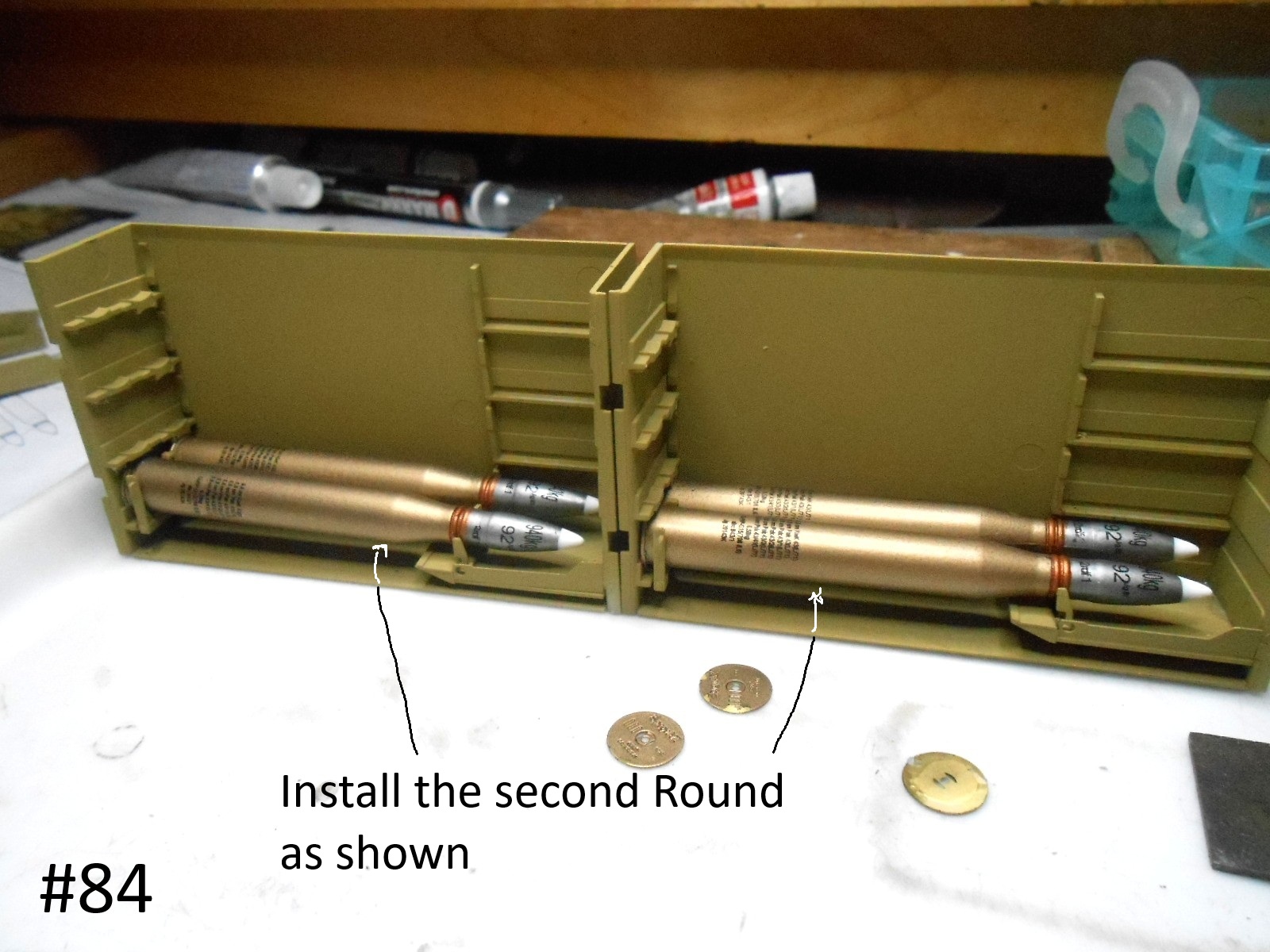

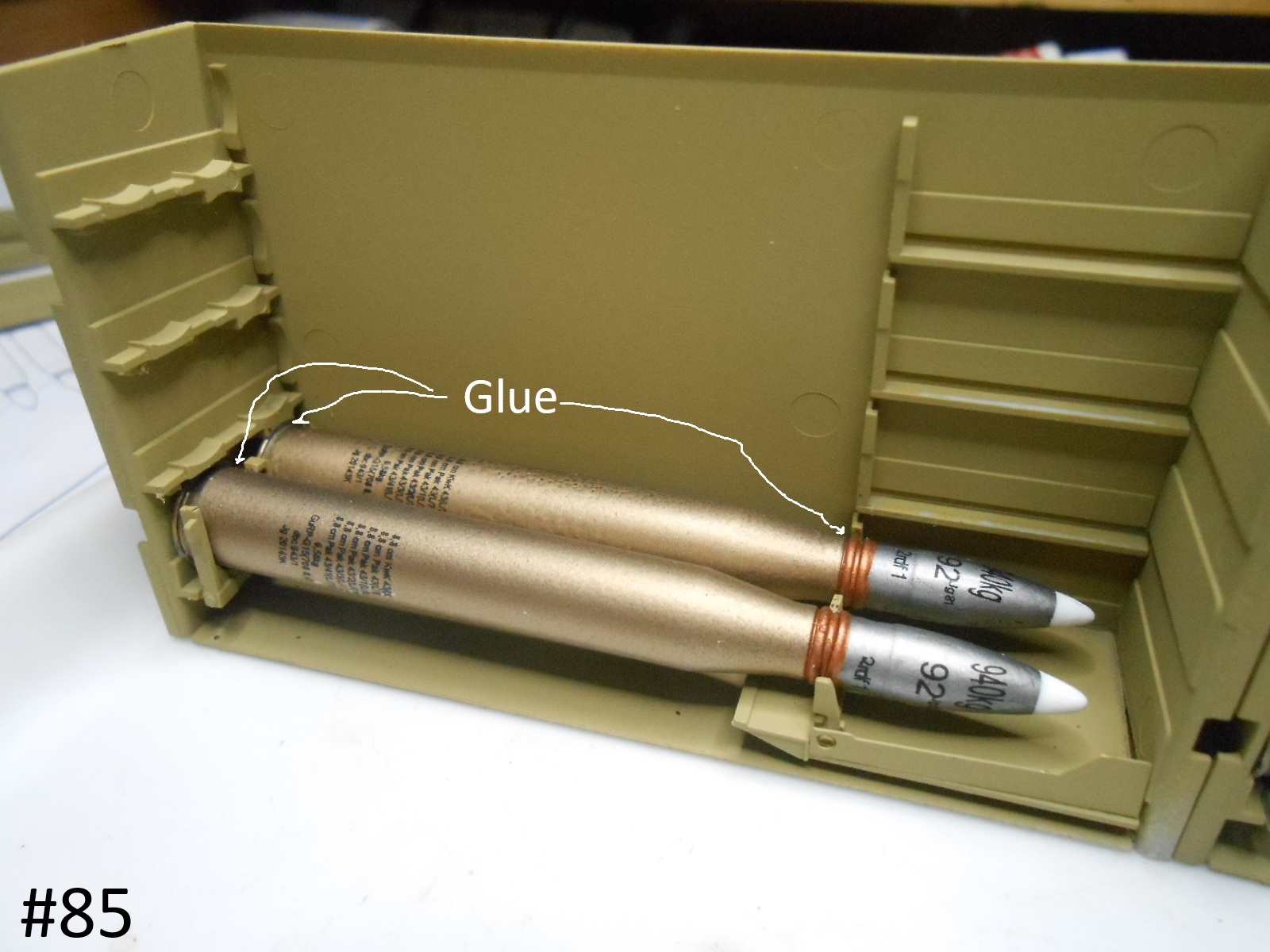

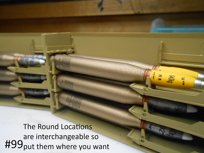

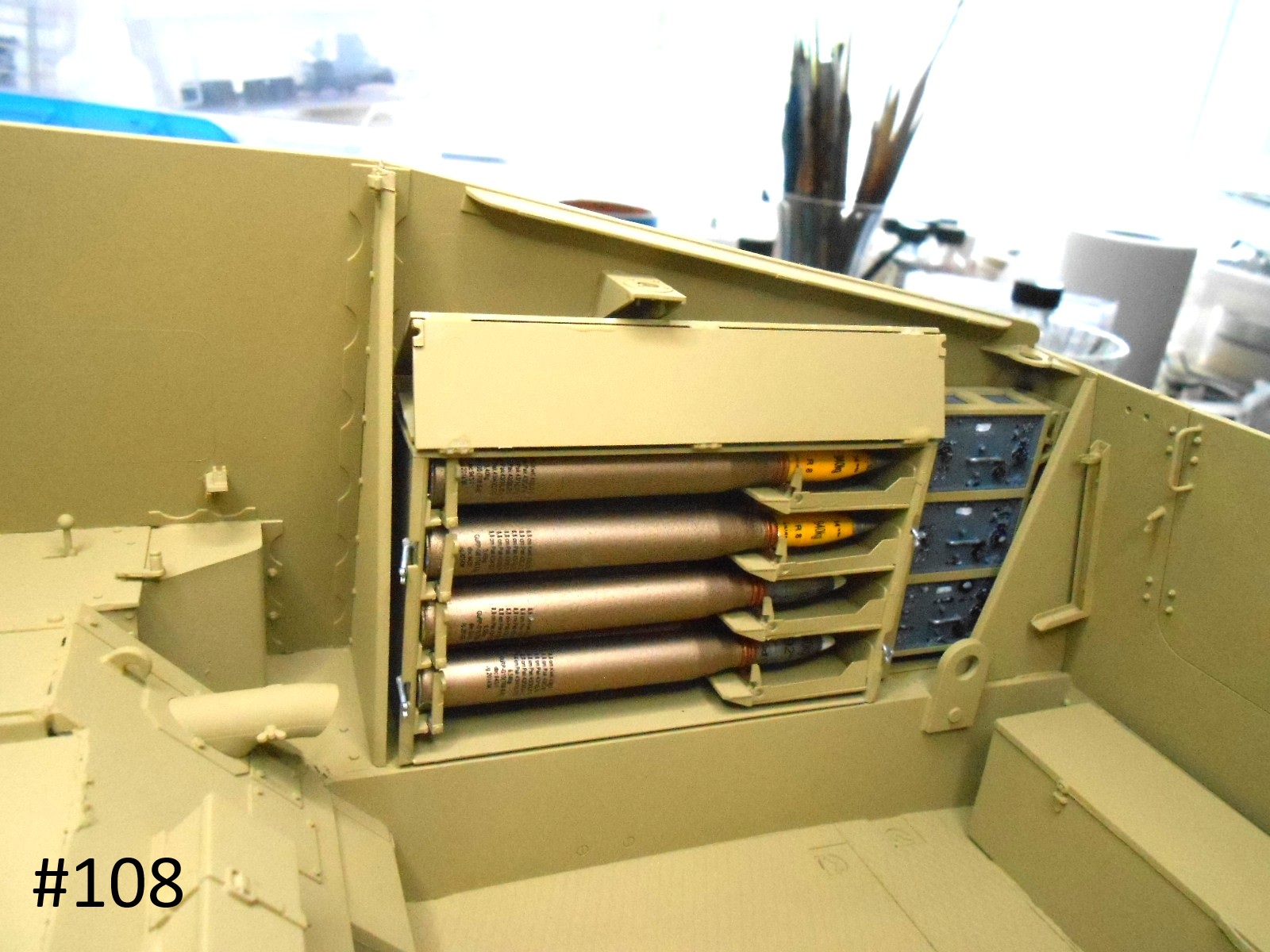

Well This next Post took me all Day to figure out and to do it and post it.
This is verry Complicated and I hope it helps any of you trying this build.

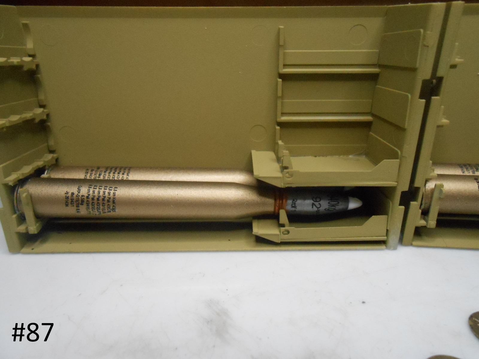

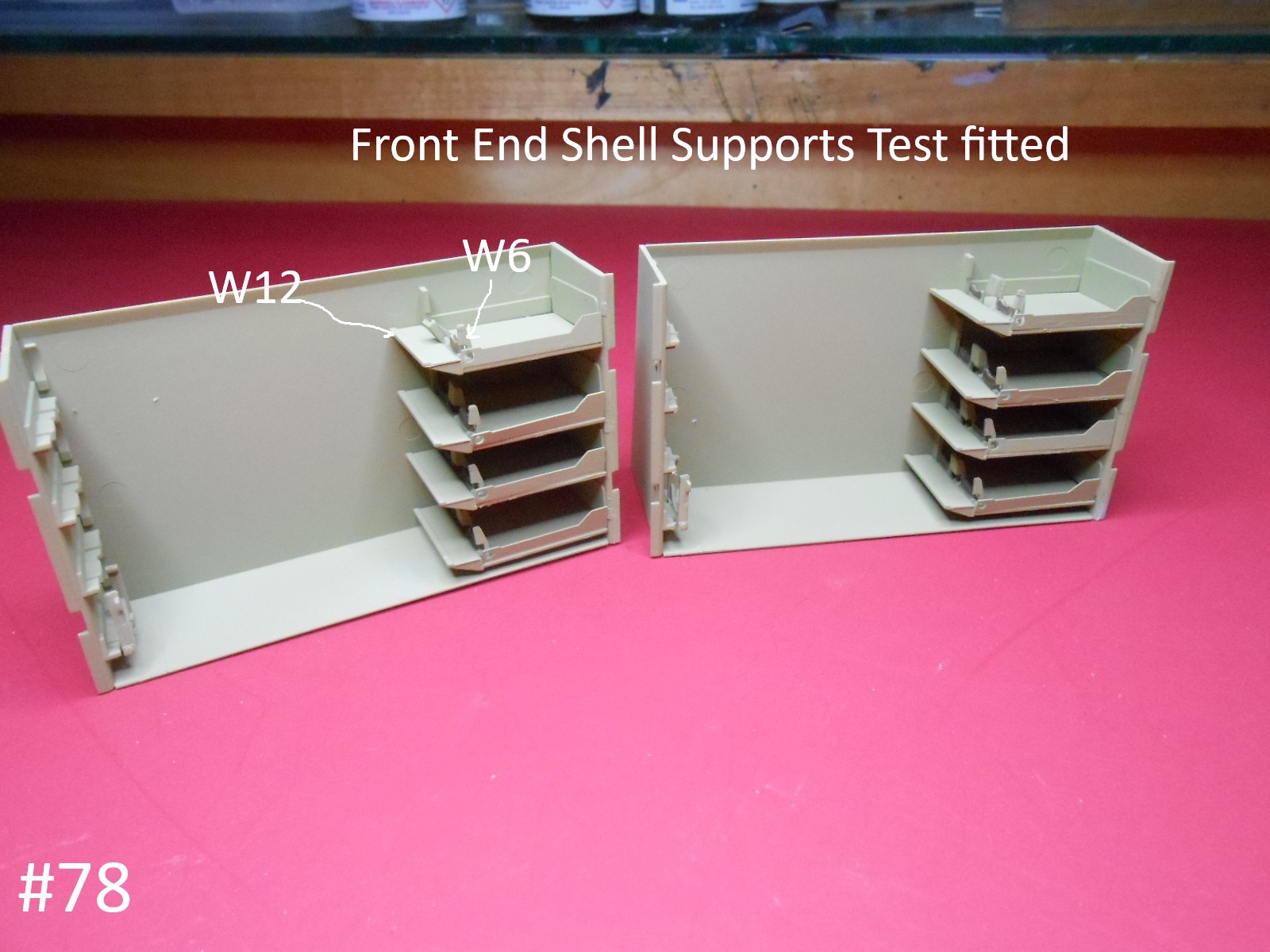

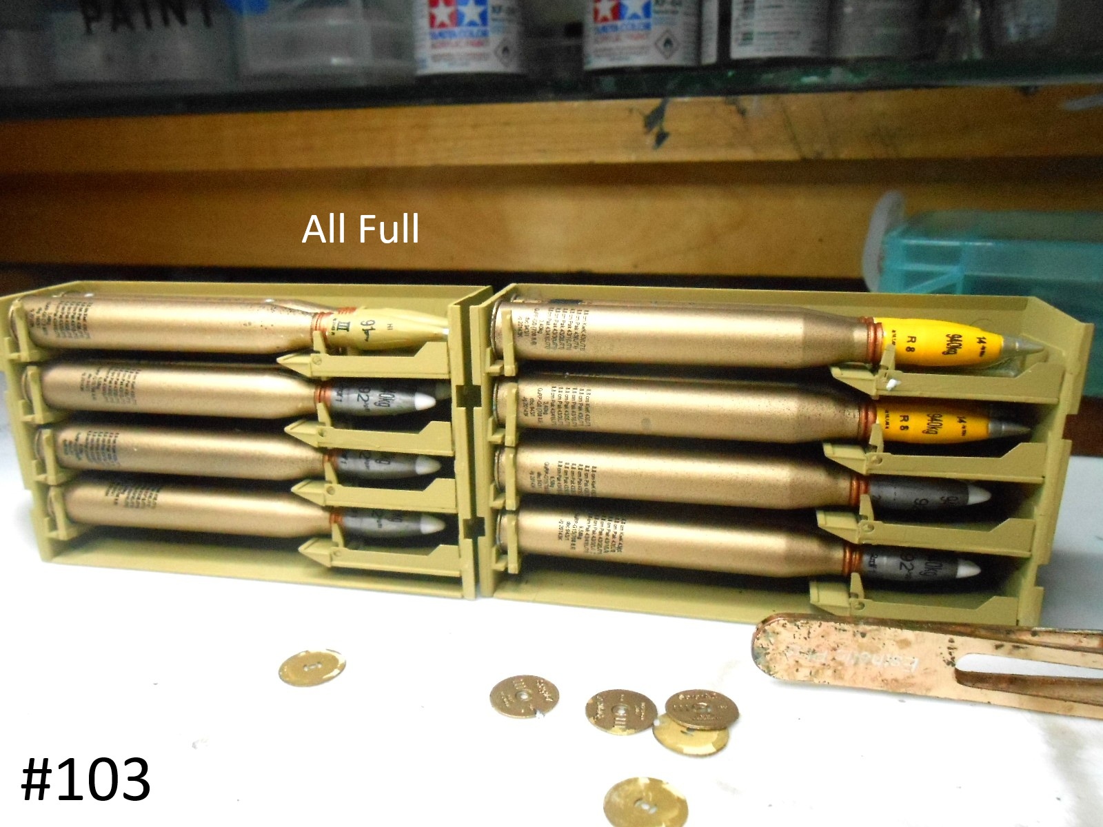

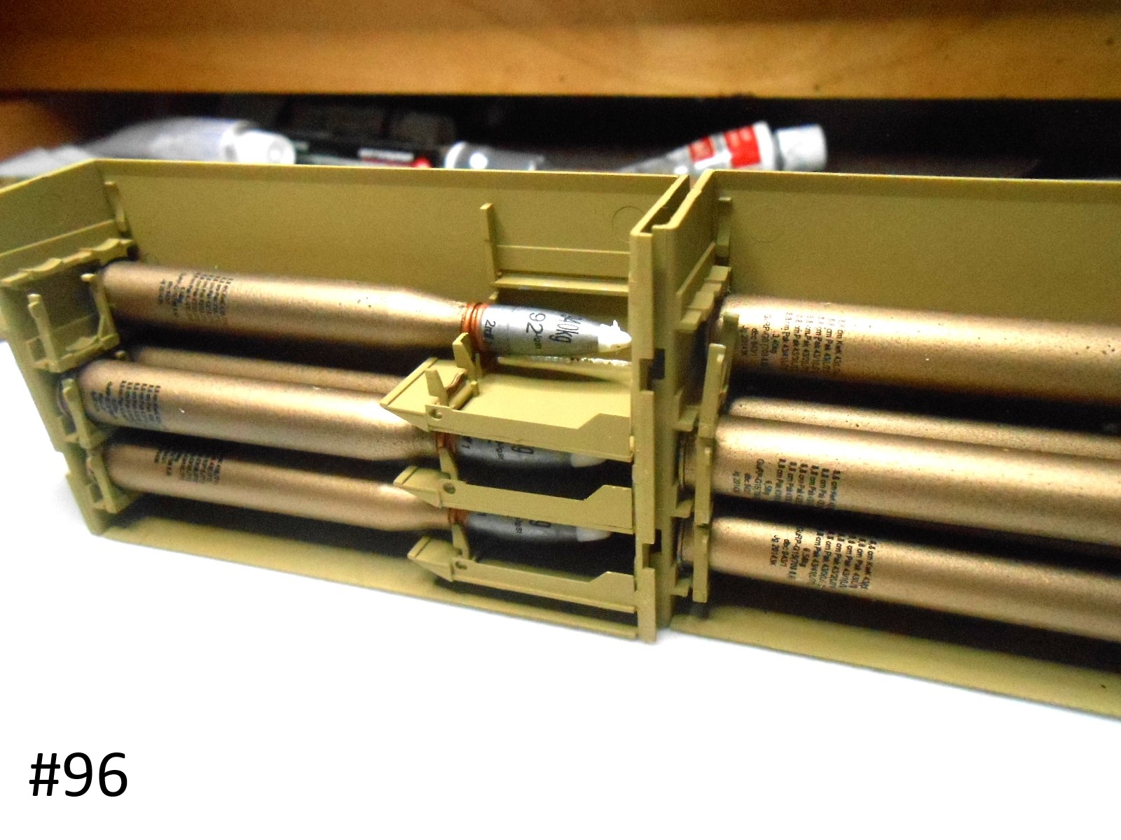

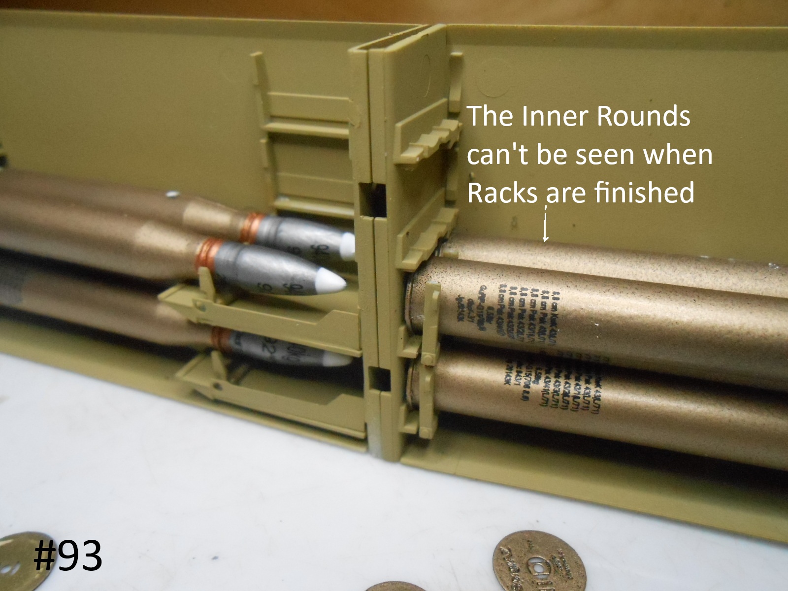

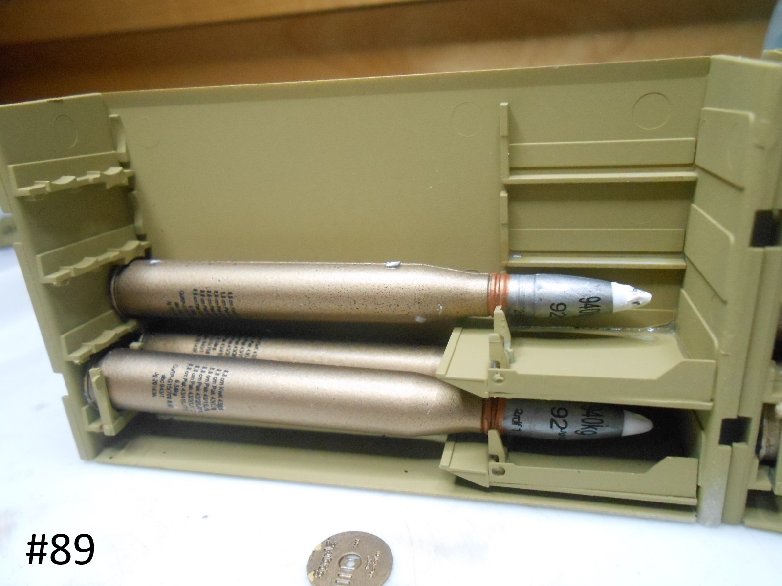

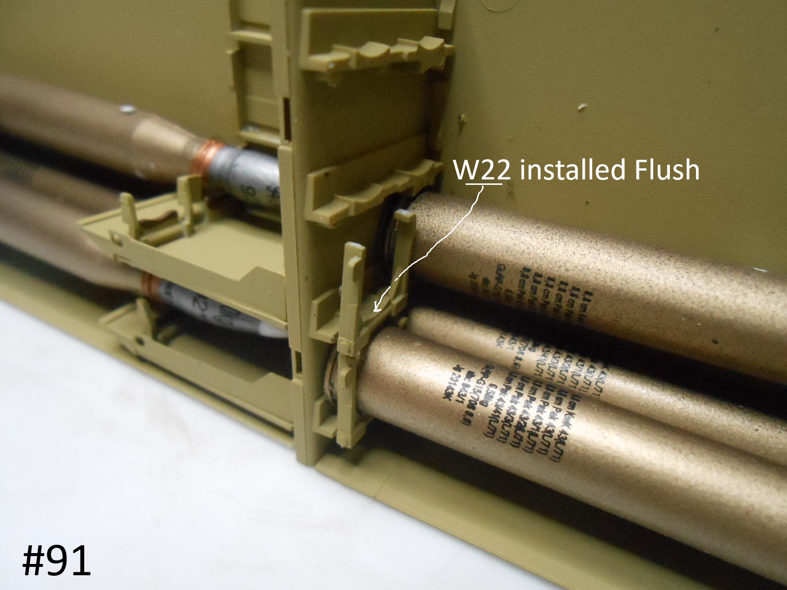

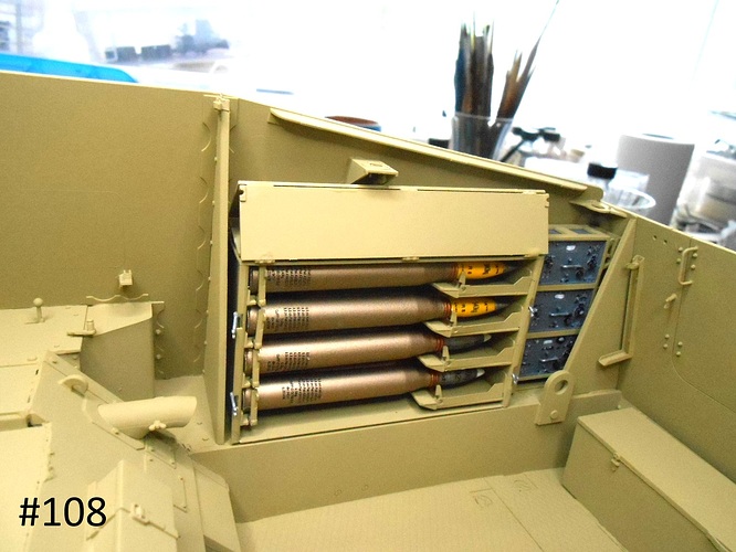

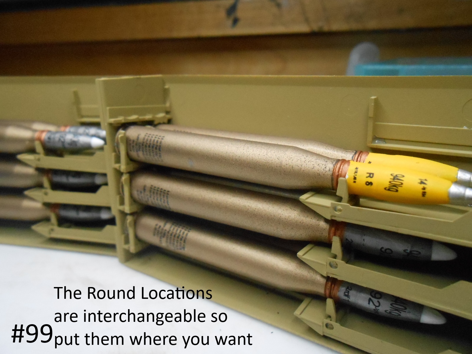

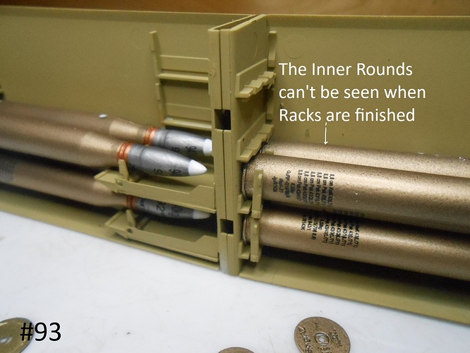

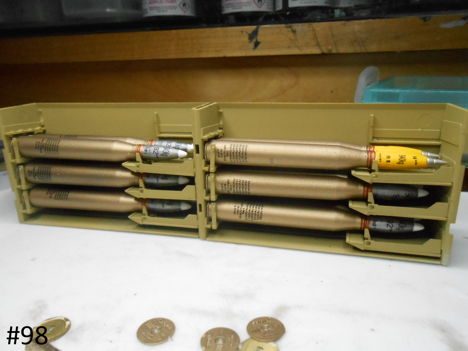

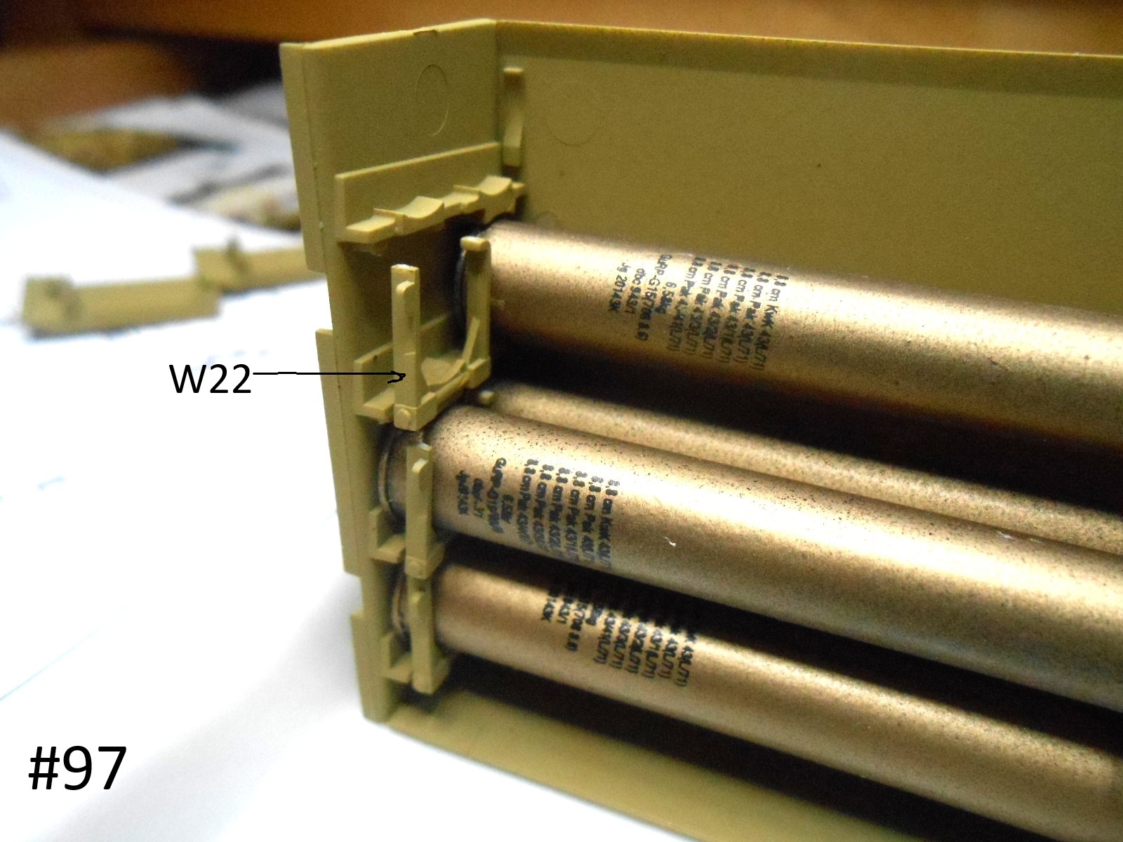

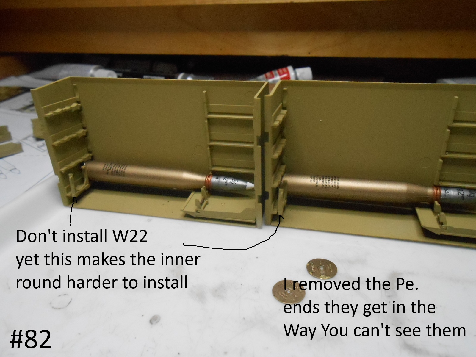

There that finisher the AMMO Racks.
I would recommend forgetting the Pe. ends for the AMMO, unless you are having loose rounds for display. The AMMO rounds have a rim around the ends and you can’t see the ends once they are in the rack,
Regards
Donald
PPS I hope this didn’t take up too much of your Computer workings.
I have 32 GBs of RAM and 5 terabytes of storage. Keep it rolling.

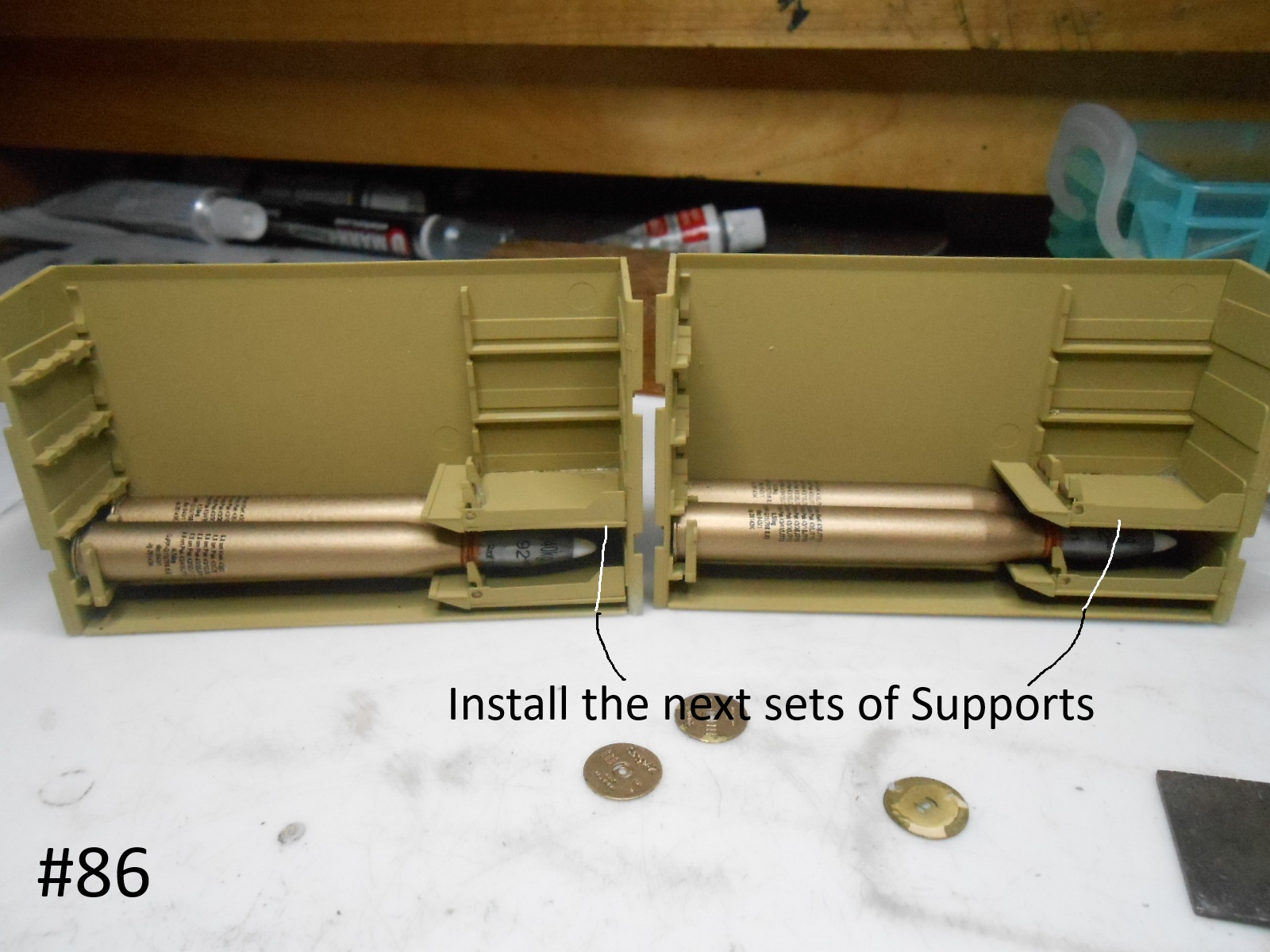

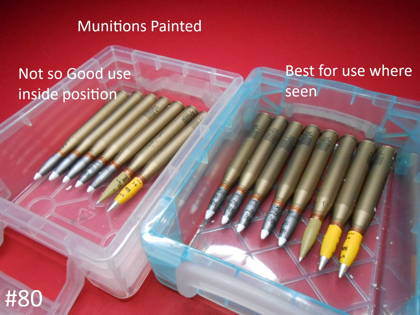

Nice job on the ammo Donald. Which brass paint did you use?
After cleaning the parts with cleaner I sprayed a coat of AK Extreme Metals Black Base.
After that cured overnight , it comes out Glossy I sprayed a coat of their Extreme Metals Brass, let that cure then sprayed again.
I used the decals from the Kit and then applied a Matt coat.
I used the best parts where you can see them and the others toward the inside back wall.
You can’t see the inside ones anyway.
Regards
Donsld

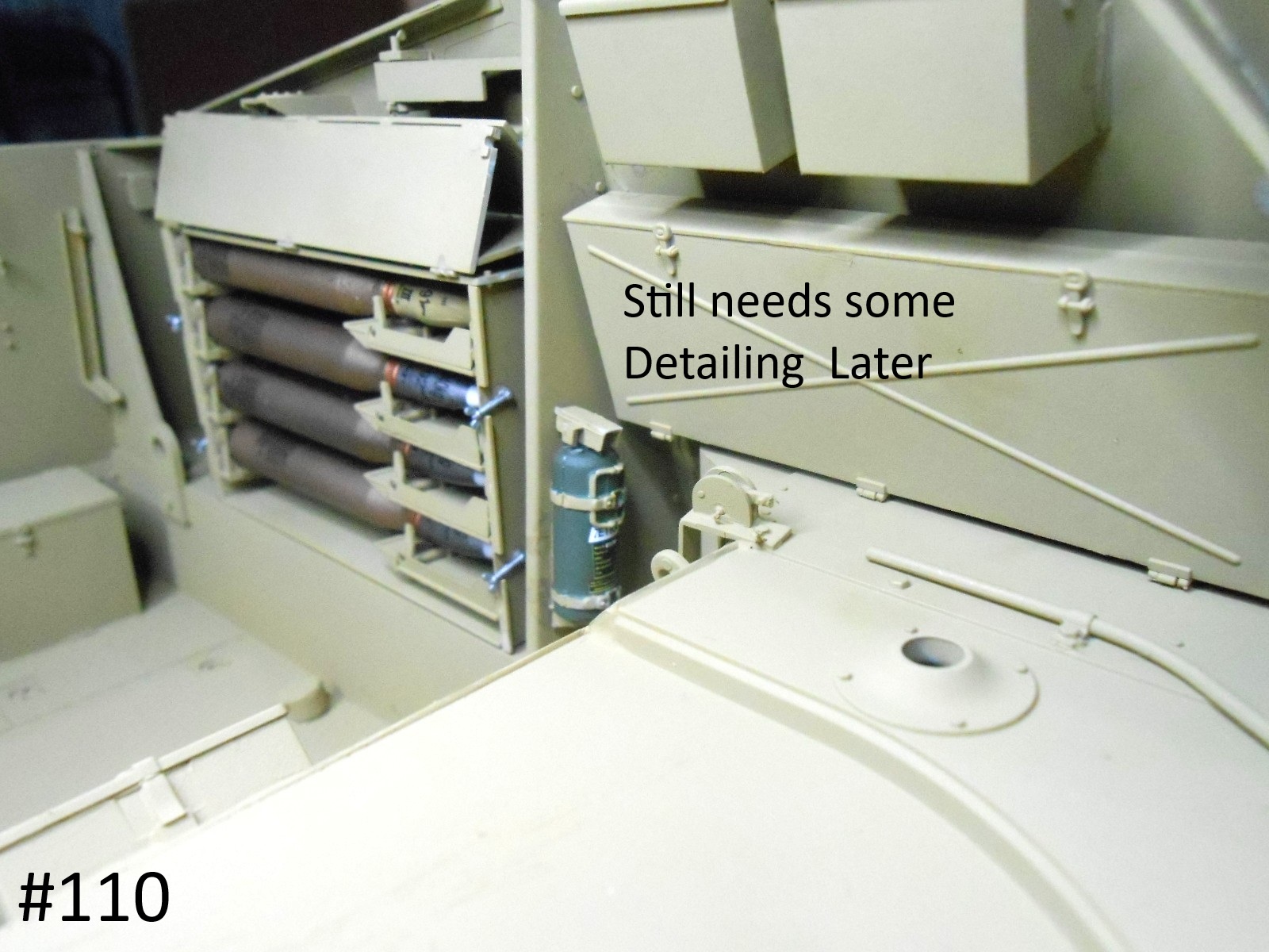

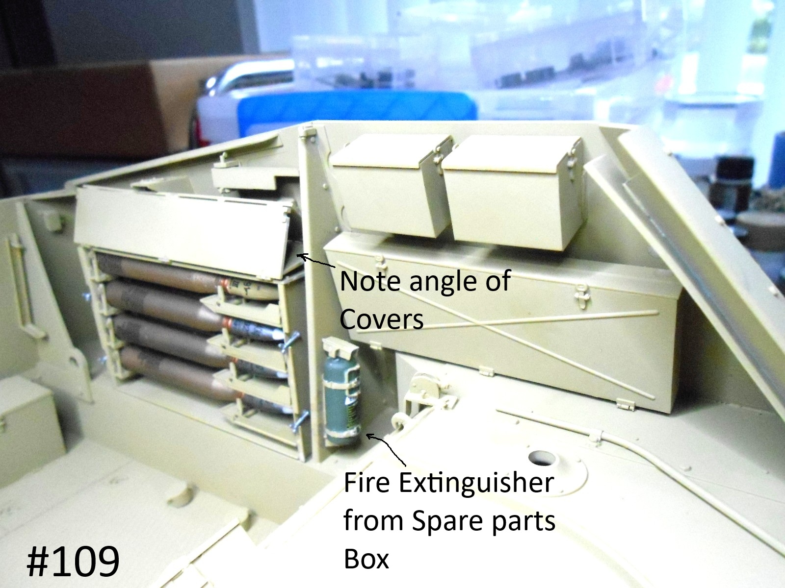

2 New Pics.
The kit doesn’t give you a Fire Extinguisher, It goes here ?
As good a place as any, and out of the way.
Donald

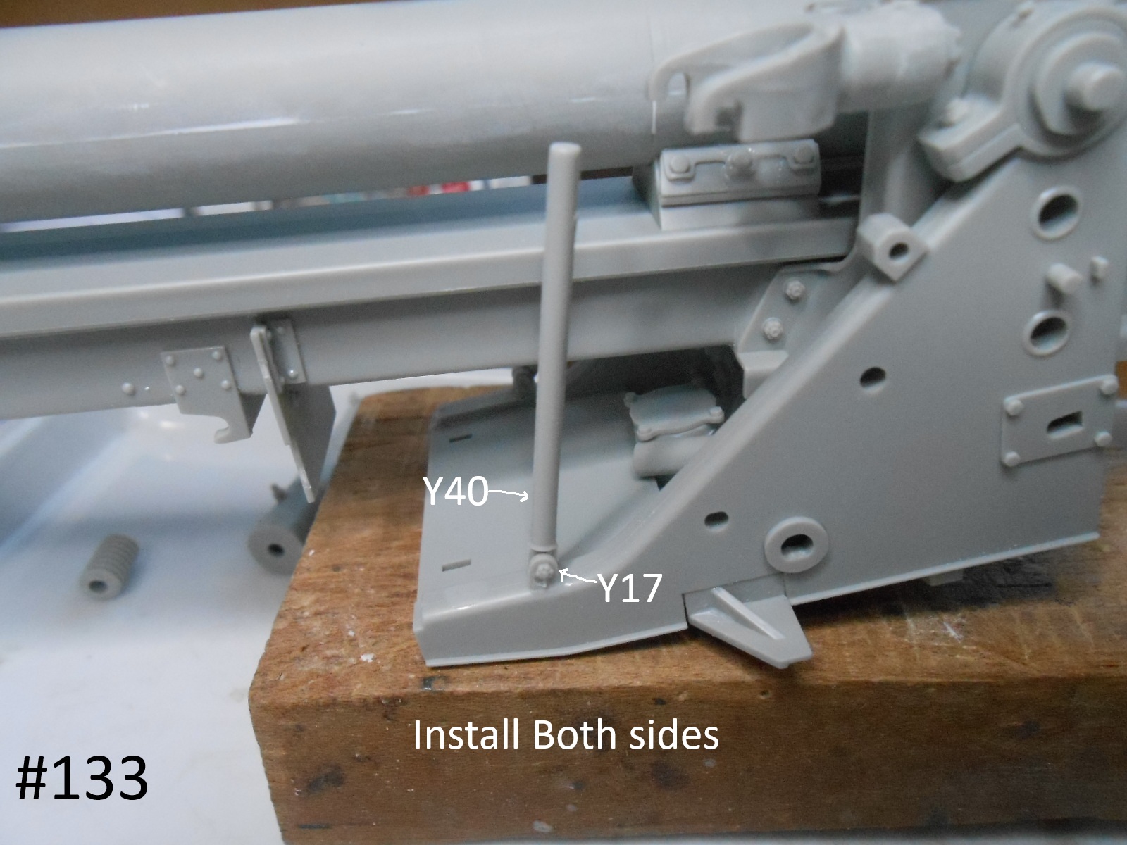

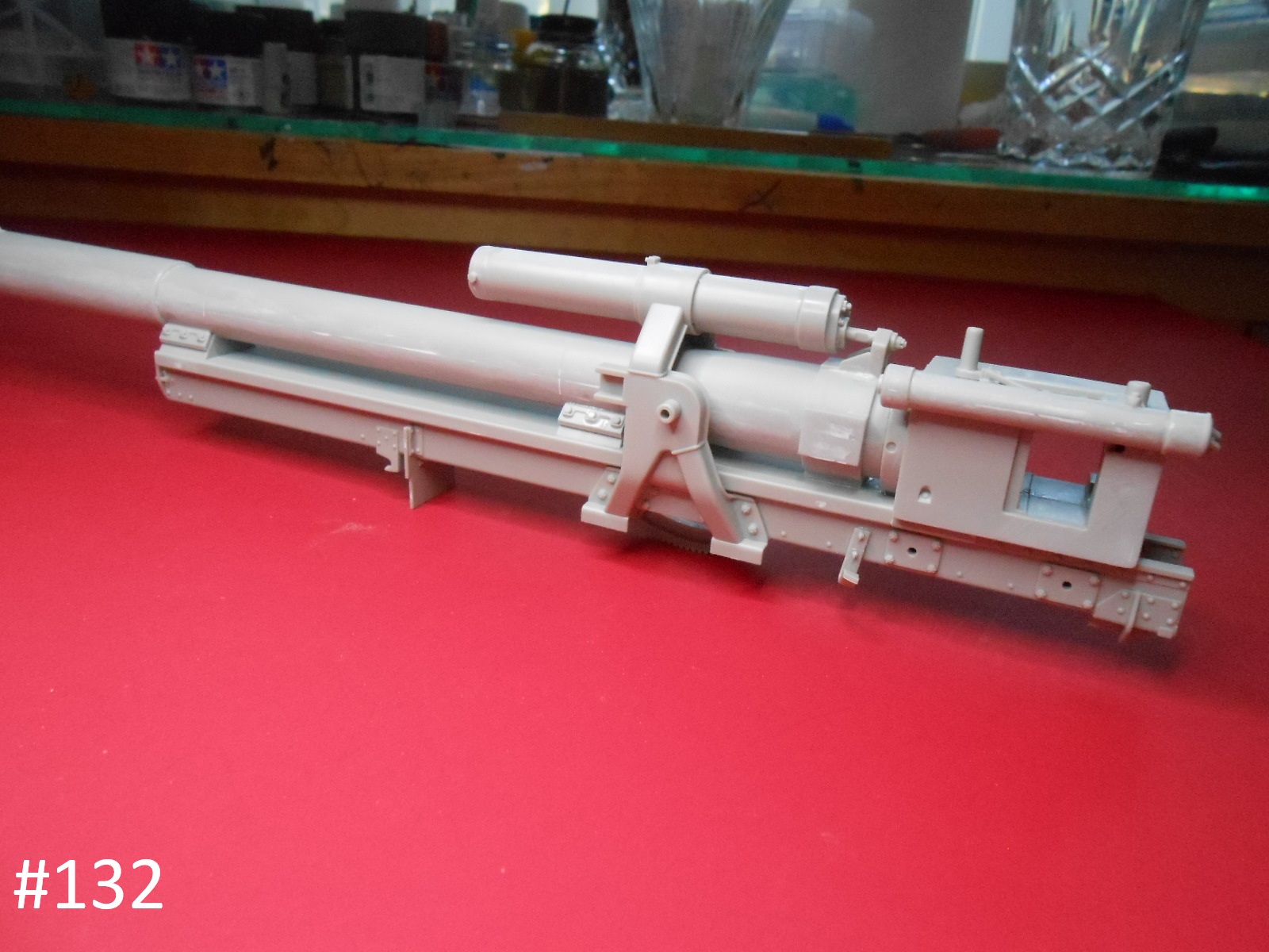

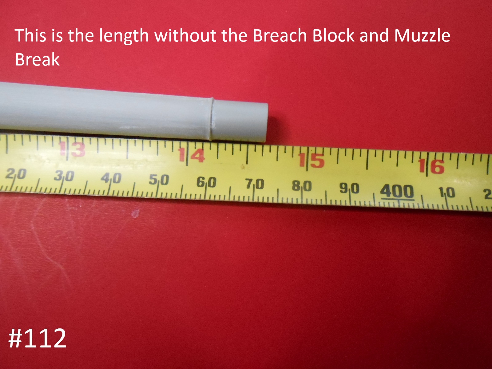

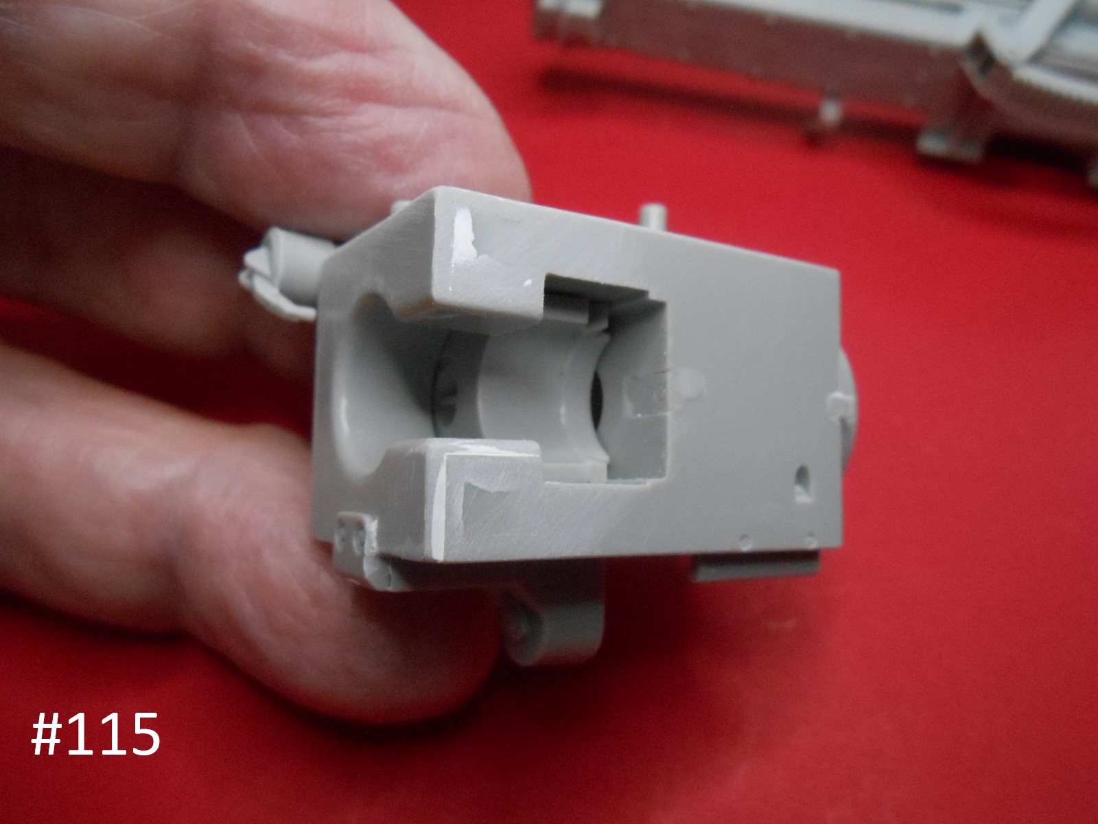

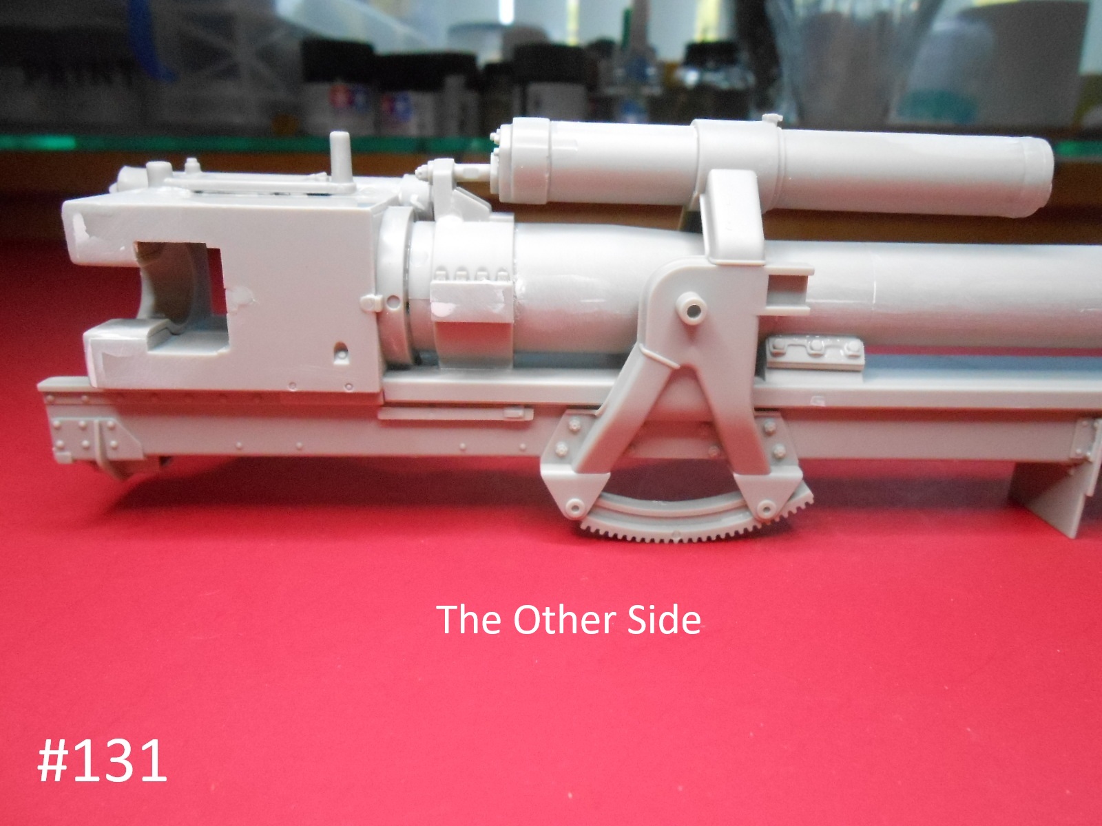

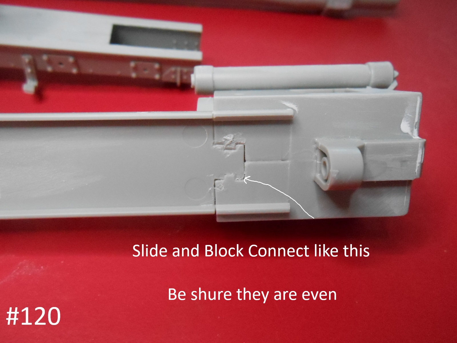

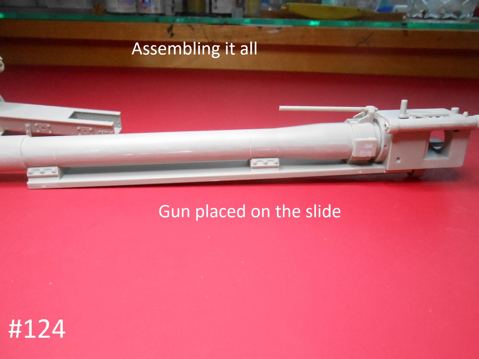

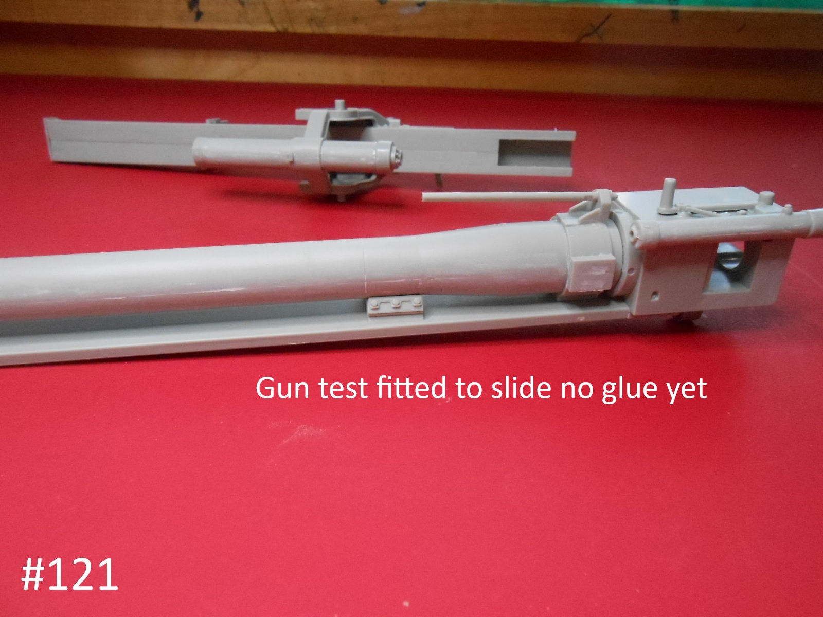

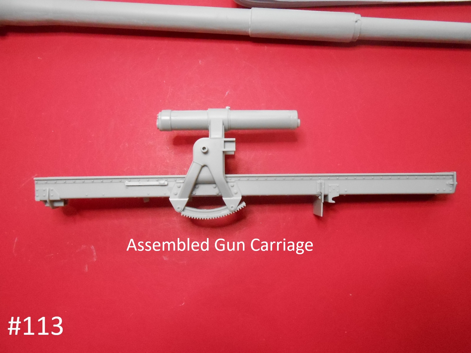

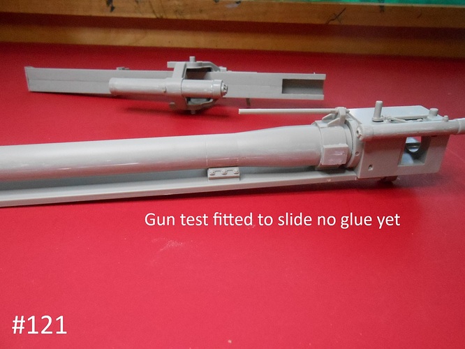

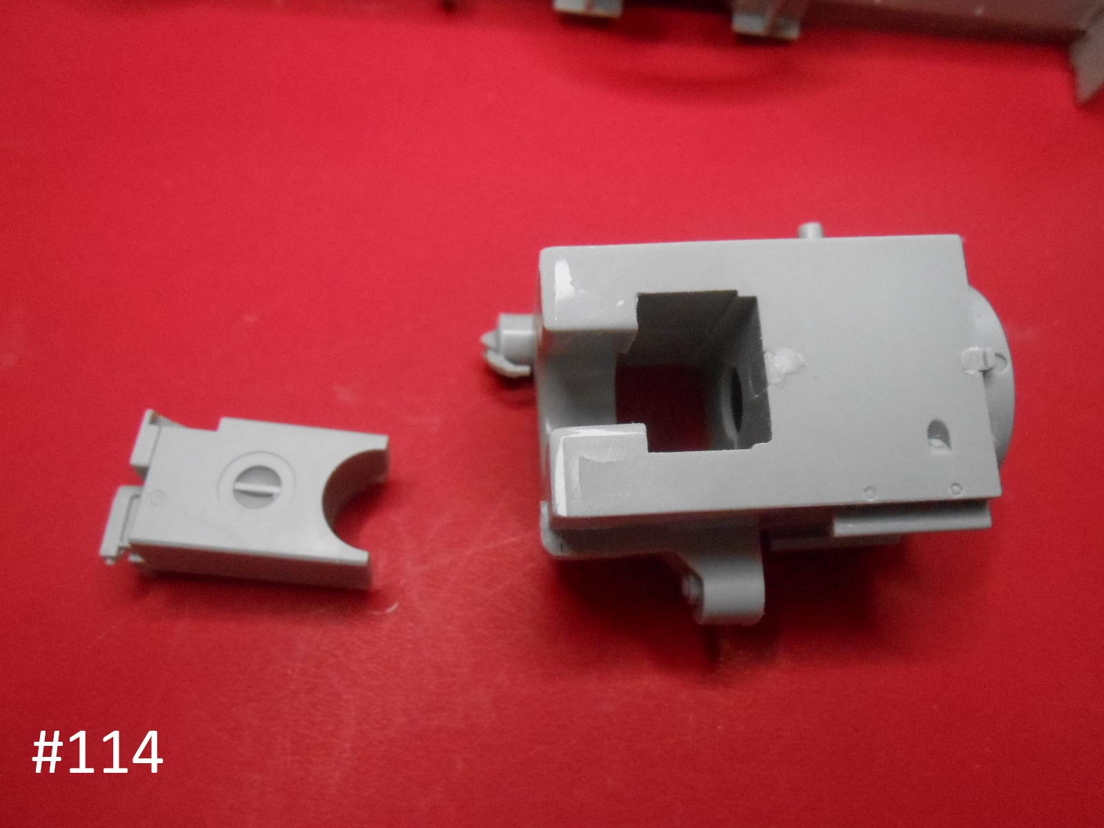

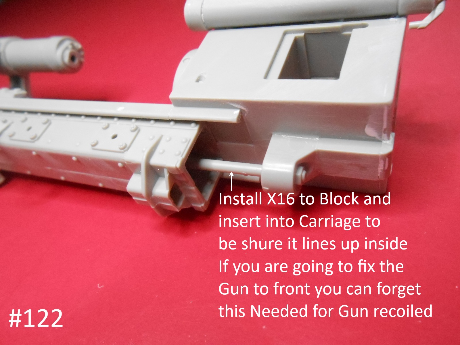

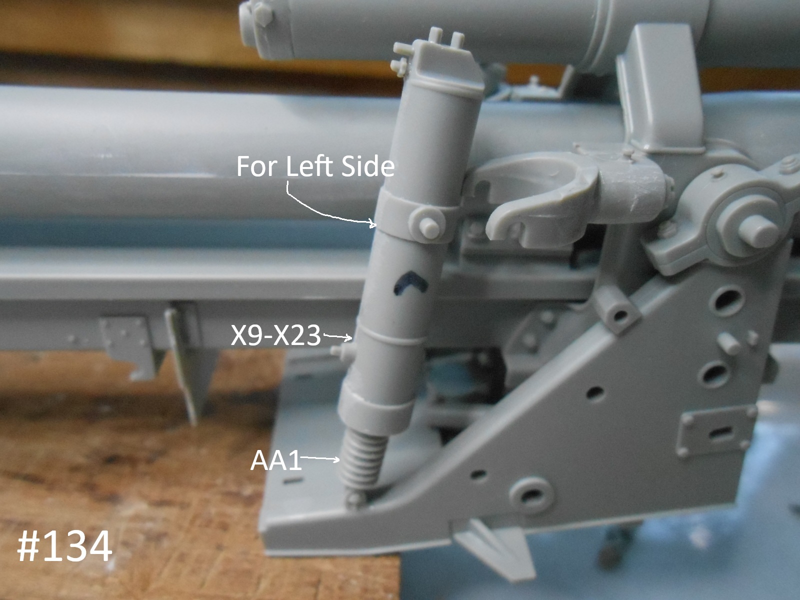

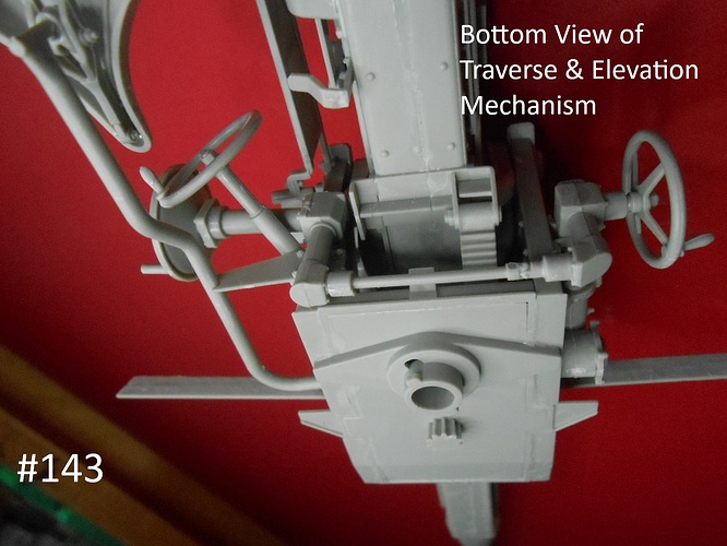

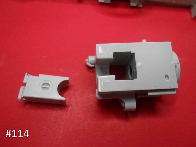

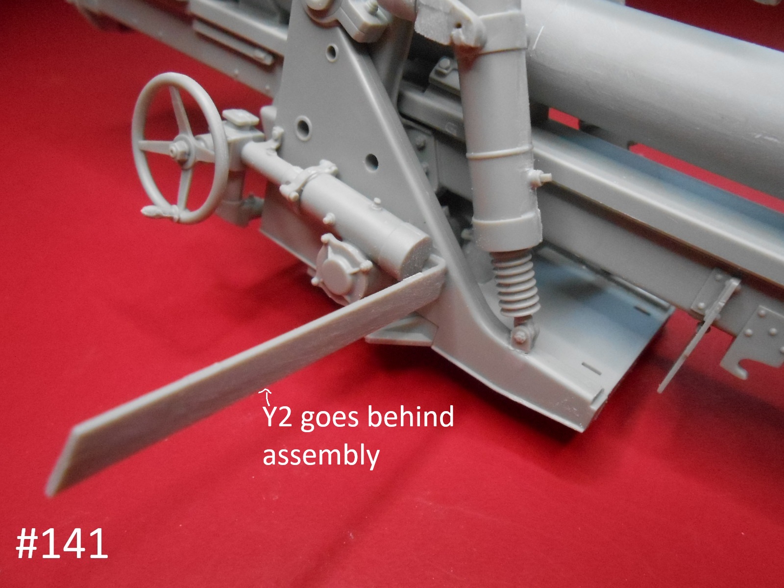

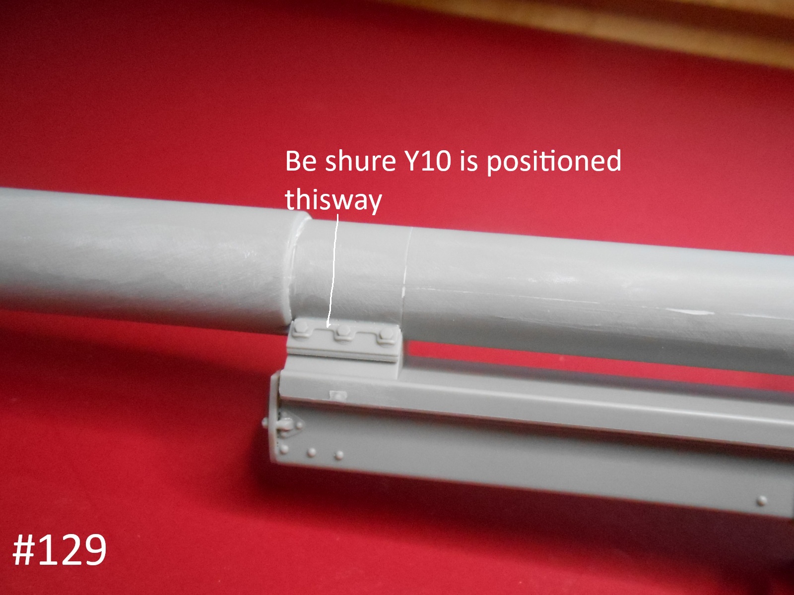

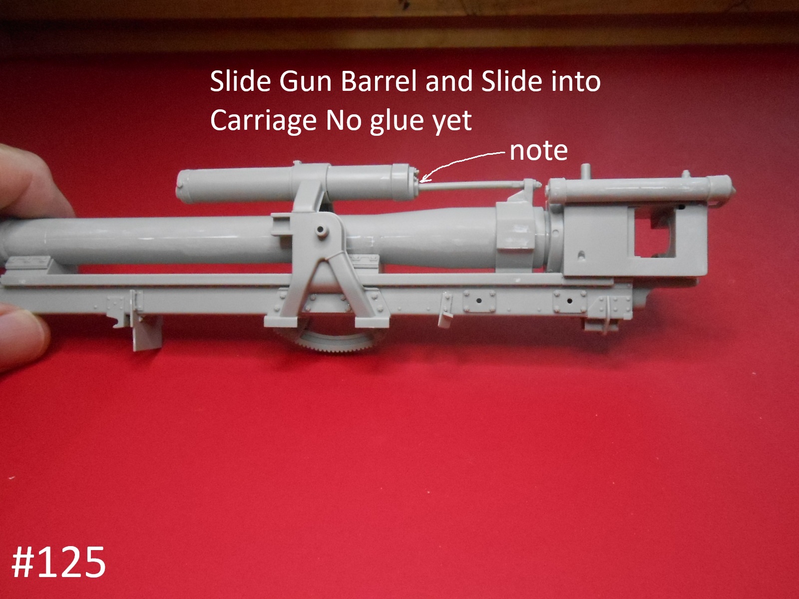

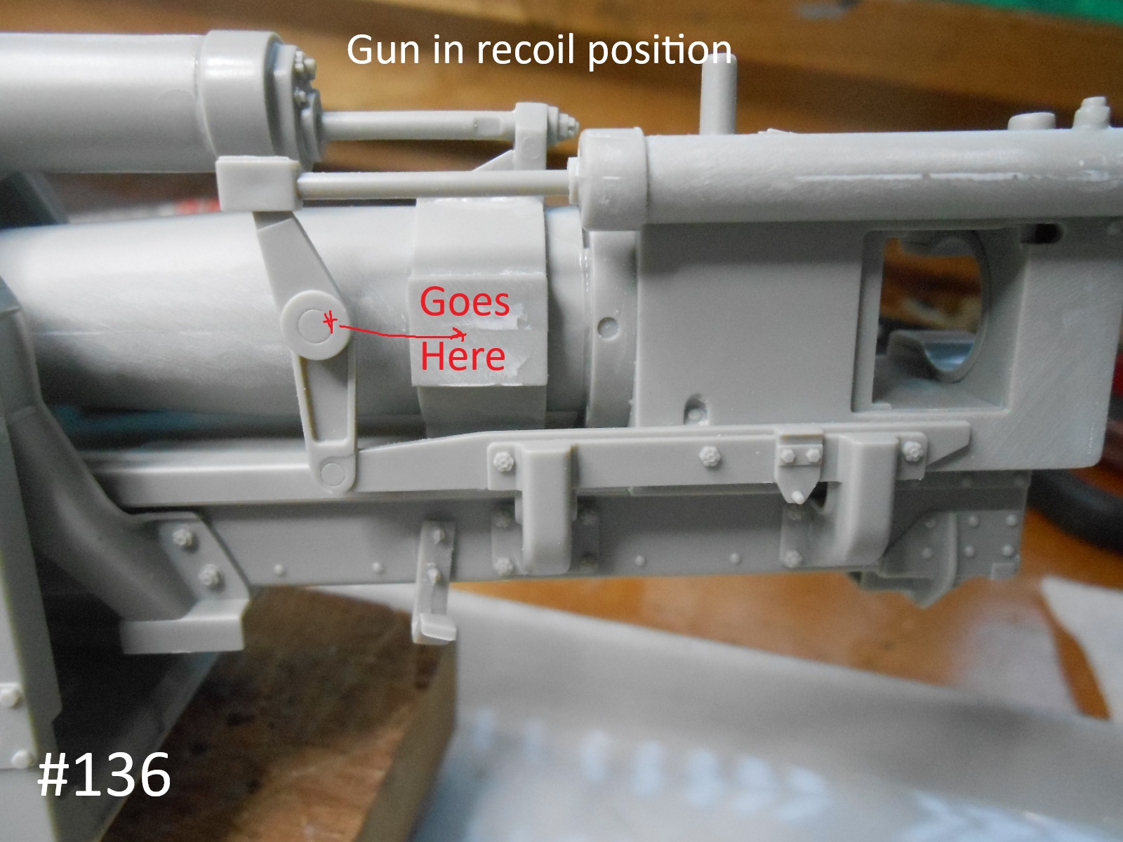

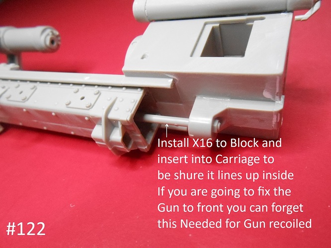

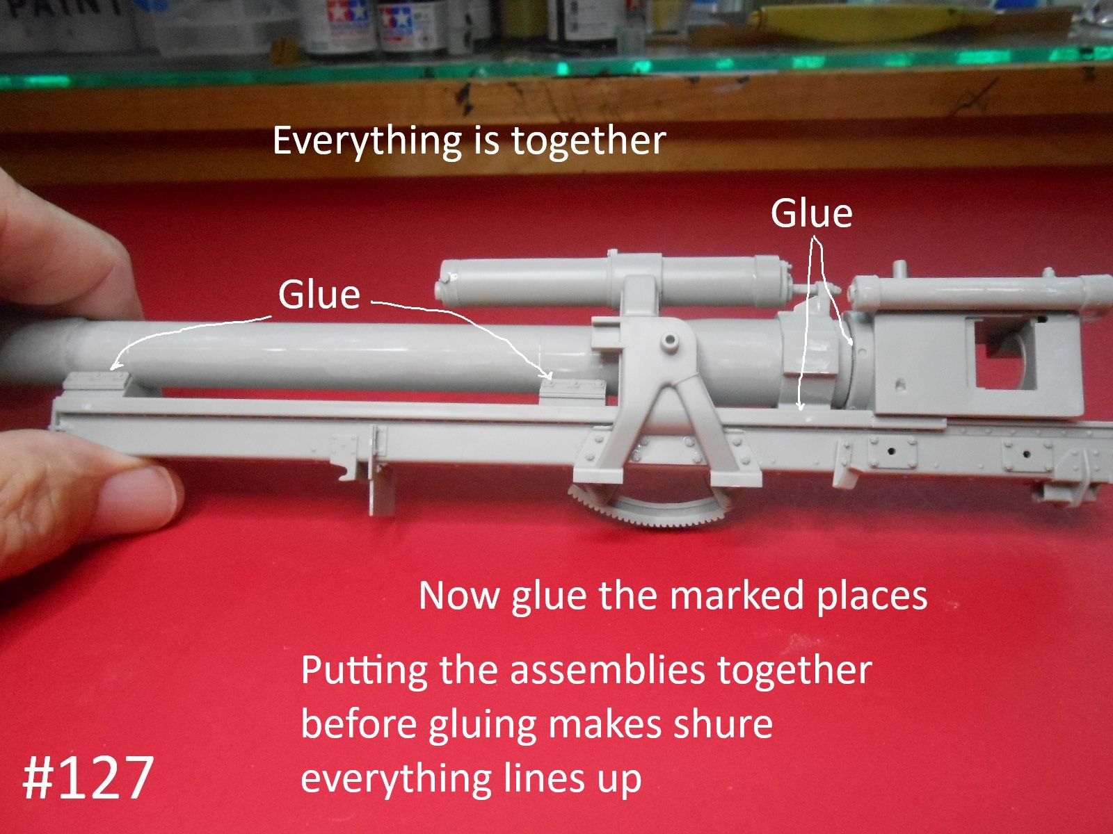

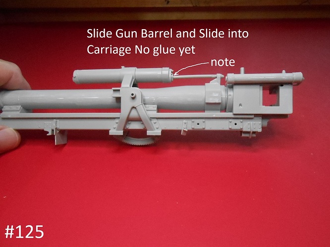

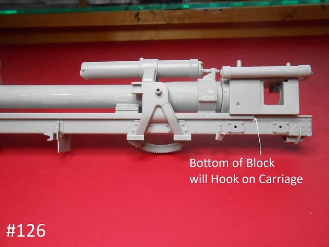

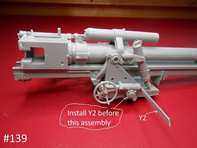

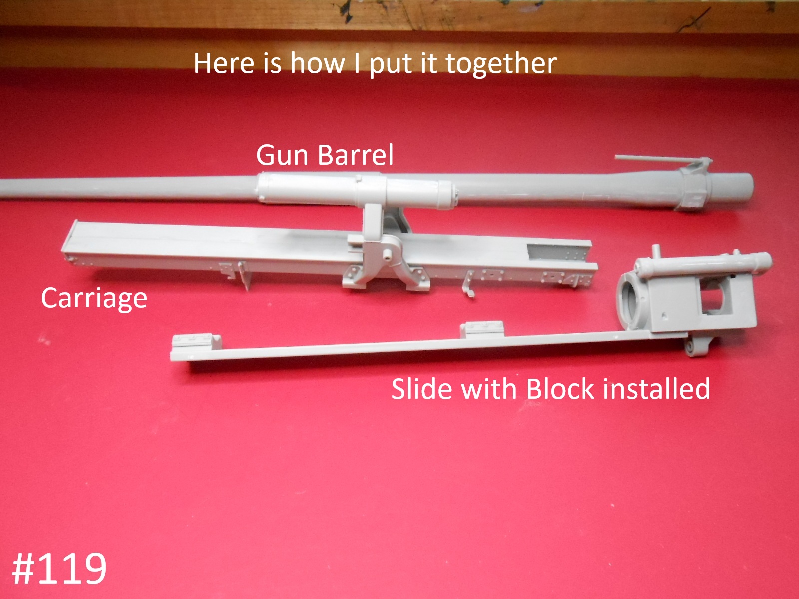

I have the main part of the Gun assembled, Here is how I did it in order
This was a really long part.
That’s all for today.
Donald

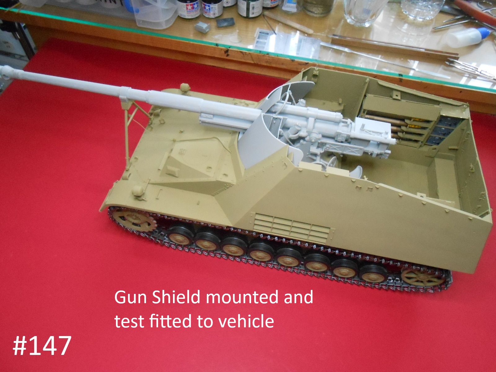

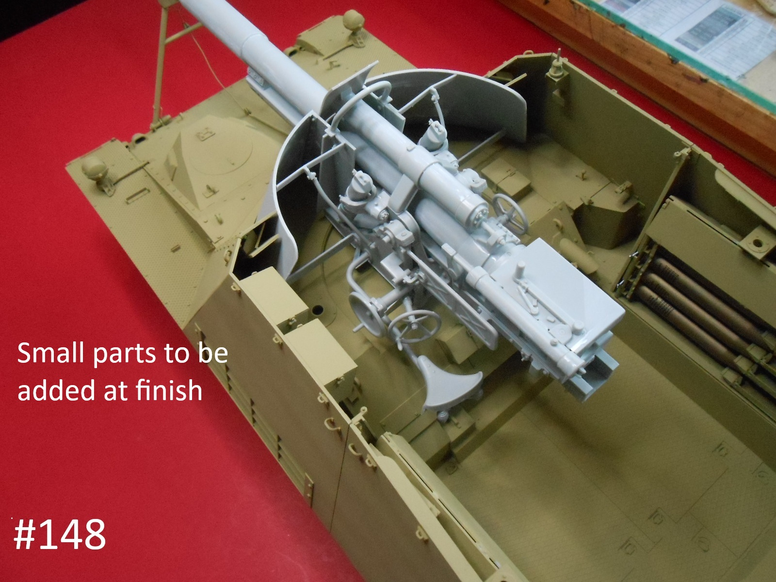

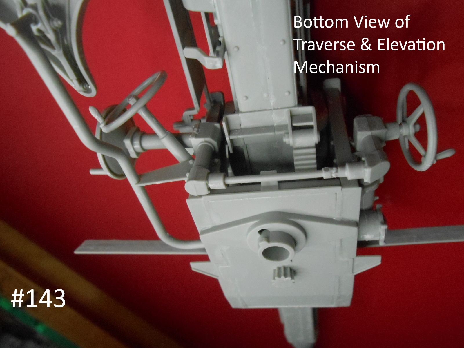

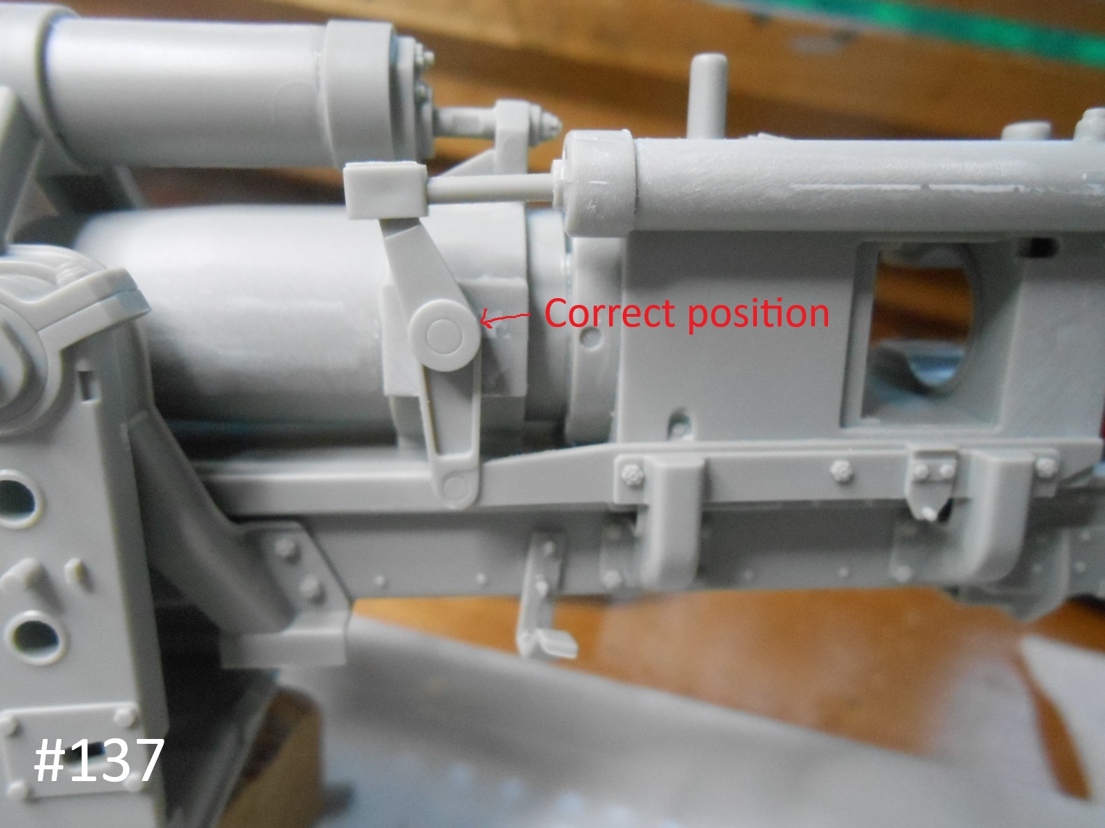

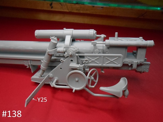

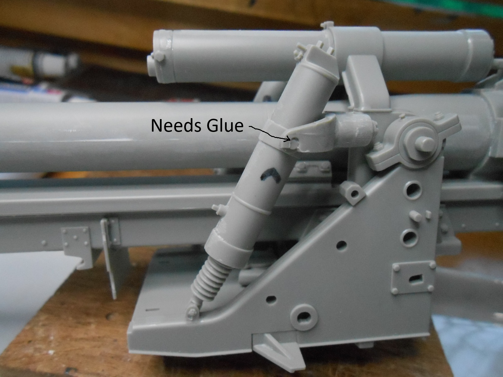

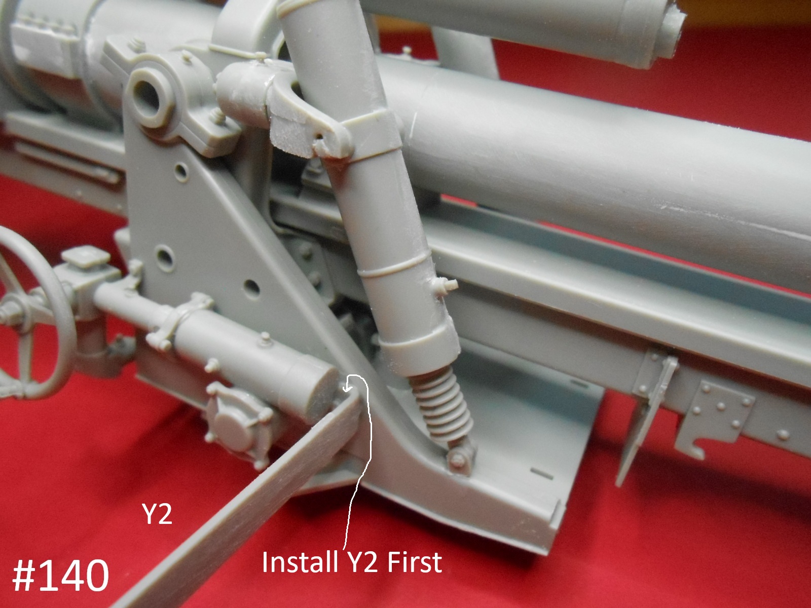

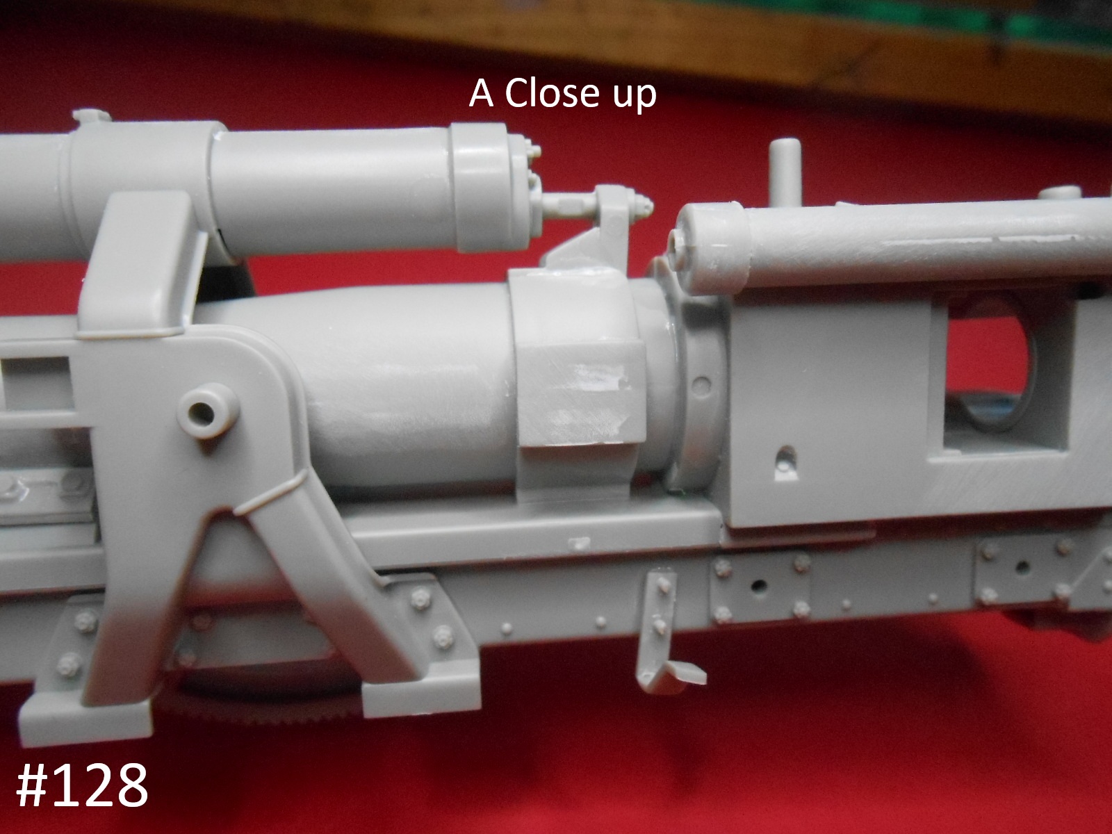

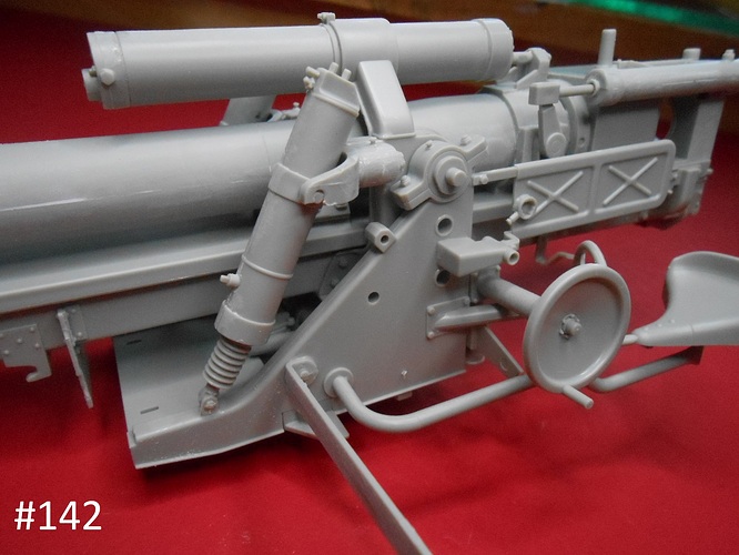

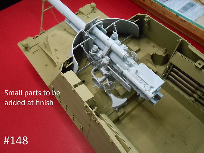

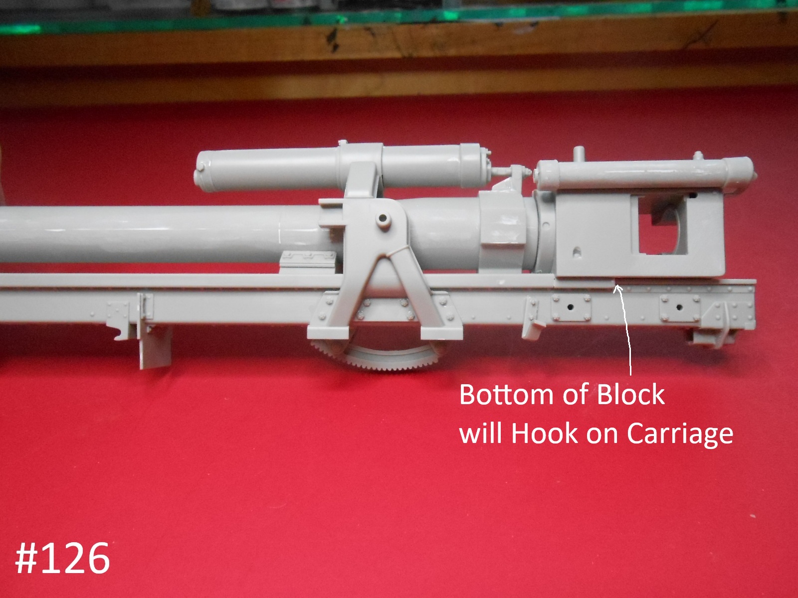

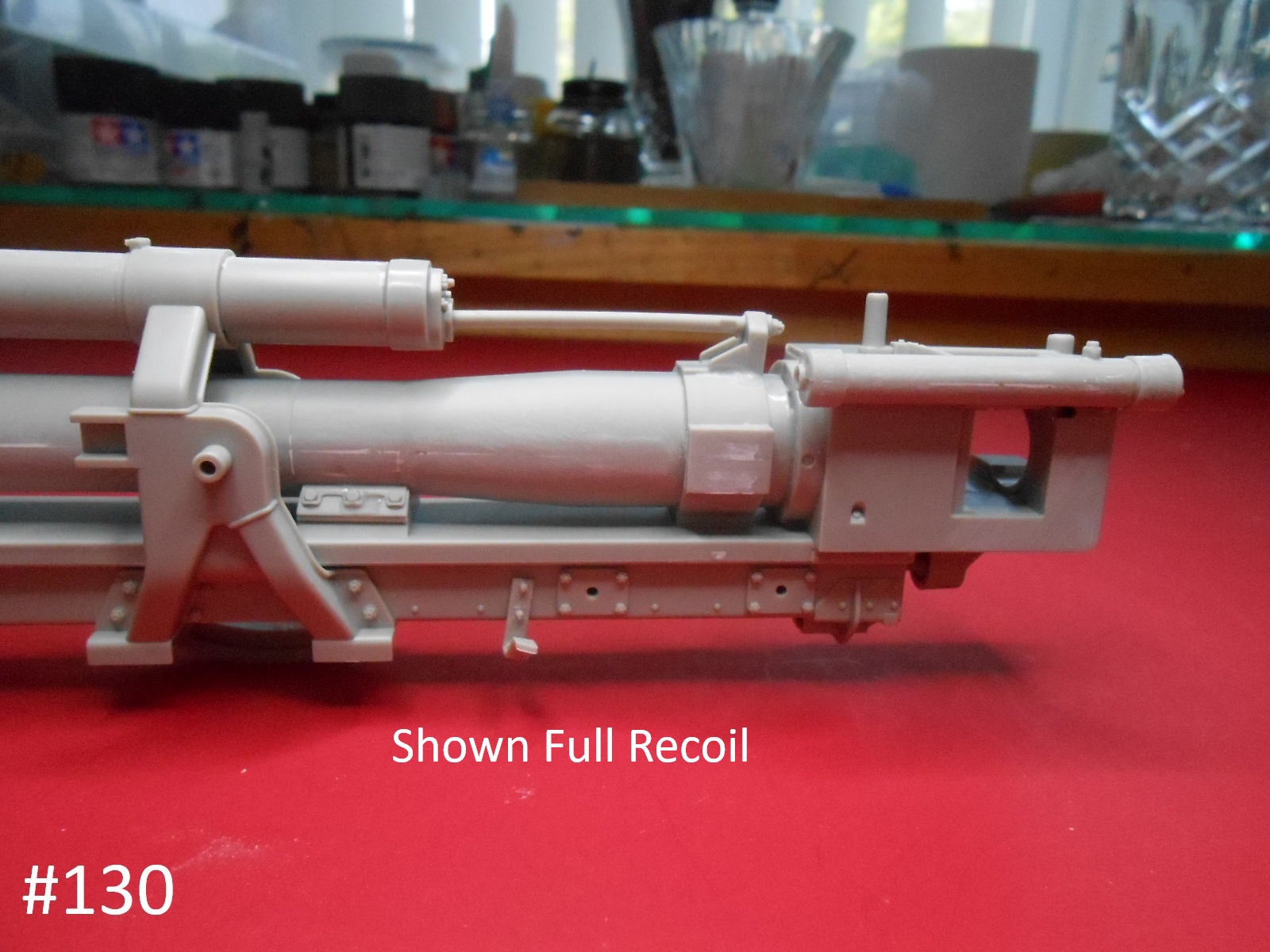

Today I have the Gun finished assembly and test fitted to the Hull.
Finished for today
Donald

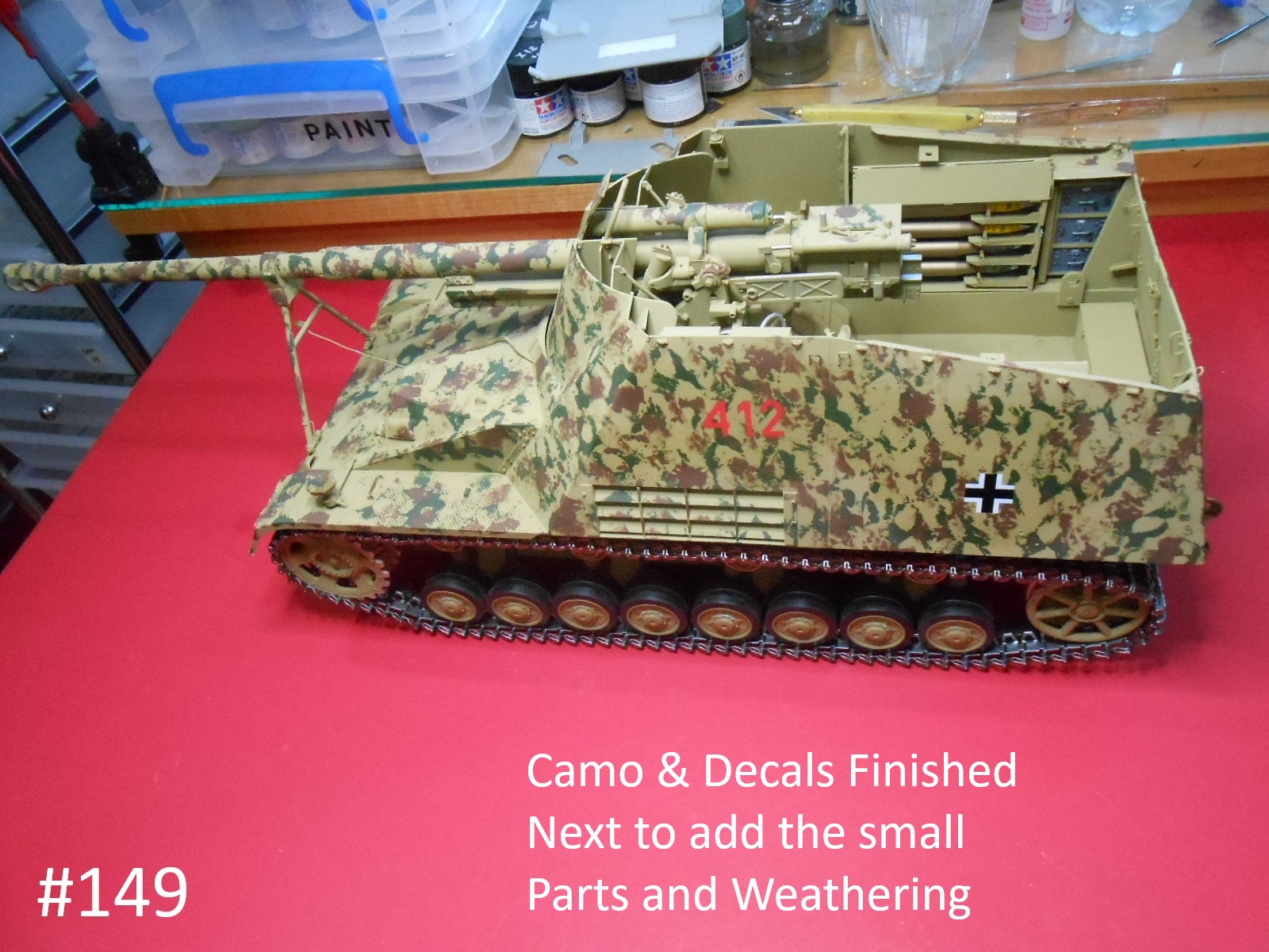

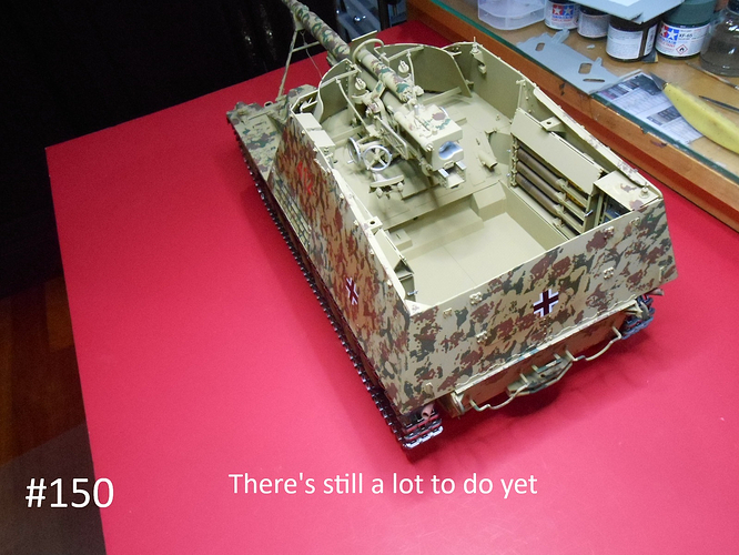

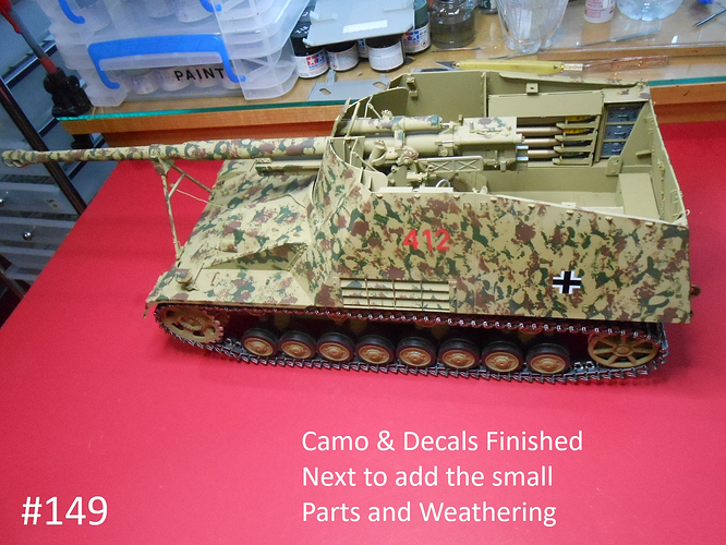

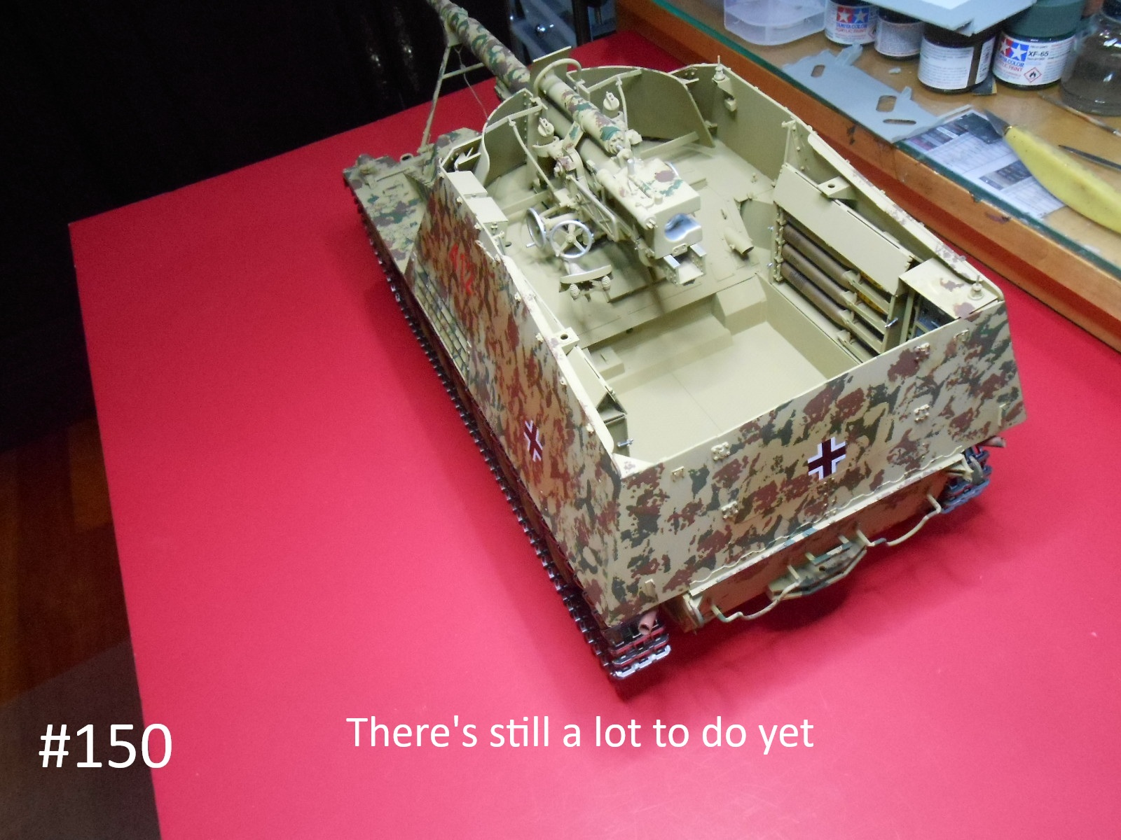

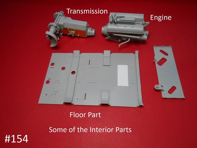

I have the Camo and Decals Finished.

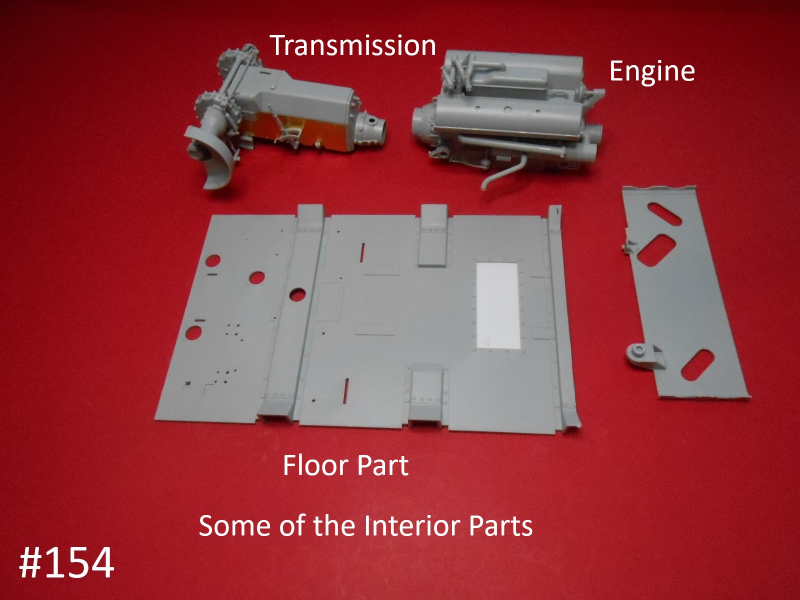

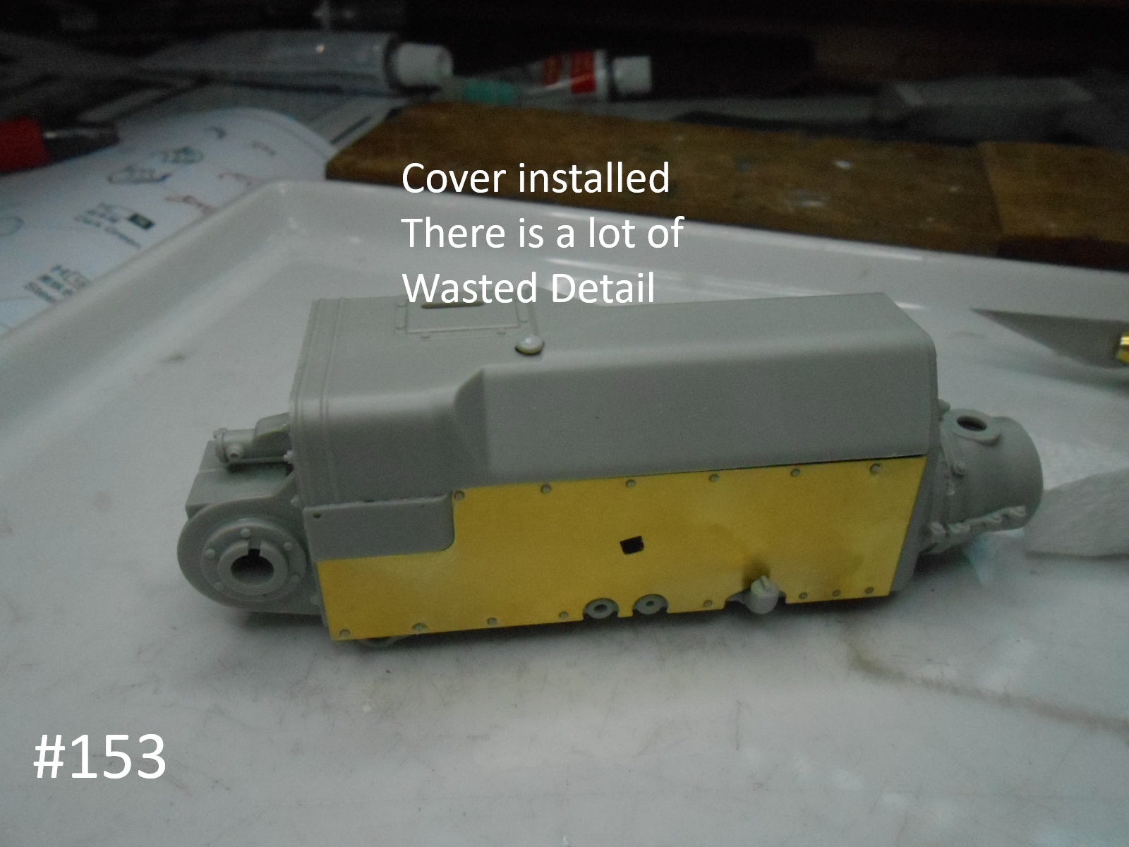

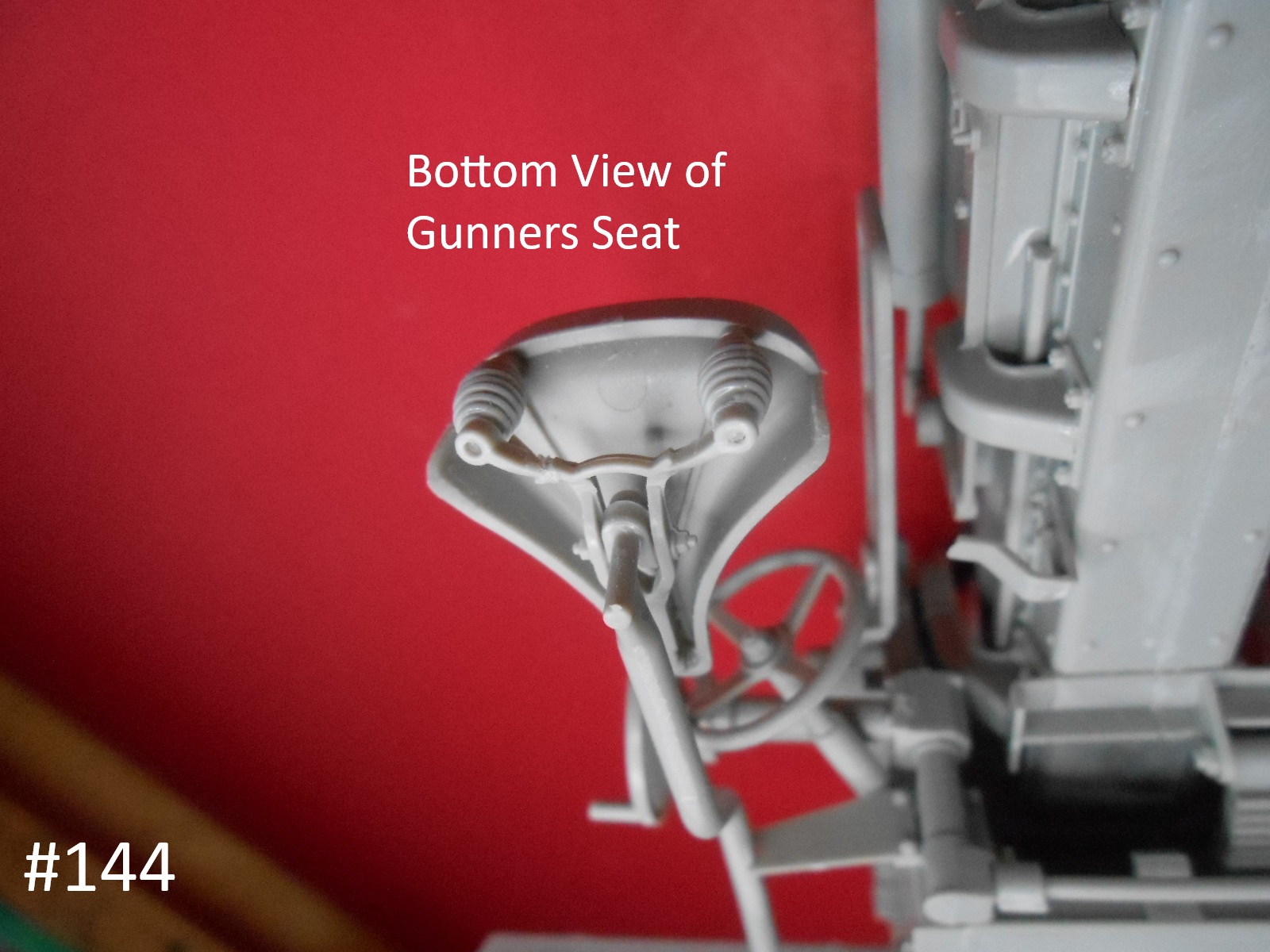

I am starting on some of the Interior parts as a separate Display, as they can’t be seen inside the finished kit.
Finished for now
Donald
