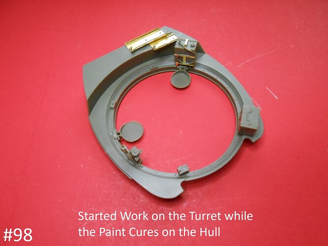

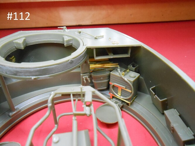

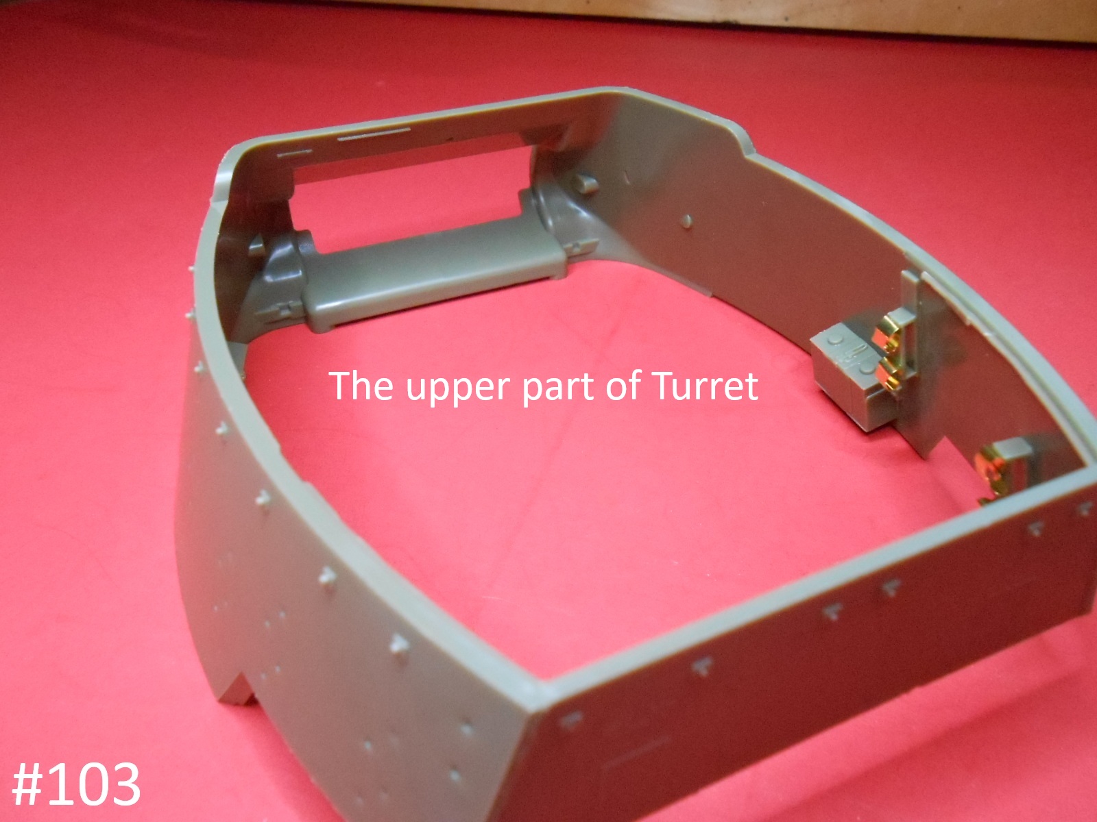

Working on the Turret now.
Finished for today.

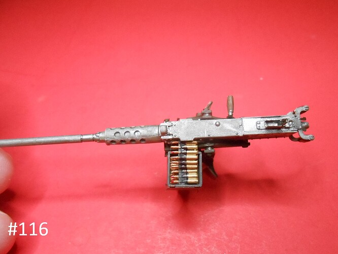

Today I have the 50 Cal. Mg.
The fit is questionable especially on raising and lowering the gun.
I’ll be working on the Tracks next, so it may be a while .

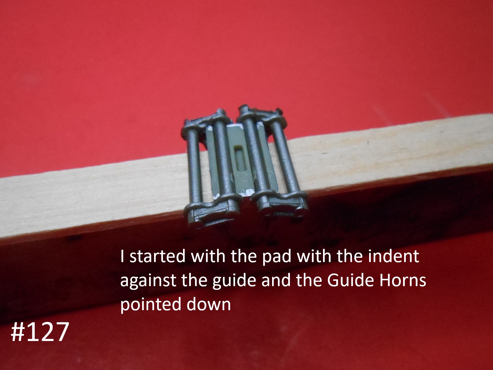

Well it took me three days to get it all cleaned up and assembled.
here it is.
It wasn’t really hard, just time consuming . .
Each shoe has 5 parts X 65 Shoes each side = 325 Pcs. X 2 Tracks = 650 pieces that’s a lot of Clean up and painting.
Now to weather it and then the install, Darn I hope it fits.
Regards
Donald
