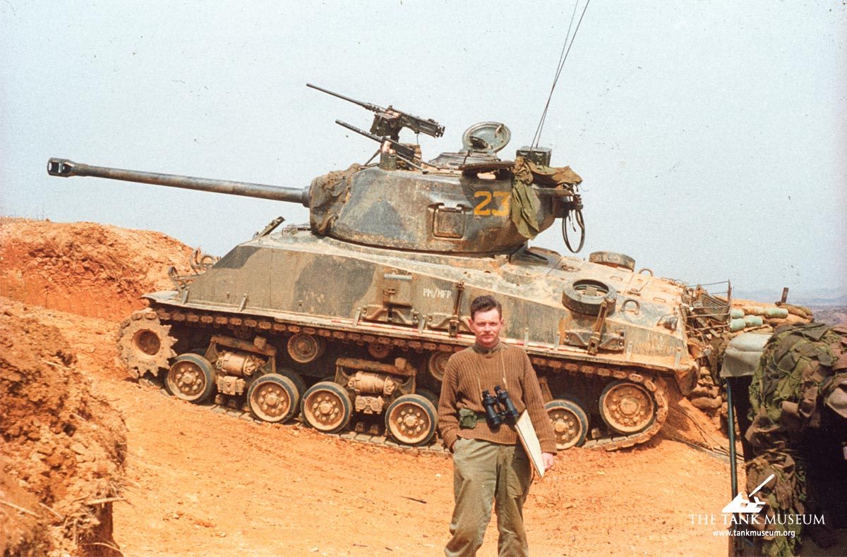

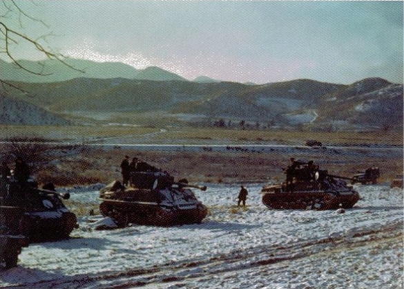

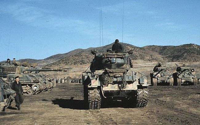

Some period color photos of Canadian Sherman tanks in Korea
I would highly recommend purchasing this book:
The first photo is not a Canadian Sherman sorry.
You are correct to paint your Canadian M4A3E8 in OD. Modifications to the C Squadron tanks very limited….the spare tracks on the glacis plate and the spare road wheel on the right side of the turret were it. Later follow-on Squadrons had heavier mods with additional tracks on the hull and turret sides, hull storage racks, and moving the turret .50 Cal mount forward. B and A Squadrons also used yellow lettering instead of the white used by C Squadron. Good luck with your build!
Then you have this one which I’m not sure but think it’s Canadian as part of the Commonwealth Division judging by the mix of troops riding the tank.
Top photo is the famous photo taken when our B Squadron had just taken over from C Squadron , showing B Squadron crossing the Imjin river July 16th, 1952. The second photo on the bottom is not a Canadian used Sherman.
