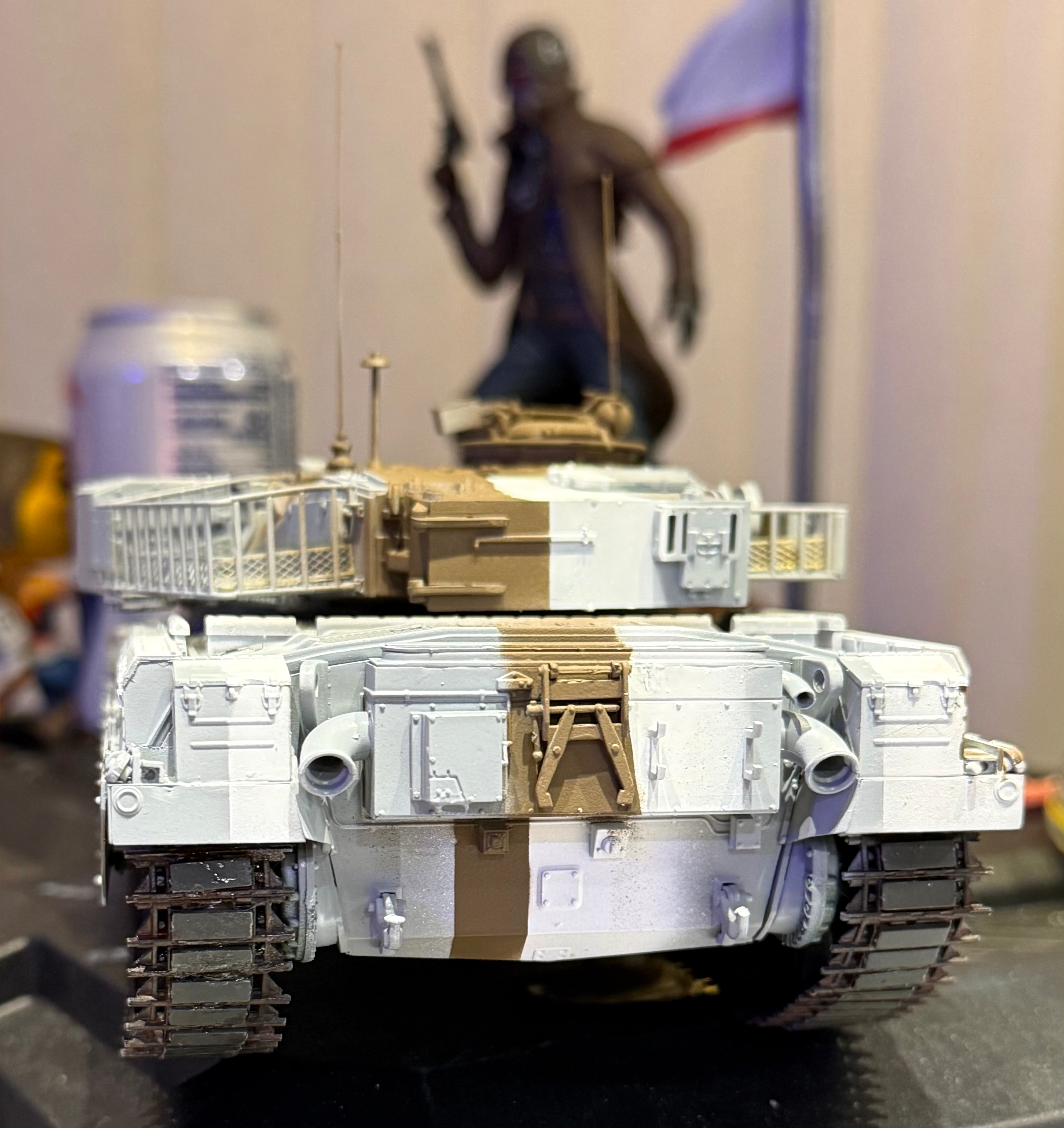

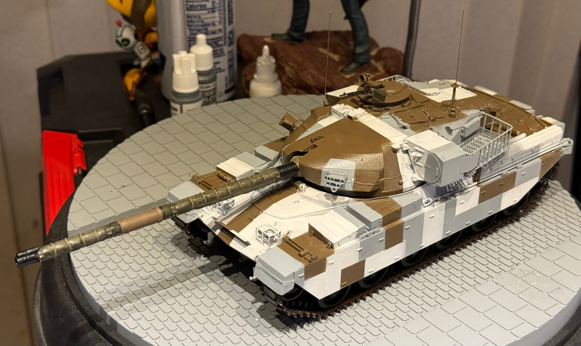

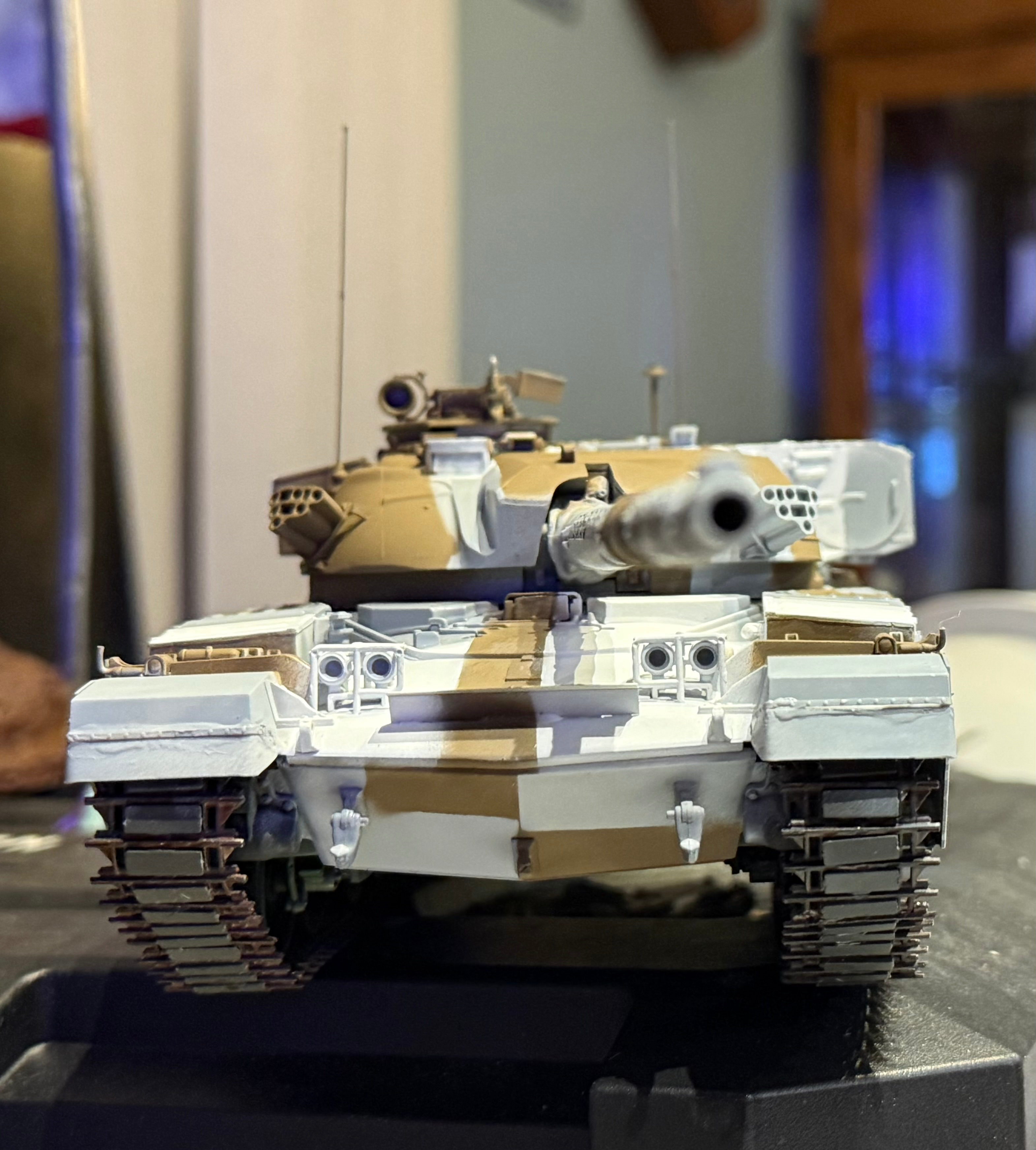

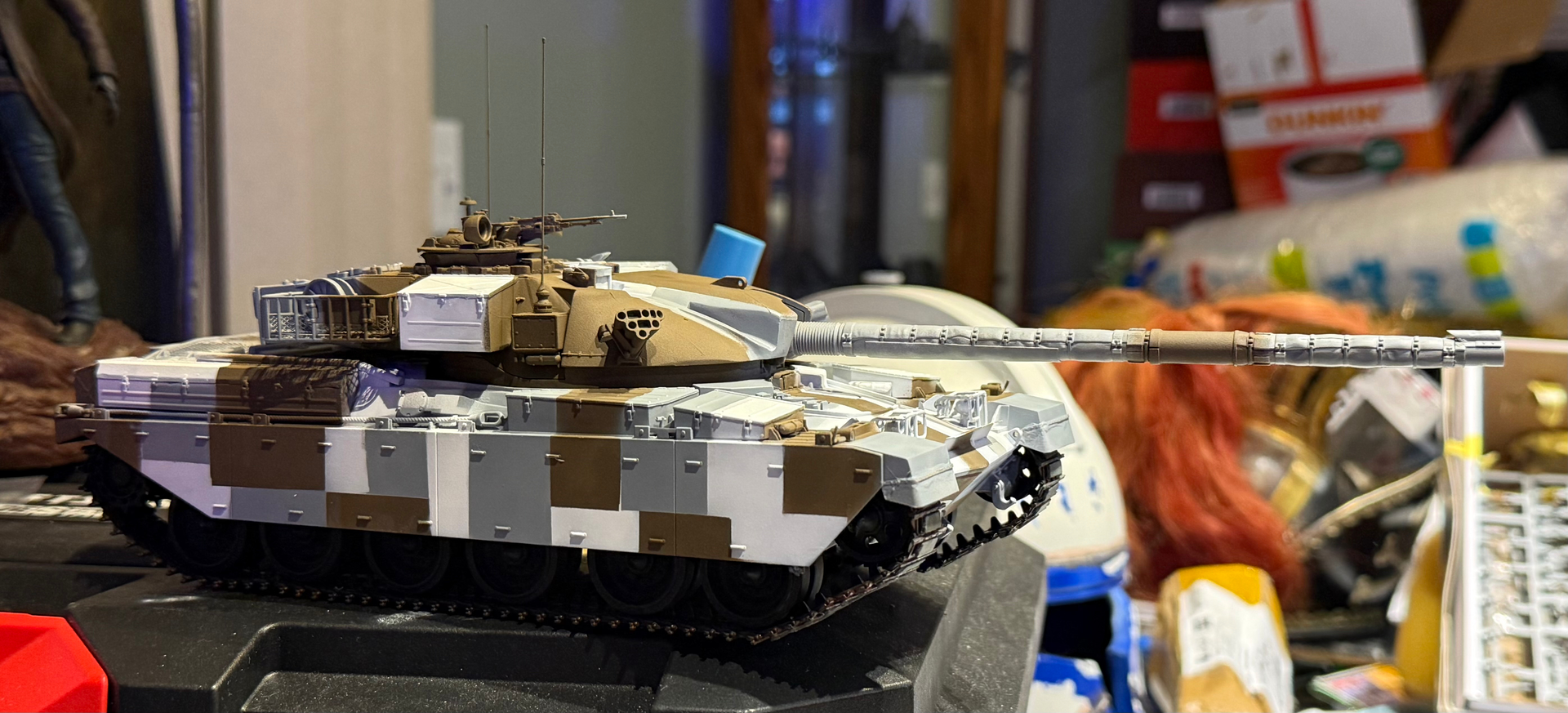

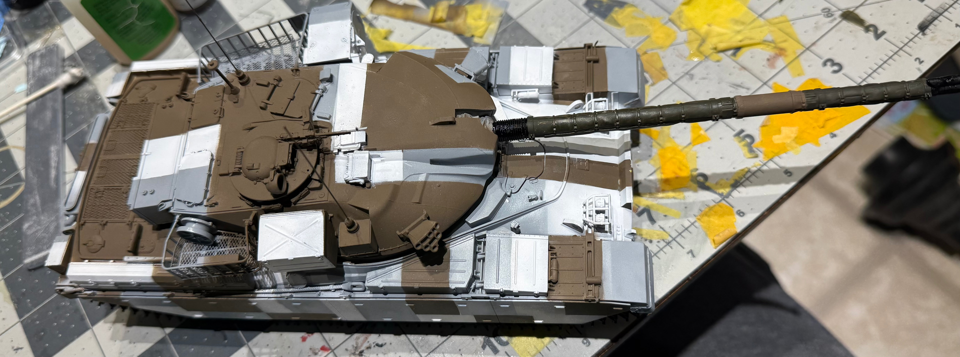

Work so far on the Takom Chieftain Mk10.
I decided to build it as the 14/20th Kings Hussars in the Berlin Brigade in Germany, 1989.
I hand taped off the camo and painted it with Blue-grey and the SCC2 brown.
I used Scorpion model Works Bowman antenna set instead of the kit antenna bases. EDIT: it’s the Clansman antenna set, not bowman. I can’t read apparently LOL.

Nice build. You may need to address the engine deck colour unless you haven’t finished it yet …… It should be brown all inside the resilient rail area :+1:
I haven’t done the engine deck yet.

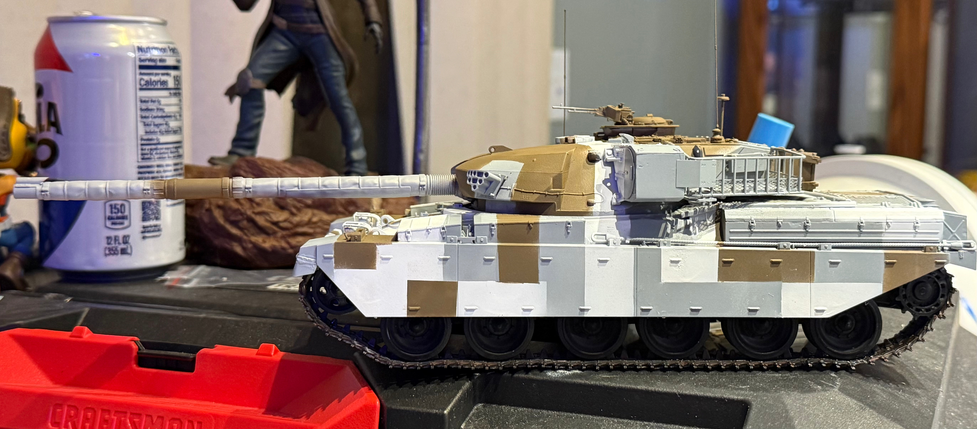

Barrel was painted and engine deck painted.
Gotta paint the MG and ammo can, then think I can gloss coat.

Gloss coat added. Decals and then washes next.
I use Tamiya x19 smoke or that and a mix of x25 clear green …. Looking good :+1:…. And Comd spotlight lens :+1: but I’m guessing those and headlight lens will be last on…..

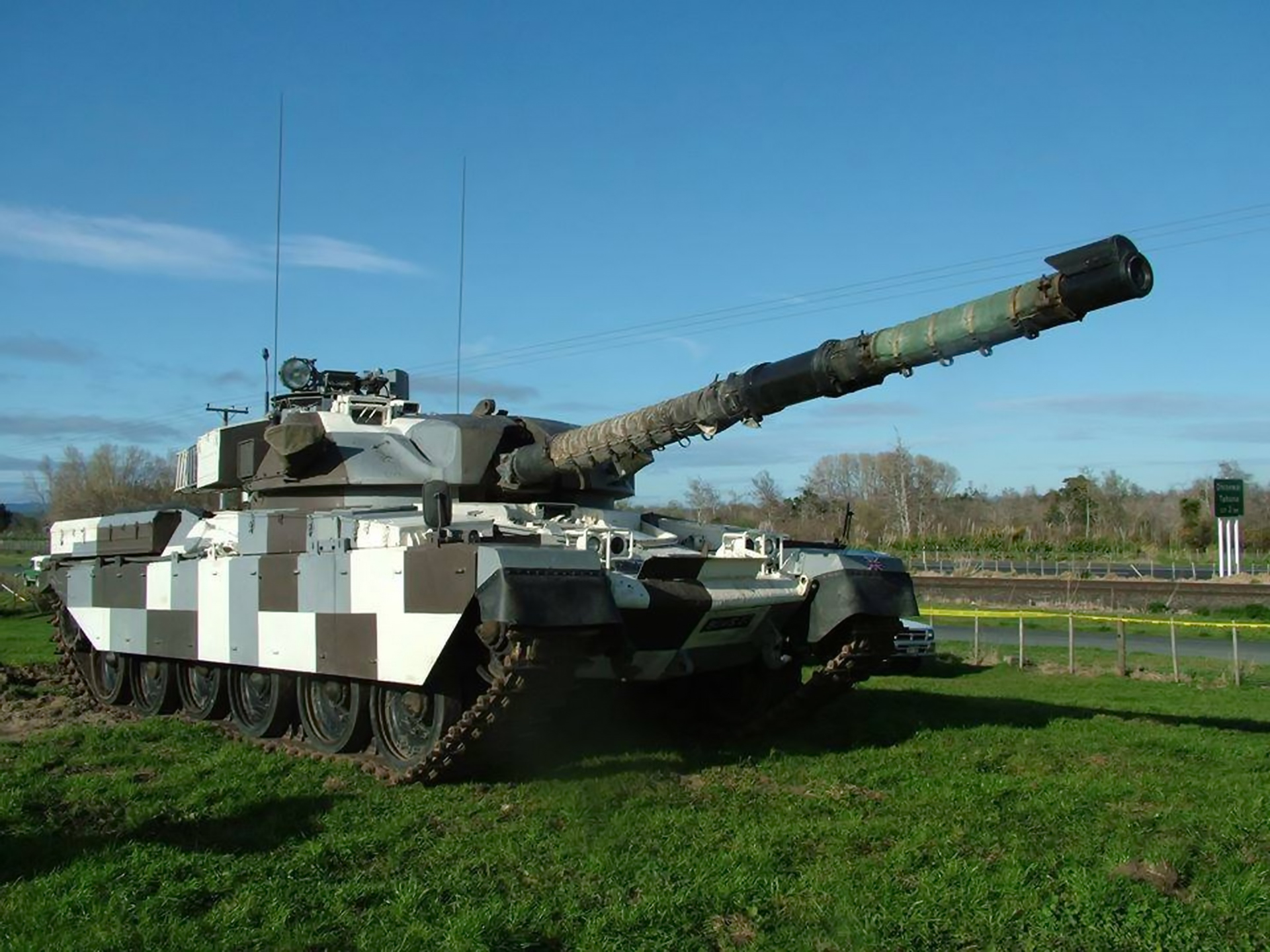

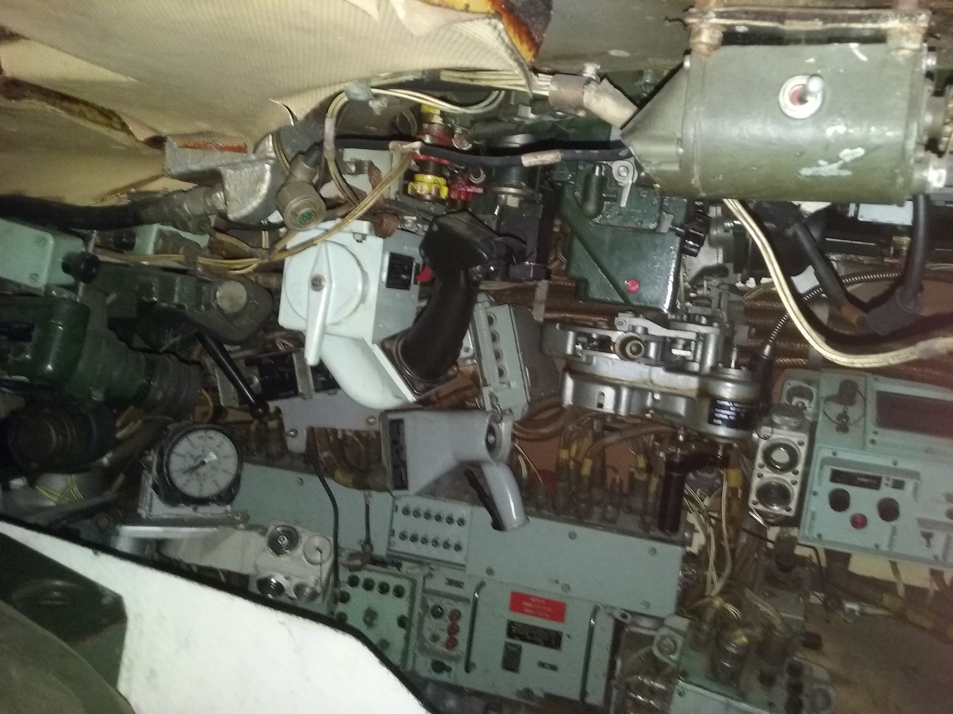

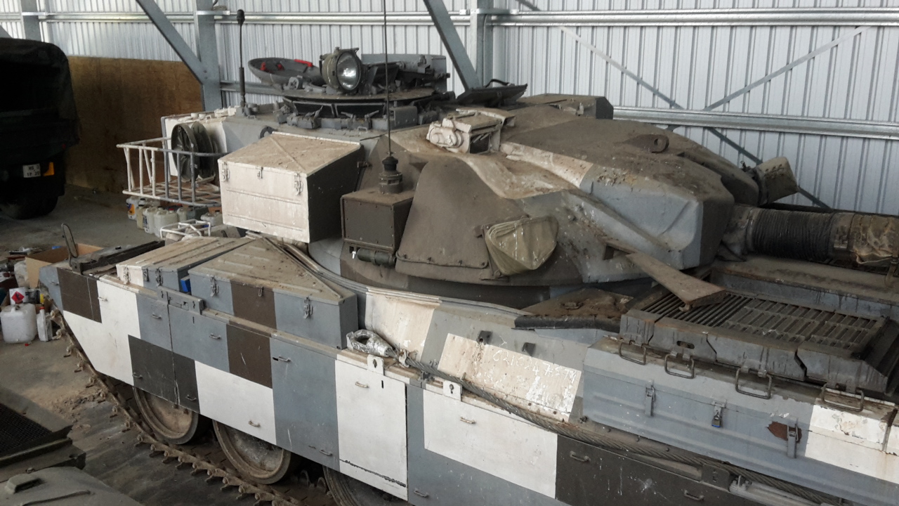

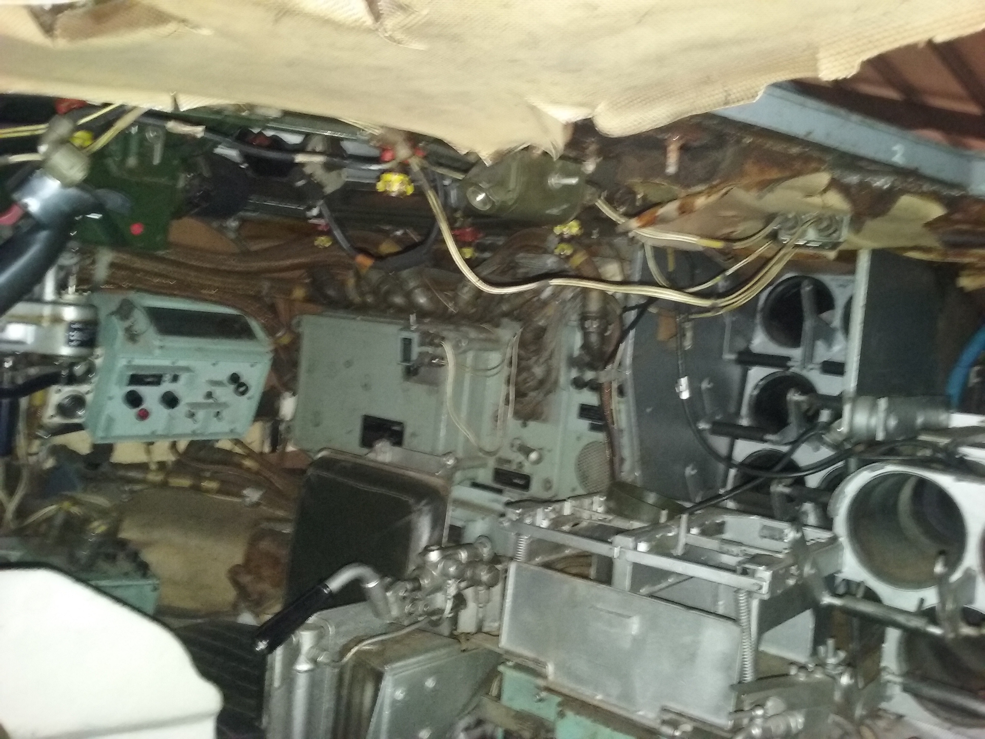

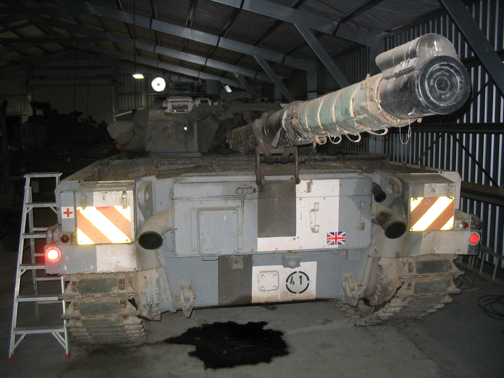

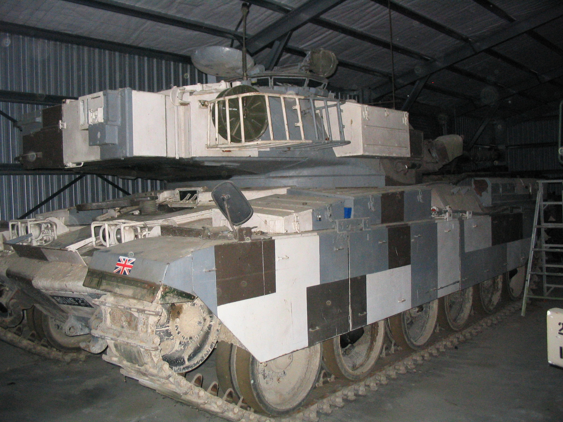

i got a crawl around this one in New Zealand a couple of years ago and some of these you will see the antennae bases it has fitted (some of these are not my pics but of the same tank)
i am sure they were using Clansman systems

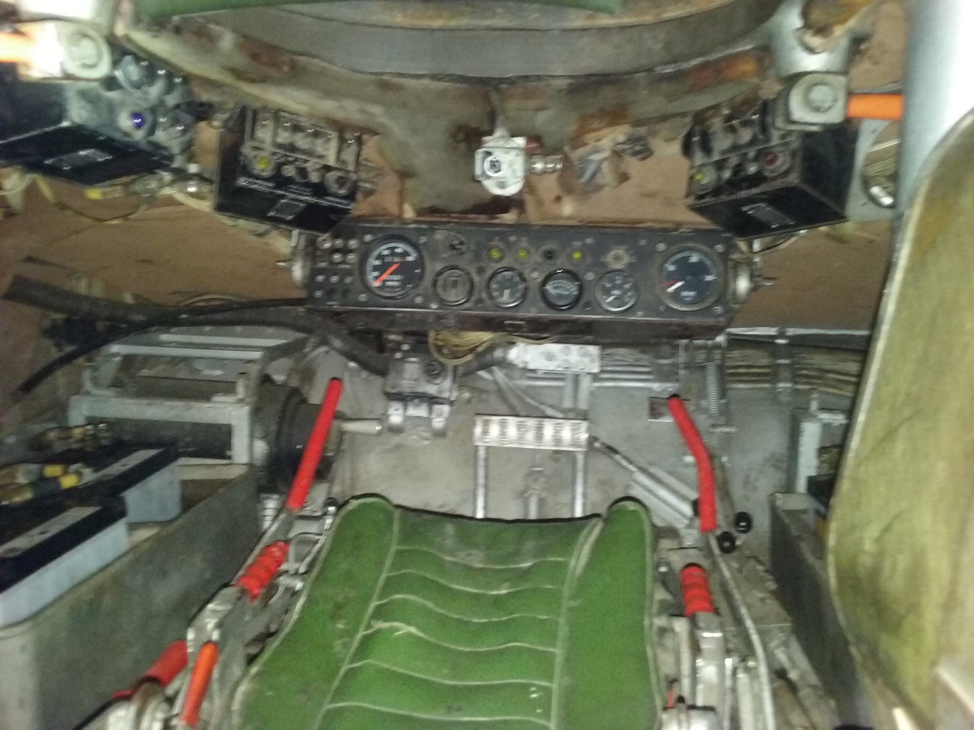

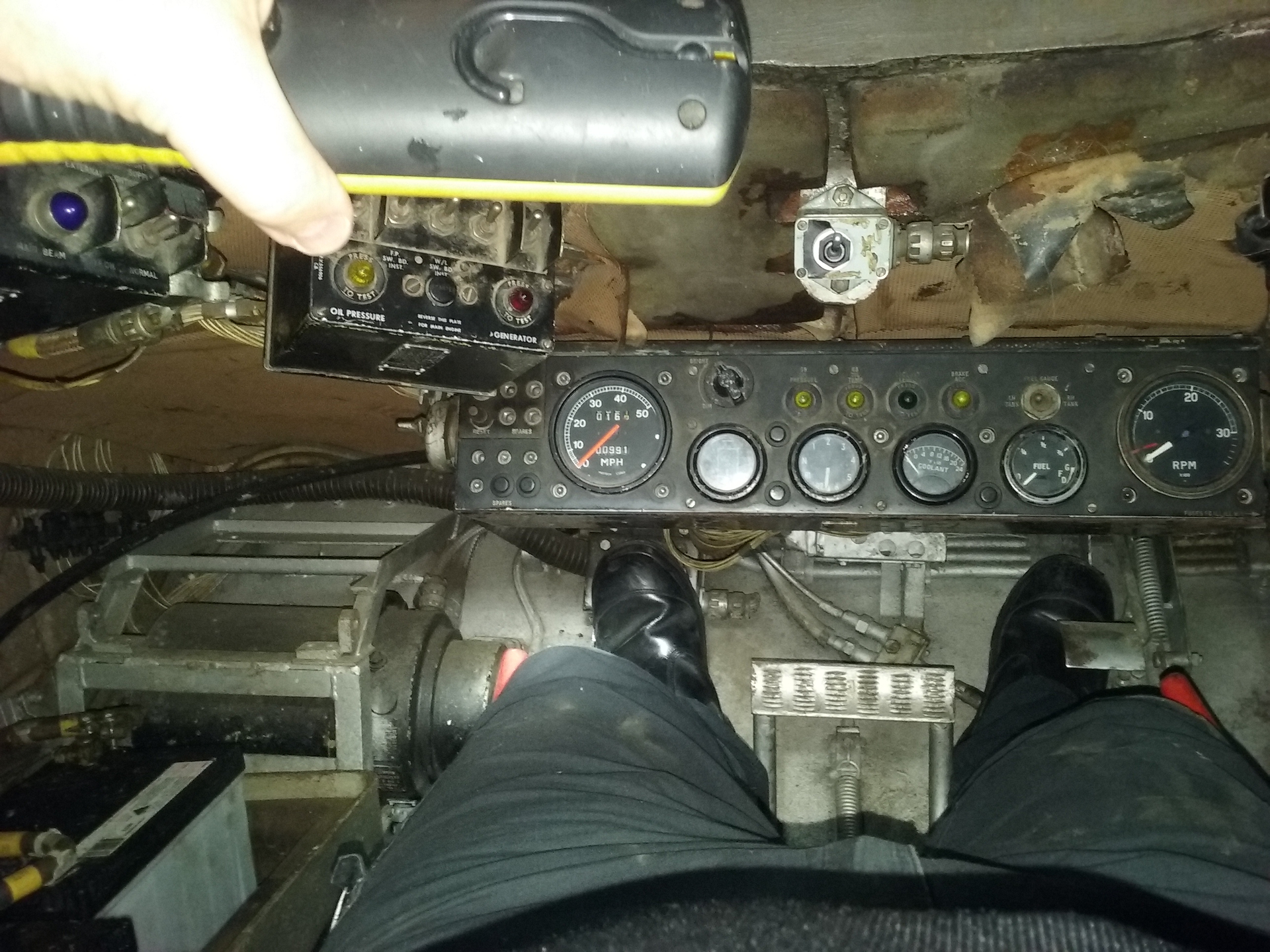

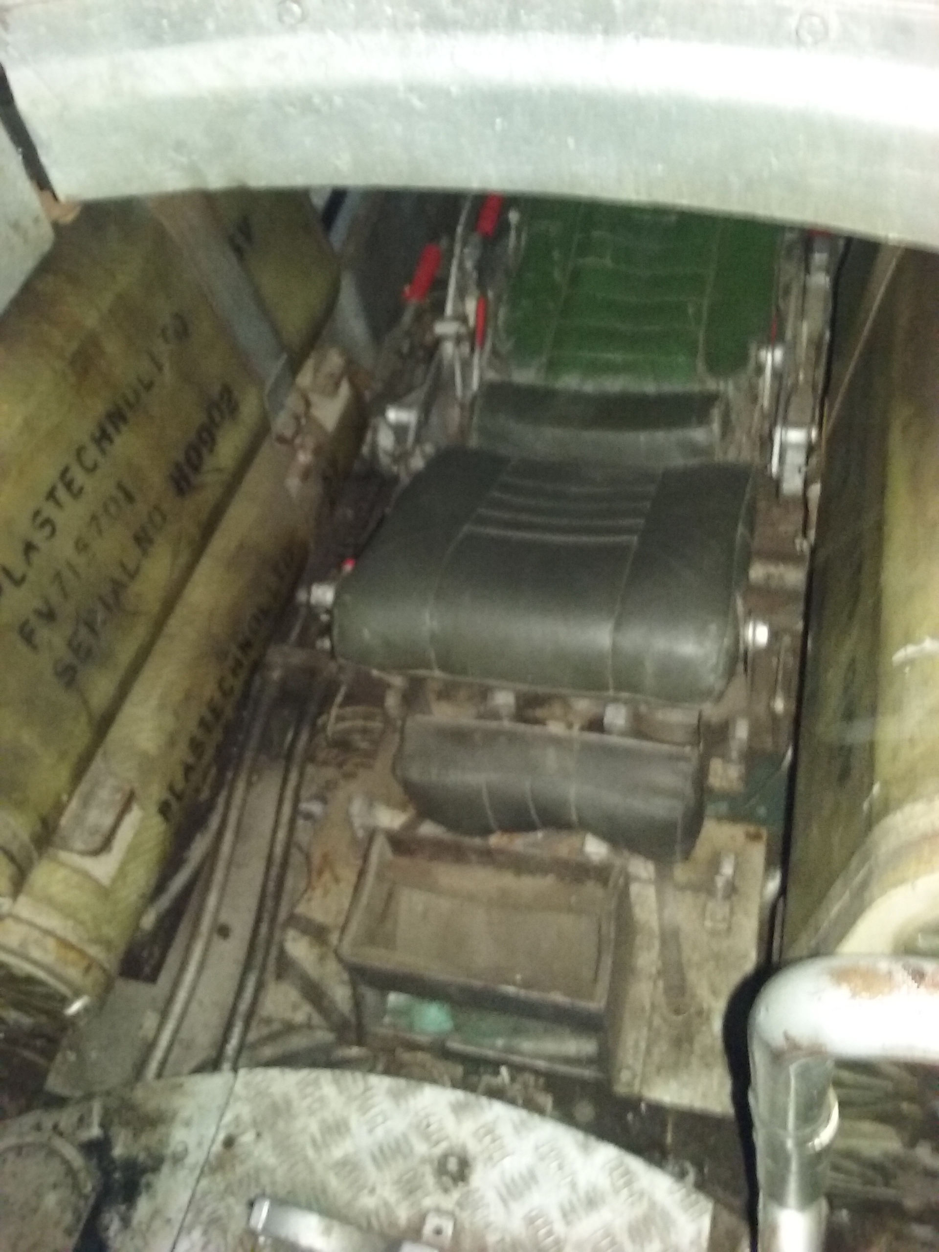

managed to get my fat rear end into the drivers seat
with the turret facing the rear it is easy to get down into the seat

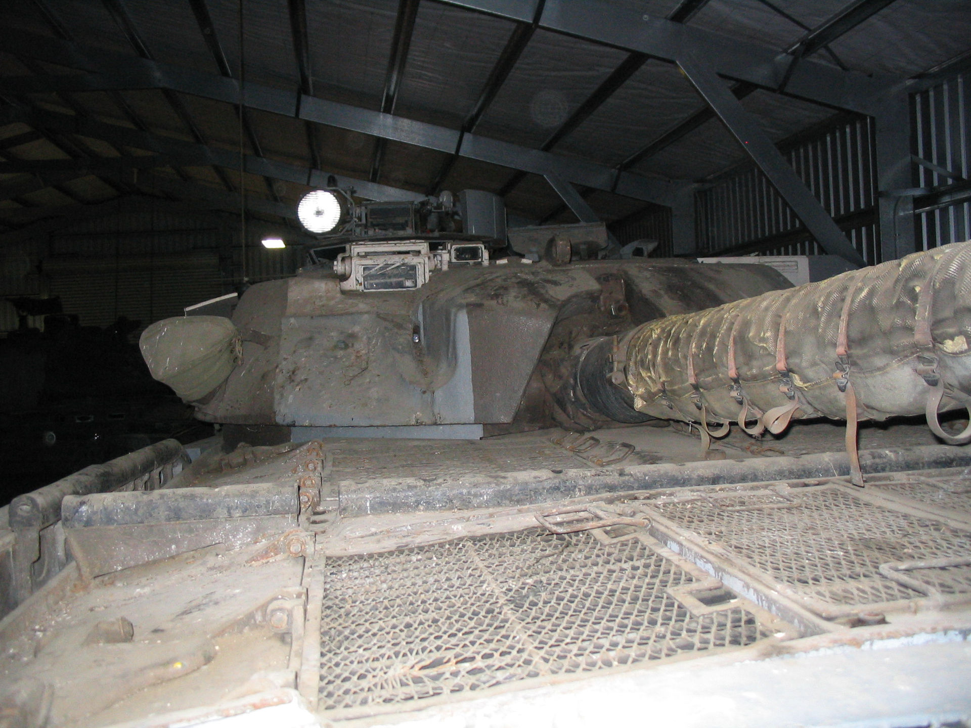

rear of the turret, the opening is just below
looking across from the loaders station
gunners station

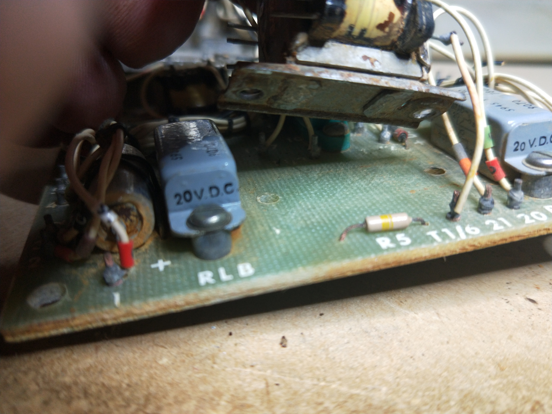

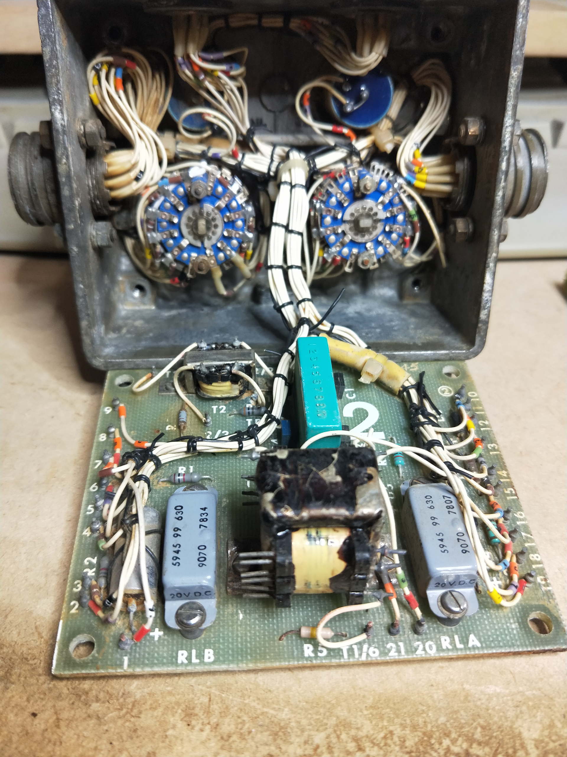

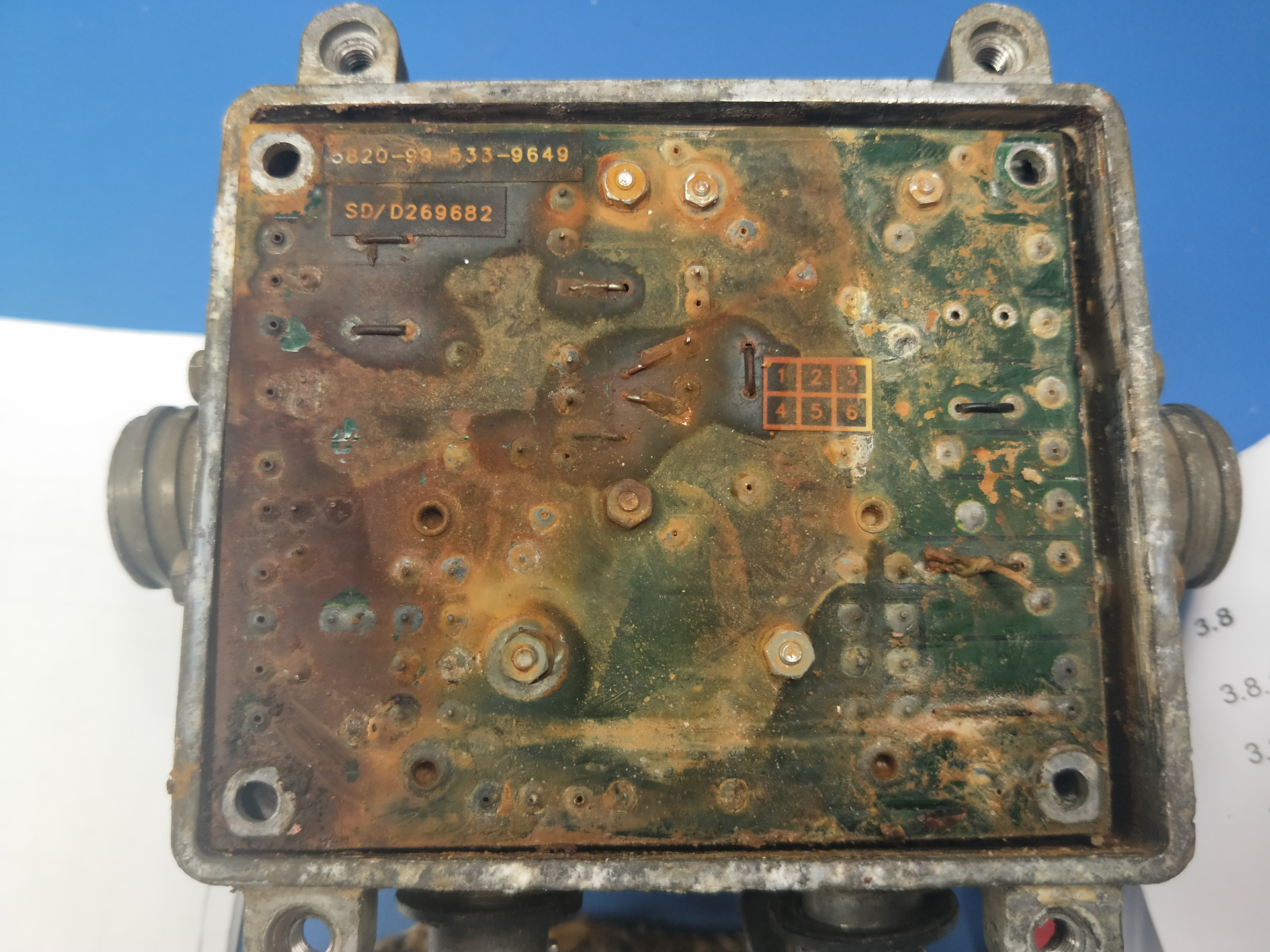

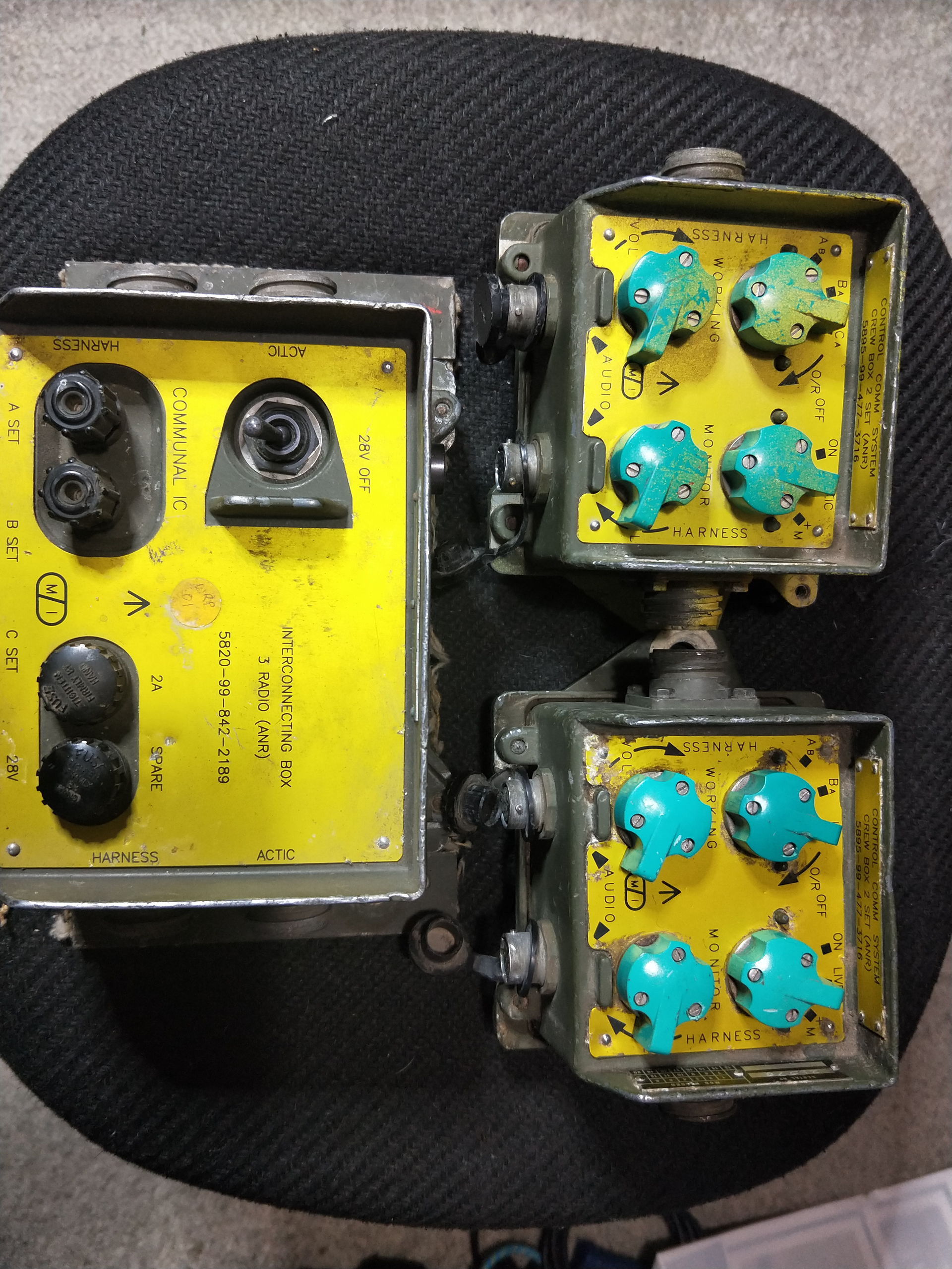

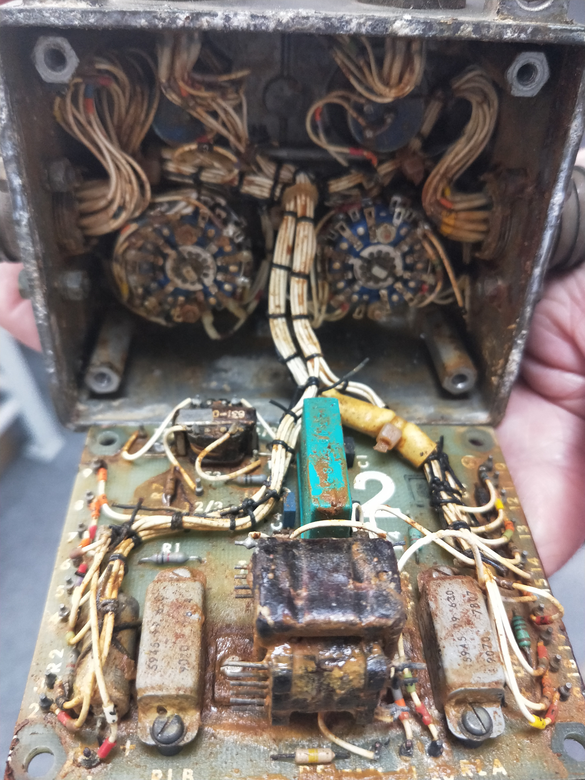

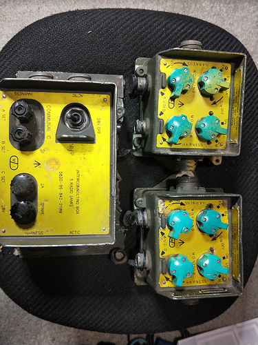

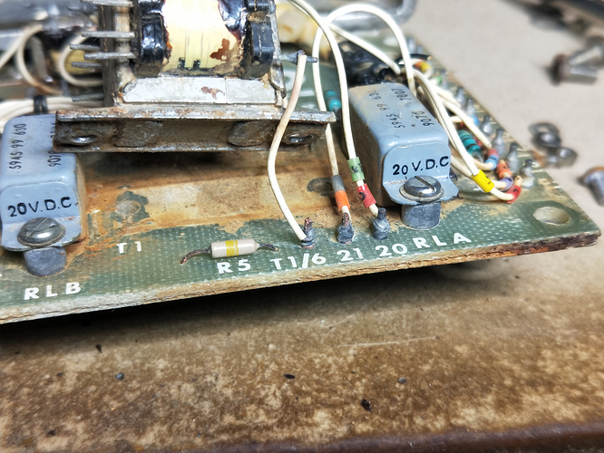

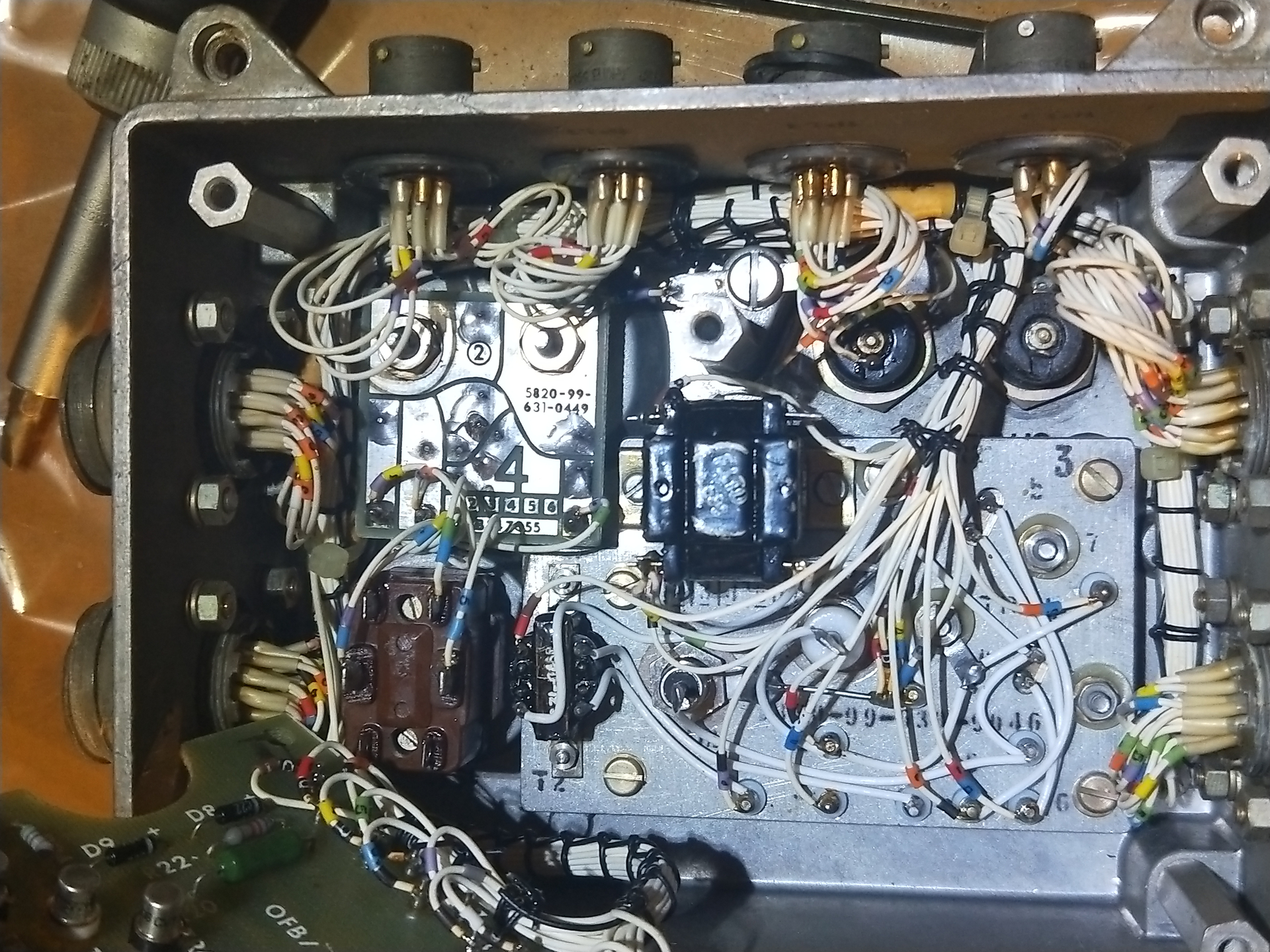

the clansman systems have some amazing wiring in them for how old they are, they also had built in noise cancelling which was classified when they came out. we used some in an M113 i helped with for 5 years as you don’t need a radio fitted to run the IC. everything has multiple redundancy in the wiring harness.

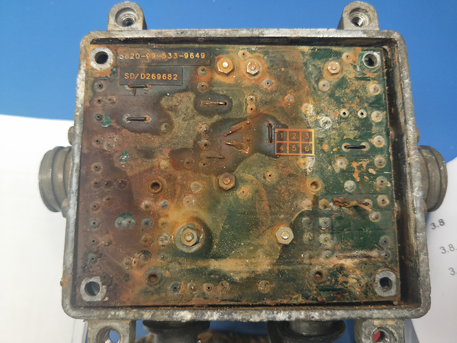

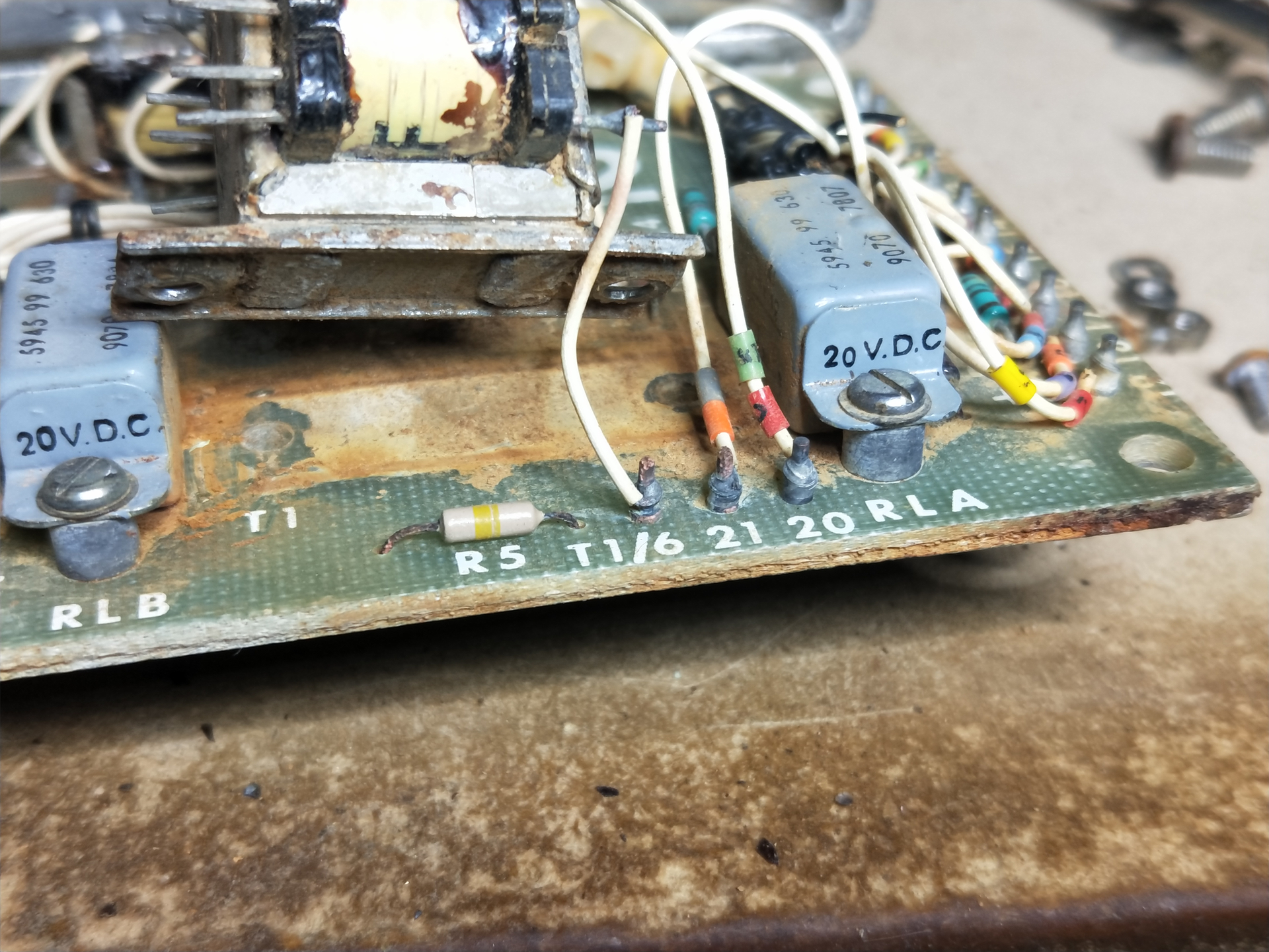

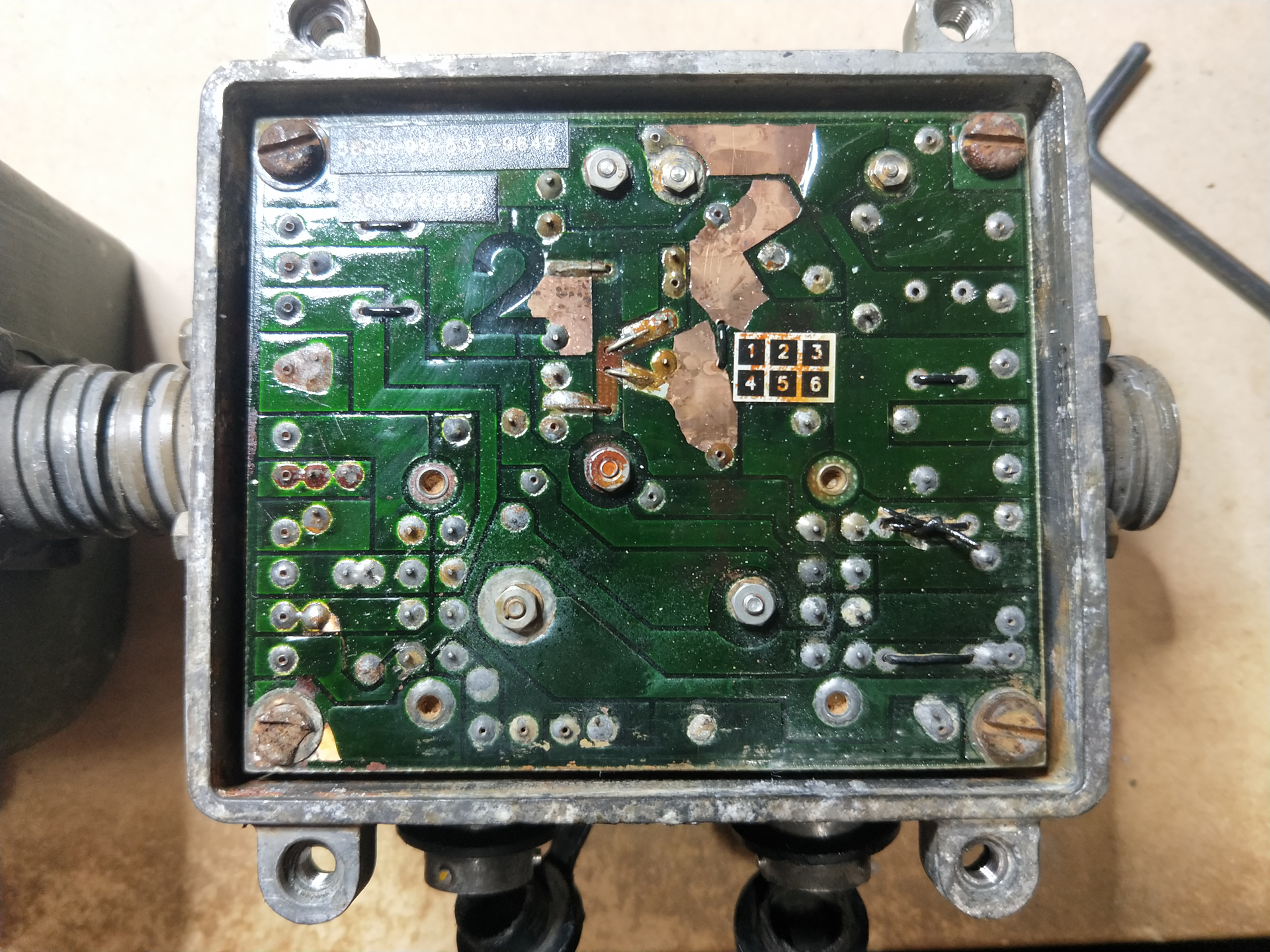

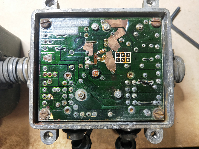

inside one of the interlink boxes we got was making a squeal and we found it was full of water for who knows how many years. took it onto our electronics lab at work and ne of the guys drained it and filled with isopropyl for a few days then i cleaned it out and it came up much better and worked just fine. we dont know how water got in as it sealed water tight. put dry bags in before i closed it up.

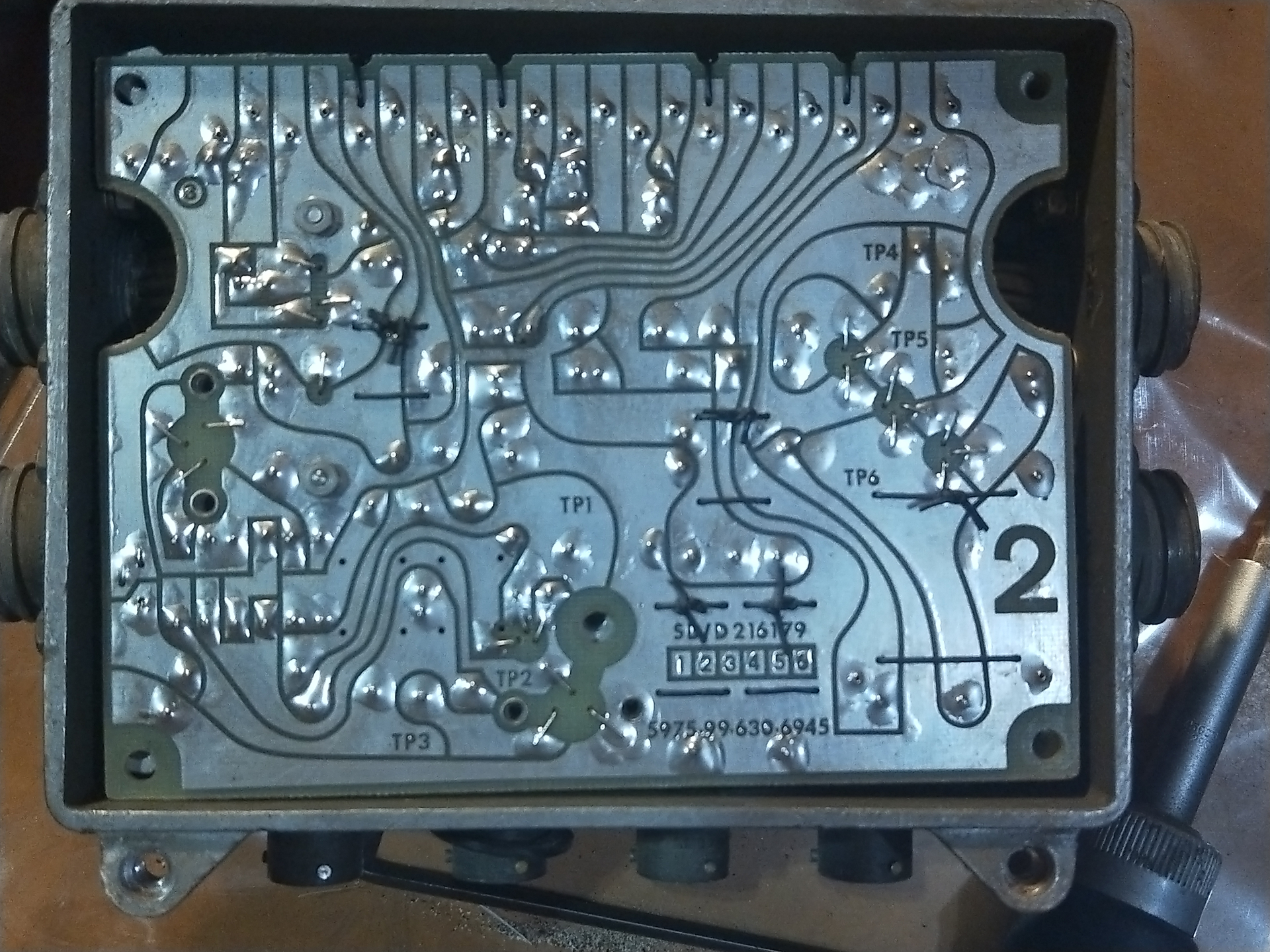

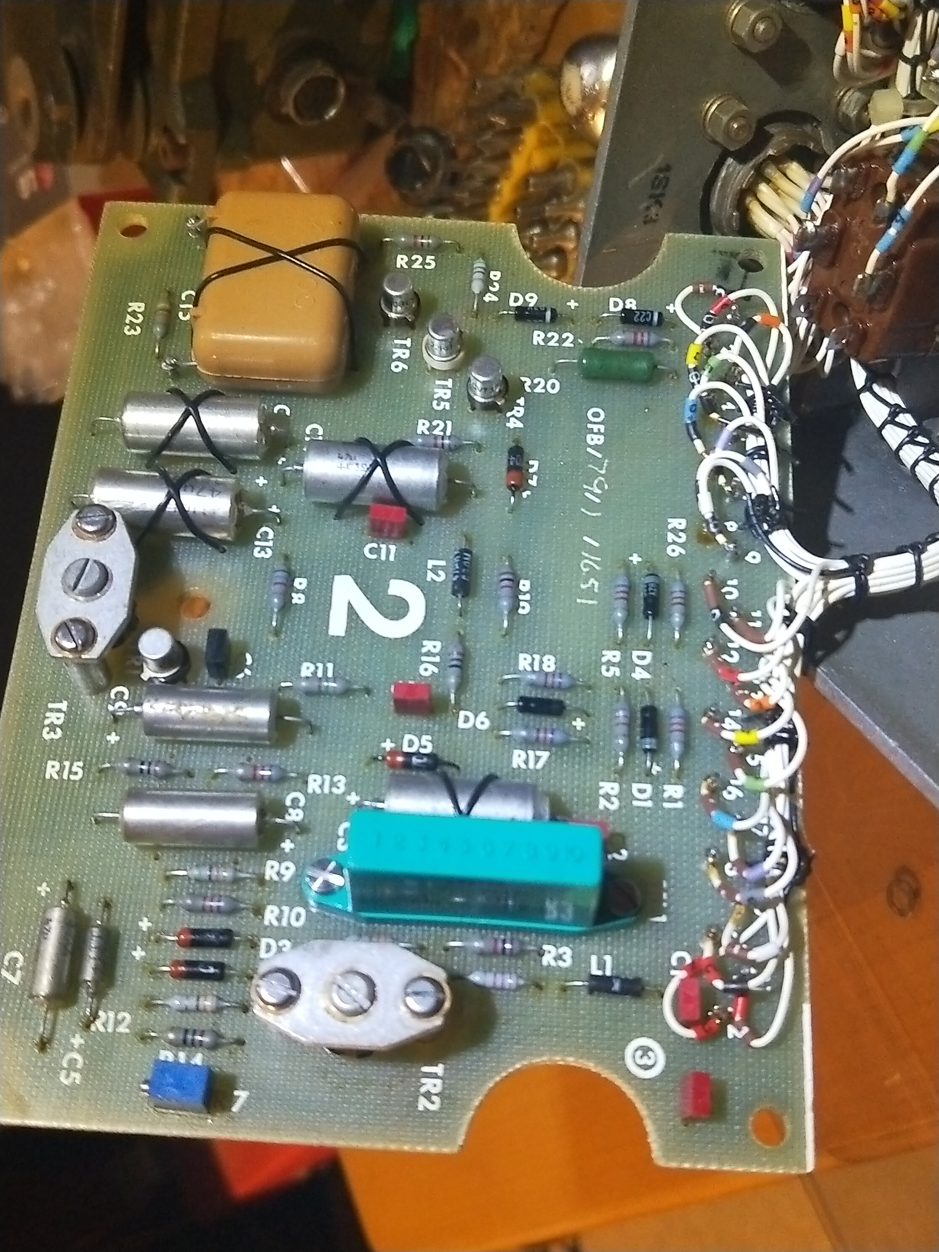

after a really good cleaning
the way they bundle the wiring is really well done
master box inside

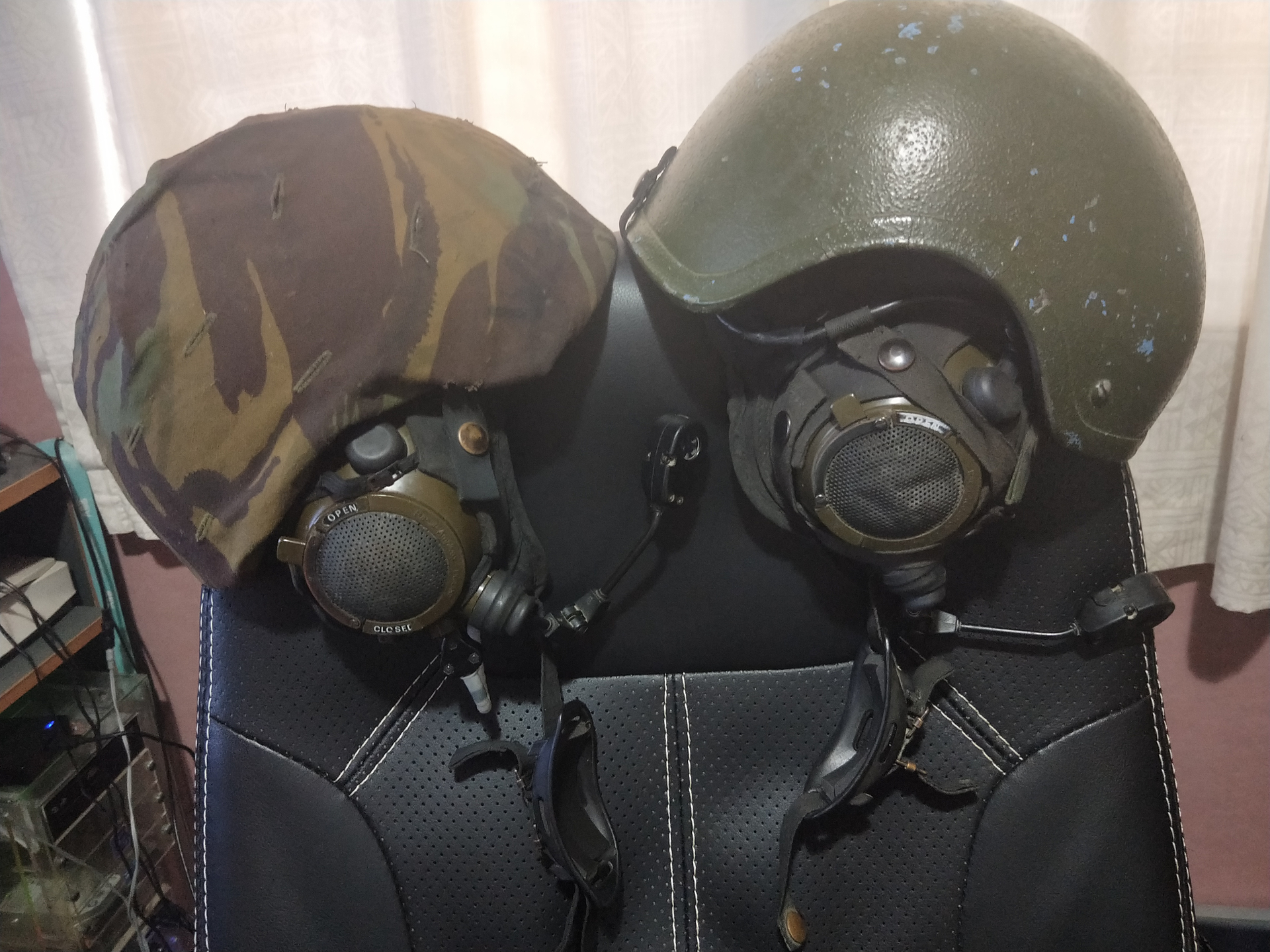

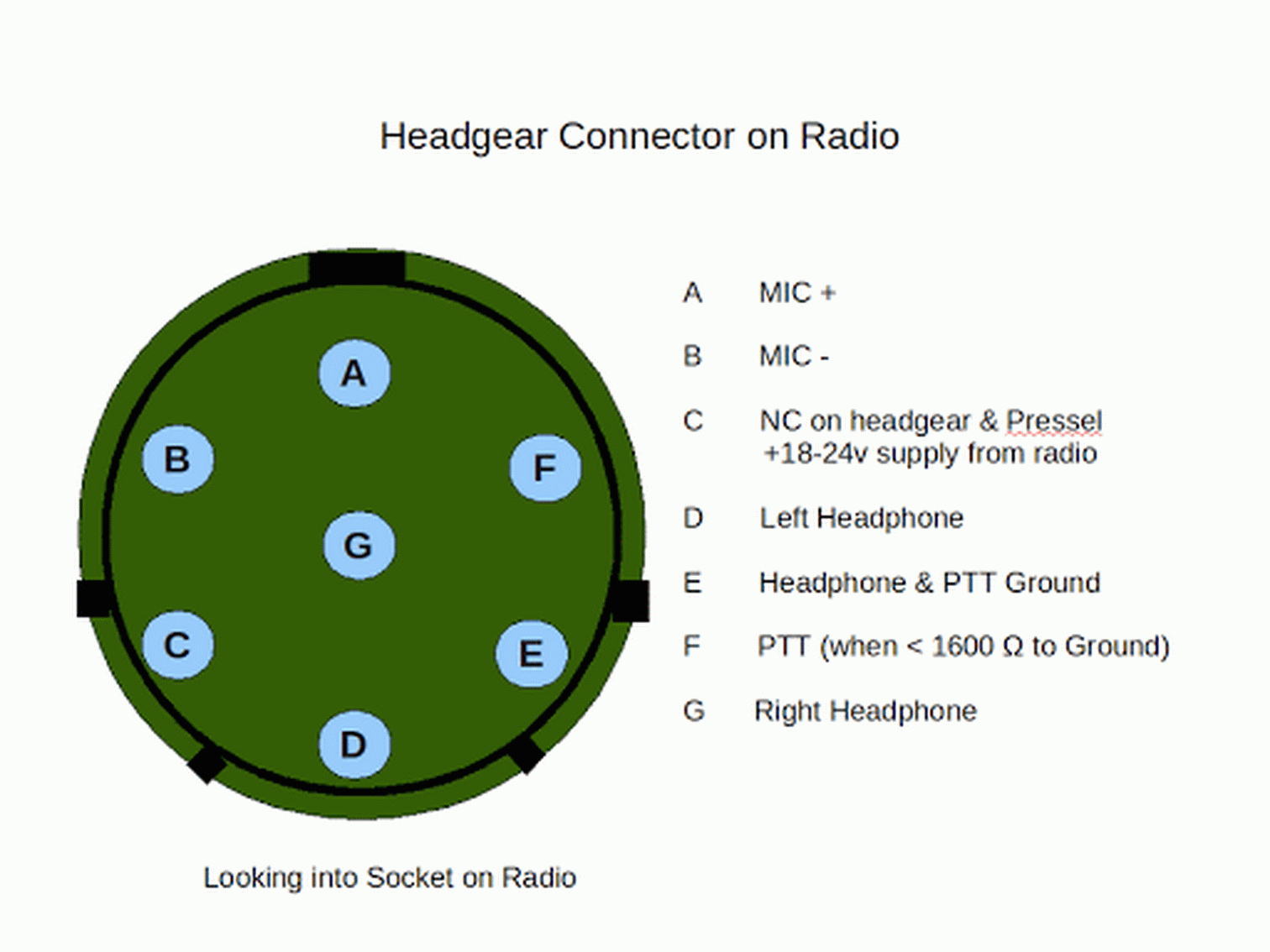

had to rewire our helmets to plug onto the Clansman but was an easy job
Rocol VTH helmets, the one on the right has the full armoured shell mine has just the fiberglass training shell
difference with Clansman is it is stereo sound meaning you could have one radio network on one ear and the other on the other side to tell which network it was. (we normally ran HQ network on right side)

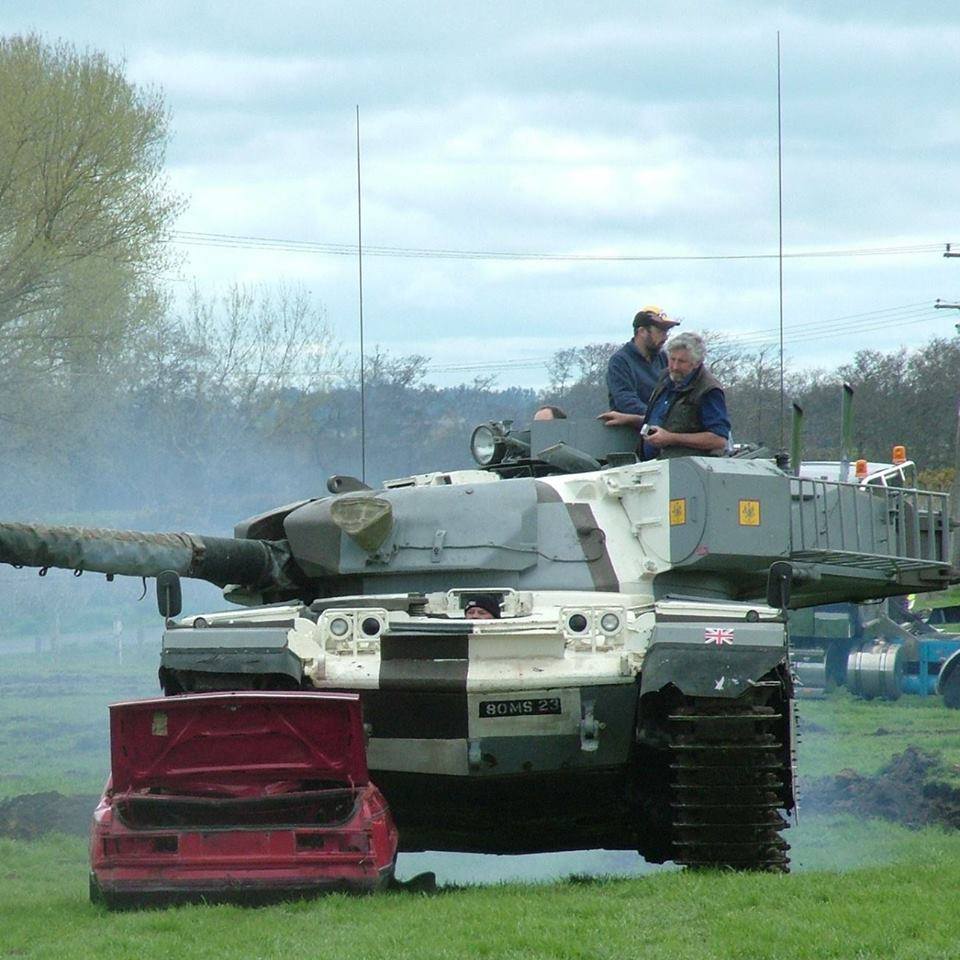

heres one just for a laugh for you - a meme i made after seeing the top picture. there is one parked there on the sidewalk - honest LOL
Dude, that is some seriously restoration work on that radio.
cheers and it doesn’t hurt that we have some good gear at work for examining the boards etc. gave it a scrub with a soft toothbrush carefully lifting some of the parts. it also shows how good the original parts build was that it could take that.
