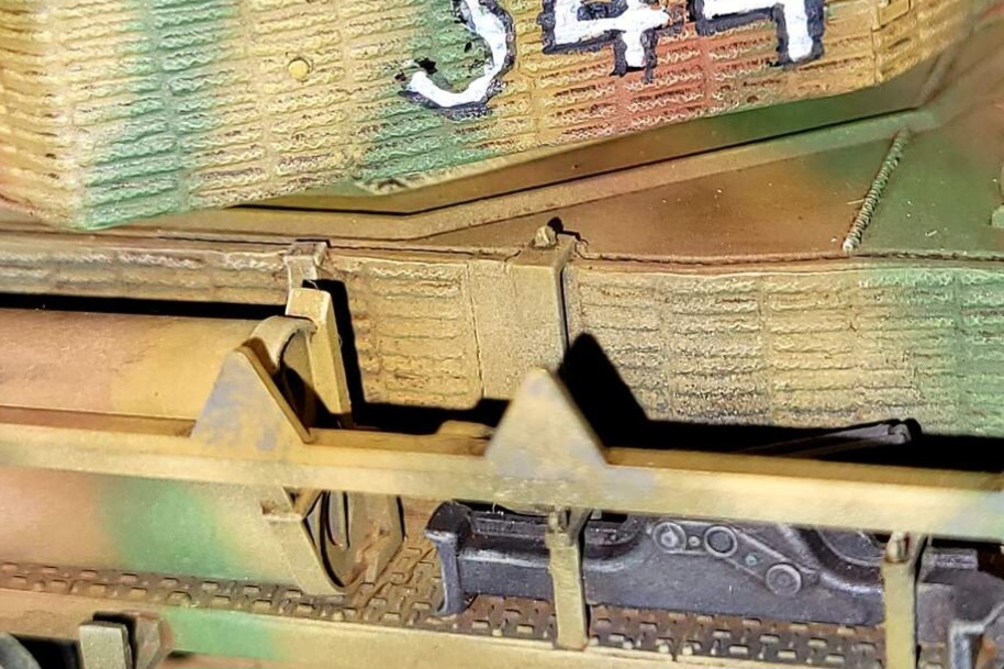

Fwiw - this is my idea of "reasonable " chipping on a Pz IV H that has side skirts in my one and only attempt. The skirts could get bumped and just hung in place. So it seemed logical to me that some paint on the hangar might get scuffed or chipped and show as such if the skirt panel was missing.

Dead right. I think the “teeth” of the hangers would be worn anyway, due to the need to remove the skirt components for maintenance (and refuelling on PzIV).
