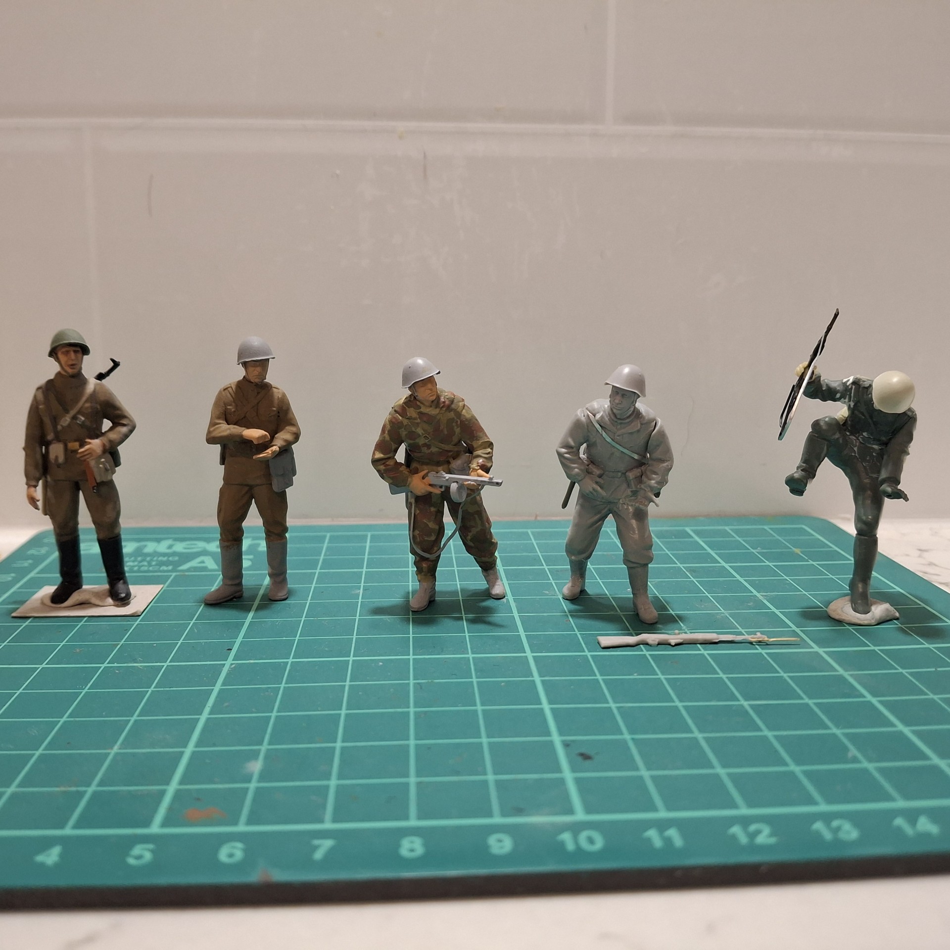

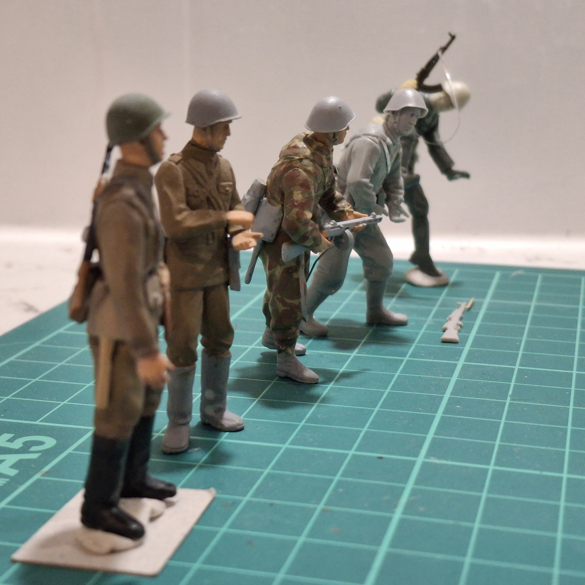

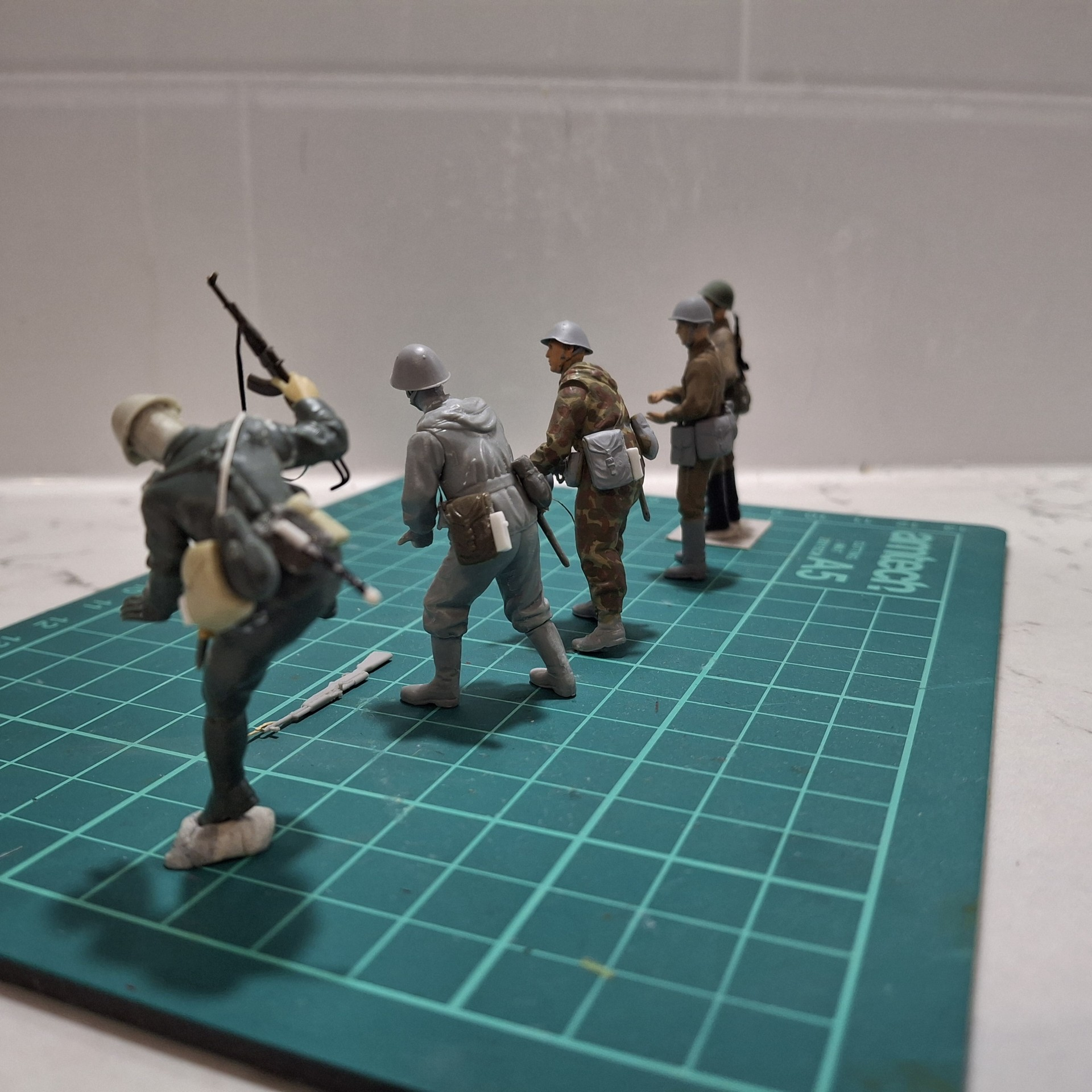

Kitmaker members may be interested in the few figures I’ve shown here; they’re really all test runs to see if they’re viable for a few future projects I’ve been thinking about; all Soviet and East German.

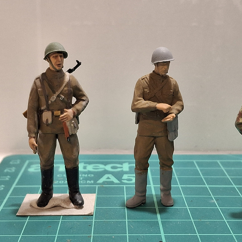

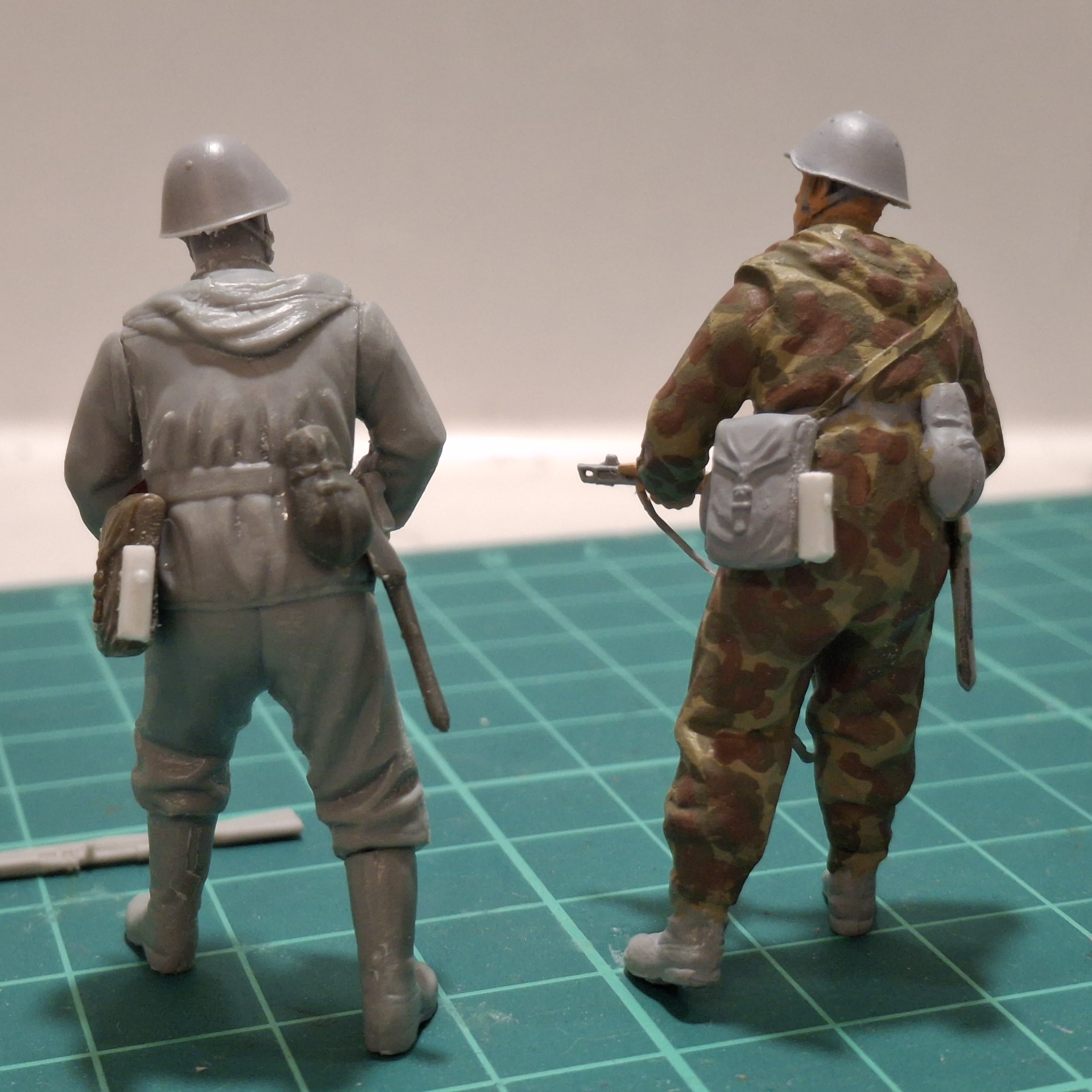

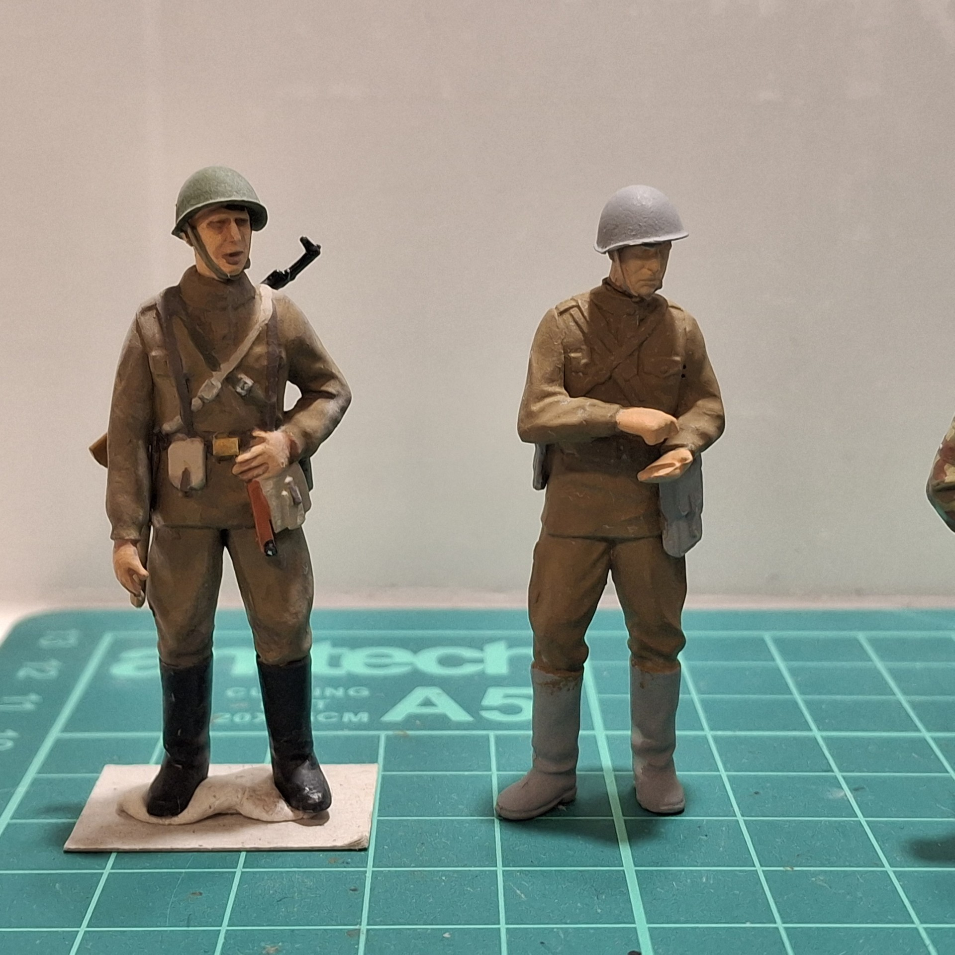

The first two are really just revamps of the basic ancient Revell WW2 Soviet figures; a sort of overhaul with Hornet Heads and a few simple accessories. Nothing to difficult here about converting WW2 Soviet figures into those suitable prior to 1969 when a uniform change took began.

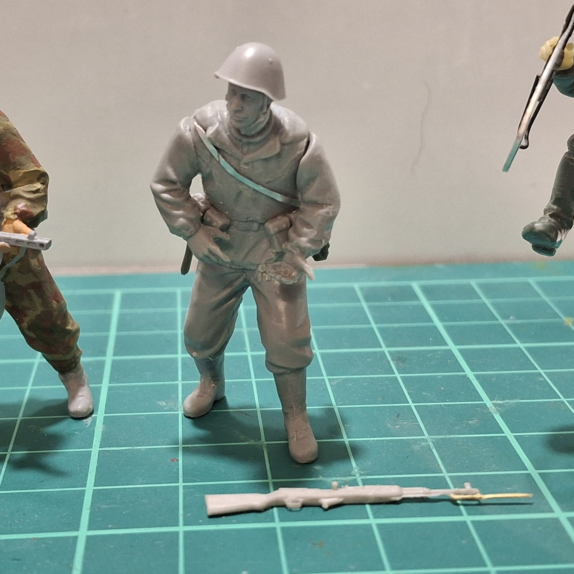

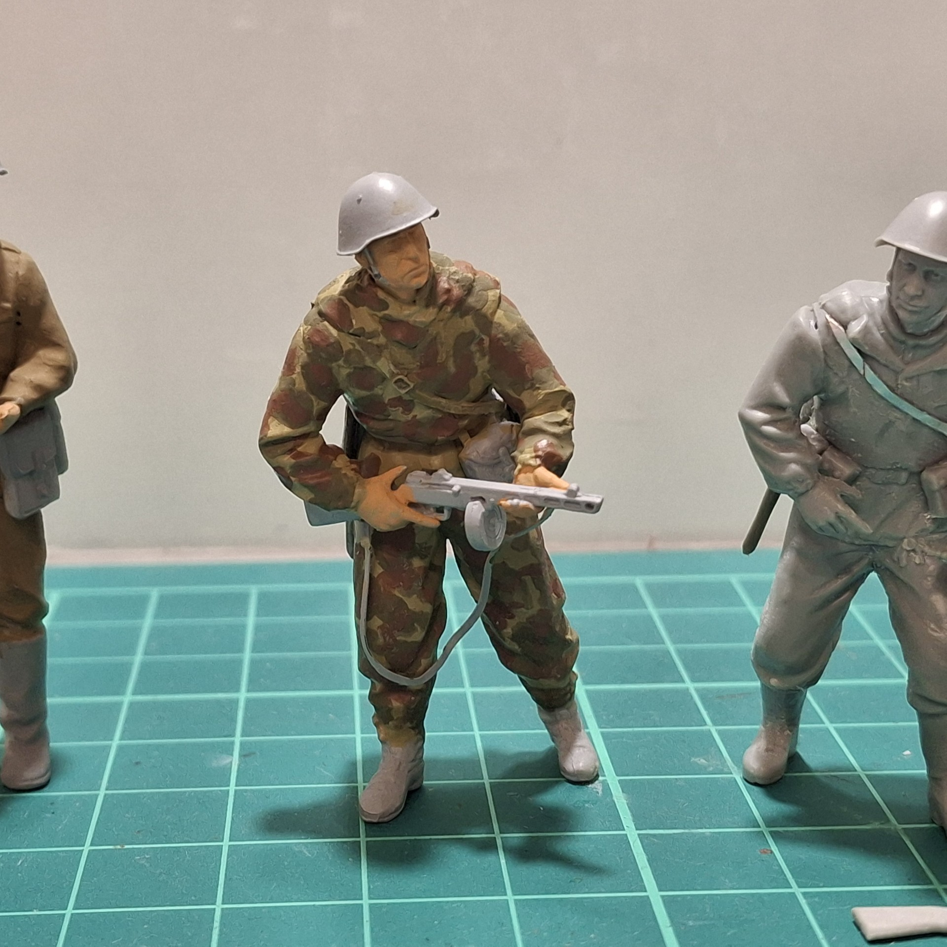

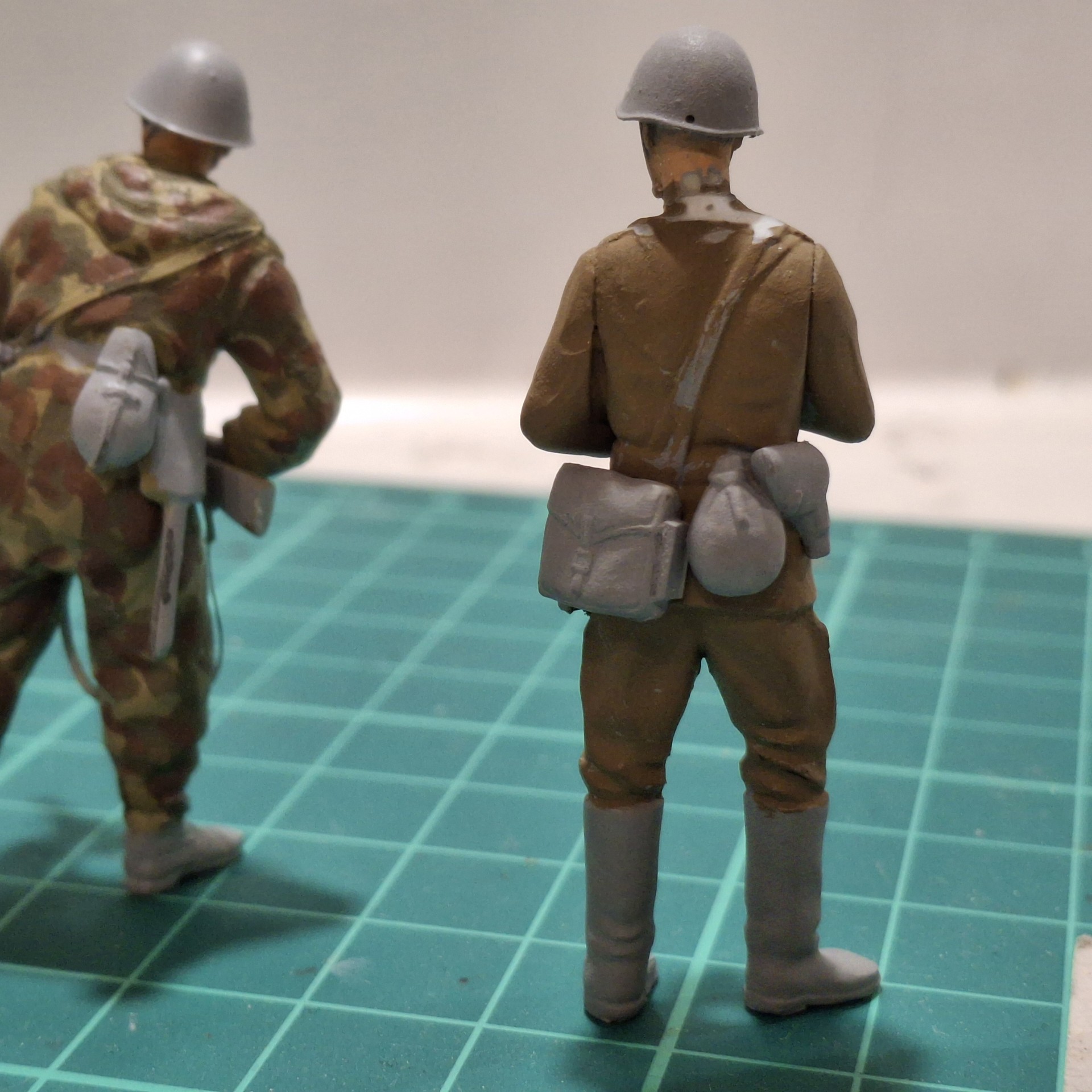

The others: well L to R, two figures adapted from the Dragon WW2 Soviet Scouts & Snipers set. They come with the baggy camouflage coverall that the emergent East German Army utilised and will replicate an early NVA exercise c.1958, and I have plans for them to be portrayed alongside a T34/85. Heads came from Hornet; this time personal equipment was a little more involved. The respirator haversack was filched from a Tamiya WW2 Russian Infantry set, and modified with plastic strip to show the decontamination kit pouch. The entrenching tool from a Heller accessory set, and the water bottles from a Tamiya Panzergrenadier set, and that was about it. I stress I am not suggesting that anyone will have such an extensive stash to facilitate such plunder, but it was relatively simple. Some parts may have to be scratched – shock! Horror

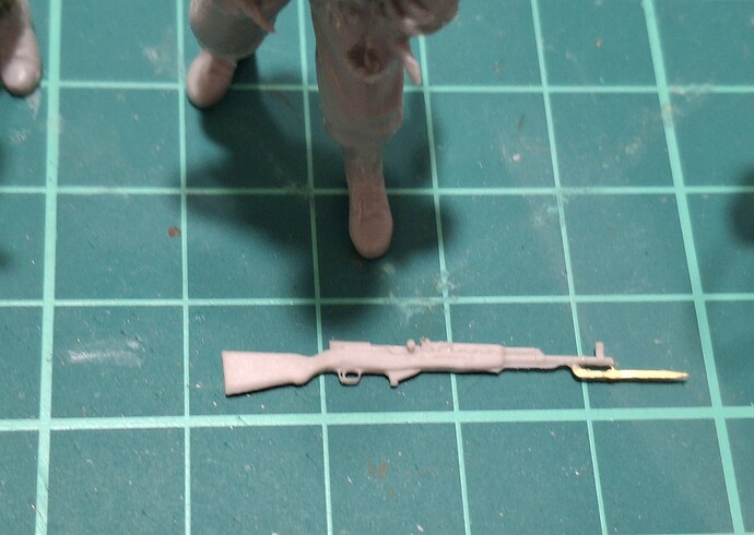

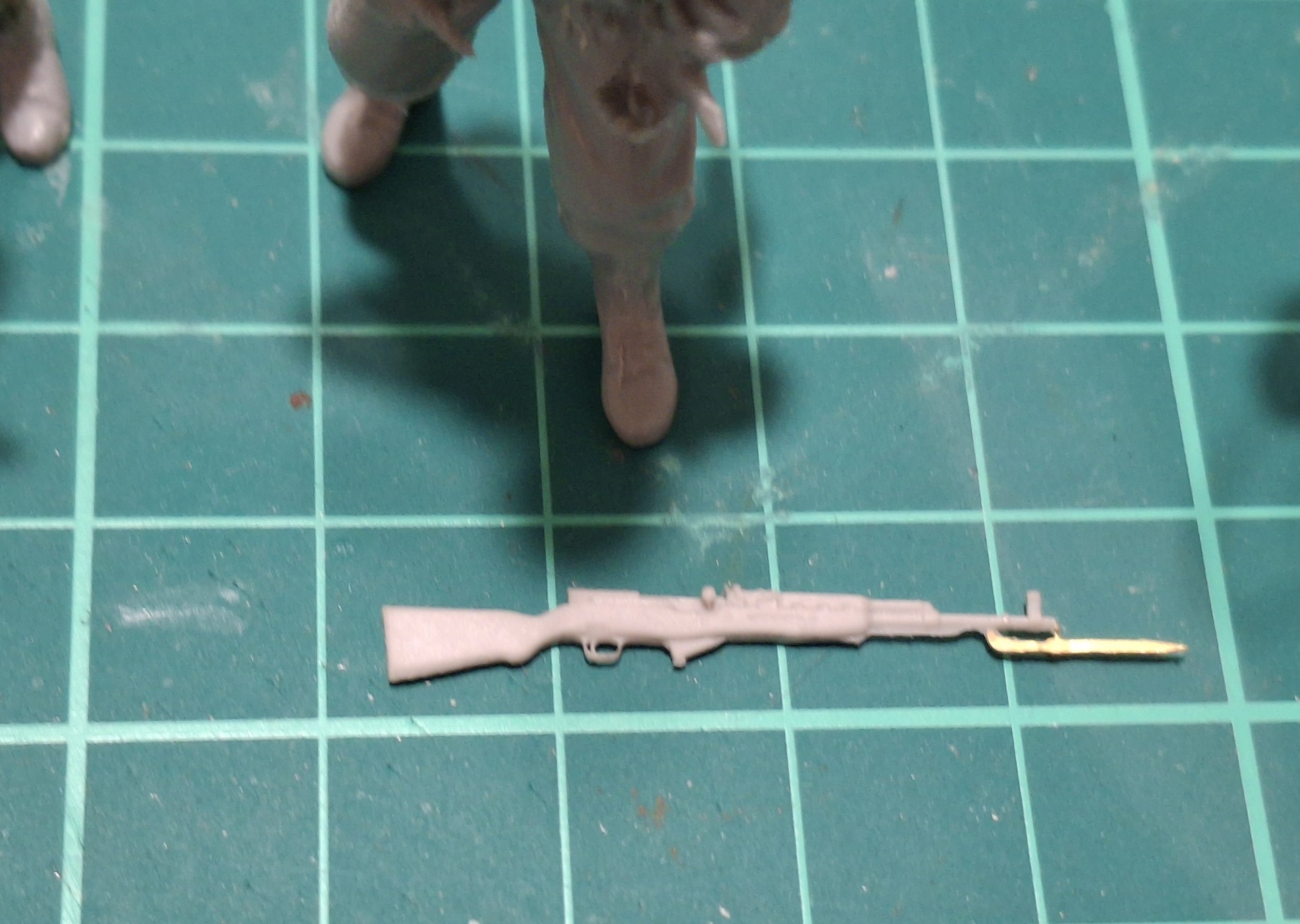

The second figure will be using an SKS, and that came from Bravo 6 – with a fiddly etched bayonet, and that is shown at the figure’s feet Please note that the camouflage pattern on the first figure is flawed and I will have to start again.

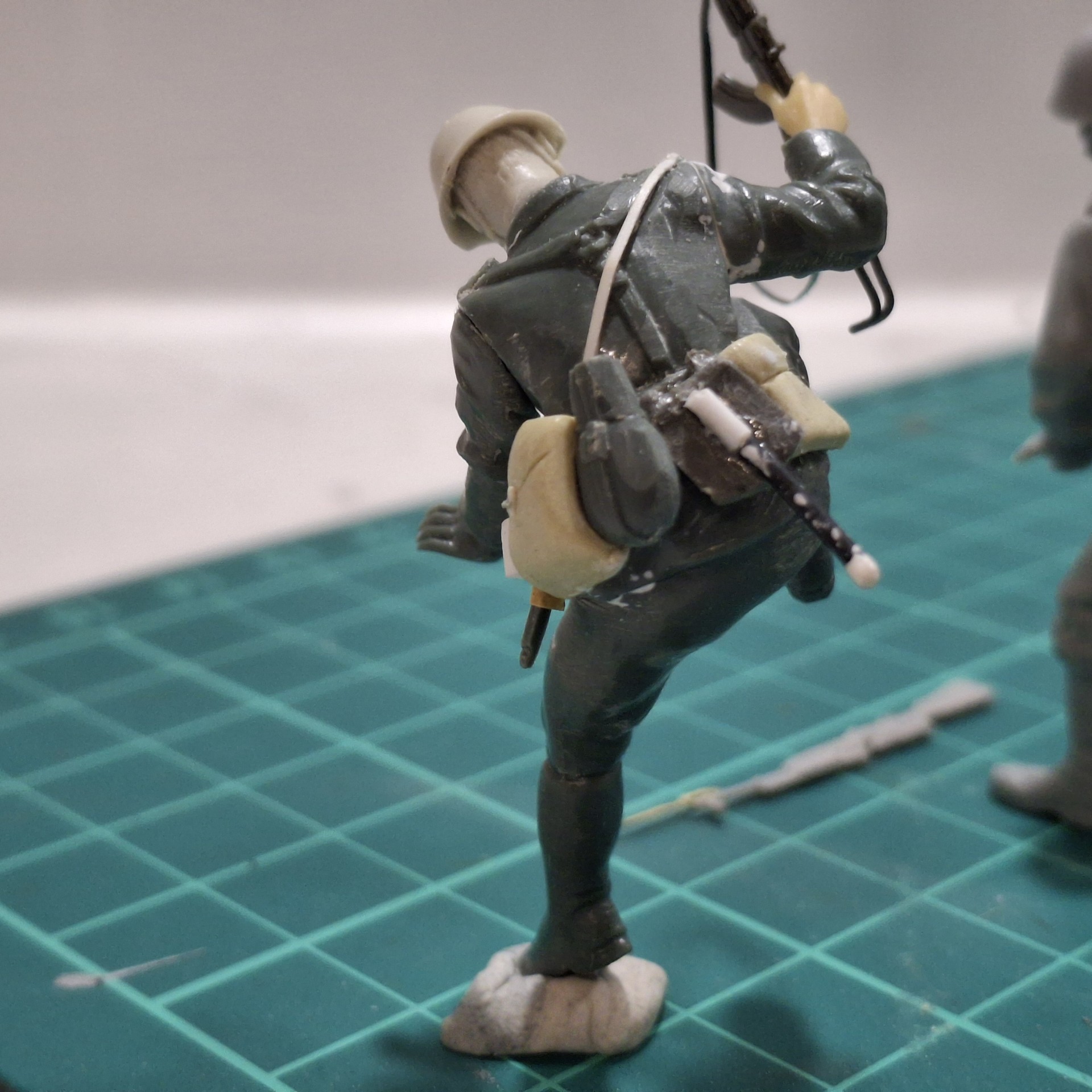

That leads me to the last, energetically posed figure; he will be a member of the Bepo, dismounting as per a quite well known picture showing a section dismounting from a BTR 40. The original figure came from the Tamiya German Assault Troops set, which has all sorts of imaginative poses in it. Modifications: Hornet Head, a water bottle from the kit, sanded to the narrower format favoured by the NVA, or at least an attempt, and entrenching tool made from scratch including plastic rod, a respirator made from Milliput, ditto an ammunition pouch. The last two modifications were not hard Folks; we’re not talking Michelangelo levels of sculpting here. A bit of practice and you’ll be good to go! Oh, the AK was adapted from an Italeri set, the “Modern Light Weapons” one. The stock from wire but is not quite an accurate effort as the real thing was slightly different. I suspect that the 3D printing industry will remedy that before too long. Weapon sling from lead foil.
And that is that; now, they’re not going into further production or completion just yet (the singleton Sov soldier figure is complete). They’re also not brilliant, especially some of my older efforts (the 2 x Sovs) but the point is, that while we all realise that Cold War figures from the mainstream manufacturers are in short supply, we tend to do nothing about it other than lament the fact! What I’m suggesting folks, is that converting figures isn’t that difficult, as I hope my efforts show. OK, if you’re keen on modelling the NVA, you’re going to need Hornet Heads, but it is really down to adapting what accessories there are available, and as I’ve further suggested, a modicum of sculpting using Milliput or Magic Sculp
This is not mean to be a polemic. And I don’t want to initiate a rather pointless whinge about the lack of figures; we all acknowledge that. I’m merely suggesting that there is a way forward and it isn’t as difficult as you might think. Unless modellers are prepared to grasp the nettle, model AFVs will continue to be uncrewed, and dioramas unpopulated.
Discuss (perhaps!) and I don’t mind criticism about the figures.

Nicely done sir! It’s funny how most of the Cold War armies used uniforms and webbing that were quite similar to their late WWII forebears. Up until the late 60’s/early 70’s only the weapons changed much…

Really excellent conversion work Brian-- I particularly like the Bepo guy!
Thanks Karl,
Thing is, this little portfolio isn’t really me trying to say “Look what I’ve done” but rather to encourage others who for whatever reason may be reticent, to tackle what figures there are available and convert; there’s nothing else to be done until manufacturers scent the possible market or the 3D boys play catchup, which I think they’re beginning to do.
I have every sympathy with those who bewail the fact that Cold War figures don’t exist, “Woe is the Cold War modeller” and all that; I am one of them, but the idea here was to try and sow the seeds of a modicum of figure converting and to get people to do it; I wanted to show, with just a few figures, how simple it can be. Let’s face it, mine aren’t brilliant and are never going to win awards at any figure contest, but that’s not the point; the point is my models are populated and crewed (for better or worse admittedly) but I achieve an effect, and that, as far as I’m concerned, is all that’s needed.
I too like the Bepo guy; with a few more of his peer group, and a competed BTR-40 (long way off to be honest) he should look quite good.

Yes I think you are spot-on in terms of conversions- what you gave there is a good example of the things that can be done with a good bit of determination. That, coupled with the knowledge that with a few extra bits of equipment, some putty and a range of suitable donor figures there is quite a wide range of subjects you can make.
Even if more actual full 3D figs are not forth-coming I hope some bits of kit might be. I bought some bits and pieces of 37’ pattern equipment in 1/35 from Diaccs and they have 58’ pattern stuff too (I think you mentioned this in another thread when a fellow modeller posted some images of their products). Some similar bits of equipment from other nations and timelines would make conversions a little easier.
Well, exactly Karl; one might have to reach for the Magic Sculp at some point, and I think for whatever reason, for a lot of modellers that’s a step too far - all it needs is confidence and a bottle of gin folks.
Set-ups such as Diaccs are priceless in producing what they dio “Yes” sure I can make some 58 pat webbing, and have done so, but it would save an awful lot of time just to say, trim and cement the stuff on to a donor figure. Hmmm. I might re-visit my long lost plan to produce a Brit Infantry section deploying out of a FV 432 now*. Might*.

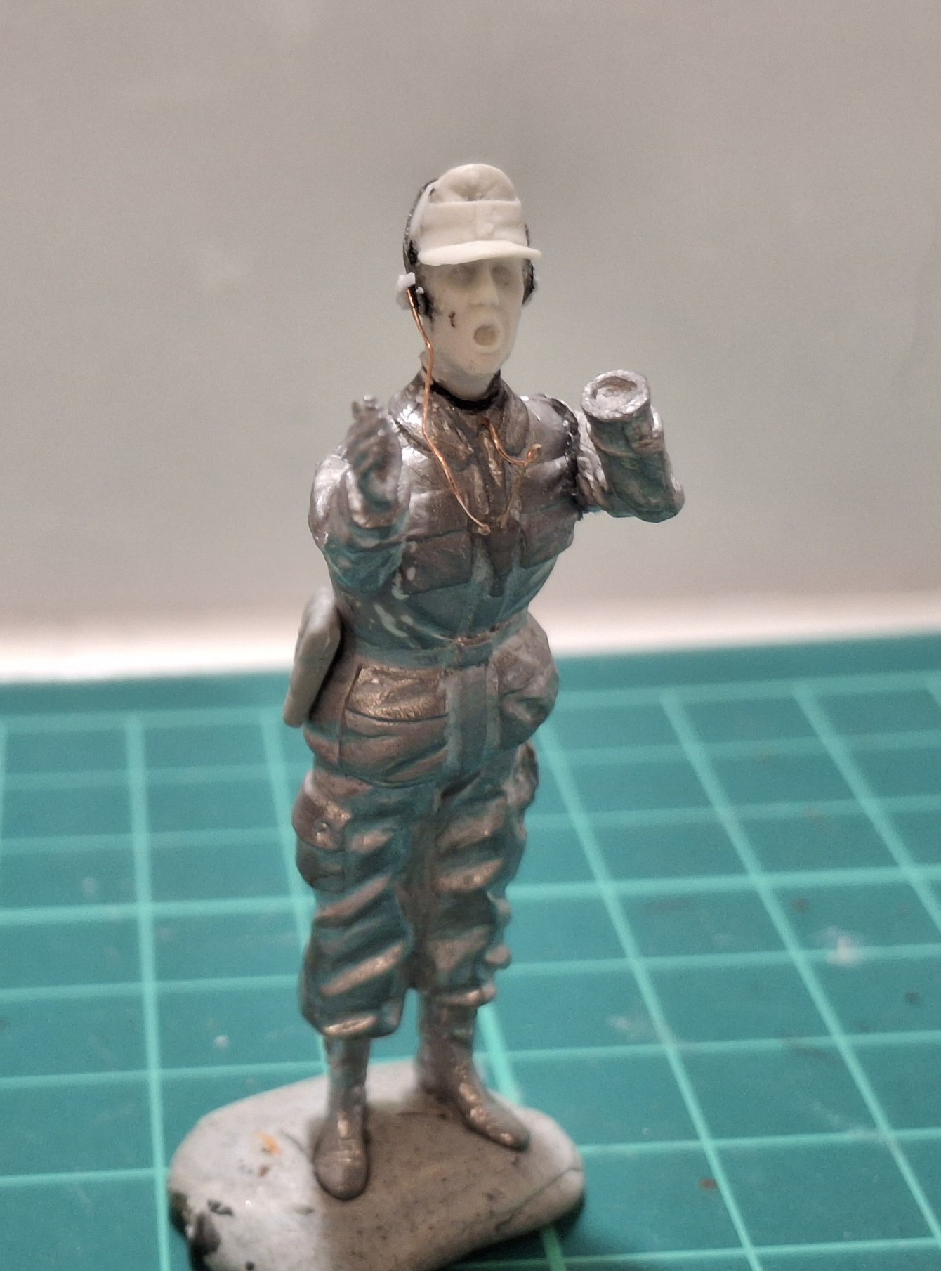

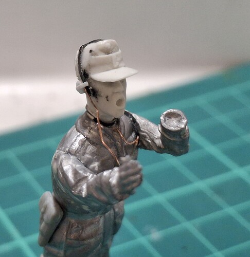

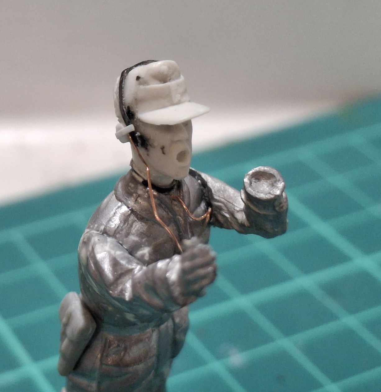

It never gets easier! Headset wiring - the bane of my life:
And headsets come to that.
