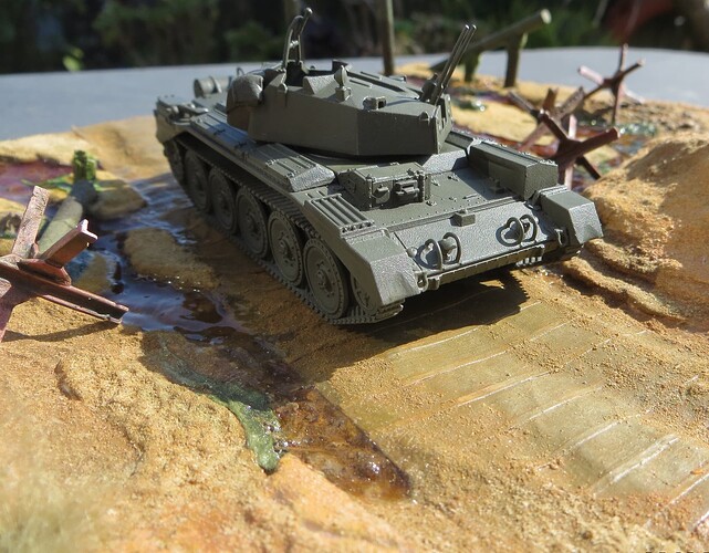

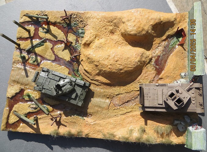

Hi all,
Some small progress, having given both AFVs a basic coat of colour…sounds like a song from a musical, :thinking: :smirk:.
I’ve shown them in-situ, along with beach obstacles positioned, but not fixed.
Still loads to do, but getting there…slowly, :pensive: :grin:.
Cheers, :beer:,
G
Thats looking super mate. Really nice movement in a solid compact little scene … you are going to need a ton of clutter strewn about though … that first day would of been manic …

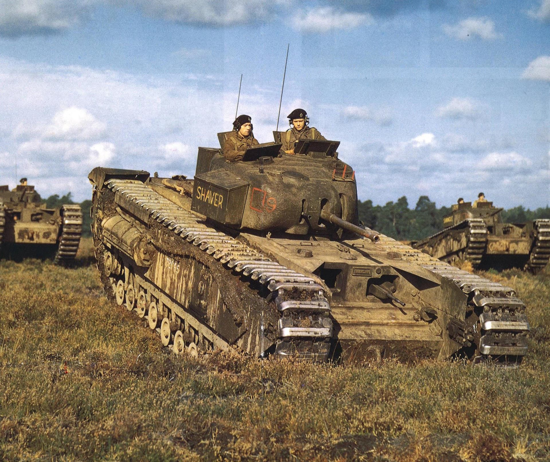

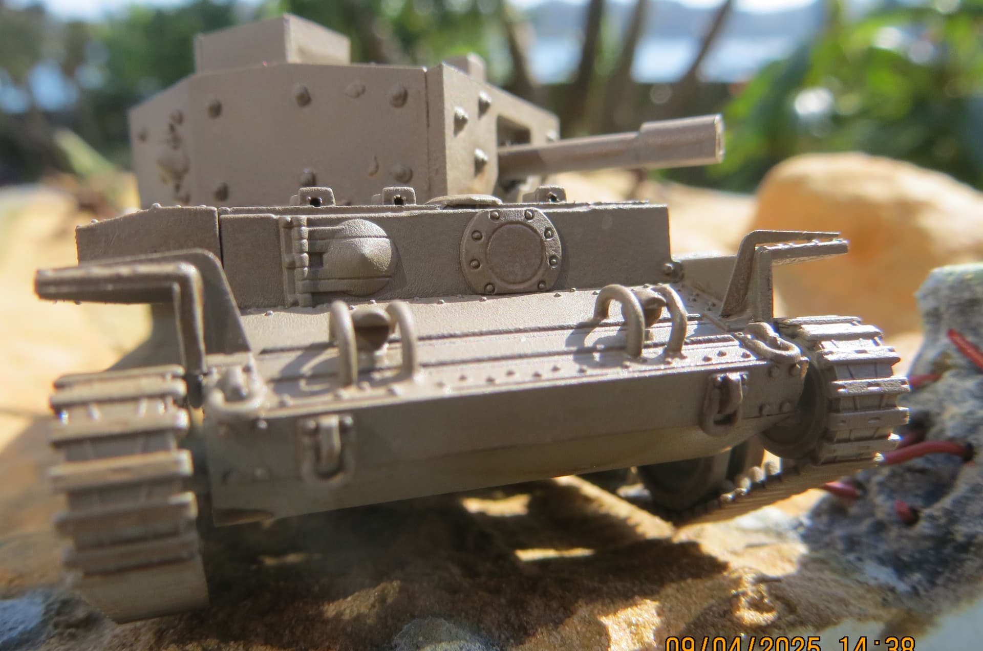

Looking good G-Man. Interesting that the Centaur kit has the bolted ring for the Hull MG position and not the flat circular blanking plate. It probably needs to be a much darker colour for SCC2. This colour pic is way off colour balance, but it still shows how dark SCC2 is. Like my Sexton.
Another wartime colour pic of SCC2 on a Churchill:
@petbat Peter, would D-Day Churchill’s be SCC #2 or SCC15 or some of both?
Thanks
The orders came out not too long before D-Day. They were for frontline fighting vehicles to be repainted as the priority prior to D-Day, but support (artillery, soft skins, etc) were to take a back seat for the make over. Even so, there was not enough time to repaint everything and from what I have read, a lot of the earlier mark Churchills that went to Normandy did so in SCC2. However, the later marks (most VI and later) were being painted SCC15 during production, so yes there were both colours present post D-Day in Normandy.
We do know the Centaurs were SCC2. The Centaurs were expected to be artillery support firing from LST’s and were never expected to actually disembark - hence them not being repainted.

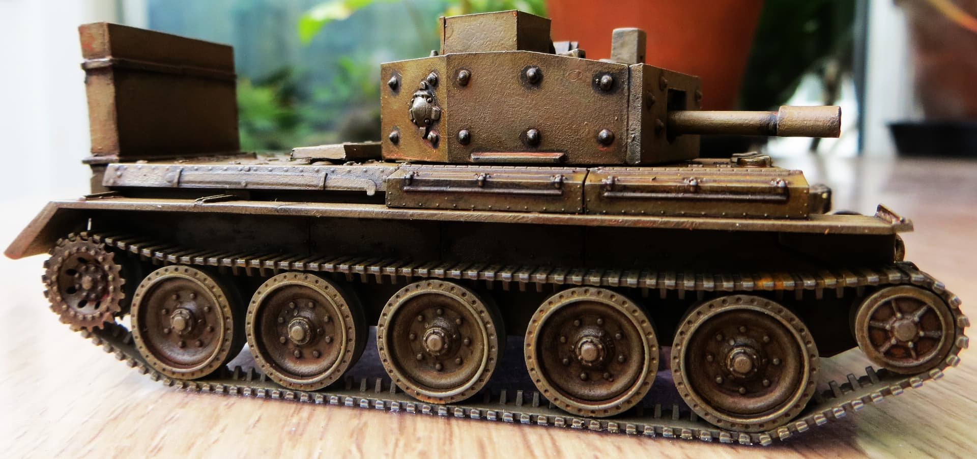

Hi all,
Started to add some tonal colour to the Centaur, it always looks a tad harsh at this stage, but will hopefully blend in as things progress, :thinking: :pensive:.
Cheers, :beer:,
G
I’m liking it already … looks nice mate.
Now that is coming along very nicely now.
It does indeed look the biz; but just one thing, would it not have been better to apply the markings etc before the washes and tonal touches?

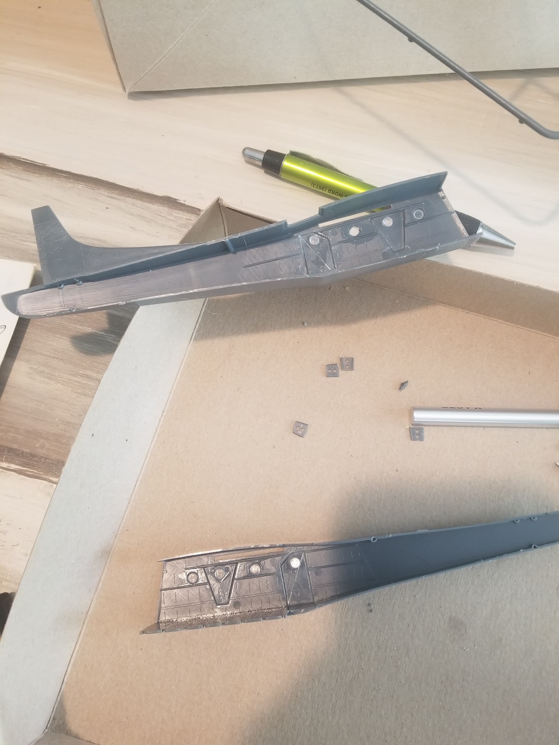

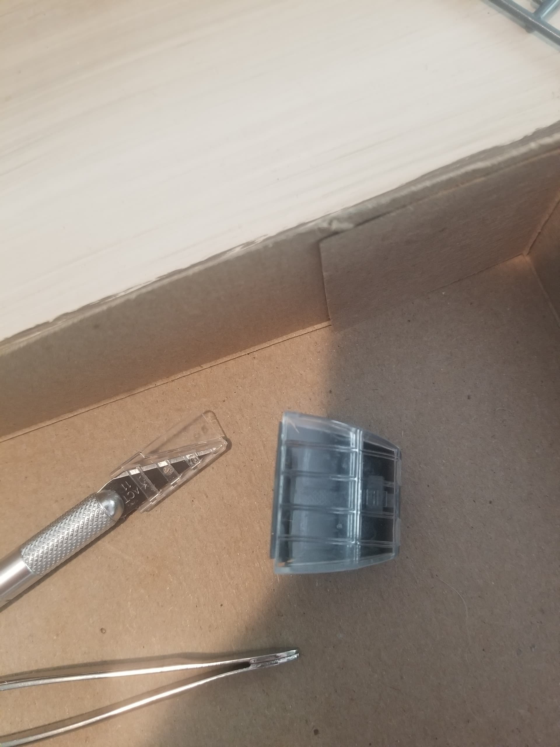

Has been awhile, I have made some progress with the glider finished window install after a weeklong hunt for two missing windows I have found them, and all windows are now installed as are the doors. I have finished the cockpit assembly and should be gluing entire fuselage together later on this evening. Already have floor installed will be making the glider with the nose fixed closed. hopefully should have some paint in the next two to four weeks.
TinyDog01
Nice progress and looking good. :+1:

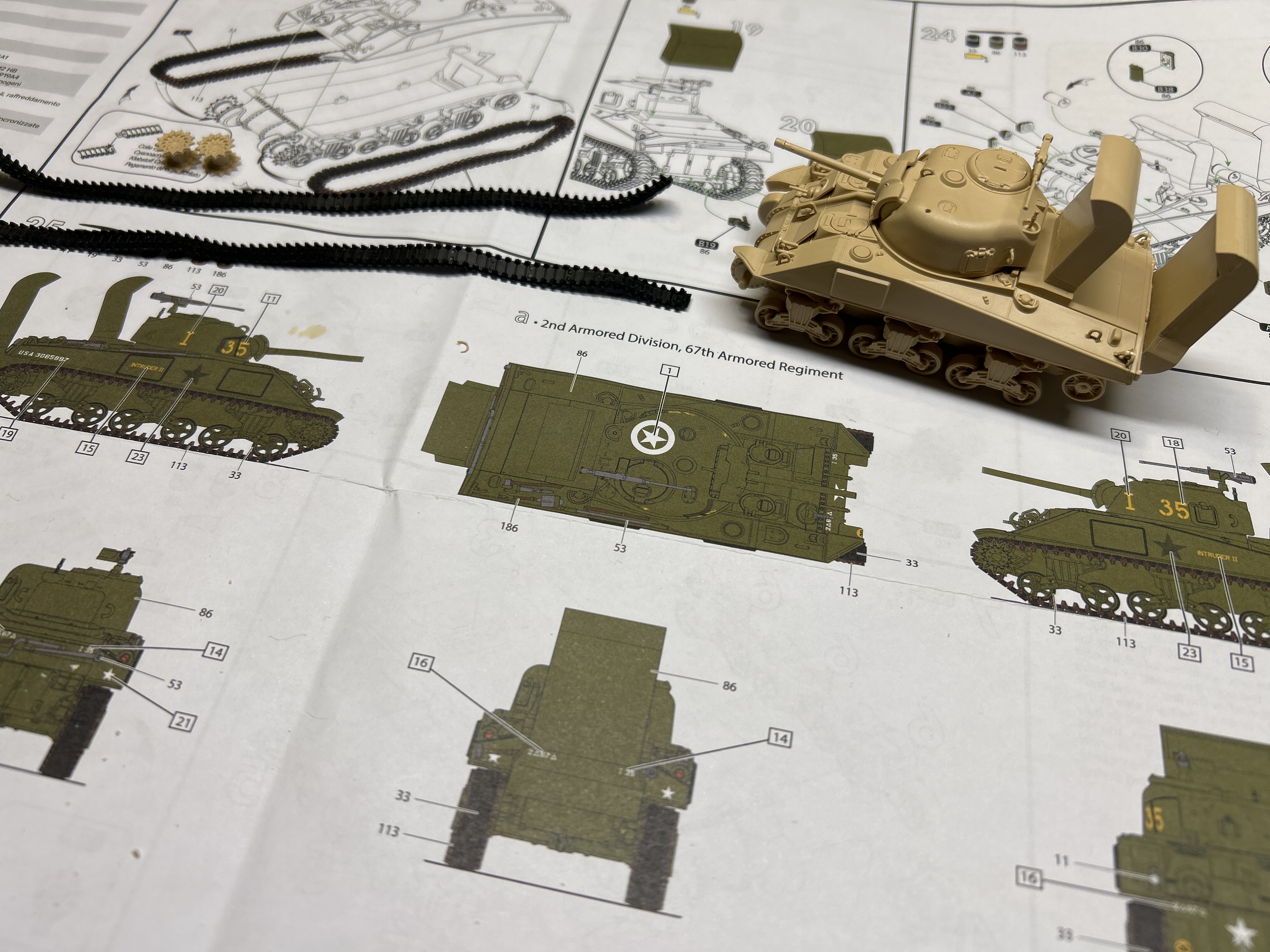

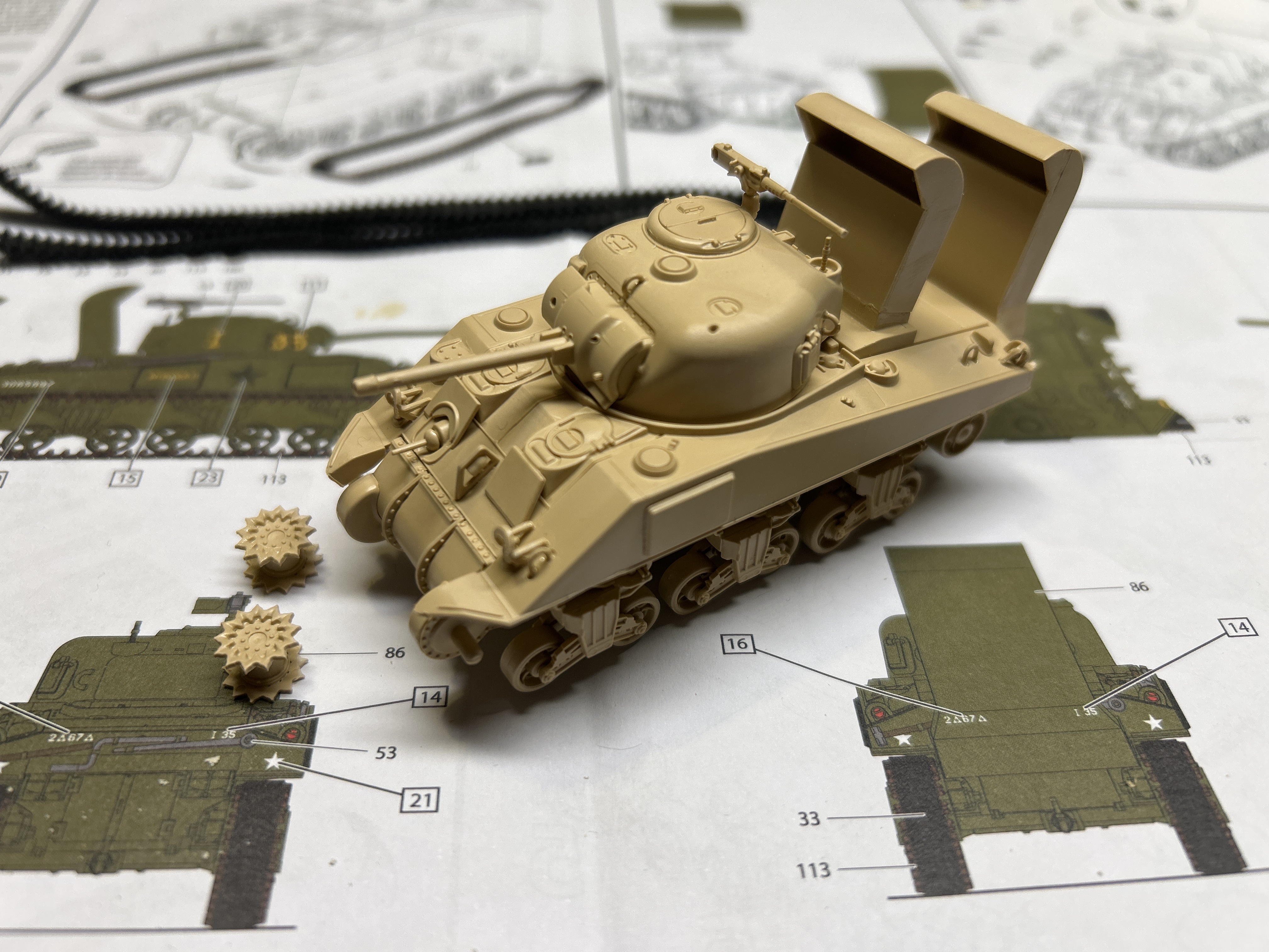

Construction is done on my 1/72 Heller Sherman. Absolutely fantastic kit. Super fit and nice details.
You can make a lot of different versions from this kit. A ton of variations for engine, hull front, wheel types, turret mantlet etc.
Next is painting and then maybe incase it is clear resin for a beach diorama.
More to follow :slightly_smiling_face:
That looks great Jesper and like you said, really well detailed for a small kit. The deep waders look nice on it … where they free standing or did they have tension cables on them ?
