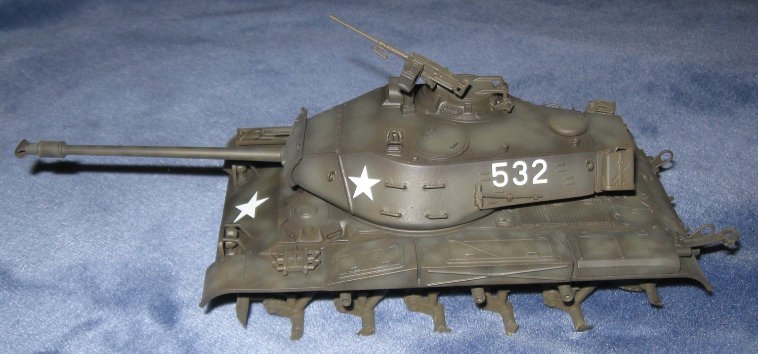

Going back to my original procedure, I added decals to the M41 right after applying the base coat. Silvering is minimal. Vallejo Decal Set has some interesting quirks I have not yet mastered.
As a new experiment, periscope lenses were added as decals. Preliminary results are promising!

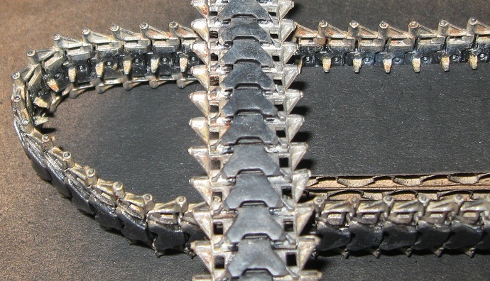

This is my first attempt to paint tracks with rubber pads so it was time for another experiment. In my opinion, they turned our pretty okay. Total paint time on the tracks was about 10 hours.
Edit: I added a close up of the tracks so you can better see my latest experiment. Close up pictures are fantastic for figuring out what is going right and wrong.
