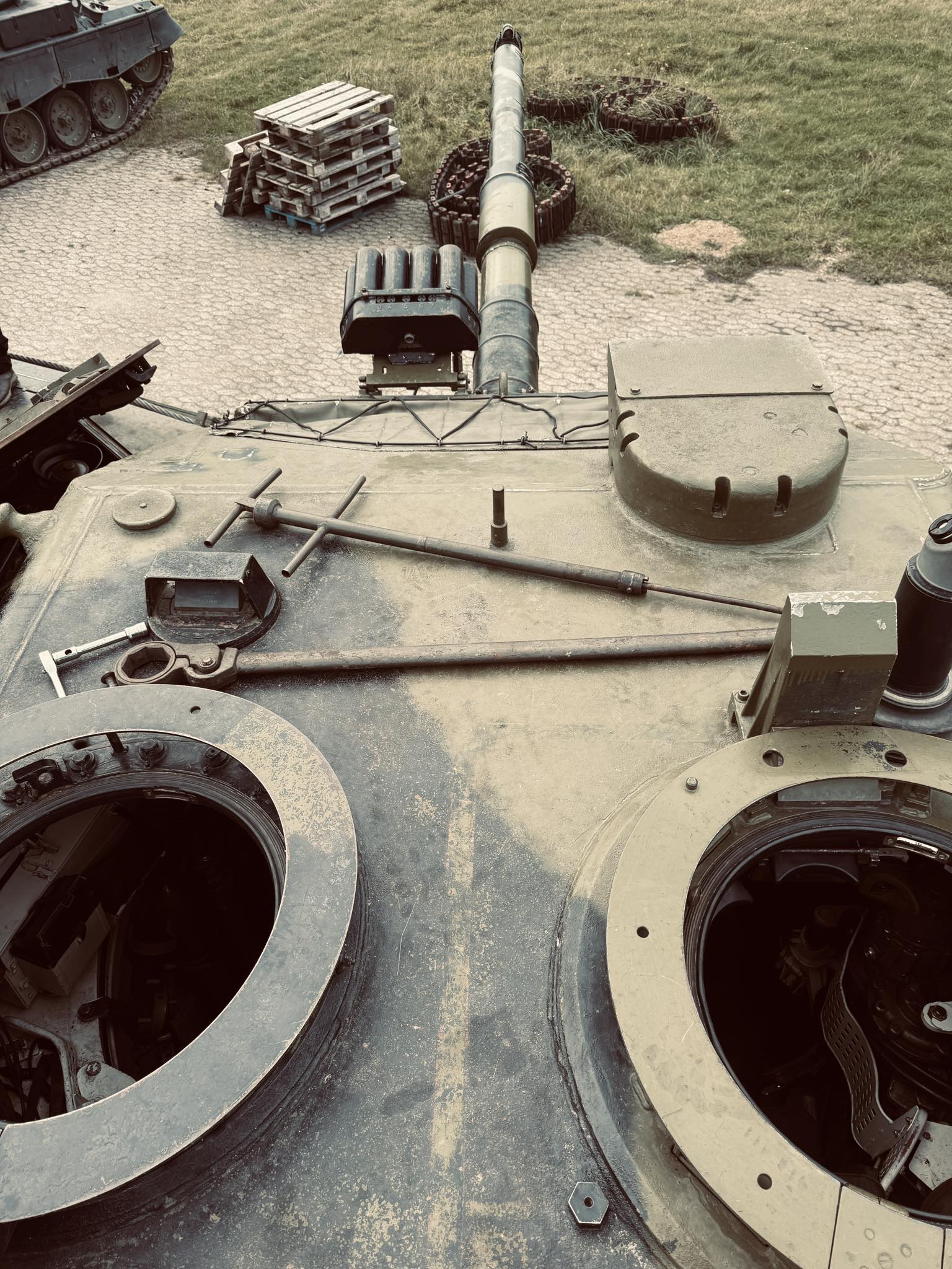

You mean this part ?
(from this walkaround Leopard Club )
Yes this is the sight.Its quite tricky to judge the placement exactly on the turret top.

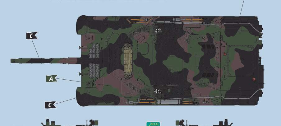

This is taken from the Revell 1A5 kit instructions - so ostensibly a scale drawing; it might help a little:
Cheers Brian.Danes used 1A3 converted.
True, but the sight position relative to the hatches behind and the gun in front should be the same, so it should be easy enough to correlate to the welded A3 turret.

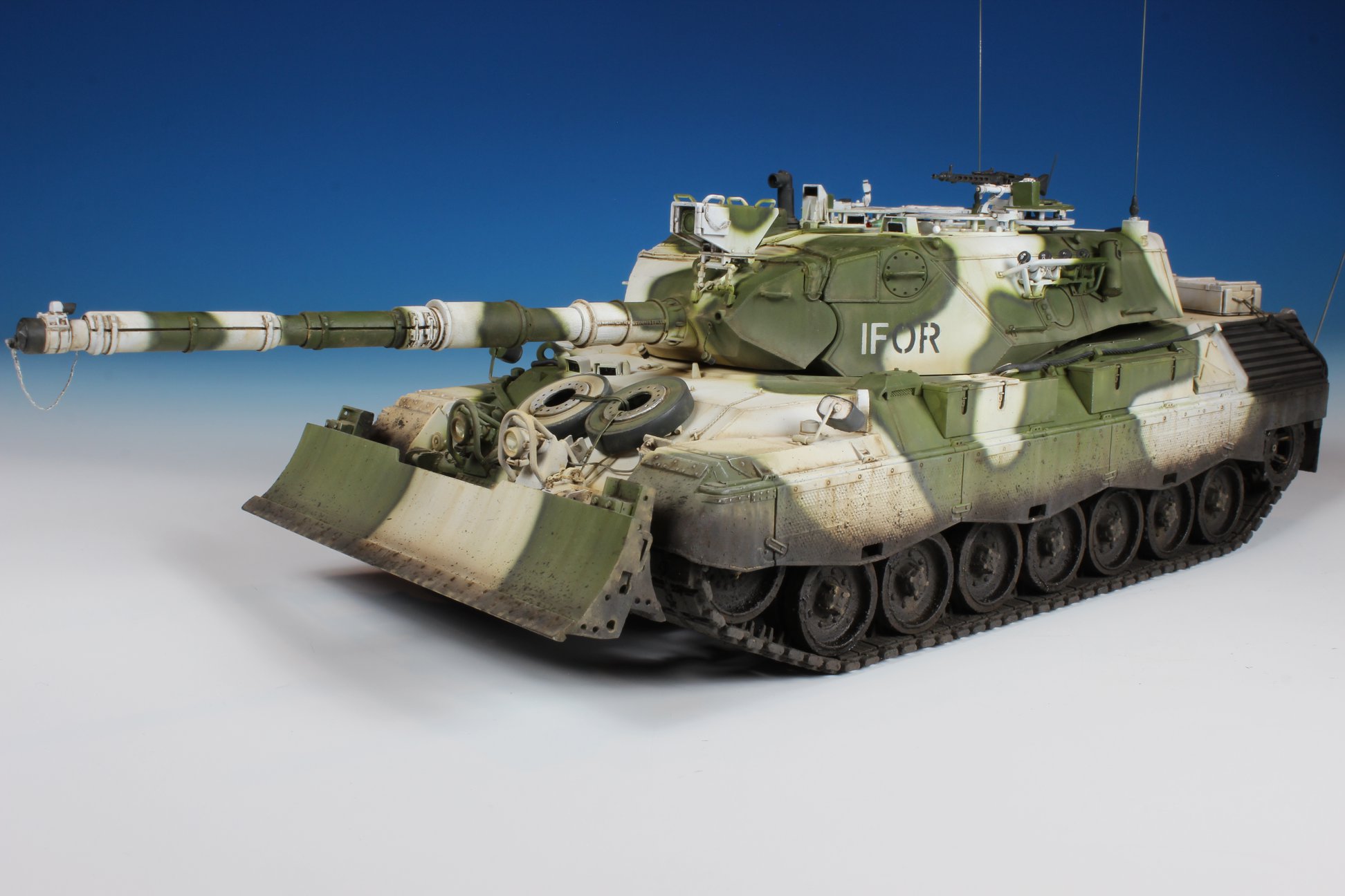

If you search Google for the Legend Productions Danish Leopard 1A5DK or 1A5DK-1 conversions you’ll find a variety of build images showing the placement of the resin EMES 18 sight.
If you can wait a week or so, I’ll post some older build images of my IFOR Danish Leopard 1A5DK so you can see the sight placement.

Per the drawings in his Leopard 1 Trilogy, when seen from above, the centreline of the sight should be in line with the front right corner of the mantlet. Fore-and-aft, the second bolt on each side is in line with the bend in the turret roof plate.

Hi Brian.Well on the 1A3 i was doing i bit the bullet and added chains to the turret smoke launchers and the mantlet plugs on glacis and mantlet cover.Happier with the position of the launchers now,Bit of a Bstard to do but adds a sparkle to the beasts.
Fantastic looking model
