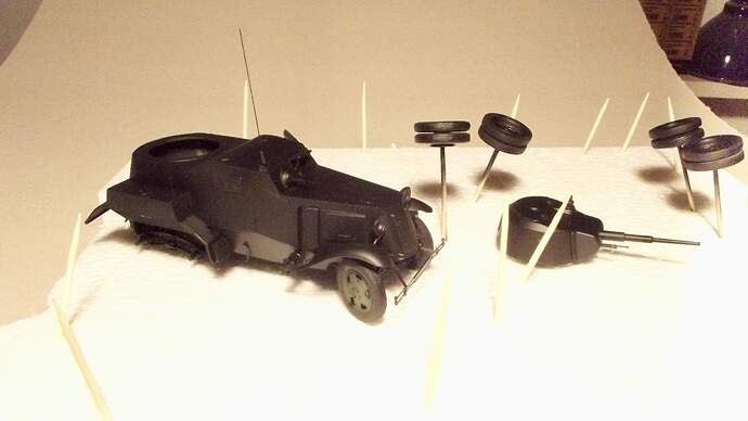

Started with the figures and the BA-10. This is my first Hobby Boss kit. Looks a bit like Bronco, very very much parts, thin, with vague clues where to put them, and at the end 75 % of the parts will not be seen.
Lately I start with Mr. Surfacer Black and Tamiya, thinned down with, Mr. Leveling thinner. So I airbrushed the figures black and later with Tamiya white from above for the glazing technique.
I painted the inside and underside of the BA-10 and now attached the pe- fenders.
Might look like Bronco, but they are more moderate with the part count and detail. Sorta like Tamiya but not as well engineered. FYI, HobbyBoss has started rereleasing Tristar kits.

Primered the beast with Mr surfacer black, then with Tamiya dark green, both thinned with Mr. Leveling thinner 400.
Next color will be German dark grey.
Basic AK Real Color Panzergrau and a satin layer of VMS

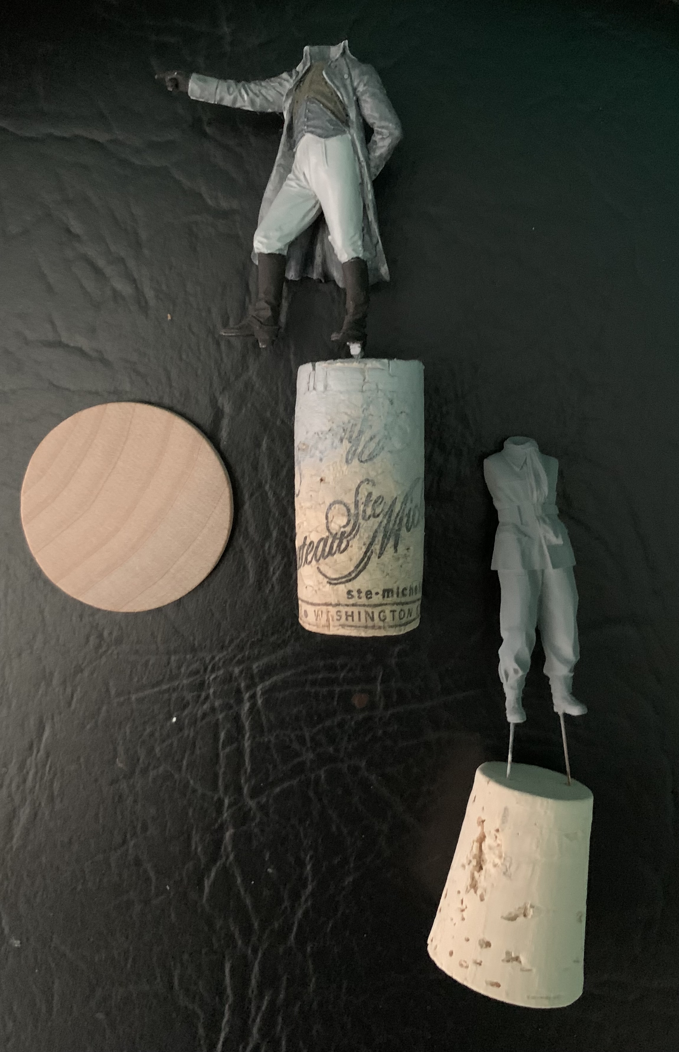

Very nice work there! Are those wine bottle corks you have used to mount and paint the figures? Very good idea!
Round discs from the shuffleboard as a base, 2 c cement, a cork and a 15 mm rod.
A hole (or 2) in the bottom of the figure does the job :grimacing:
I like that idea and will give it a go with the base. I have switched to a different style of cork for some figures. The wooden nickel and cork was acquired at Hobby Lobby.
Works out great.
Thanks for the tip.
