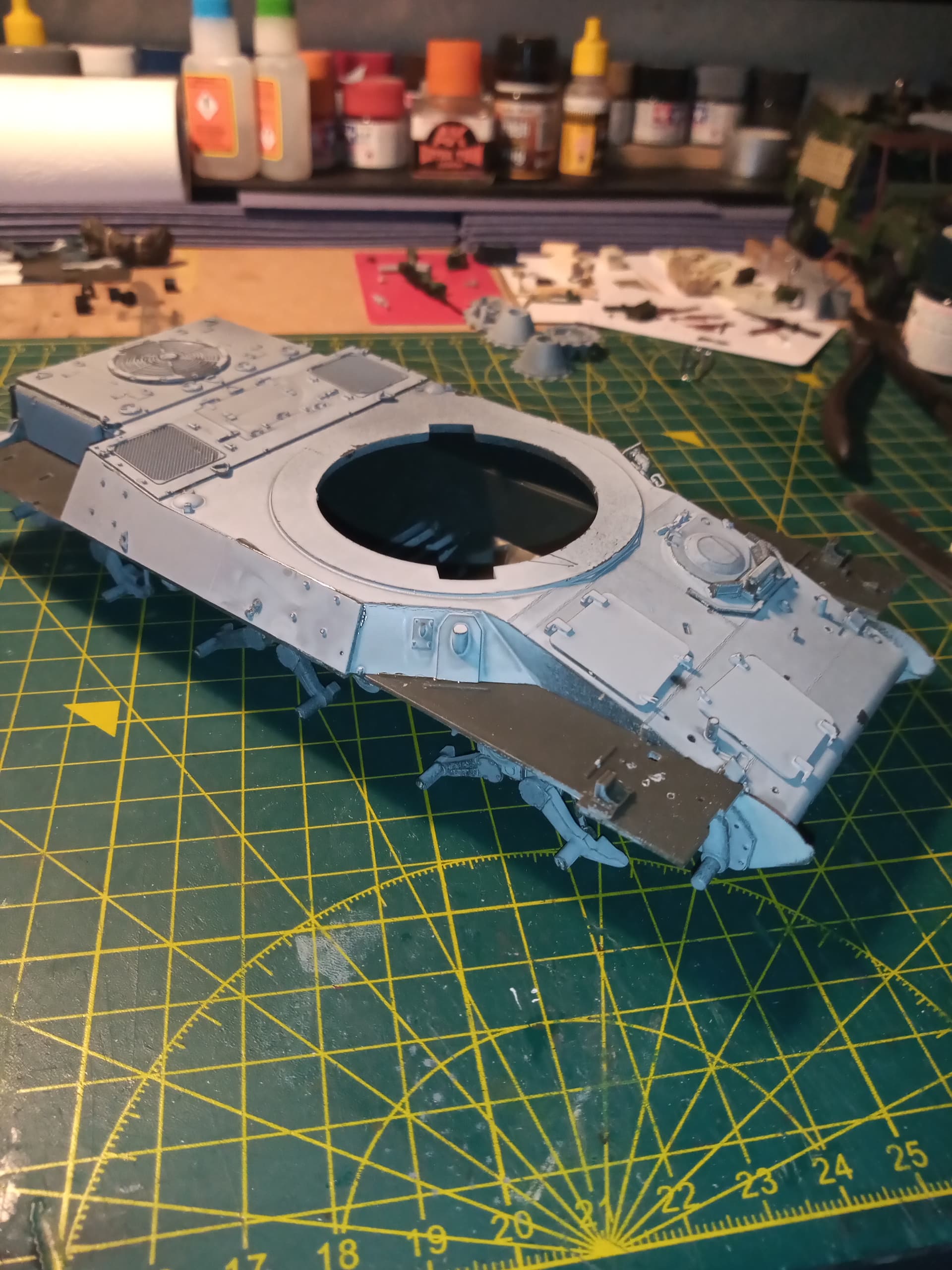

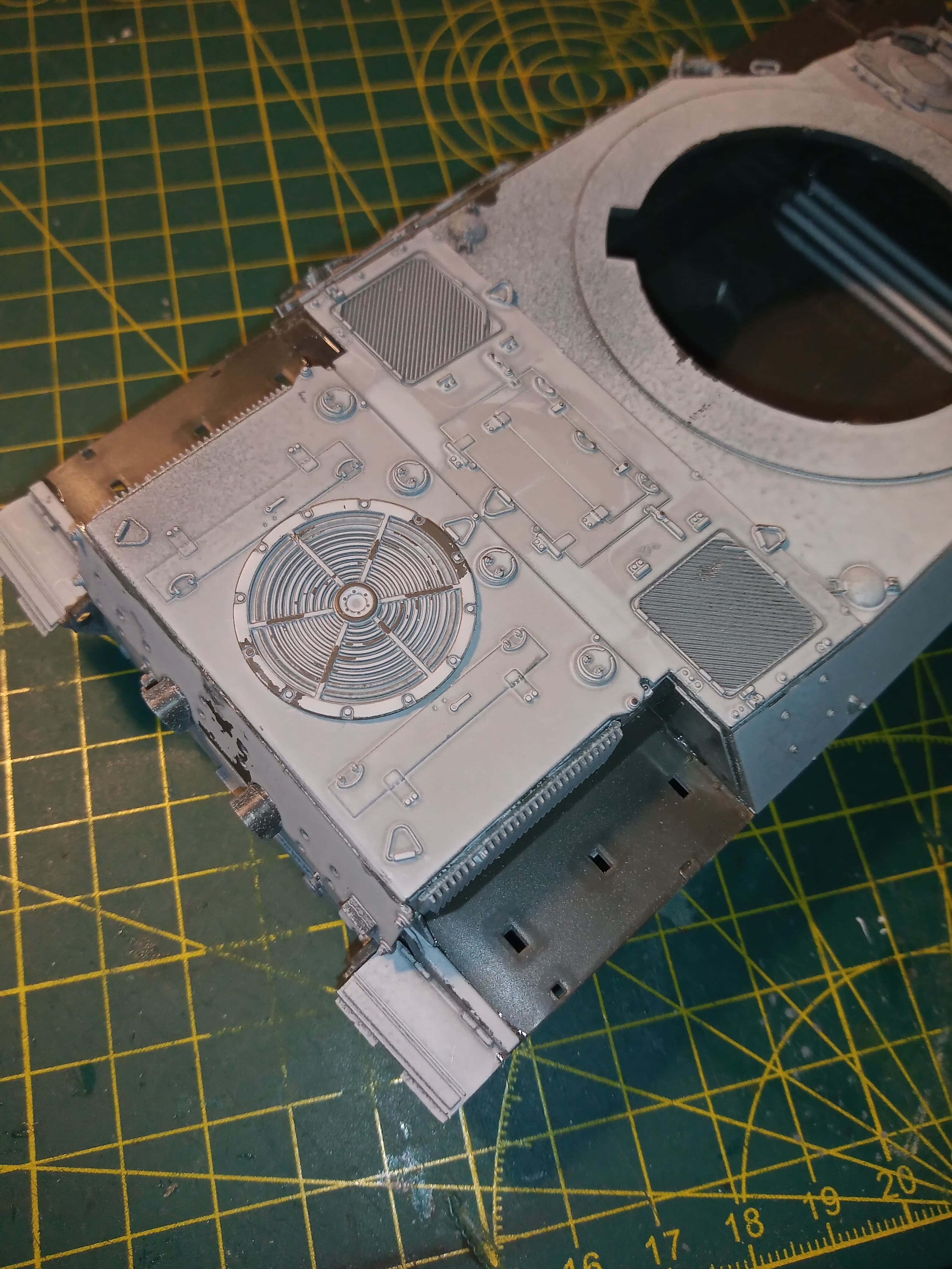

Upper and lower hulls are now together
Again, everything fitted perfectly and nice and snug. You get 2 types of engine deck supplied, same for the exhaust side grills and the circular air inlet ? I presume they are for an earlier version of the AUF ?
Stay safe everyone :+1:
You’re right about the engine grille and the exhaust mesh protections. The TA is based on a AMX 30 B2 which has a different engine deck.
The earlier AuF1 had a AMX 30 B engine and rear hull.

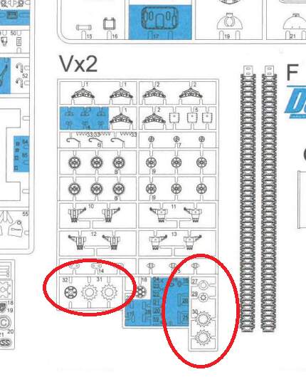

Doug, it might be worth putting up a thread and asking if anyone in the USA has the ‘fancy’ Tamiya sprockets as spares and would be willing to sell them to you. Most Tamiya kits have both the ‘Fancy’ type and ‘solid ring’ type:
Otherwise, what you mean by wrecked? Did you break the teeth of the sprockets off trying to prise them apart? If so, and the central hub and centre bolts are okay, you can get a replacement ‘fancy’ type ring from a Dragon kit if you have one, or see if someone can help out. Dragon supplies both the solid and fancy types in their kits. As long as the donor vehicle kit is one that can use the solid type, the fancy ones could be used:
