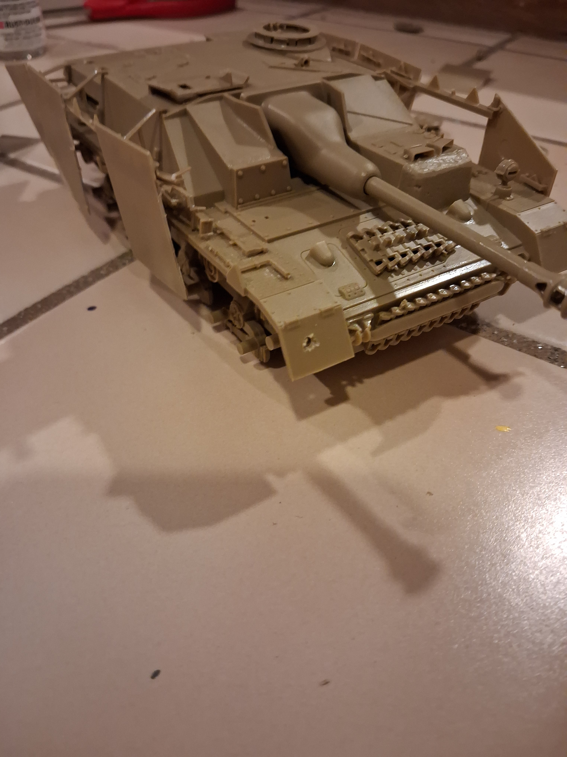

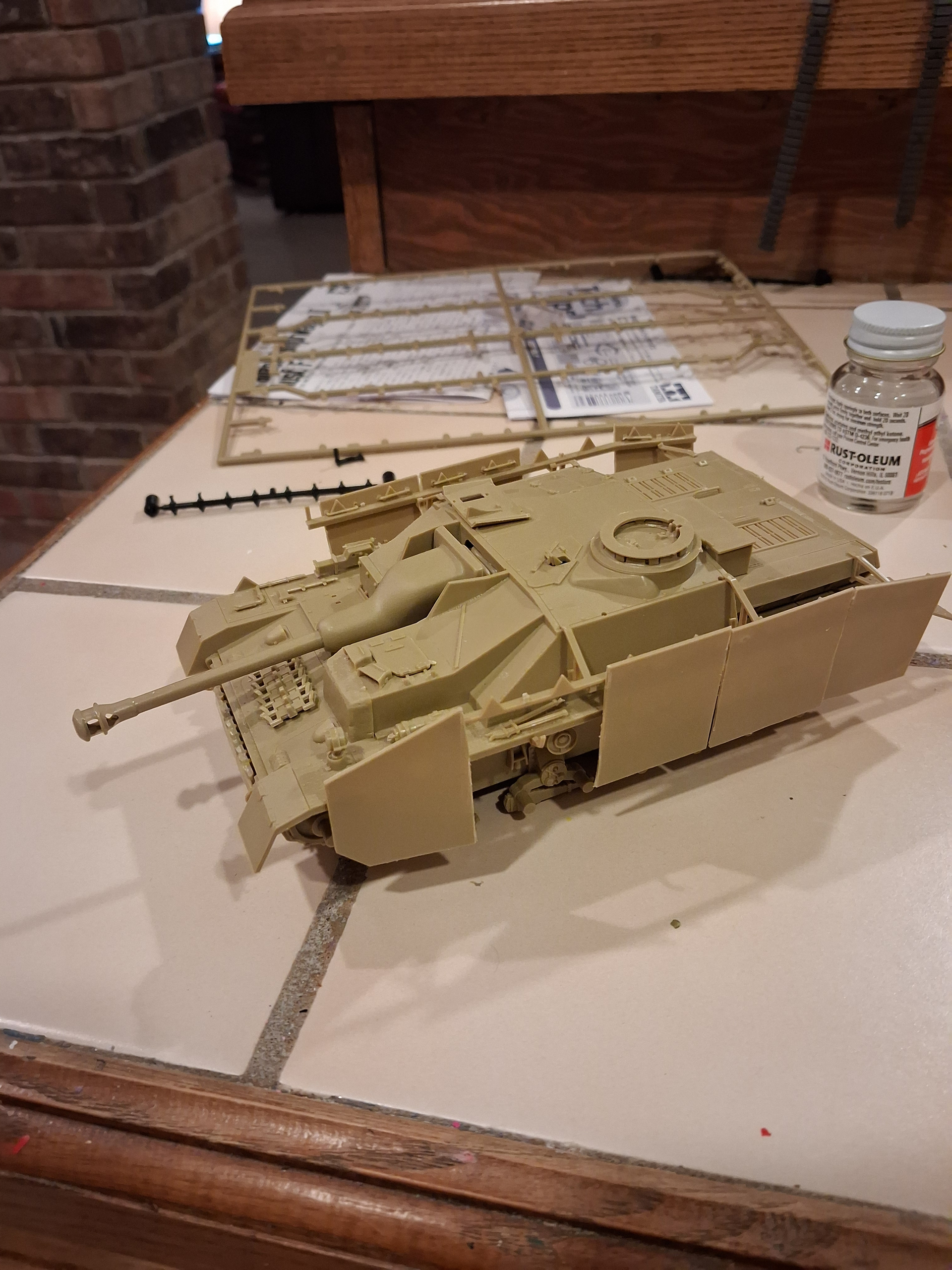

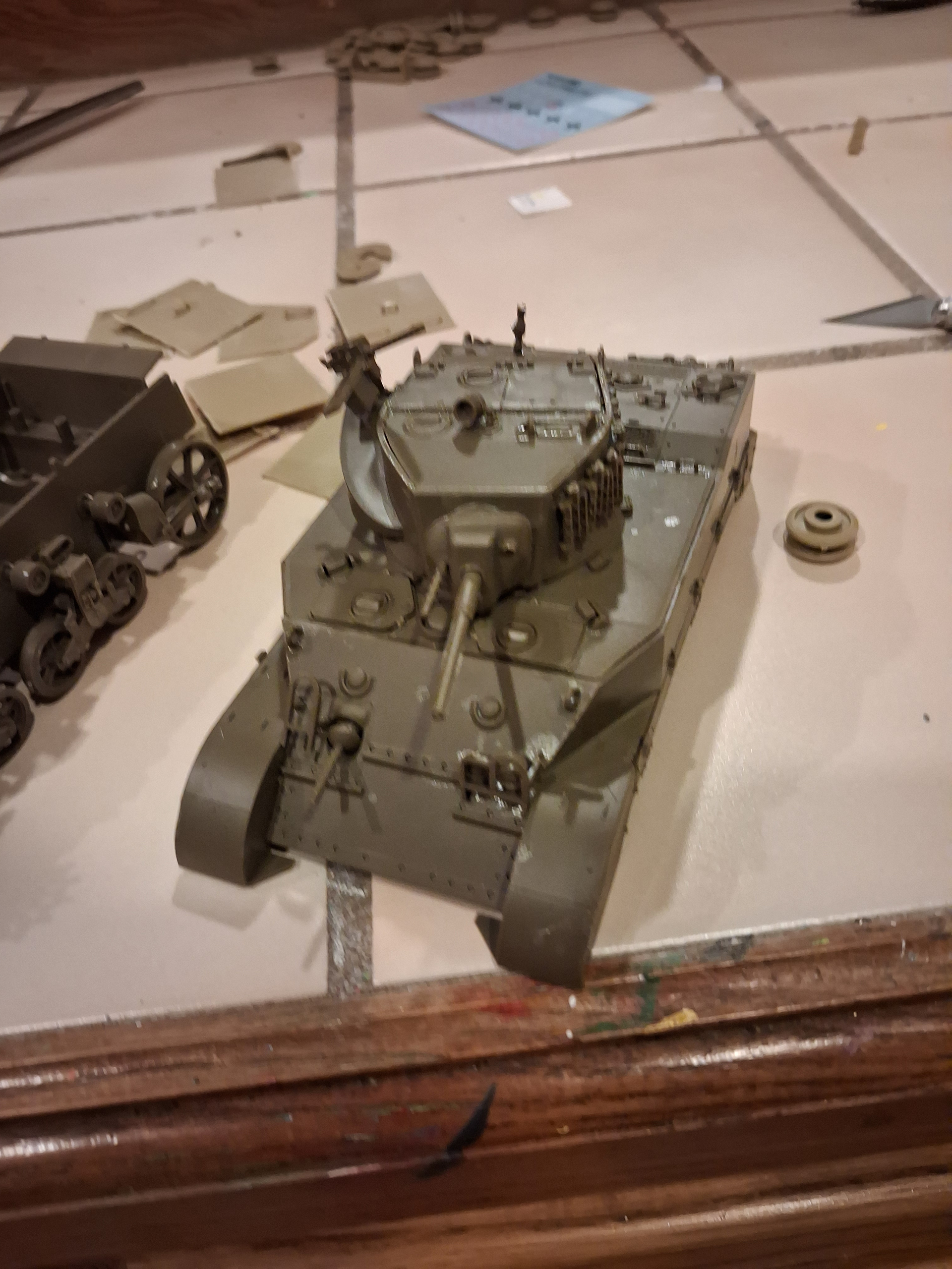

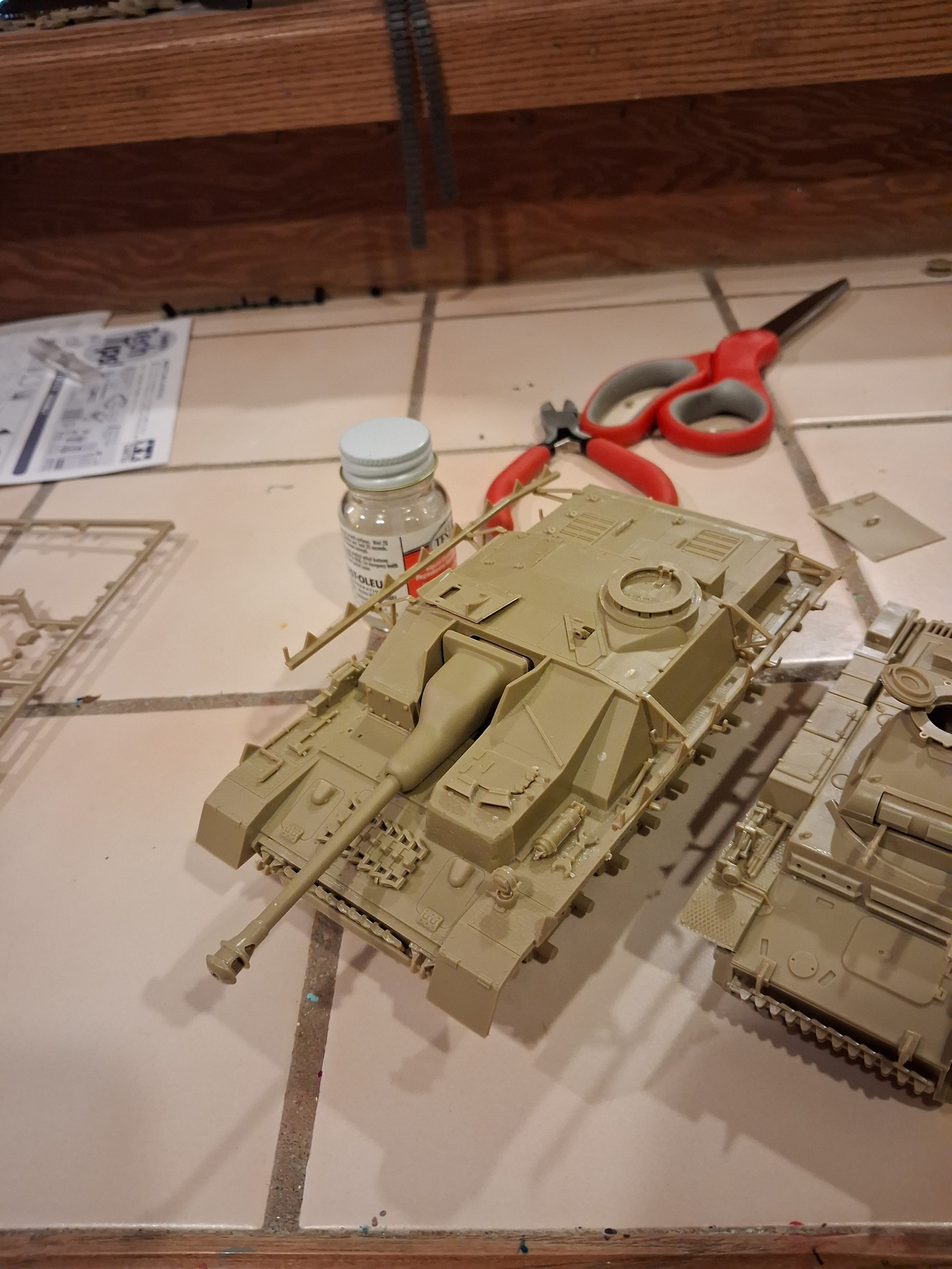

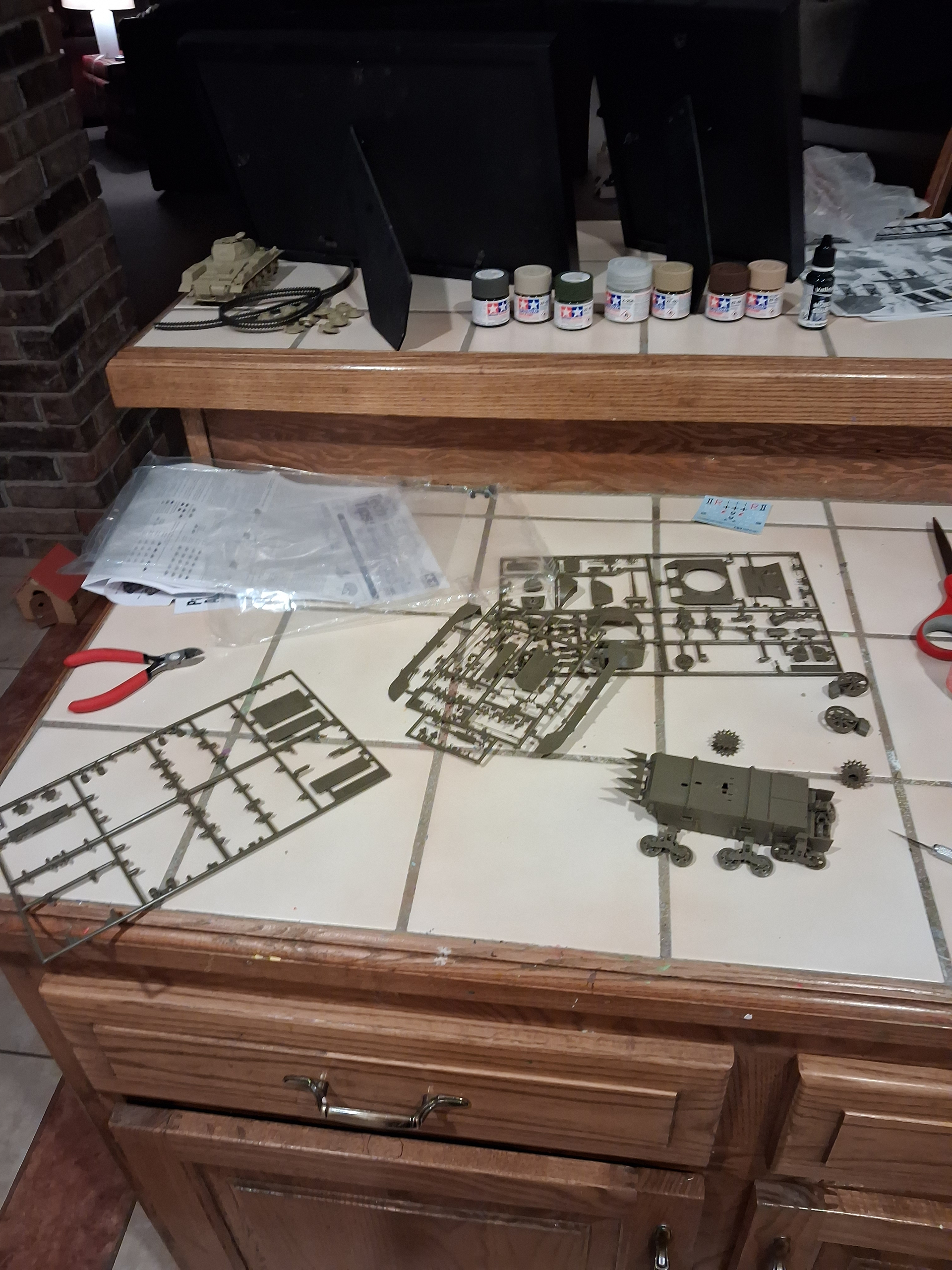

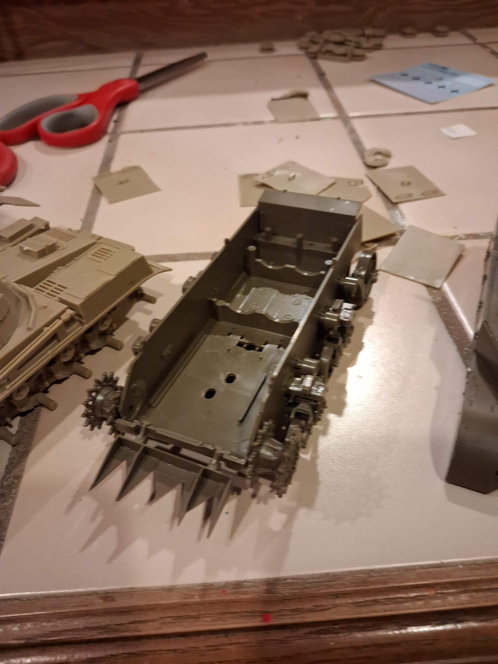

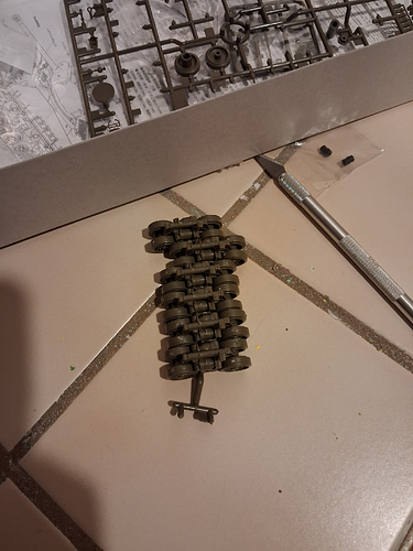

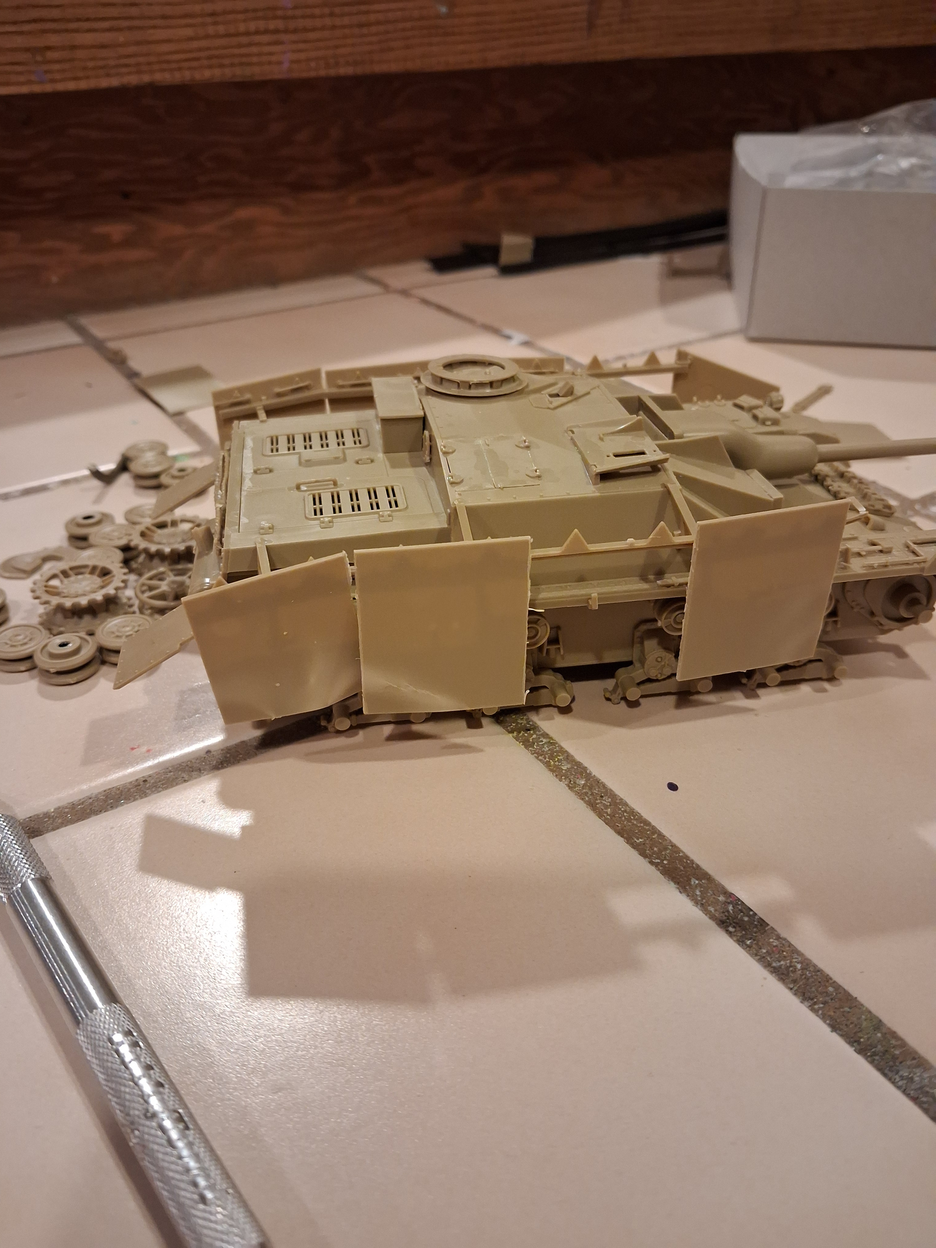

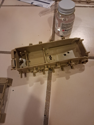

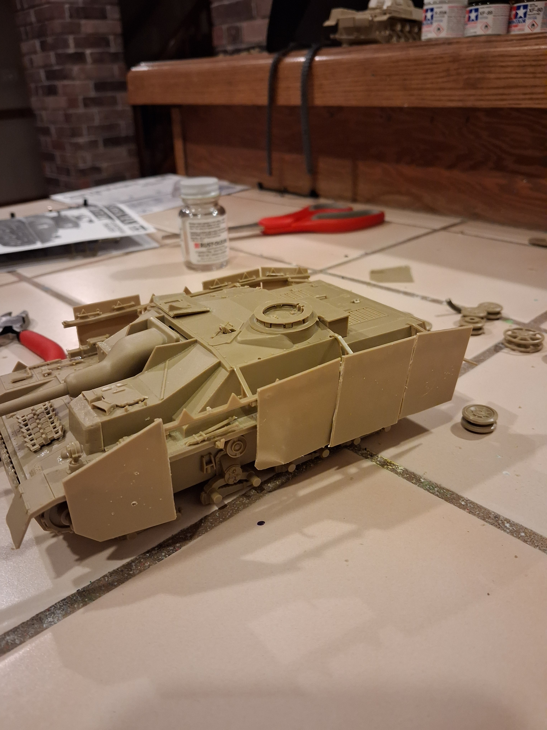

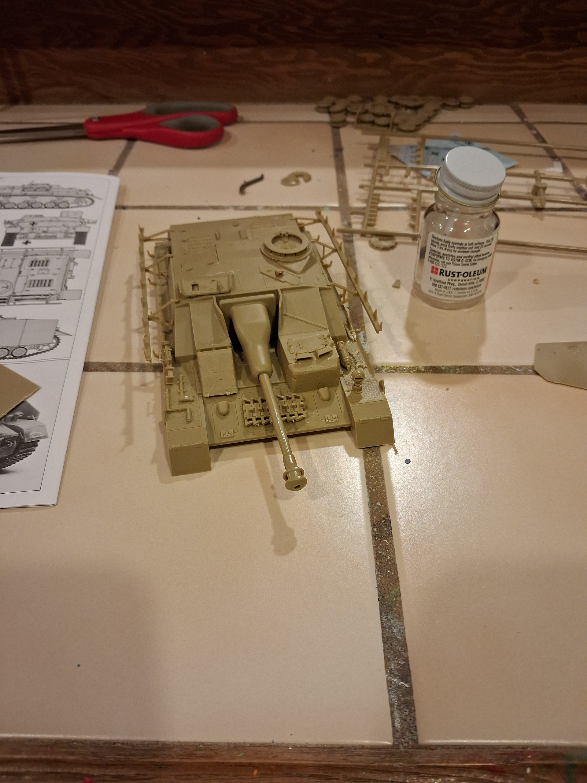

These are the first three kits I’ve ever built and I am waiting on a cheapo airbrush to paint them I will post the follow up layer

Welcome to Armorama! Your builds look good. You’ll find lots of friendly guys with lots of good advice here. Don’t be afraid to ask questions; they will be answered! Good luck with your new airbrush.
Nice start, but with experience you may find that building in sub-assemblies before painting can be more convenient. You can find decent yet inexpensive airbrushes on AliExpress ($25 - $30 range), but you will still need a compressor, although there are some airbrushes with an attached battery-powered compressor.

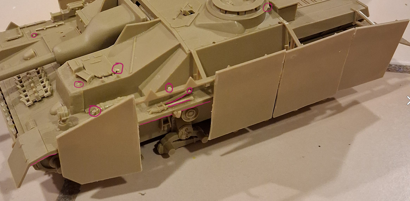

Tip for the future: You will get better results if you clean-up the parts before assembly.
The process of moulding plastic requires that the parts are shaped so that they
can slip out of the molds. Older molds/patterns usually cause edges and flash.
Use a fine needle file or fine sandpaper glued to a small wooden stick to remove these imperfections. The leftovers from injection gates (where the part is attached to the sprue)
also need to be removed completely (they can cause issues with the fit of parts).

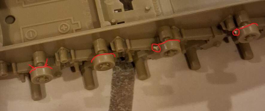

Mould edges and what looks to be two sprue attachment points:
Some more:
These will become more visible when you paint the models.

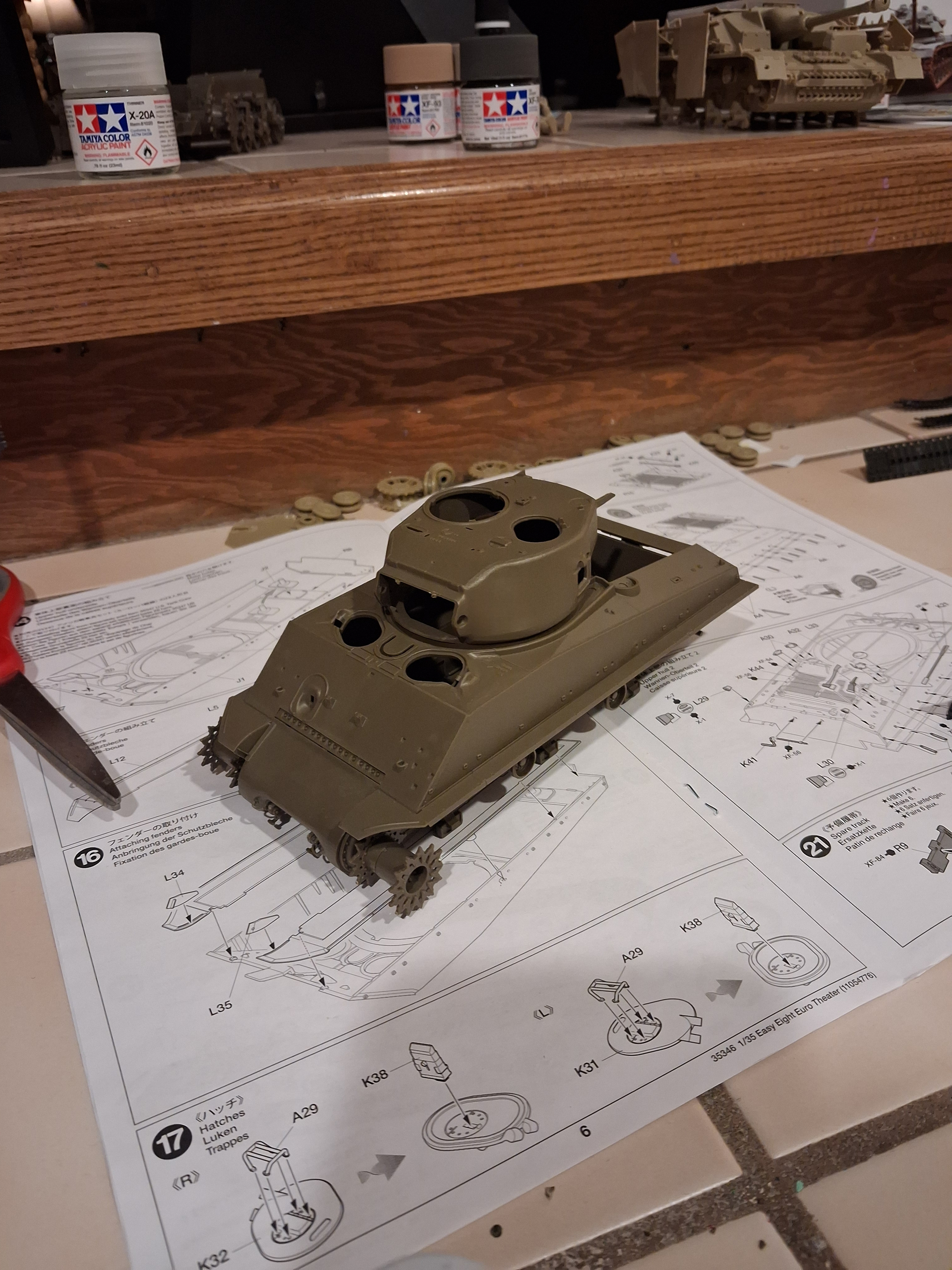

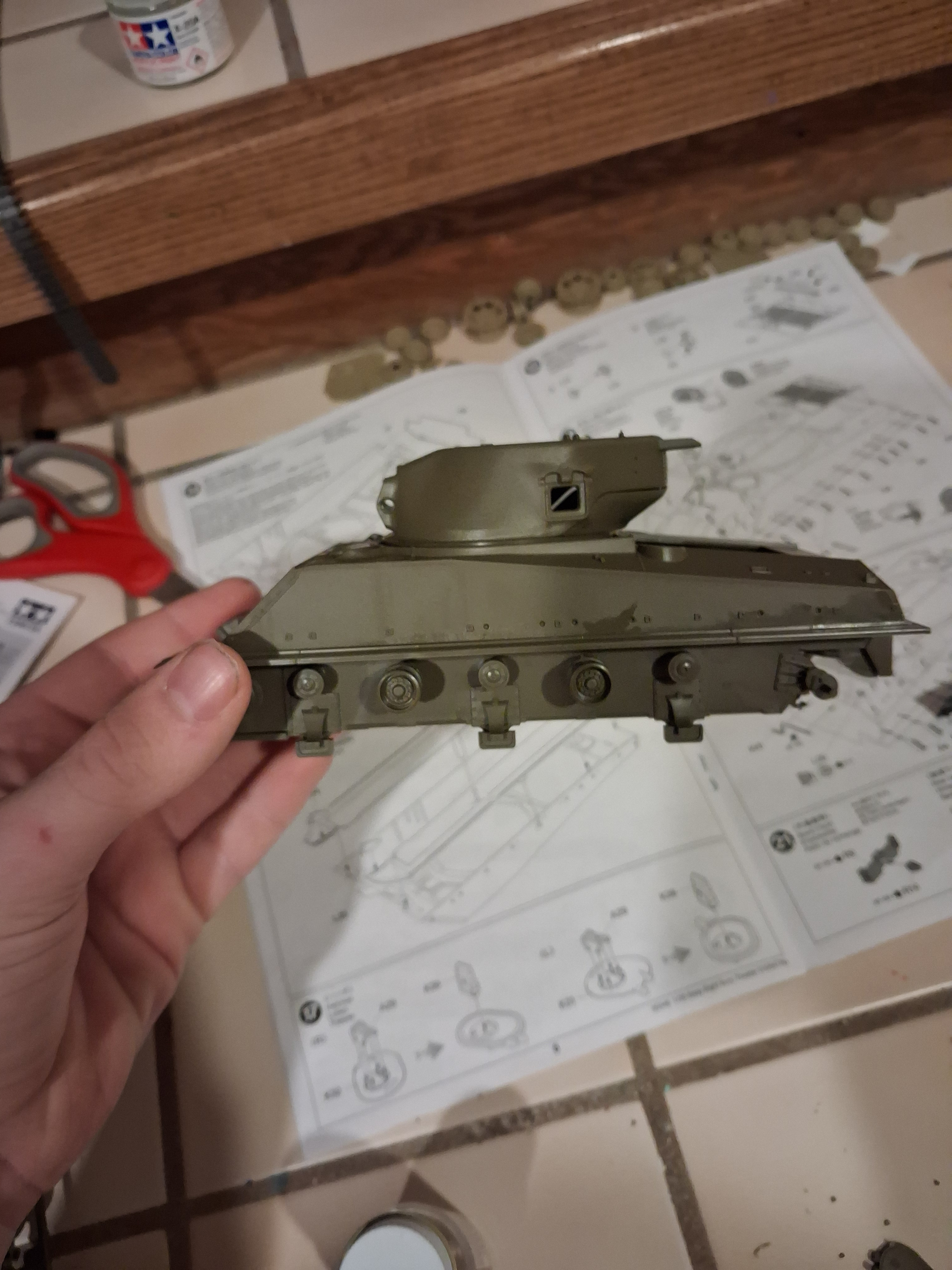

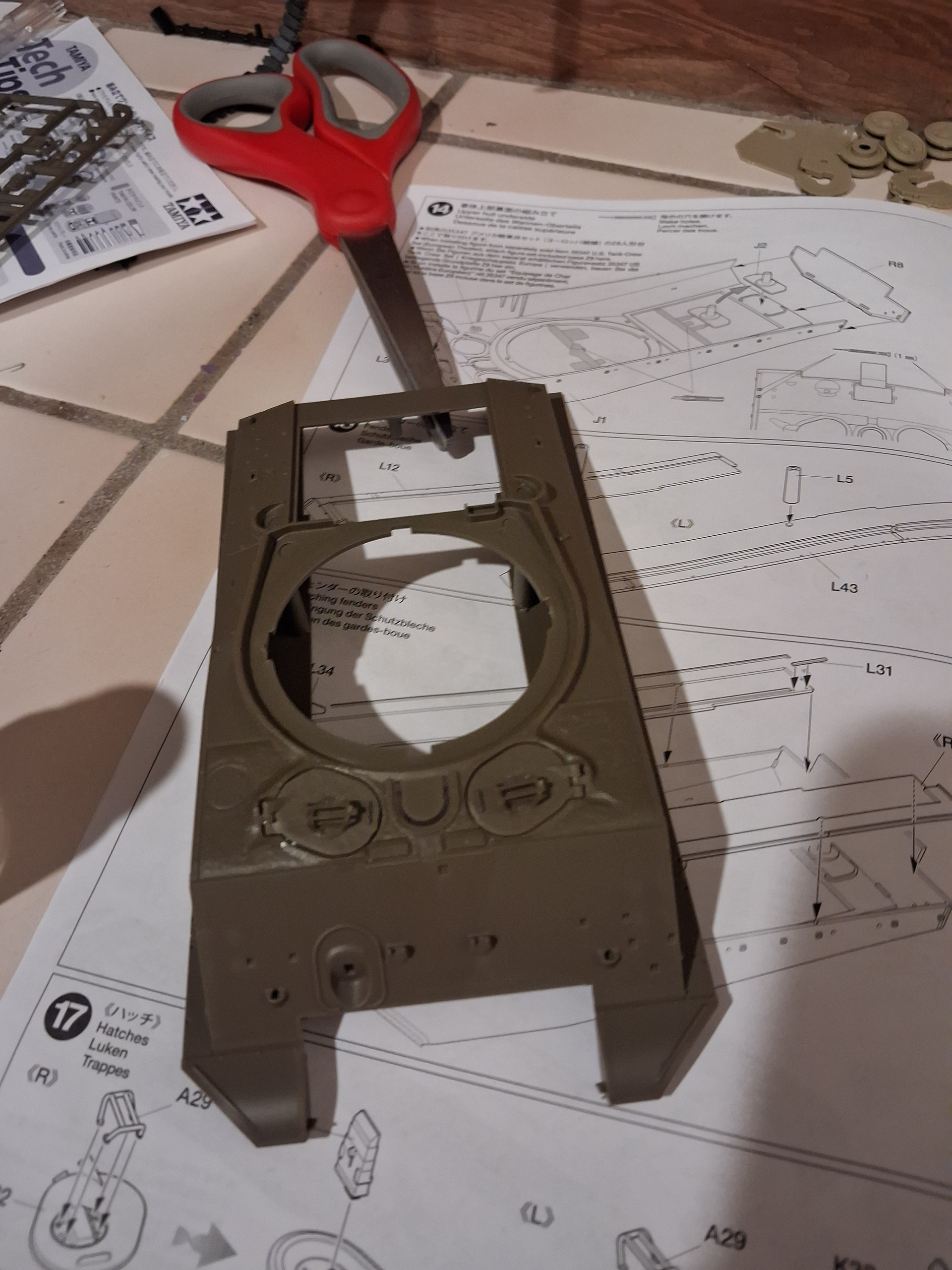

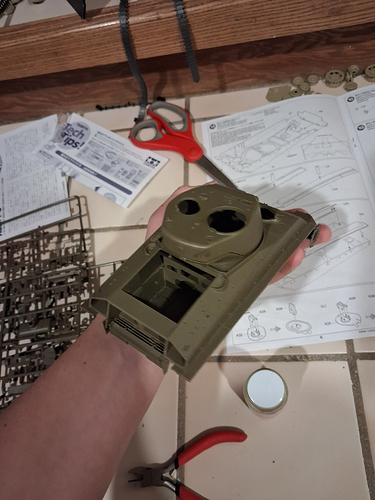

Some pics of my Sherman just a mock up the upper and lower aren’t cemented nor is the turret
Hatches
