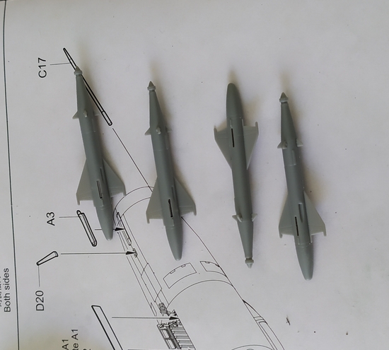

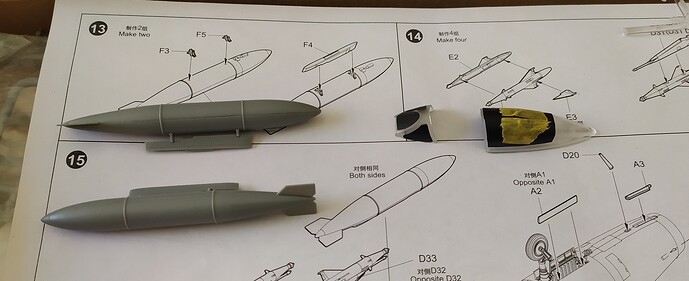

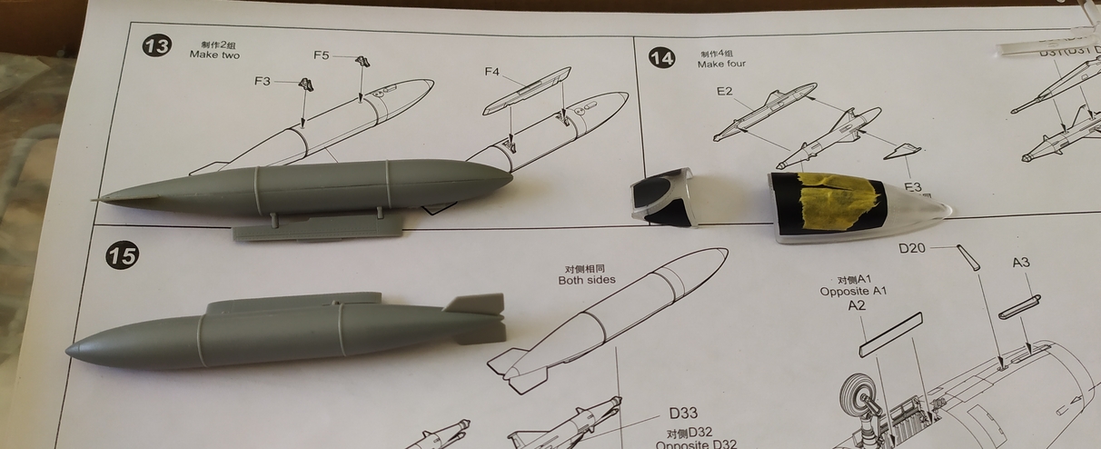

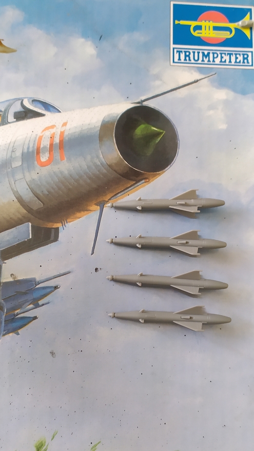

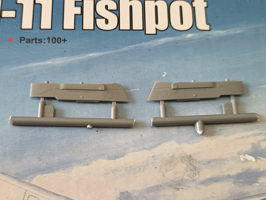

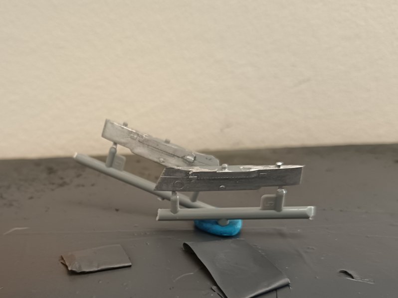

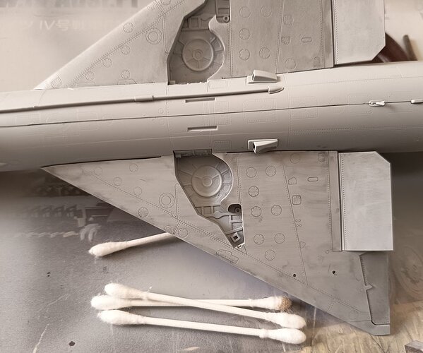

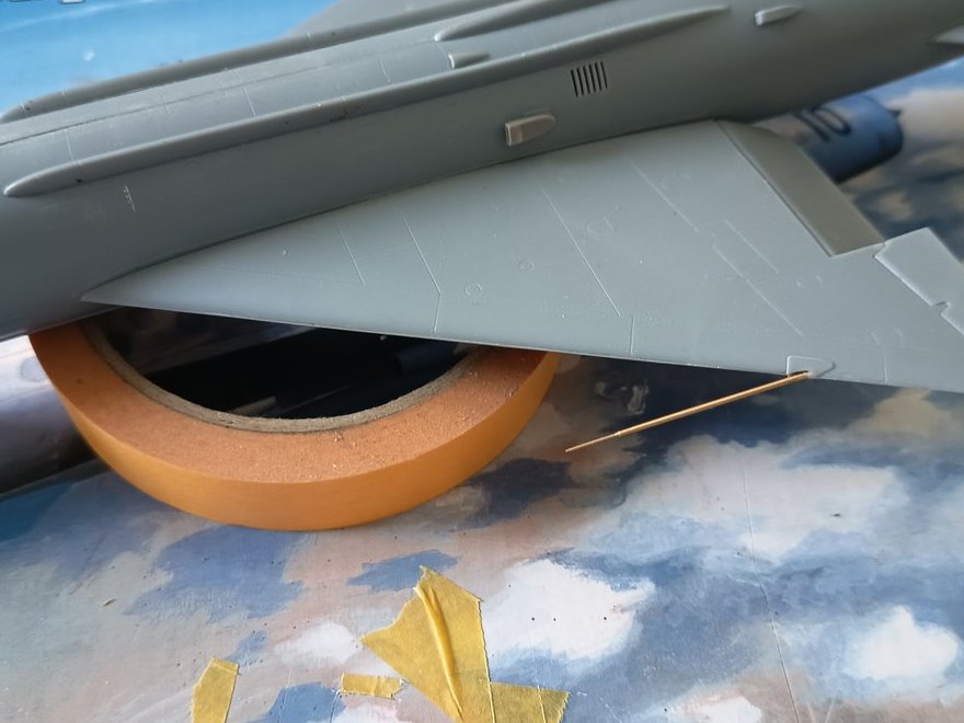

I worked a little on the Su-9, landing gear, correct masking, started the missiles
Finished building the missiles.

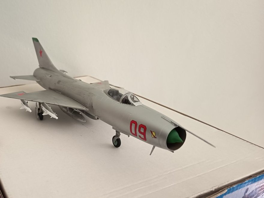

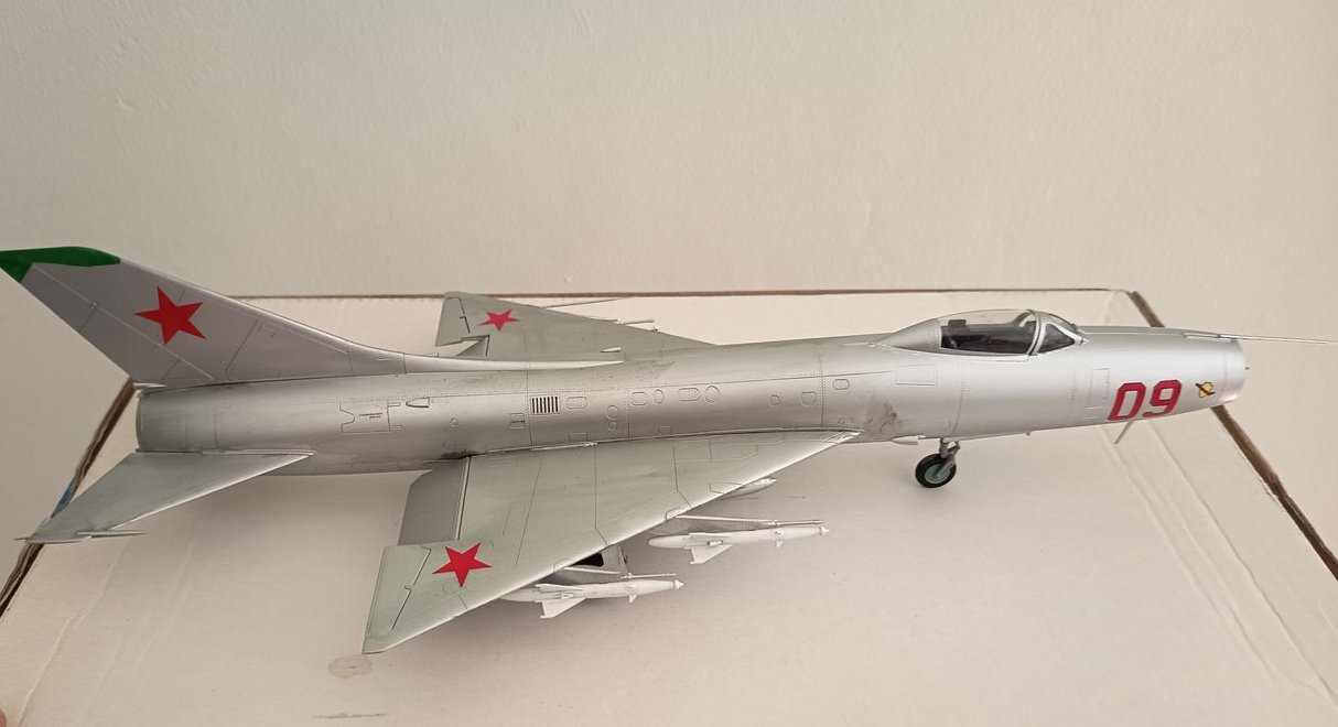

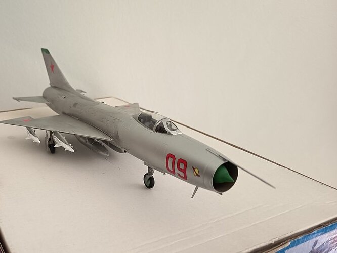

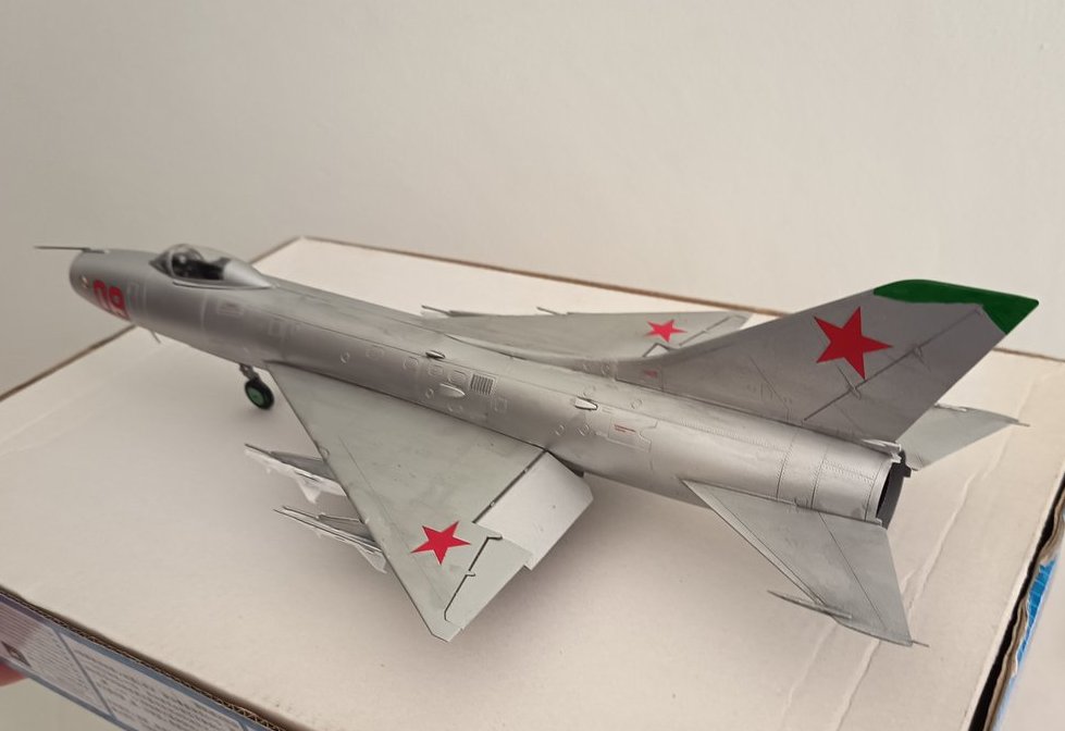

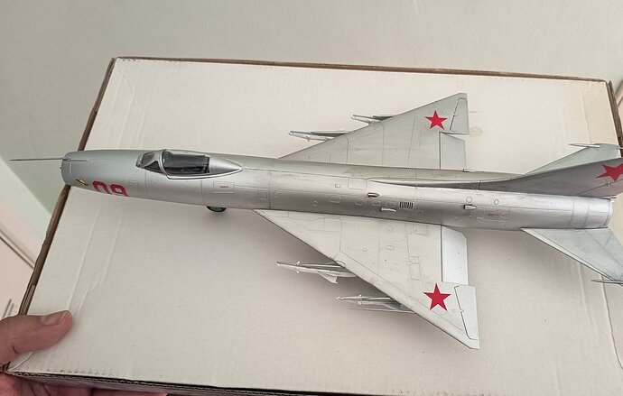

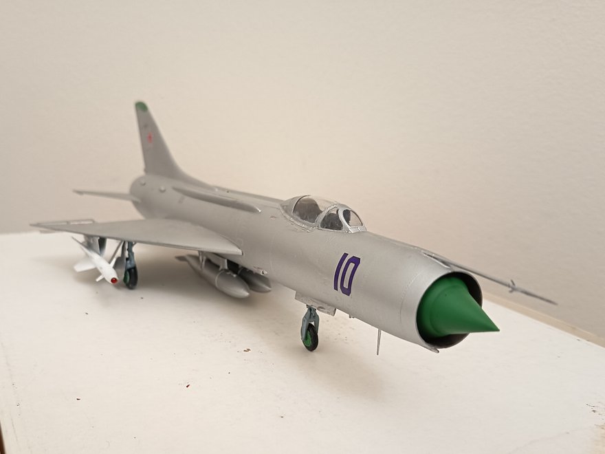

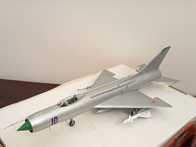

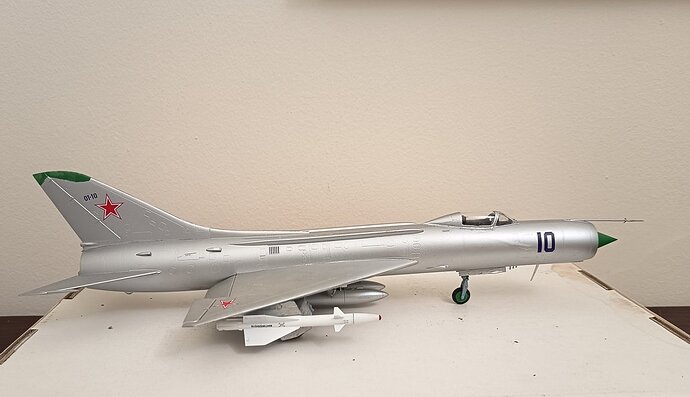

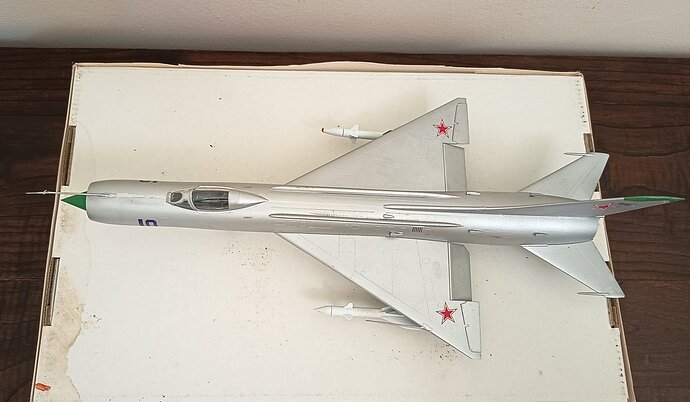

Su-9 is finished.

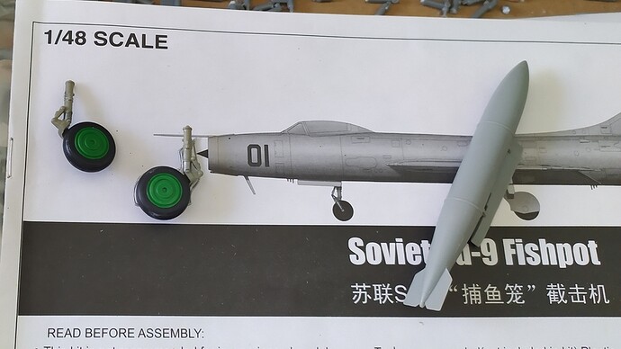

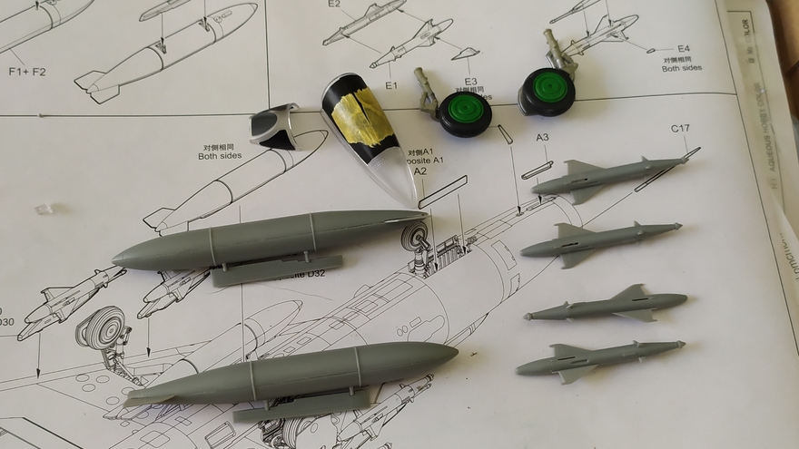

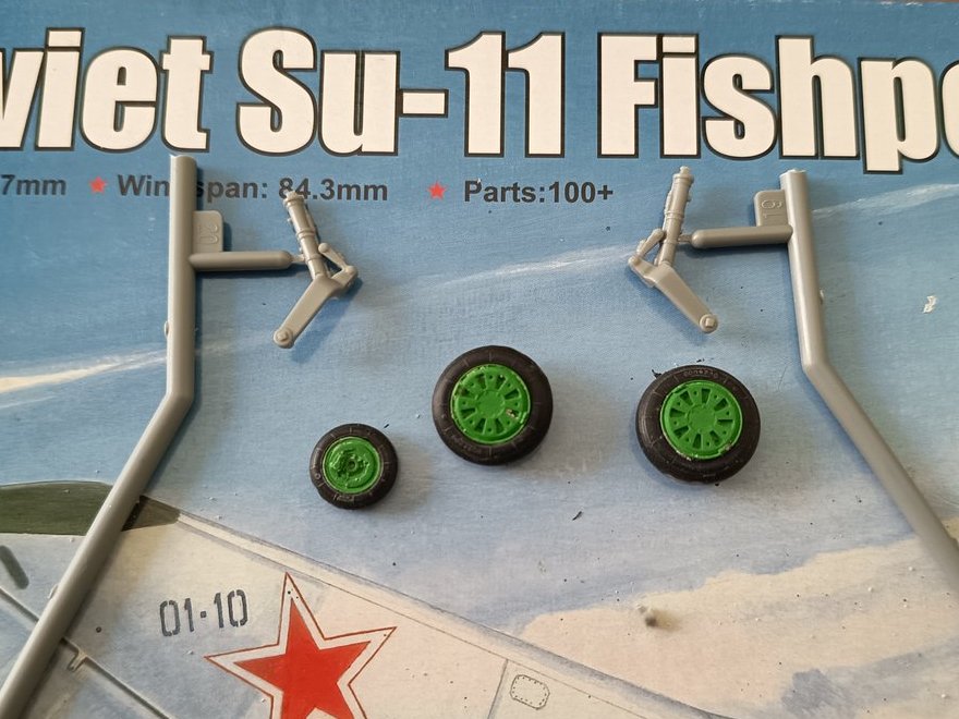

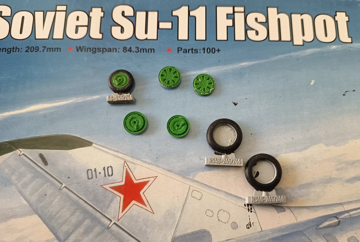

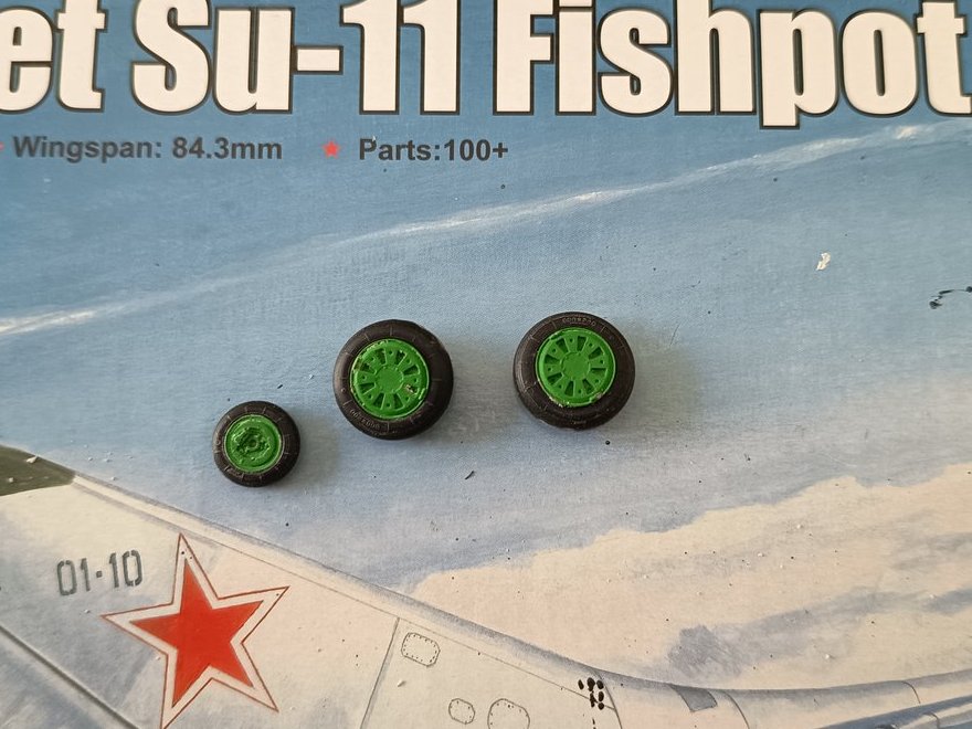

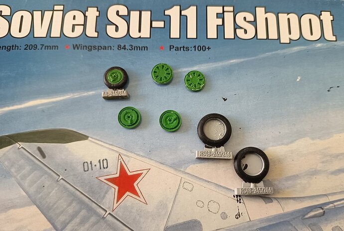

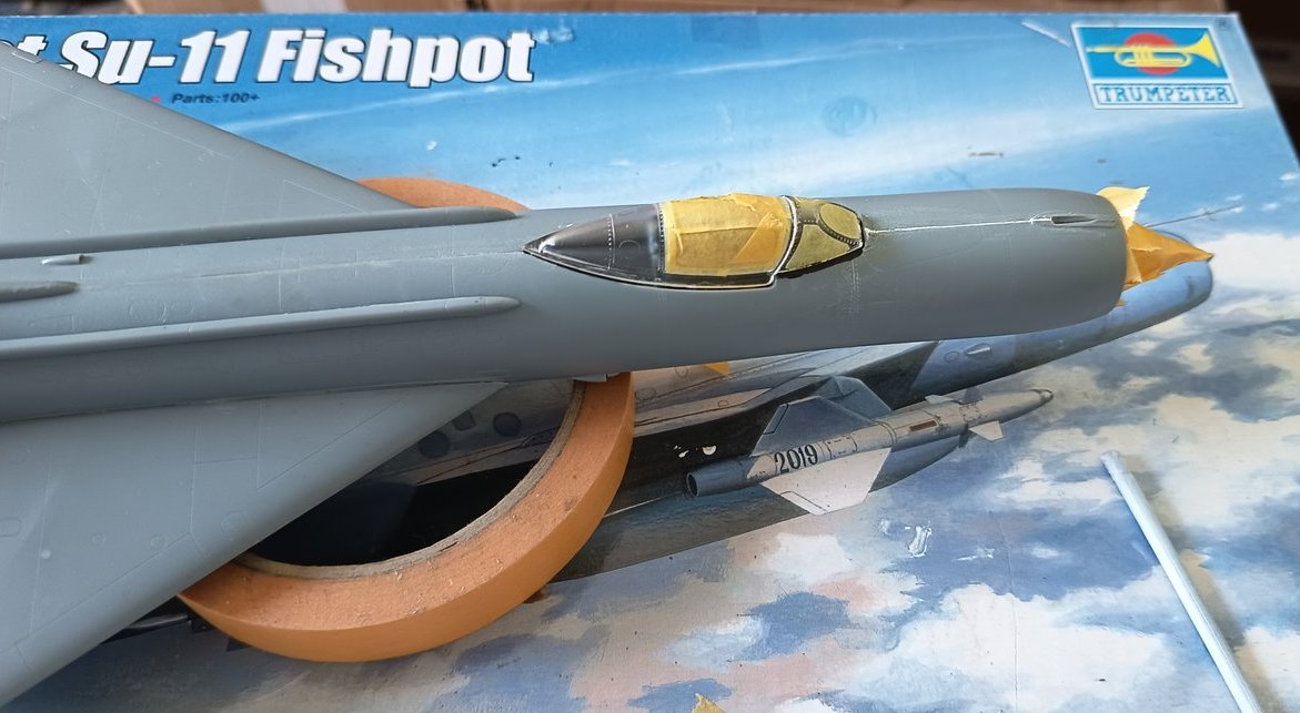

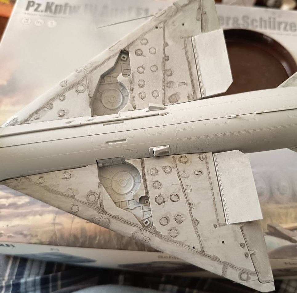

The Su-11 is a little behind, so I got it back to the bench and started working on the landing gear

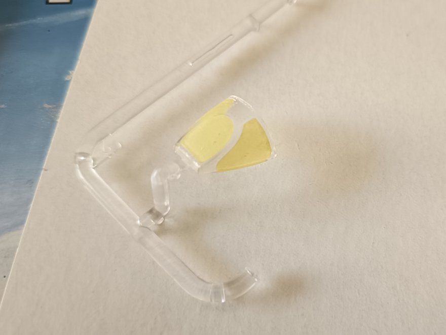

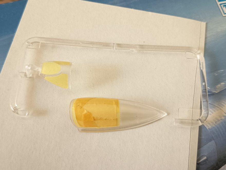

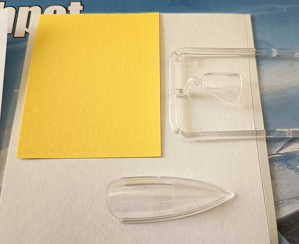

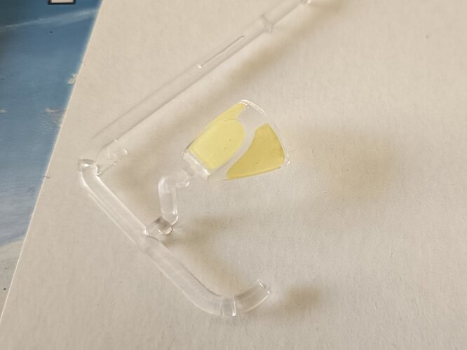

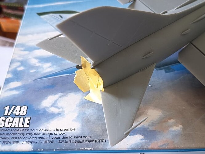

Looking good. It appears you had no issues during construction. Did the kits come with the masks?
No, they didn’t.
For the Su-9 I got a set from Montex and the Su-11 from Eduard.
No, no issues with the construction.
But the cockpit lacks detail, at this scale and given the size of the aircraft, I would expect better detailing.
The are other extras if you want to pimp it.. engine, wheels, air scoops and pitot tubes.

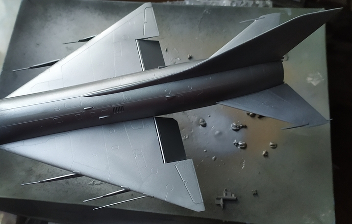

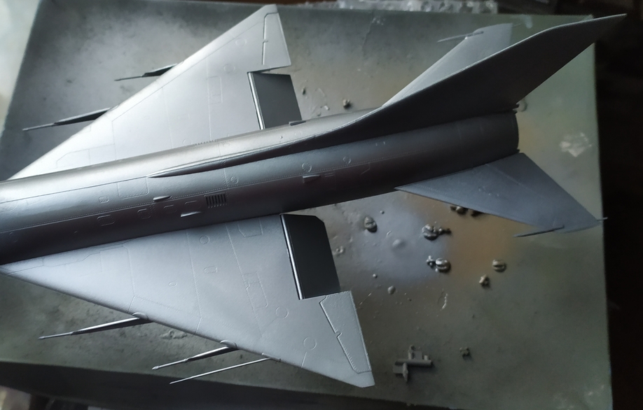

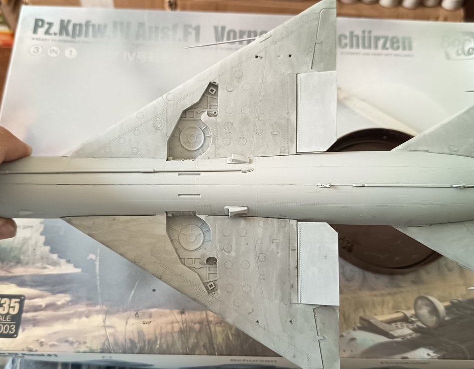

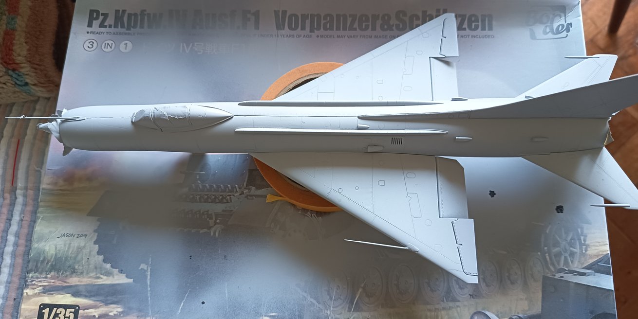

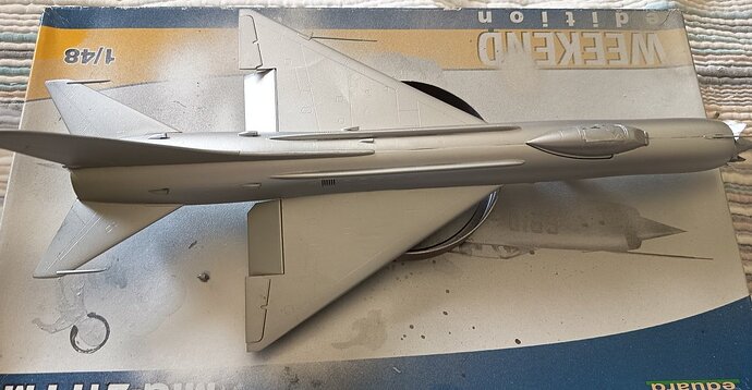

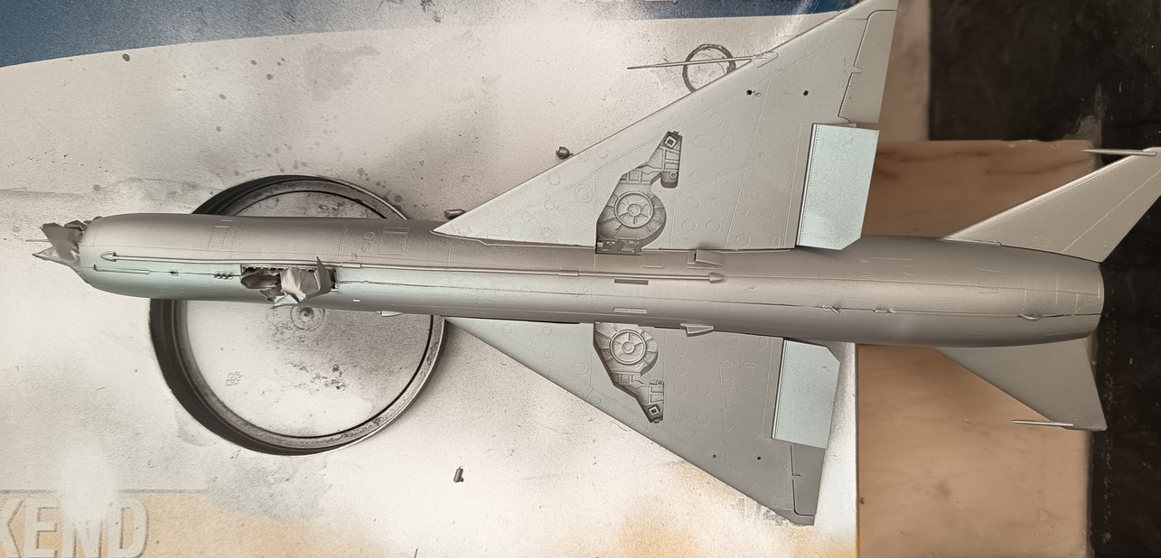

Almost ready for a Primer Session…
What’s your planned finish, NMF?
Yes, there’s no other option for this aircraft.

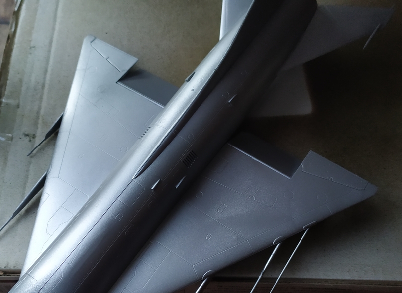

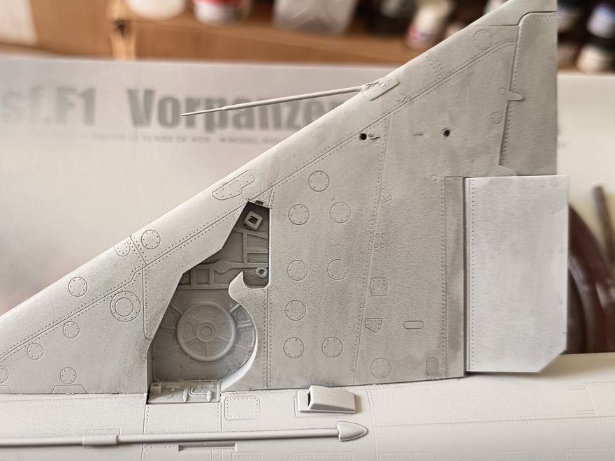

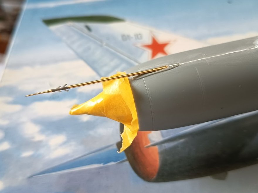

Pre-shading

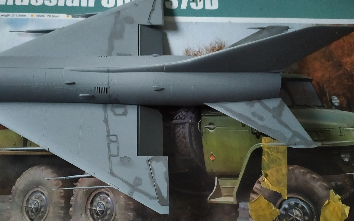

if i may say: the seamlines of the fuselage may need some putty and sanding.
If you never done this, and as the paint is already there
  • put a gloss coat on the whole plane to protect the paint
  • after drying, put some tamiya tape left and right of the seam (leave +/- 1 millimeter around the seam open for the putty
  • put tamiya putty on and clean away the excess, this should already give you a smooth surface
  • move the tape a few millimeters away from the filled seam
  • clean up with sand paper 600-800
  • repaint

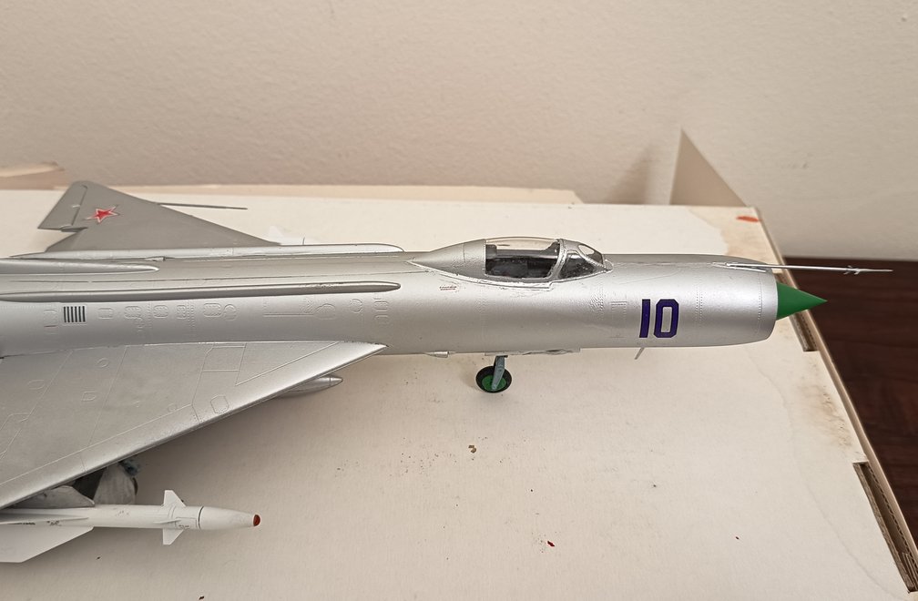

Thanks!!!:grinning_face:

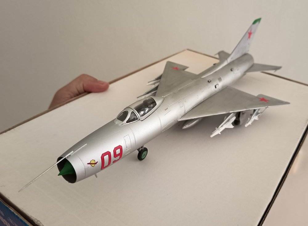

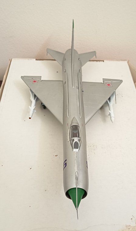

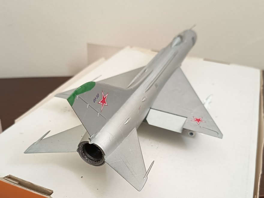

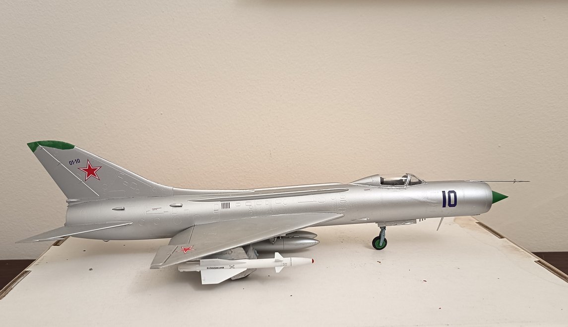

Finished!!!
