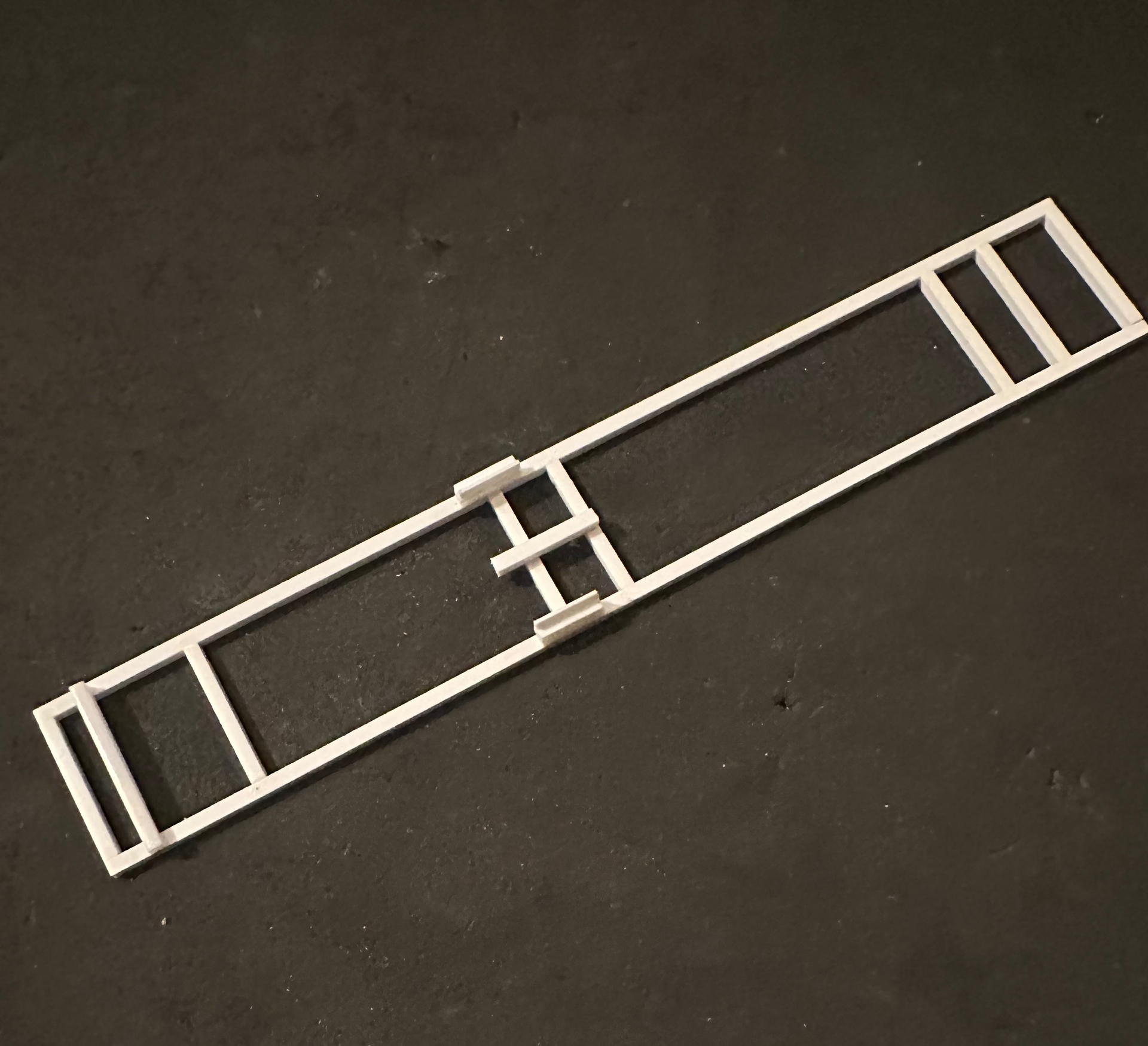

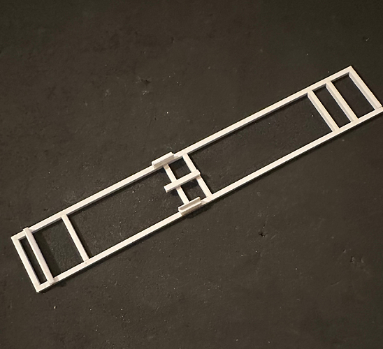

As many of you know, the ATACMS version has an extra sprue for the ATACMS missile and the most of the pod parts. Unfortunately it relies on the original sprue for the pod braces, making it impossible to build two whole pods. Or is it?
I built the ATACMS pod as in the instructions, and then assembled the remainder of the parts for the GMLRS pod.
It doesn’t have to go to waste. All you have to do is add a few pieces of angle front and rear, and you can put it in one of the available MLRS kits, saving their pods for a possible reload diorama.
Or…you can simply add the necessary framework to finish out the pod, essentially giving you two pods for every ATACMS HIMARS kit you purchase. I’ve decided to go that route:

What sizes of Evergreen did you use?
KL
No. You’re still using all the parts in the kit. Just adding more. :smiley:
Top angles: .060
Bottom angles: .080
Other braces: .010 x .060
Not done yet, but it’ll require one more wider strip. I’m thinking .010 x .100
Top plate requires .080 half round and some rod.

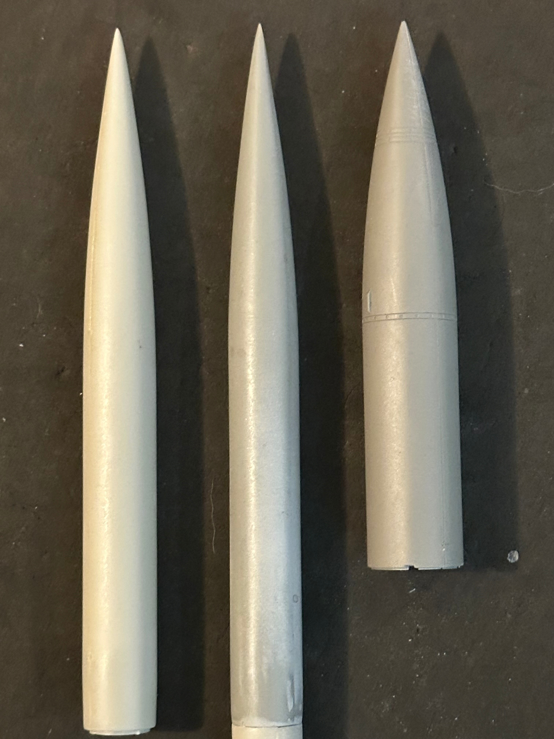

Yesterday I posted a link to a story about the PrSM’s operational debut. As it turns out, I’ve been working on several of them for a customer. I don’t post everything I do on here or it would be quite boring. :grinning_face_with_smiling_eyes:
Here are two of them in progress - the shape and proper scale diameter are dead on.. To their right is the kit’s ATACMS for comparison.
This is something I probably will have to make a mold of

Interesting. It looks like the kit rounds are quite over scale, unless I have misunderstood your post?
I have the ATACM’s version on order, so this is of interest to me!
The ATACMS missile on the right is correct. I used to build larger version for Lockheed Martin Missile Division with their pods, and have posted photos here which you can find.
The photo was simply to show the size difference between the PrSM and the ATACMS.
Two PrSM’s fit side by side in a modified pod.
OK, thanks! I thought I’d probably misunderstood!
The Precision Strike Missile’s (PrSM) size and slenderness is caused by the miniaturization of microchips and electronic technologies over the decades, resulting in two Precision Strike Missiles of about the same performance as one older ATACMS for the size. Thus, a HIMARS can fit two slimmer PrSMs and a MLRS can fit four compared to one ATACMS per HIMARS and two ATACMS per MLRS.
The PrSM is about to get a new guidance seeker, allowing it to target moving objects, including enemy ships for an anti-ship role, something the older ATACMS can’t do. Also, there are discussions of increasing the PrSM’s range to 500-1,000 kilometers (or even miles), much further than ATACMS.
