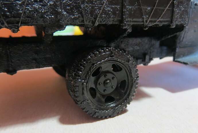

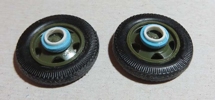

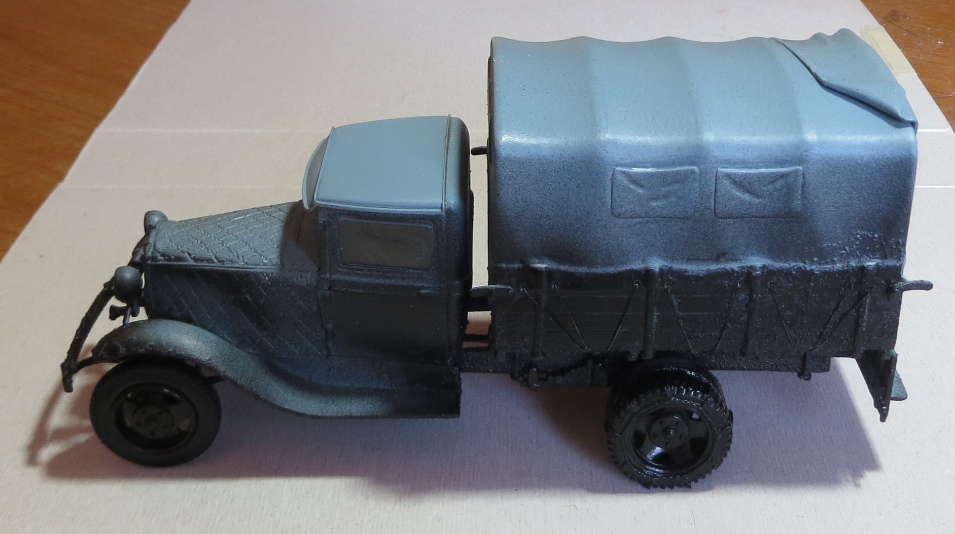

Thanks Tank … in the meantime some more progress. I used Flak’s trolley wheels to replace the two outer rear wheels.Then the thicknesses are added to create more space between the two wheels.
Hi everyone, let’s proceed with the construction.
due to wheels shortage you can use only one tyre on rear axle if semplify your job.
By now I have glued the shim, so this time I will put the twin wheels.
Thanks

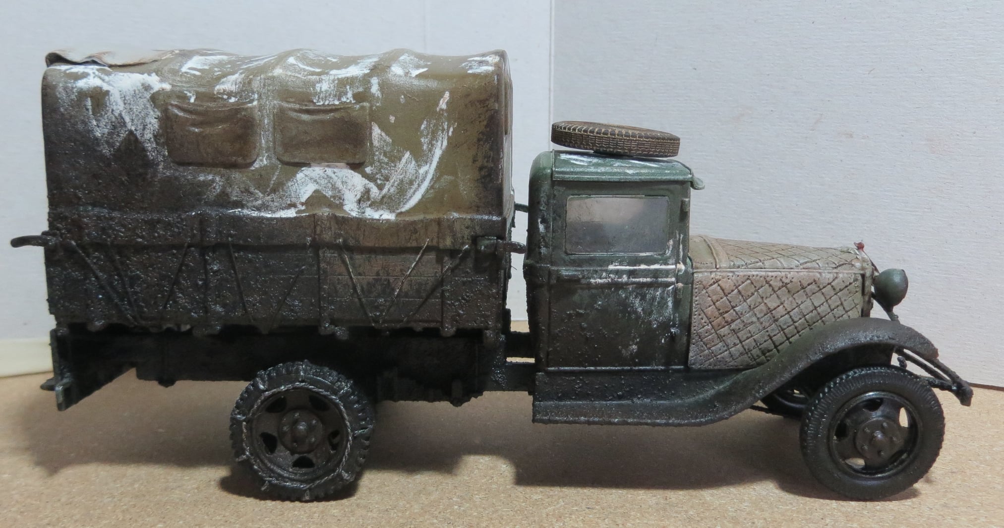

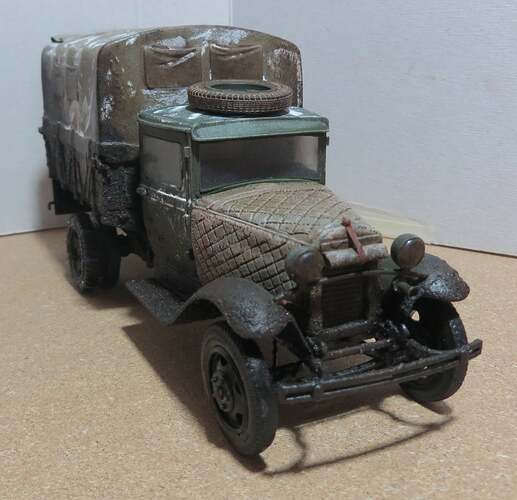

A couple more photos. I decided to apply a cover for the engine hood. And to make it I used the white Milliput.
Hello everyone, let’s go ahead with this pickup truck.
I like the engine cover, can you explain more about the process you used to create it? Thanks.
I used the white Milliput putty, spreading it and obtaining a sheet of about 1.5 mm. Then I laid it on the hood of the truck and scored the seams. When it was completely dry, I added 0’5 mm plastic strips. and the details on the radiator using cyanoacrylate glue.
Thanks for the information.

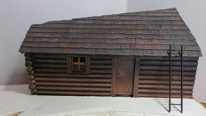

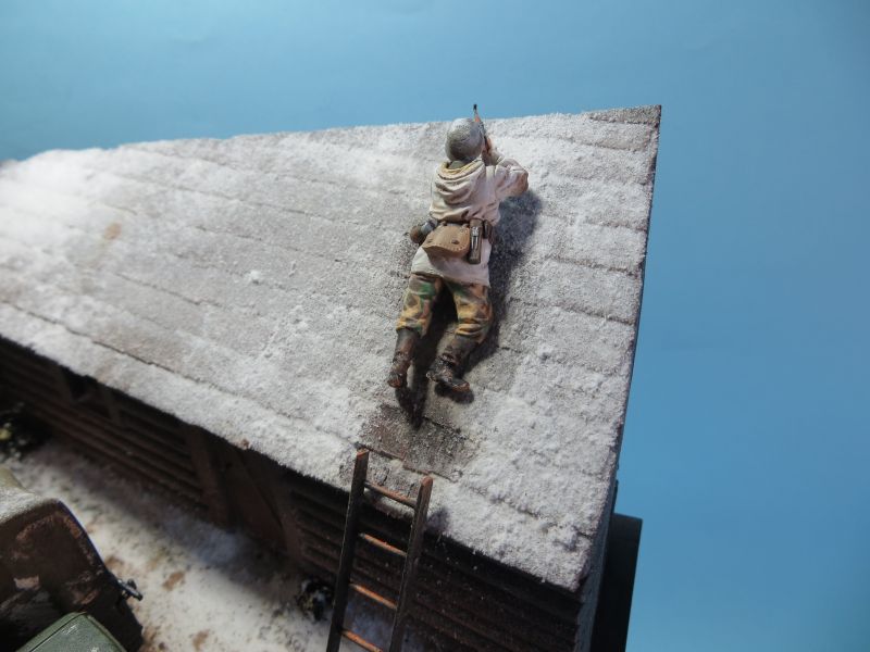

Hi folks, I made the isba and the various details of the diorama, stone wall and toilet …
All the details look great. :+1:
The toilet is good and beautiful, but not Russian.
Look at the kitography on the toilets.
toilet
Cool man , very cool !!!
Love the bonnet diaper .
Thanks guys … well I admit that not everything reflects the truth, in fact in my works there is always a bit of imagination … :smile:

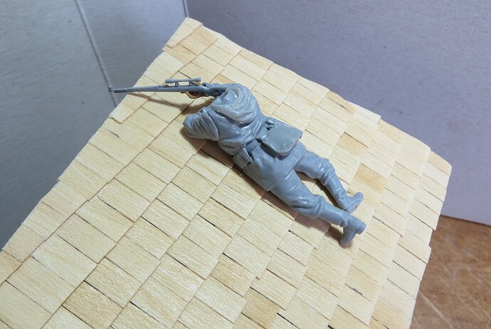

Meanwhile, I started with toy soldiers.
Hello everyone, we are proceeding, a bit slowly, but we are proceeding.
Hi everyone, and the job is done.
Nicely done man , very cool !!!
Looks great. :+1:
