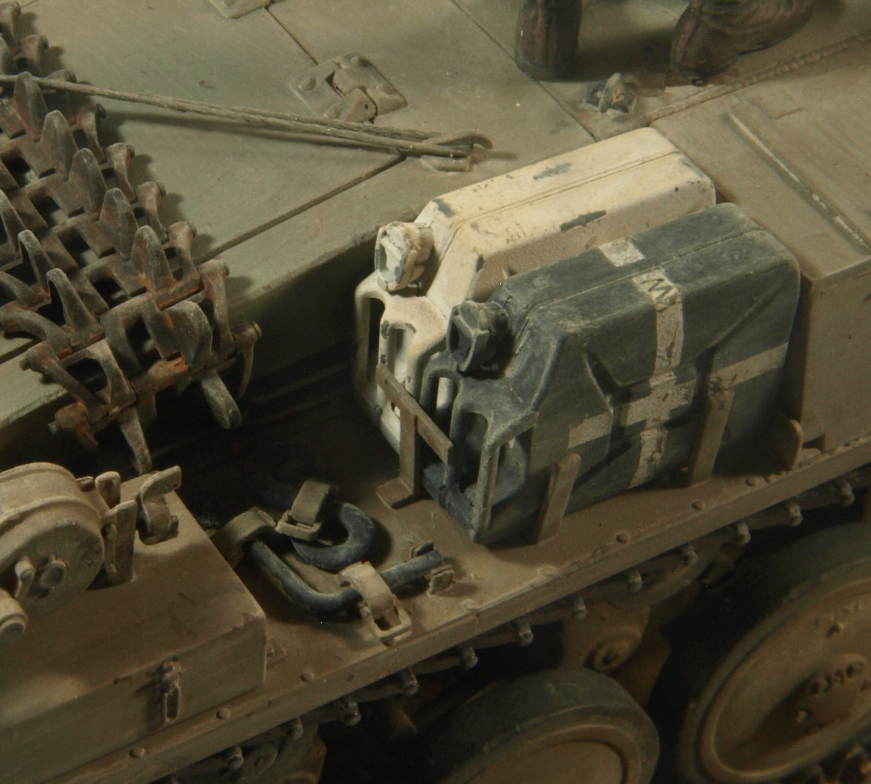

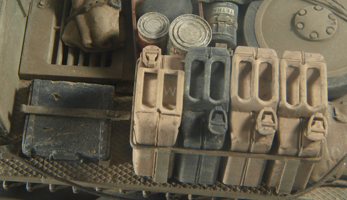

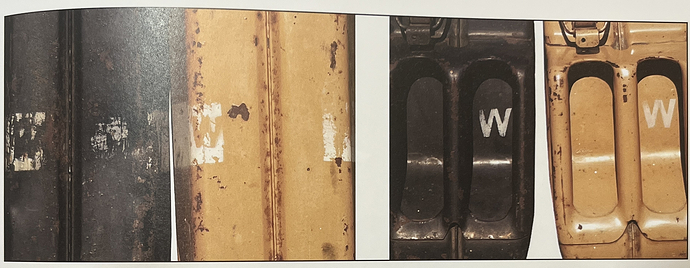

One thing that this article fails to mention, and no model manufacturer that I know of has done markings for, is the “W” marking seen on Wasser cans as well as the white cross. This “W”, placed on the top of the can to the right of the center handle, as well as a reverse stencil on the right side of the front of the can, was a factory marking along with the white cross and was applied by ABP, the primary manufacturer of Wasser cans, at least between 1940 when production started and 1943 when three other manufacturers started producing small batches of water cans. For obvious reasons, given the need to carry lots of water, it is typically seen on cans in use by the Afrika Korps. A photo showing the markings on vintage cans, a period photo showing them, and my take on them on a 1:24 Pz.Kpfw.II.
