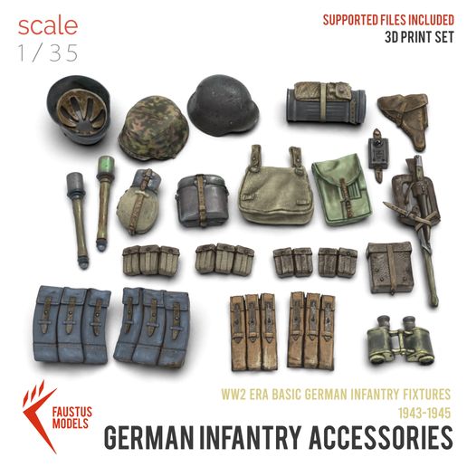

The air vent is trickier. If I were doing it, and thankfully I’m not, my solution would be to insert a tiny bit of hypodermic needle through a number 80 drilled hole, and cut it off just proud of the helmet surface. I’m pretty sure that would look like stir fried do do. So have you looked into these? (which can be scaled down)
Or these?
