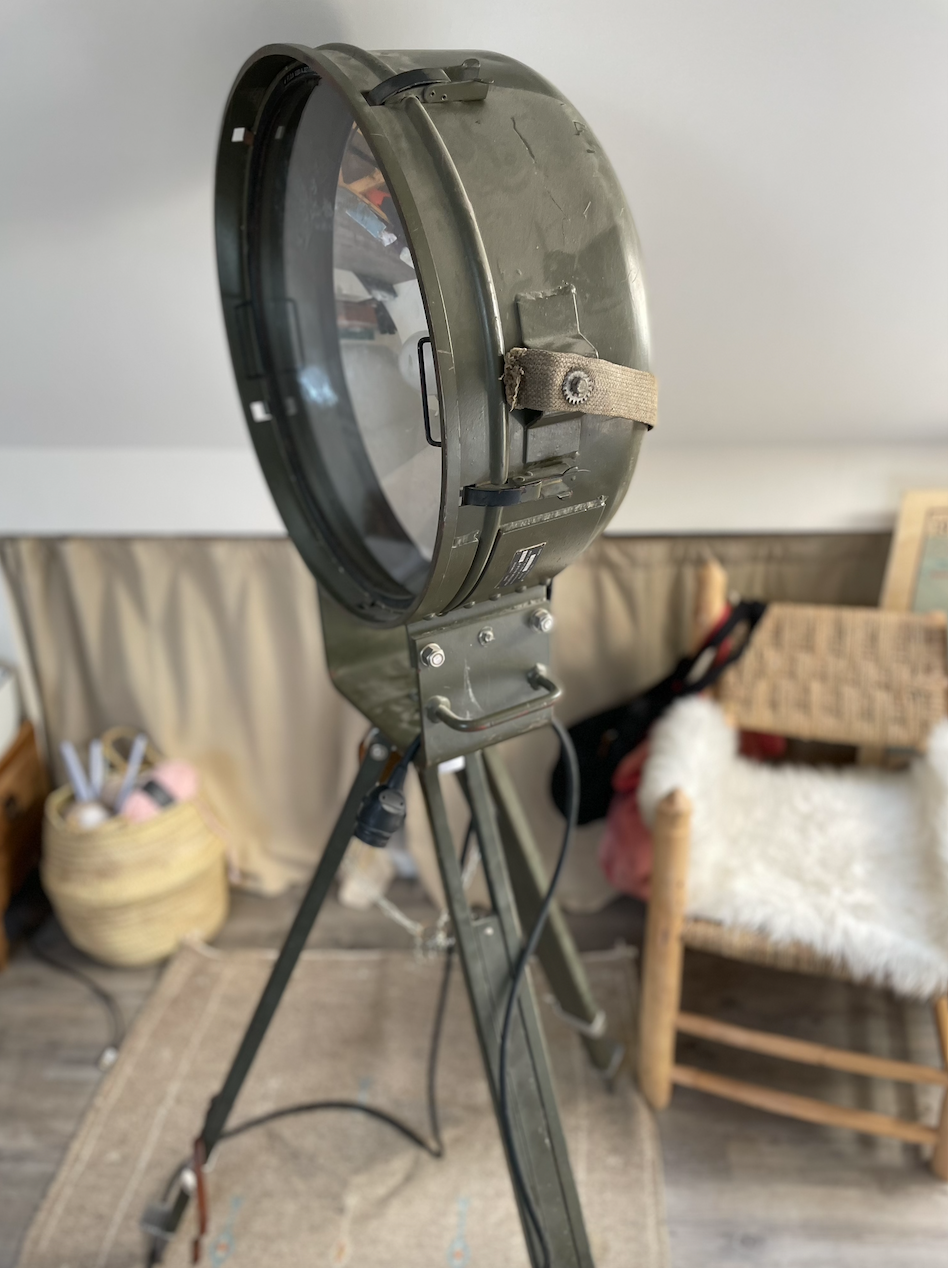

Searchlights were French, I believe. Look to be the same as on the M51 Shermans. US was using the Crouse-Hinds lights at the time, wider front to rear.
18 inch Crouse- Hinds

I guess it could be a PH-2-A model, also used on the AMX-13
More pics here : https://www.selency.fr/p/3UJ24ER2/projecteur-militaire-armee-francaise-style-industriel
