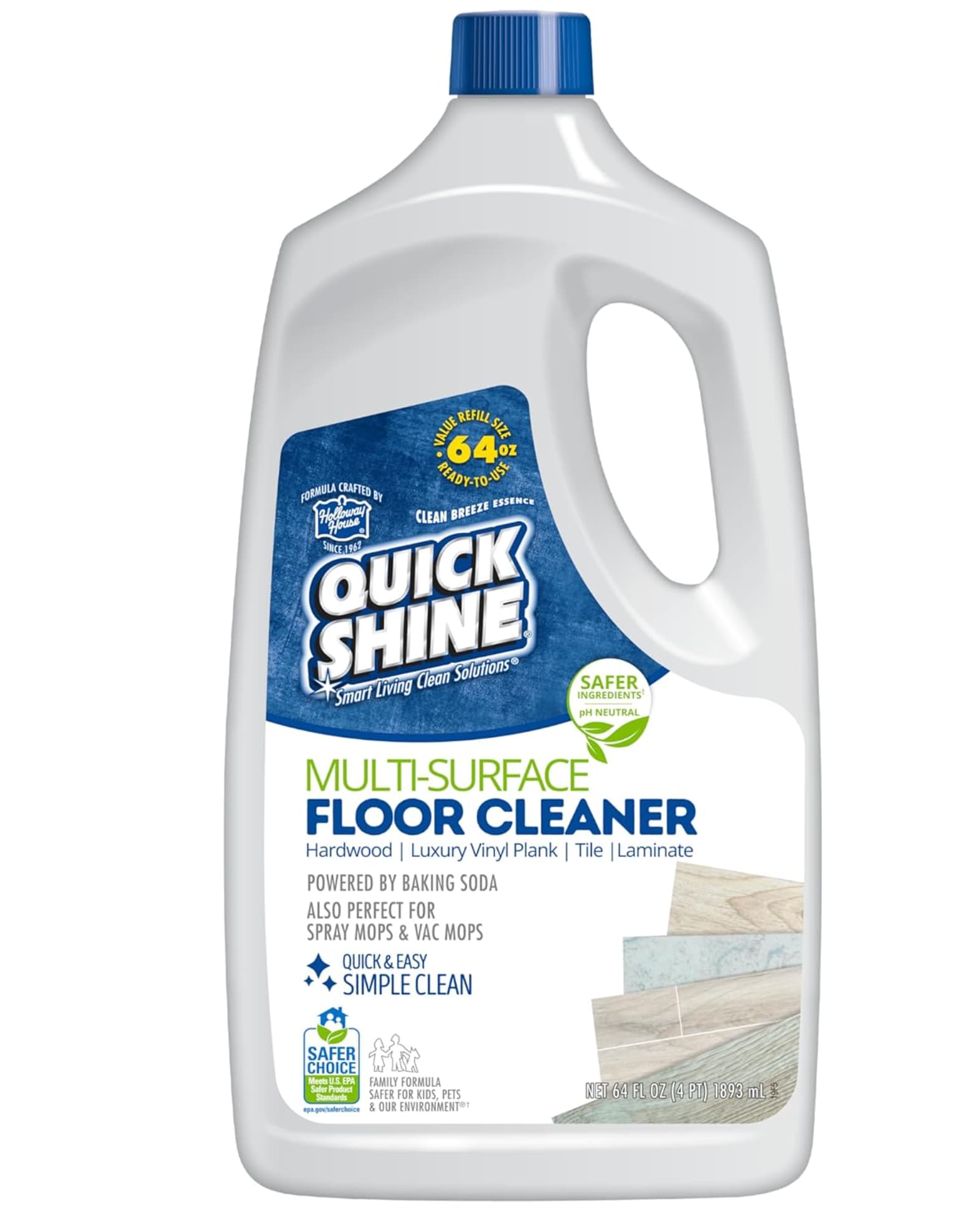

This stuff SSG?

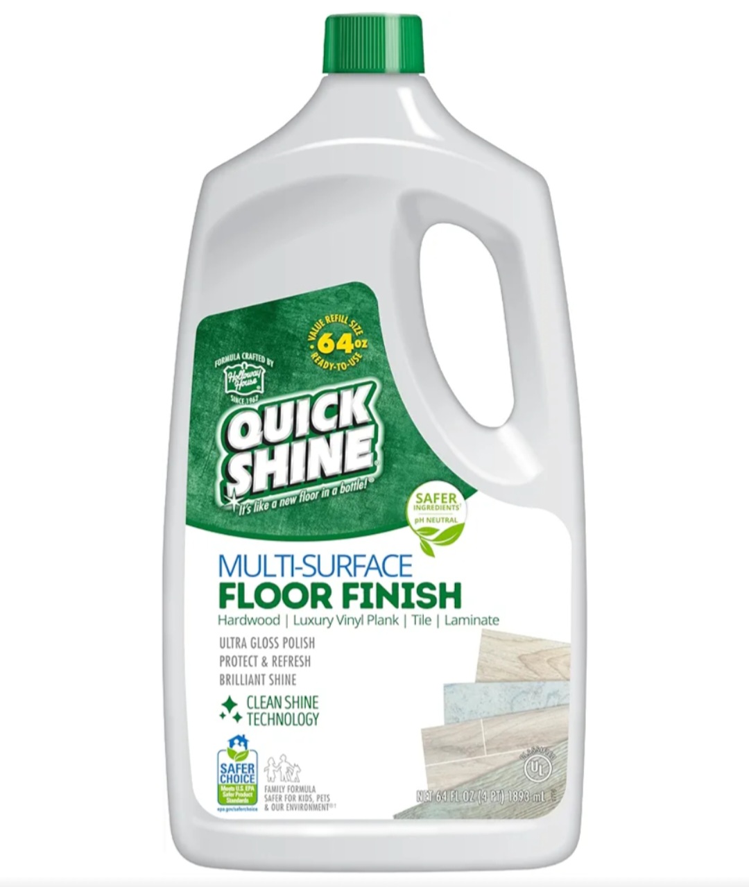

No, that’s floor CLEANER. You don’t want to use the cleaner. You’ll want the polish aka gloss.

So much here…You do not need a hi gloss surface to decal. a semi gloss will work. Now as to what’s next, there are many paths. Robin suggests working in a wet paint environment. I am sure he has his technique down pat and I have done that before but it gives me anxiety, sort of like which wire on the bomb do I cut?
The floor polish is forgiving and levels very well, that is the property Robin is counting on.
If airbrush less (darn it) get a 1/2 inch, high quality flat brush for acrylic paint. Use the floor polish and brush it thinly on your kit. cover panel to panel so no paint line will be seen in the middle of a surface. Me, I let dry over night. Decal as you normally would using micro sol/set as needed. Do not touch the decal if it crinkles. I will magically heal itself as it dries. the next day spray a matt/flat clear from a rattle can and all should be good. Some swear by Teaters dullcoat.
