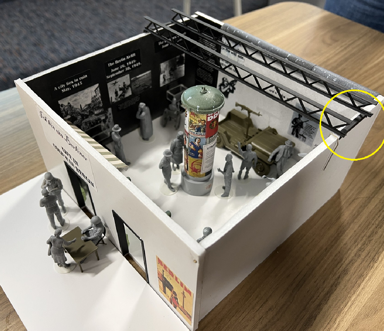

The circled portion below shows where Plactruct roof girders were cemented to Evergreen 1/4 inch channel with Tamiya extra thin liquid cement - it holds up very well. However, when using ABS plastic you’ll need the use a CA type glue.

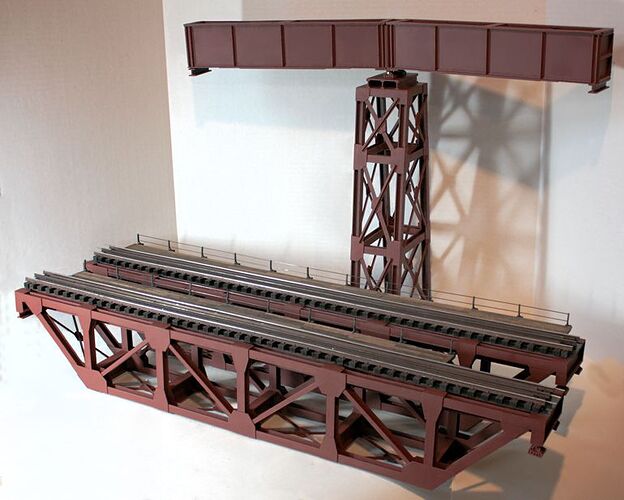

I’ve had pretty good luck, sticking with (haha) two primary glues - Testors liquid cement, which works on most kits, evergreen, and most plastruct (I know plastruct has one version that is maybe pvc? I don’t know, but for most of the other plastruct pieces it works fine), and Bob Smith odorless, Super-gold + medium CA, which will attach most things.
On the project below, 90% is assembled with these two, and the other being Elmers wood glue or Titebond, which both work well for big pieces of wood or other big chunky parts that aren’t plastic.

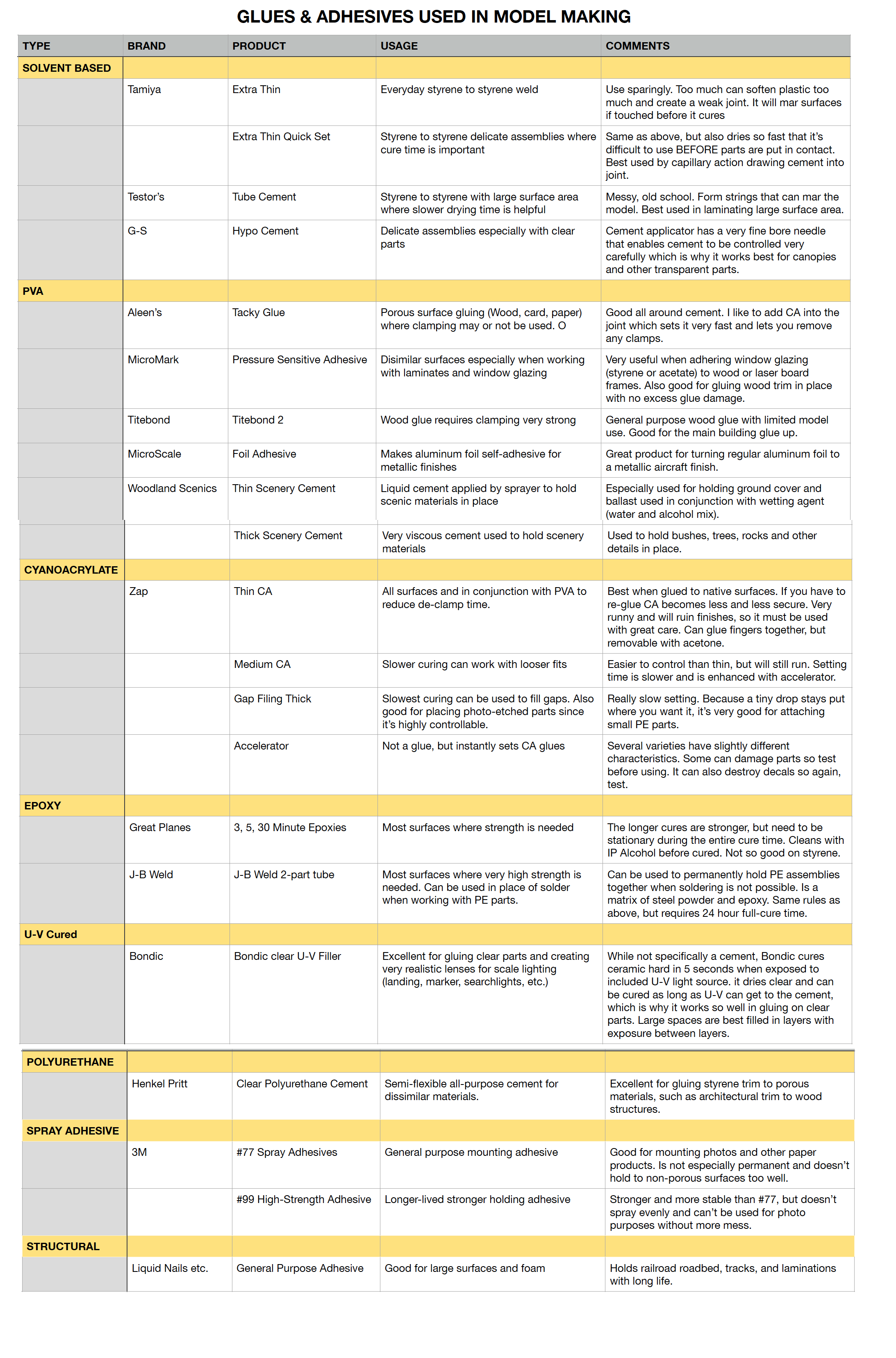

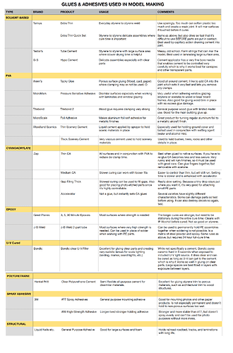

I put together this adhesive chart for model makers for my local modeling club. It lays out what works on what. ABS does react to solvent cements, but you need to find the right one. Plastruct sells a liquid cement that can work. These were built out of kitbashed Plastruct kits using solvent cement. They’ve been supporting heavy traffic for 12 years. Tamiya airbrush cleaner is the same material that is their liquid cement and much less expensive. You can mix acetone and MEK and get a pretty agressive liquid cement.
Here’s the chart.
