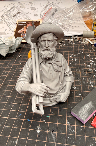

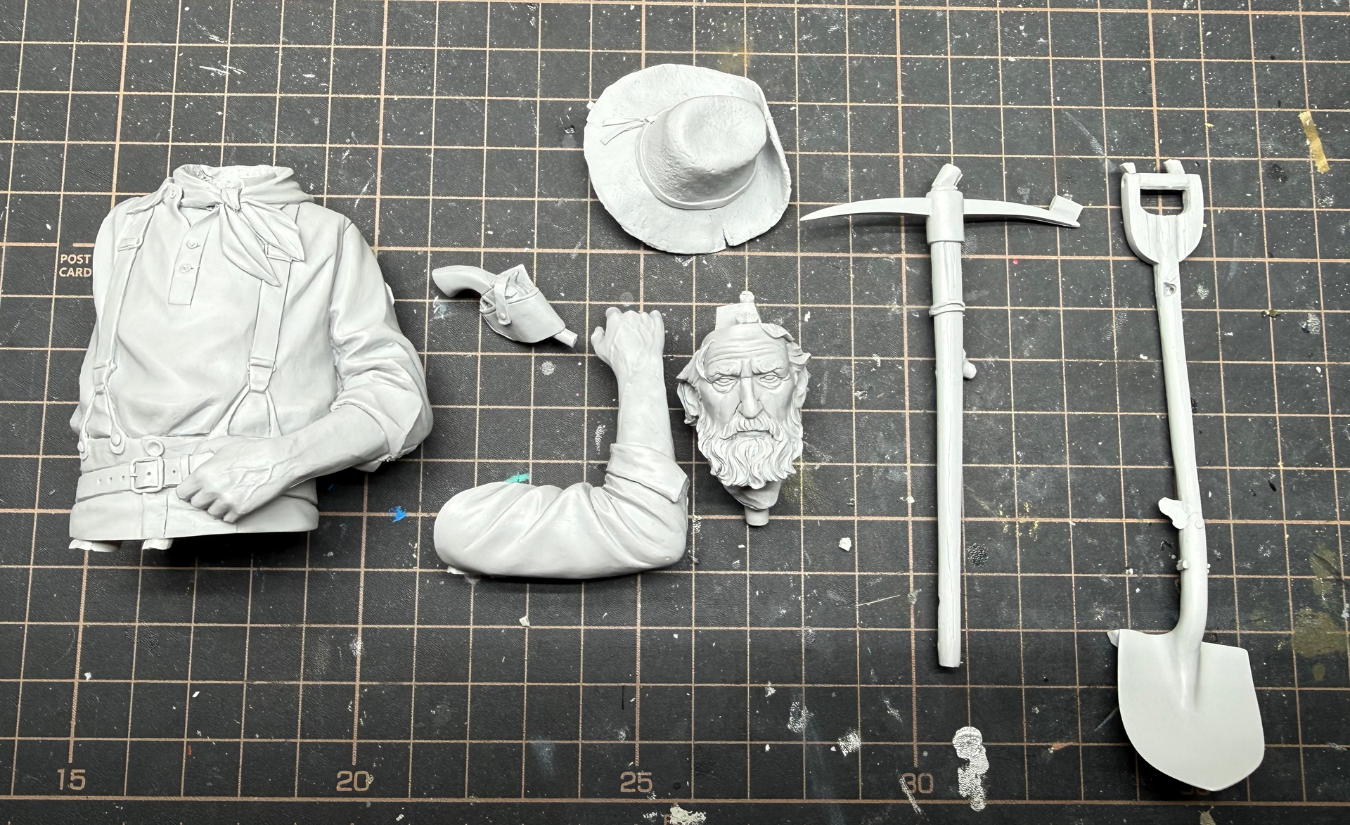

I have started to get a new bust ready to paint. It is a wonderfully characterful piece from Legion Miniatures.
Here are all the parts cleaned up with the mould plugs removed. They were small plugs and only a few seam lines here and there needed to be attended to. The spade handle, the head of the spade and the pick handle were a bit warped. Immersing them in some boiled water soon had them coaxed back into shape.

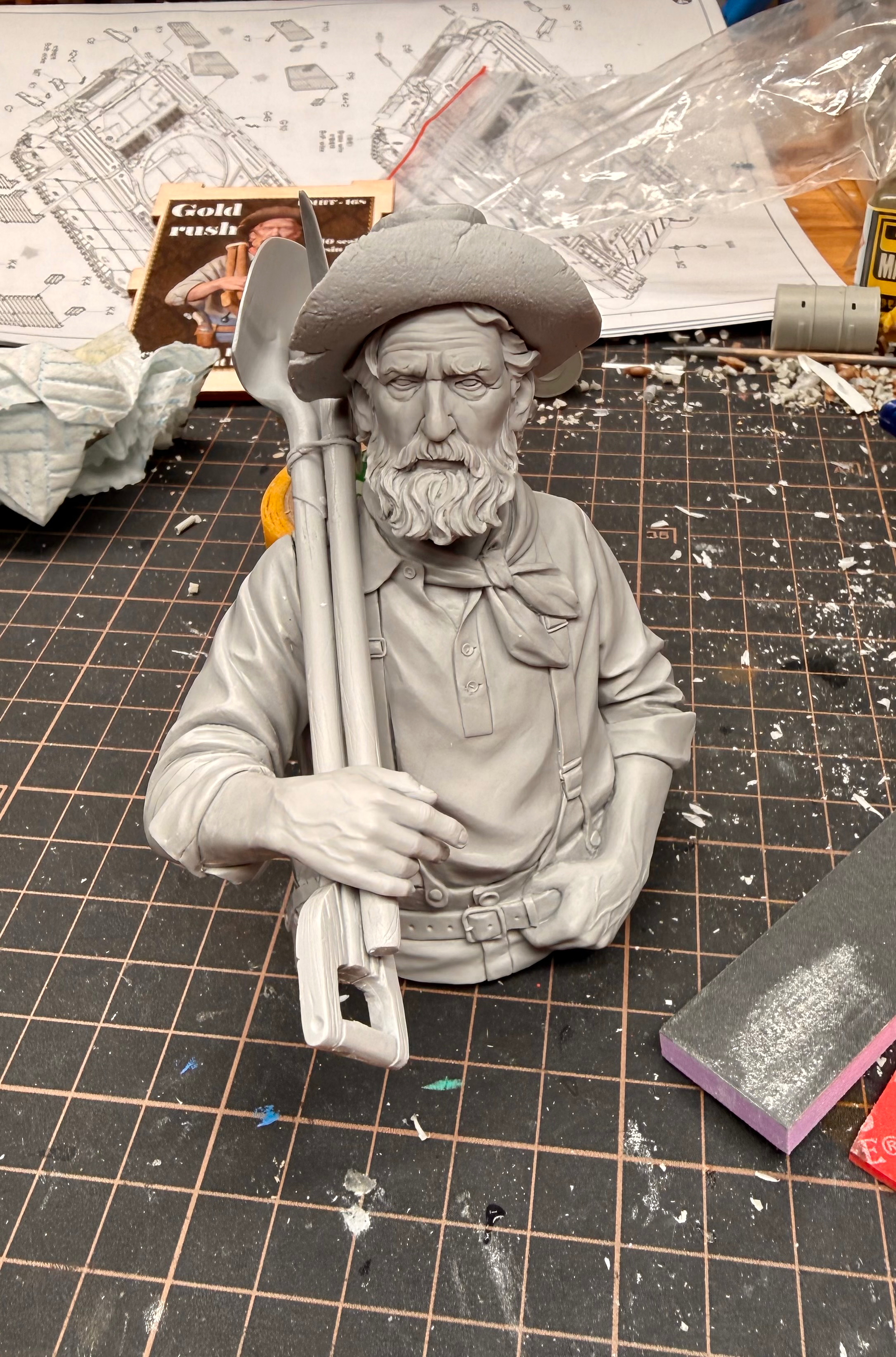

The test fit went grand and I must say the parts fit is top notch. Next up is mounting the pieces for painting and getting some primer on.
Thanks for reading.

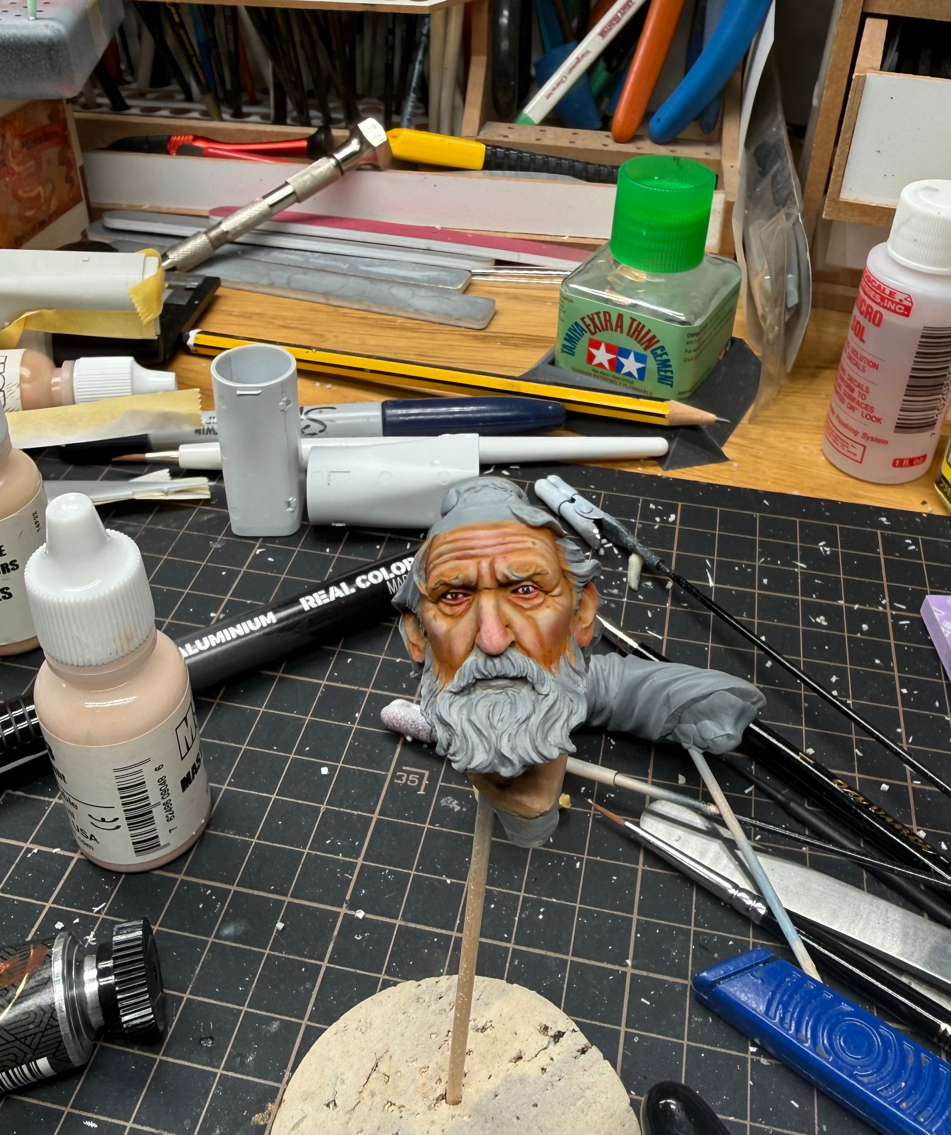

In painting busts the first thing I tackle is the skin and eyes.

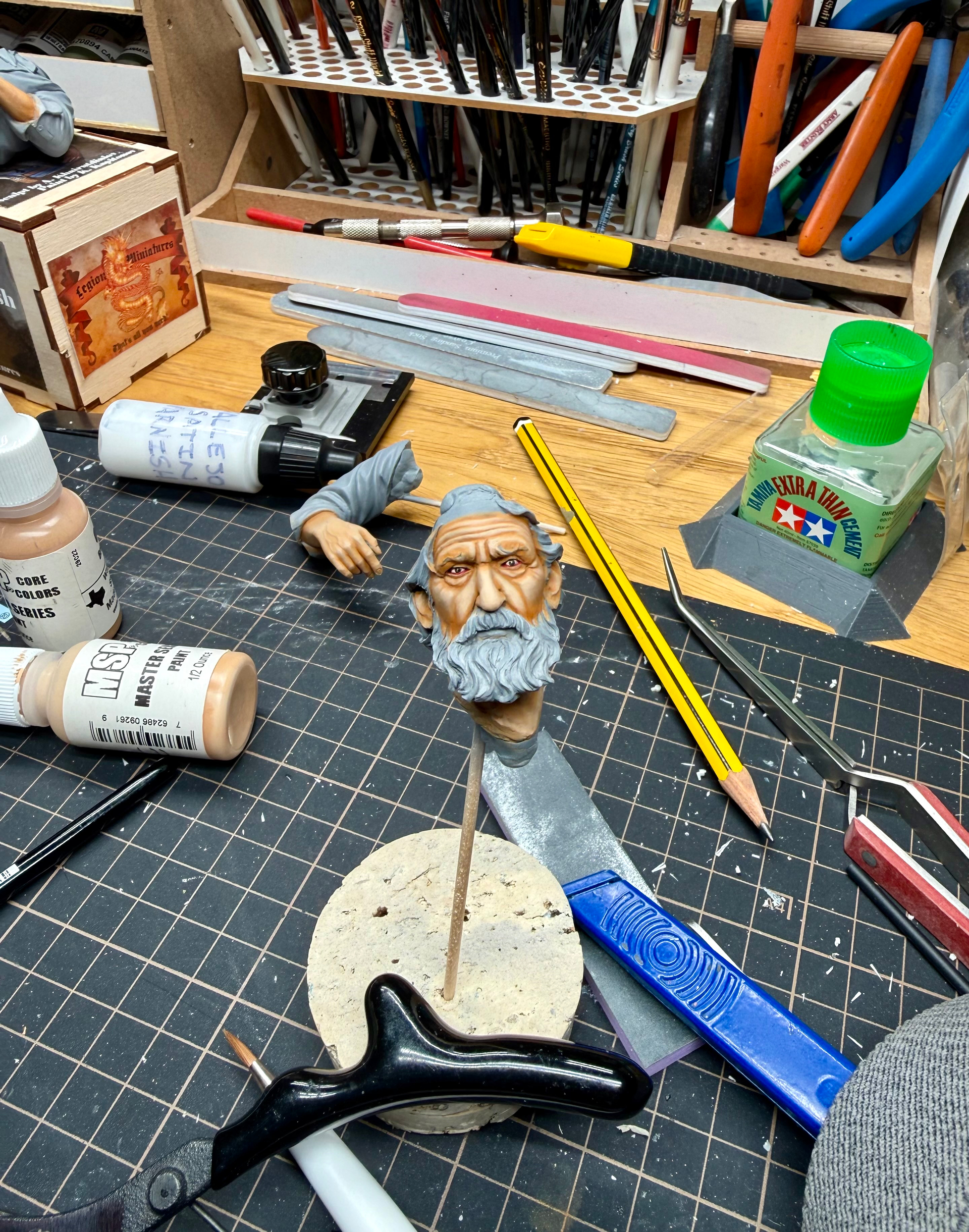

Below you can see the eyes are done and the base flesh paint is on.
I’m using Reaper Miniatures paints, their Bronzed Skin trio set for this. I’ve used quite a few different brands of flesh paint over the years and these are the best I’ve come across- the fact they come in these sets of three (and there are others for lighter skin tones) makes everything just that bit easier to do.

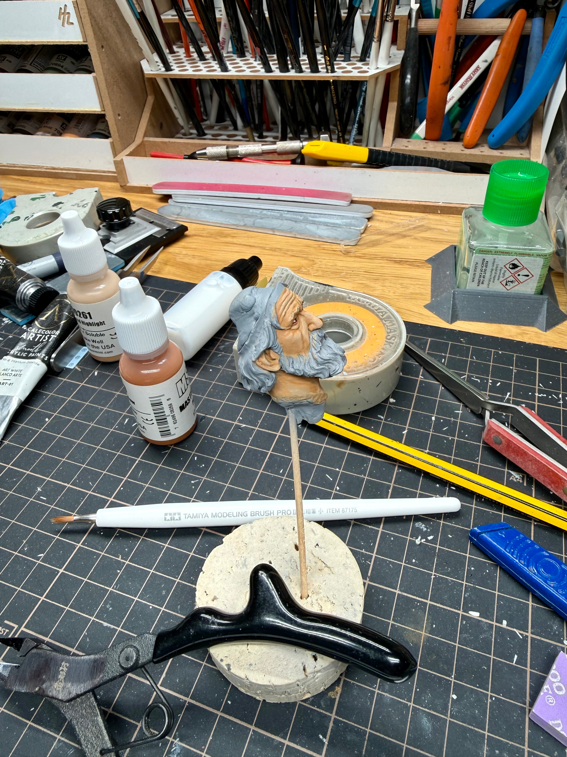

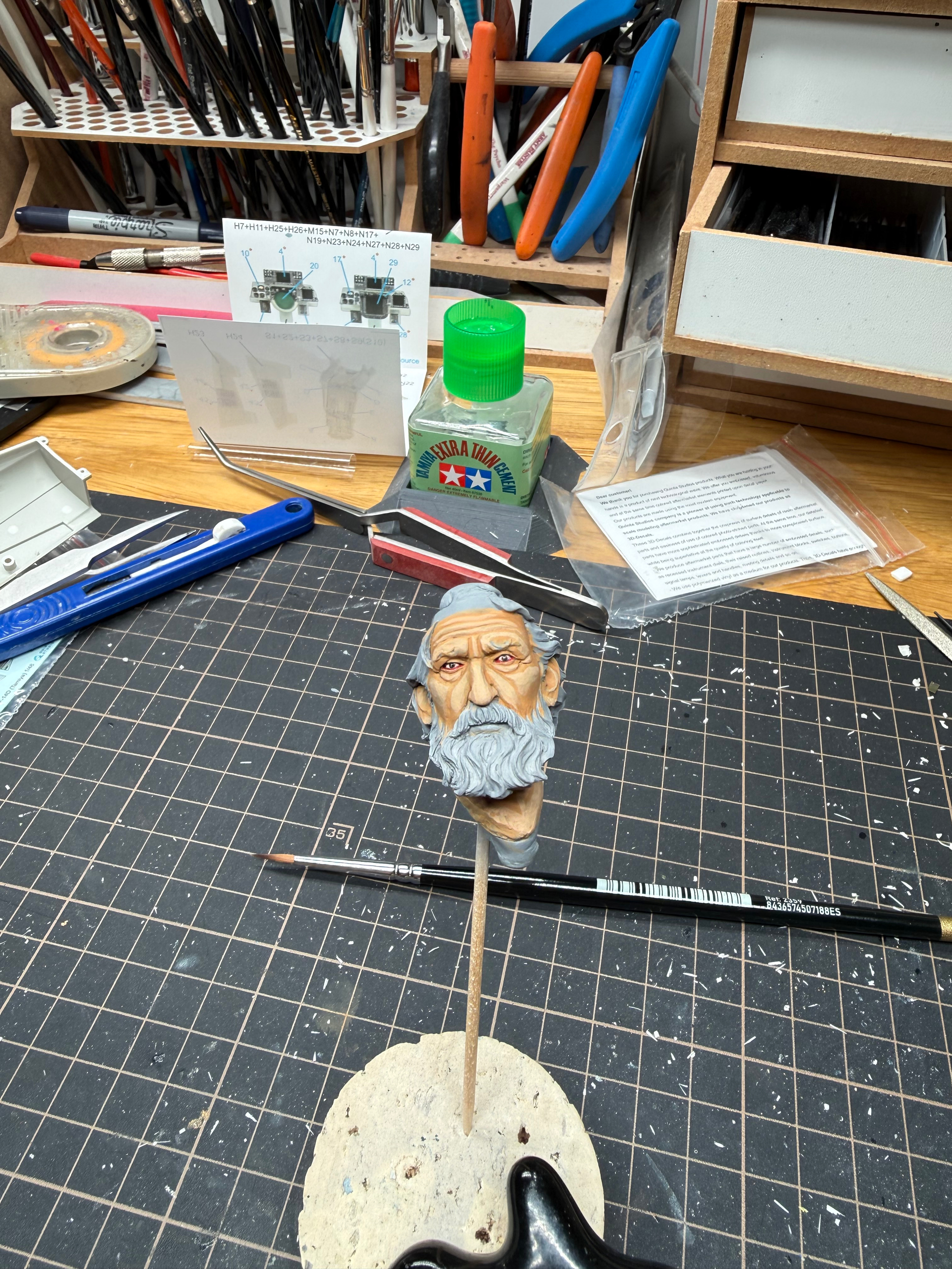

Below you can see the 1st highlight and 1st shadow colors have been added to the skin. For this I thinned the relevant paints 50/50 with the base color.
Below you can see the difference between the unblended side of the face (on the left side of the photo) versus the blended side. Still, this is very far from finished- much more work to do!
Thanks for reading!

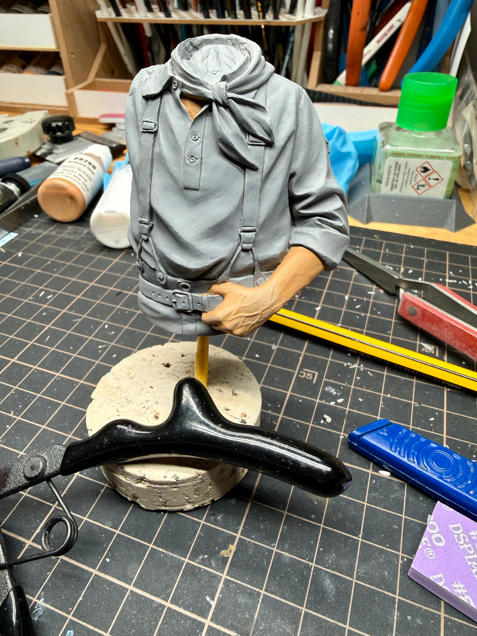

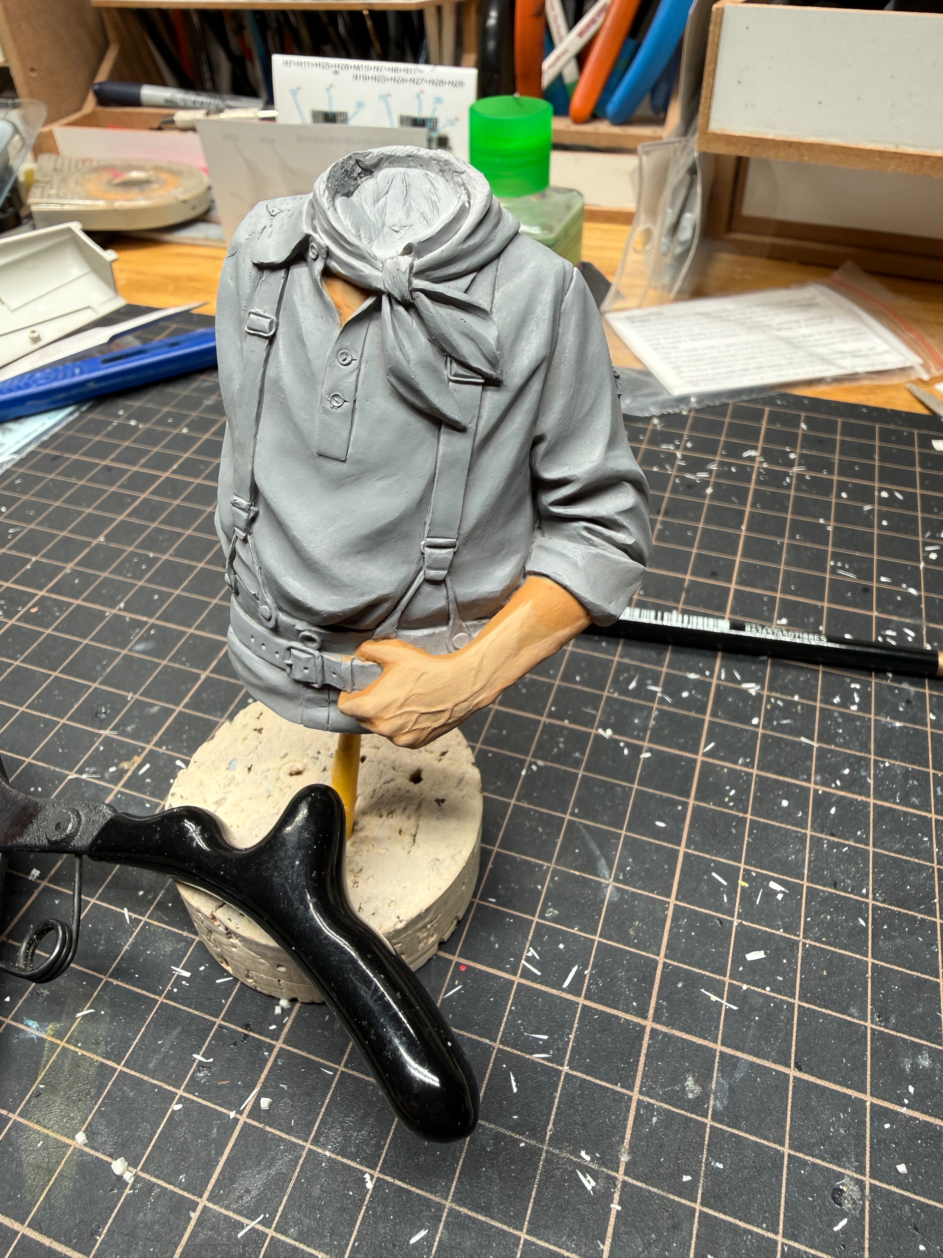

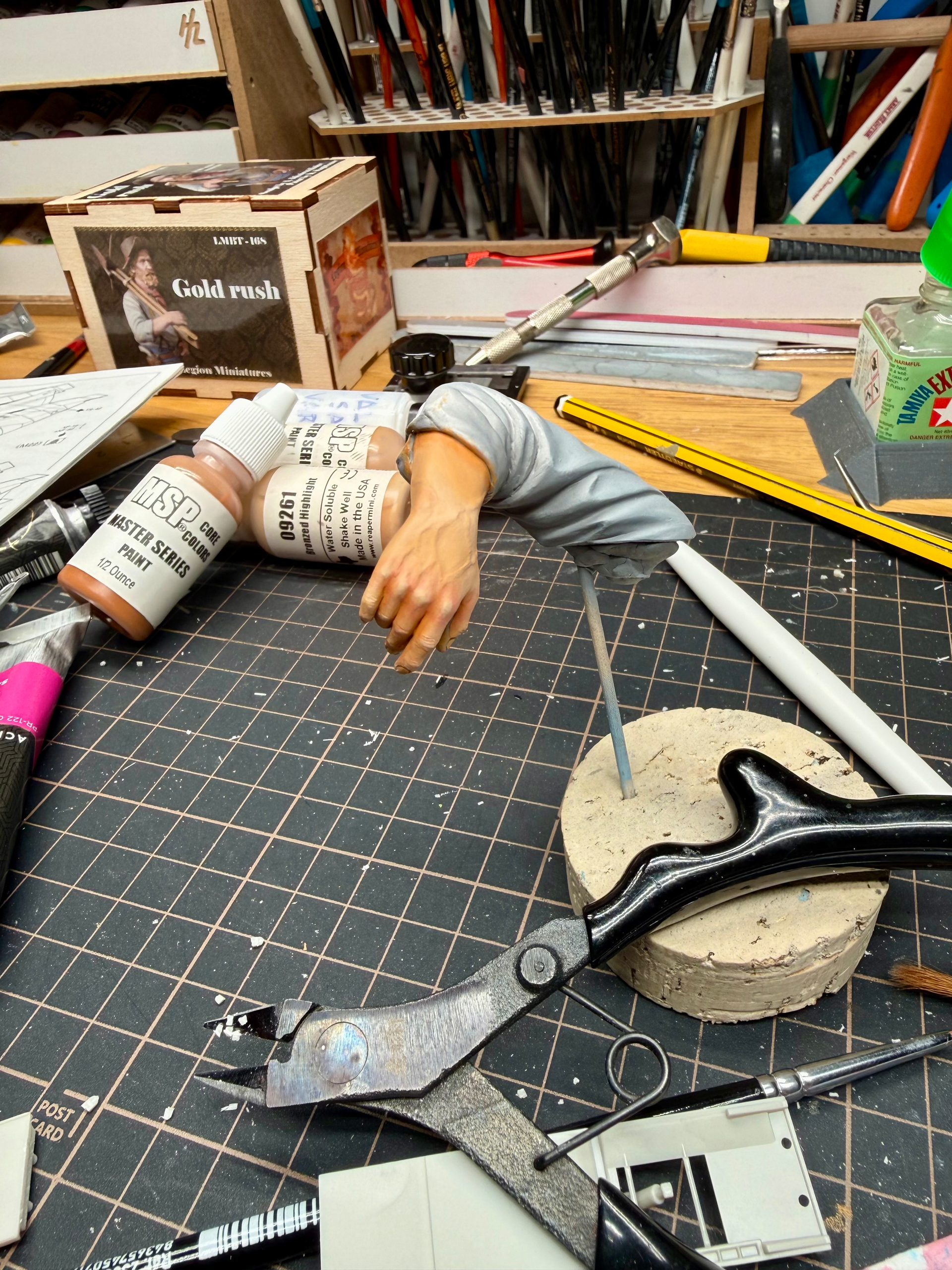

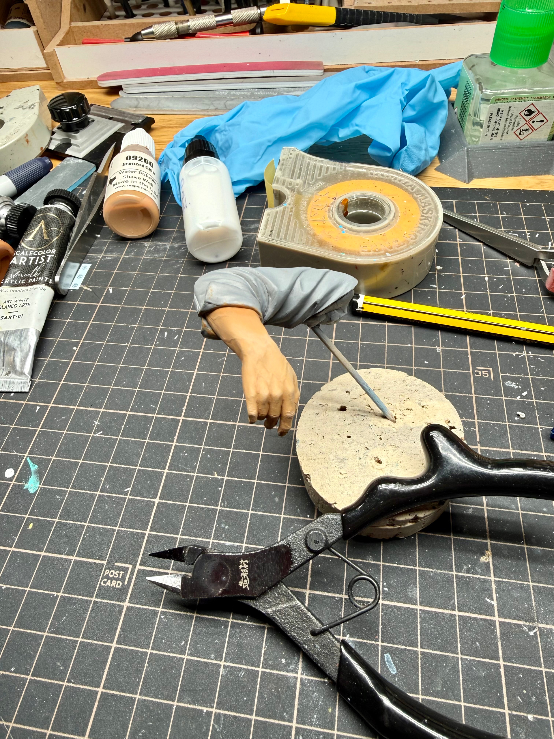

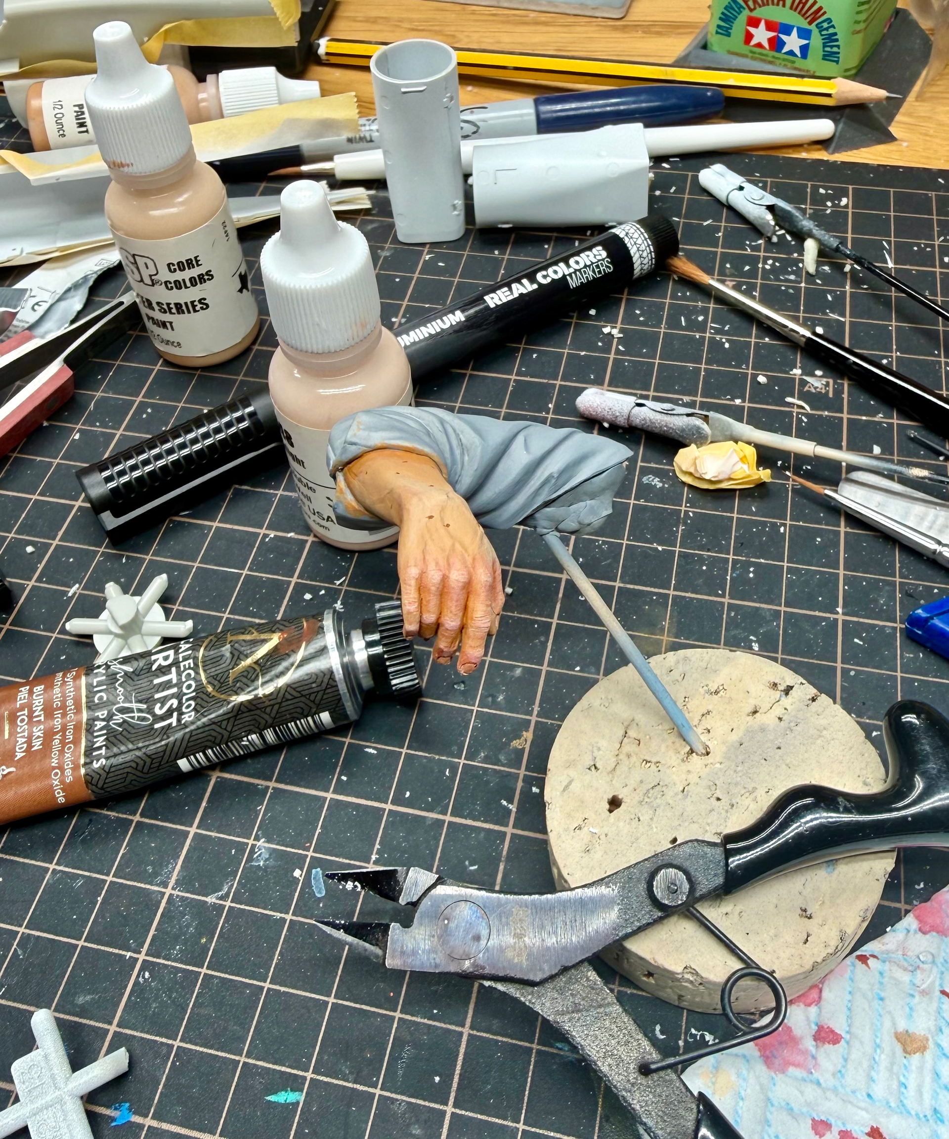

After smoothing out the transitions in the face I moved on to the arms.
At this stage I take stock of the progress- often when smoothing the transitions between the 1st highlight and shadow you will shrink those areas of light and shade in order to smooth the skin. This is beneficial if you are seeking quite youthful, smooth and unblemished skin. For older skin (or for more contrast) you might need to go back and re-apply some of those shadows or highlights. For this I work cautiously and slowly via glazes of my 1st highlight and 1st shadow colors. I mostly kept the highlights drawn up toward the high points of the face where I felt some contrast was lost. For the shadows I didn’t do too much but I did start to add in the beginnings of wrinkles- most notably on the lower neck and around the sides of the eyes.
Right now I’m doing a similar job as I’ve just described on the hands and arms. I’ve also begun the second highlight color on the face- once again applied quite sparingly with a glaze.

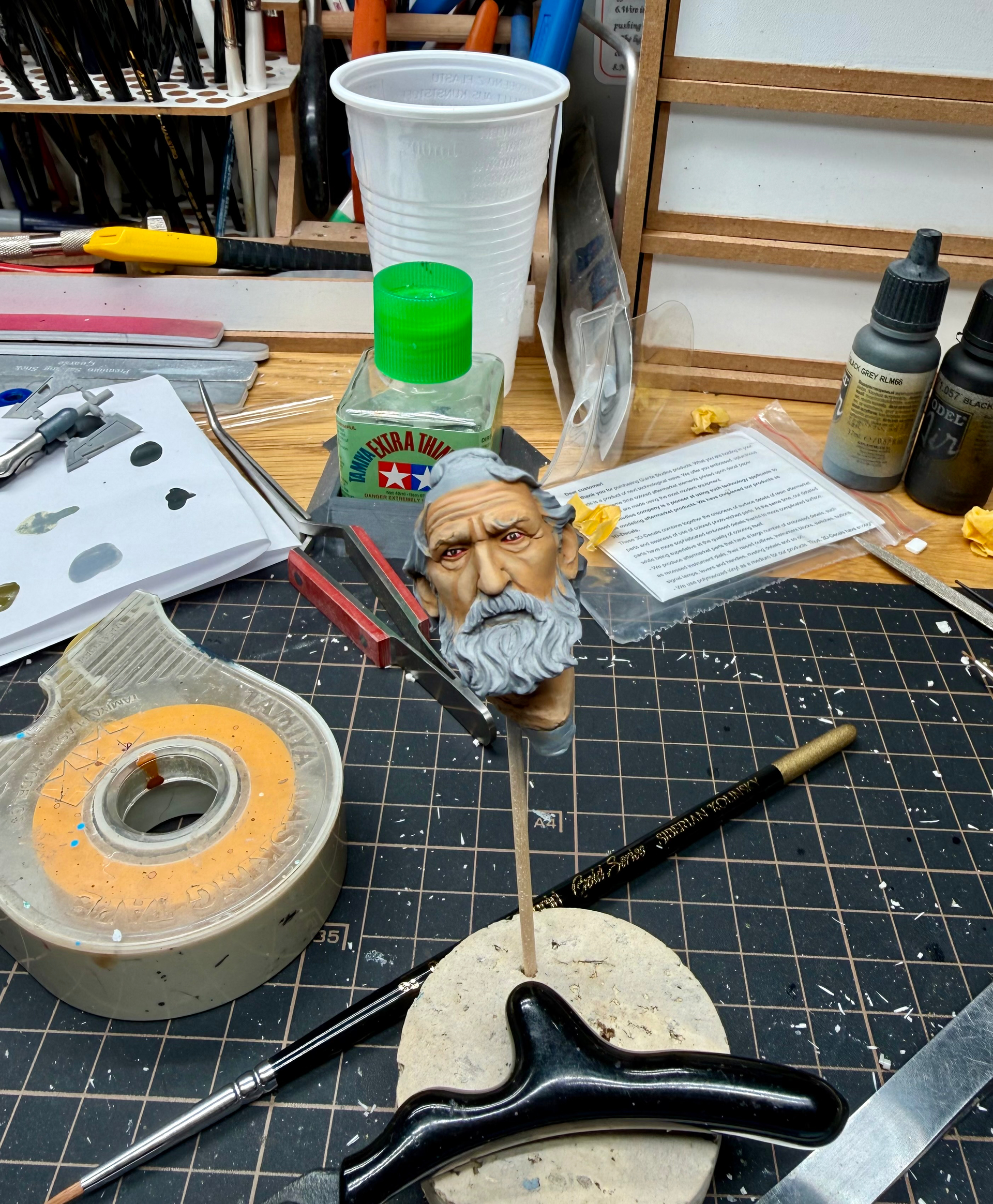

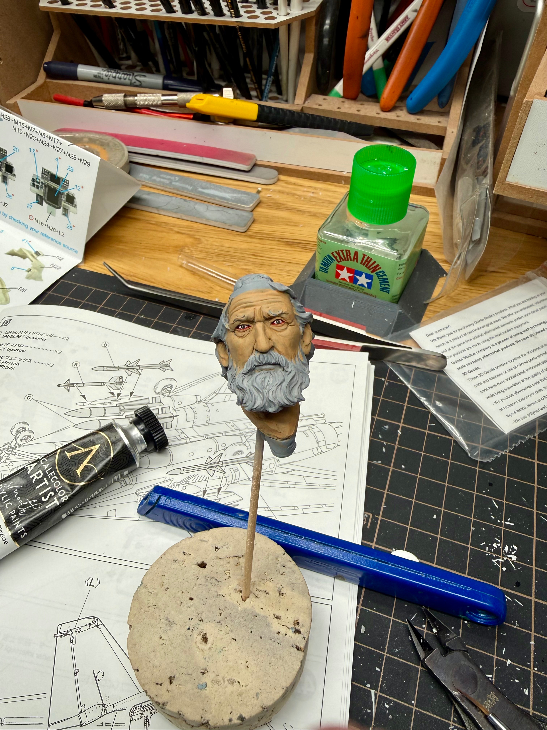

So here we have a bit more progress.

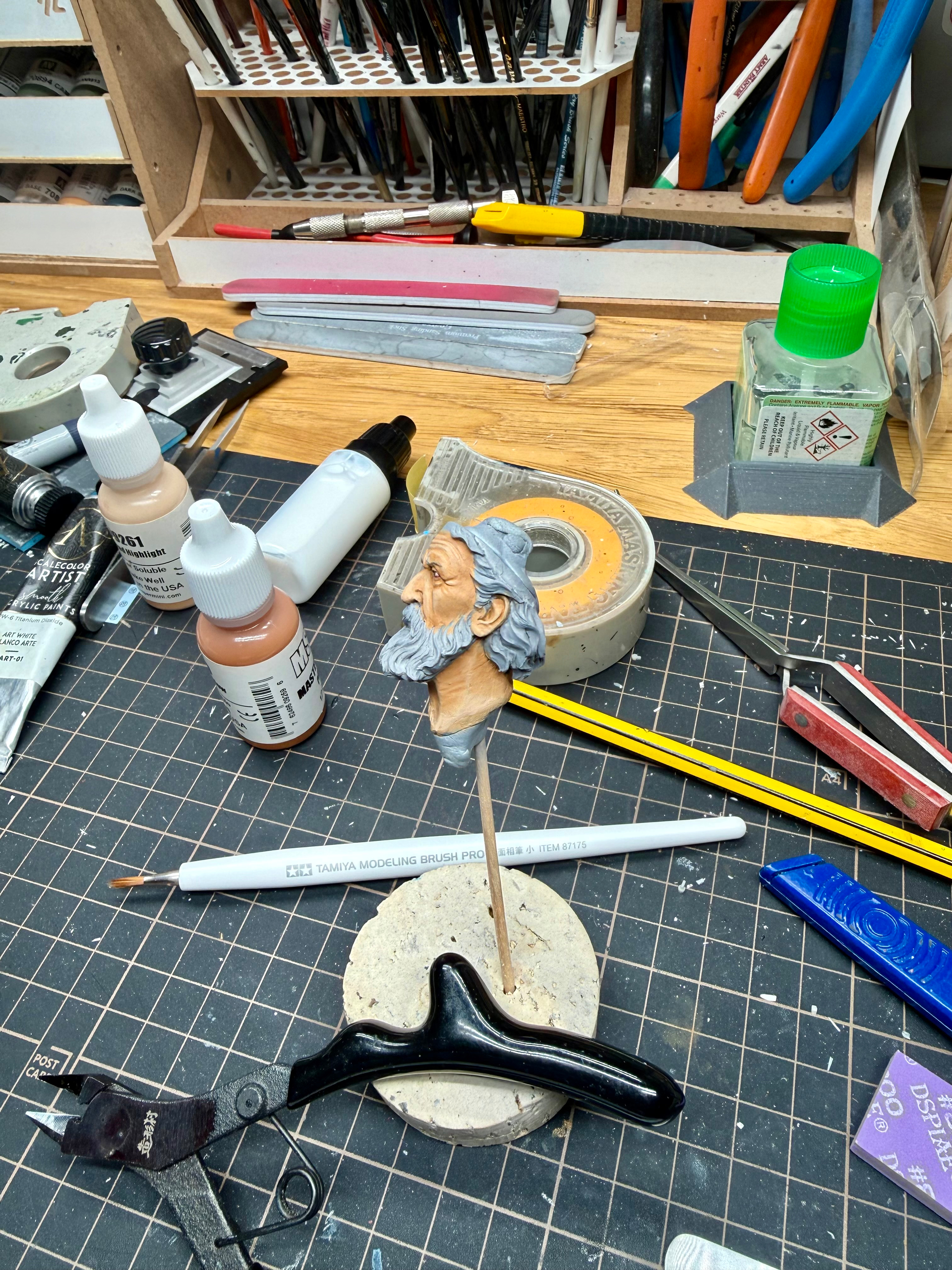

Below you can see how I have deepened the shadows on the left side of his face (on the right of the picture) versus the as yet to be worked on opposite side of the face.
Now you can see both sides have been worked- with some added highlights here and there.
It was then time to add in the areas of high blood flow on the face- which appear more pink or red- typically the cheeks, forehead, parts of the ear and nose. I have also concentrated a little more red around the eyebags to suggest fatigue and around the nose to suggest both sun damage and heavy alcohol use.
I also used the same red color on the hands- mostly around the knuckles and fingers.
I decided to add some moles/age spots to both the arms, hands and face.
In addition to adding the skin blemishes I tried to impart weathered and damaged skin around the knuckles and fingers- Gold prospecting would have been a very hands-on job and would not have been gentle on the skin! I can’t say I’m entirely happy with the effect though.
At this point the skin on the face is more or less finished- the lips and hair will be next. On the arms/hands I have to do the veins and nails before then tackling the arm hair.

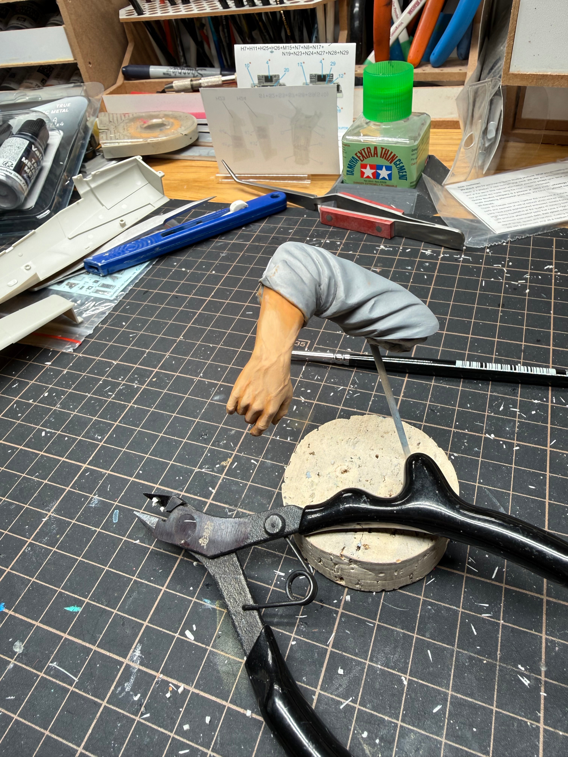

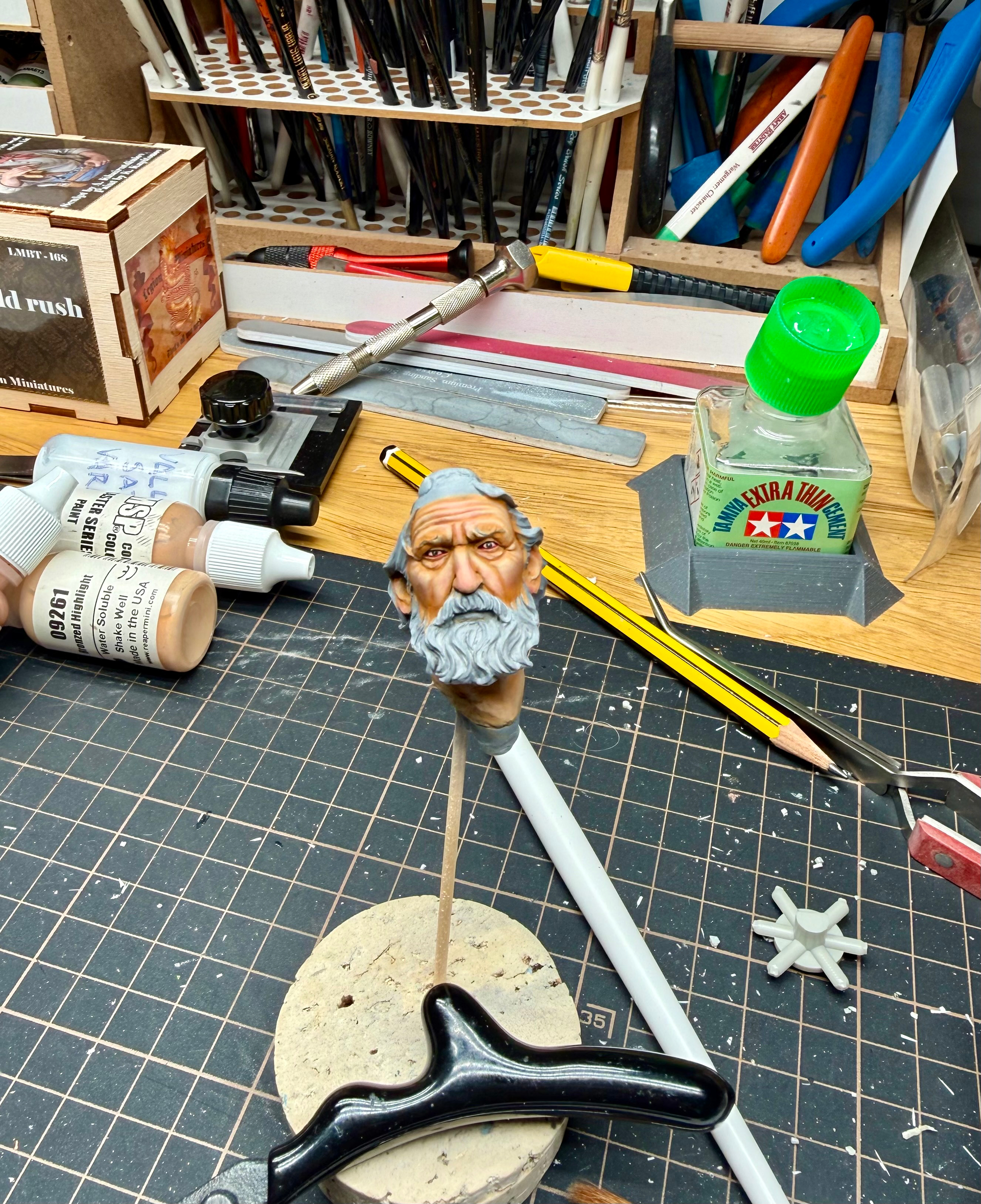

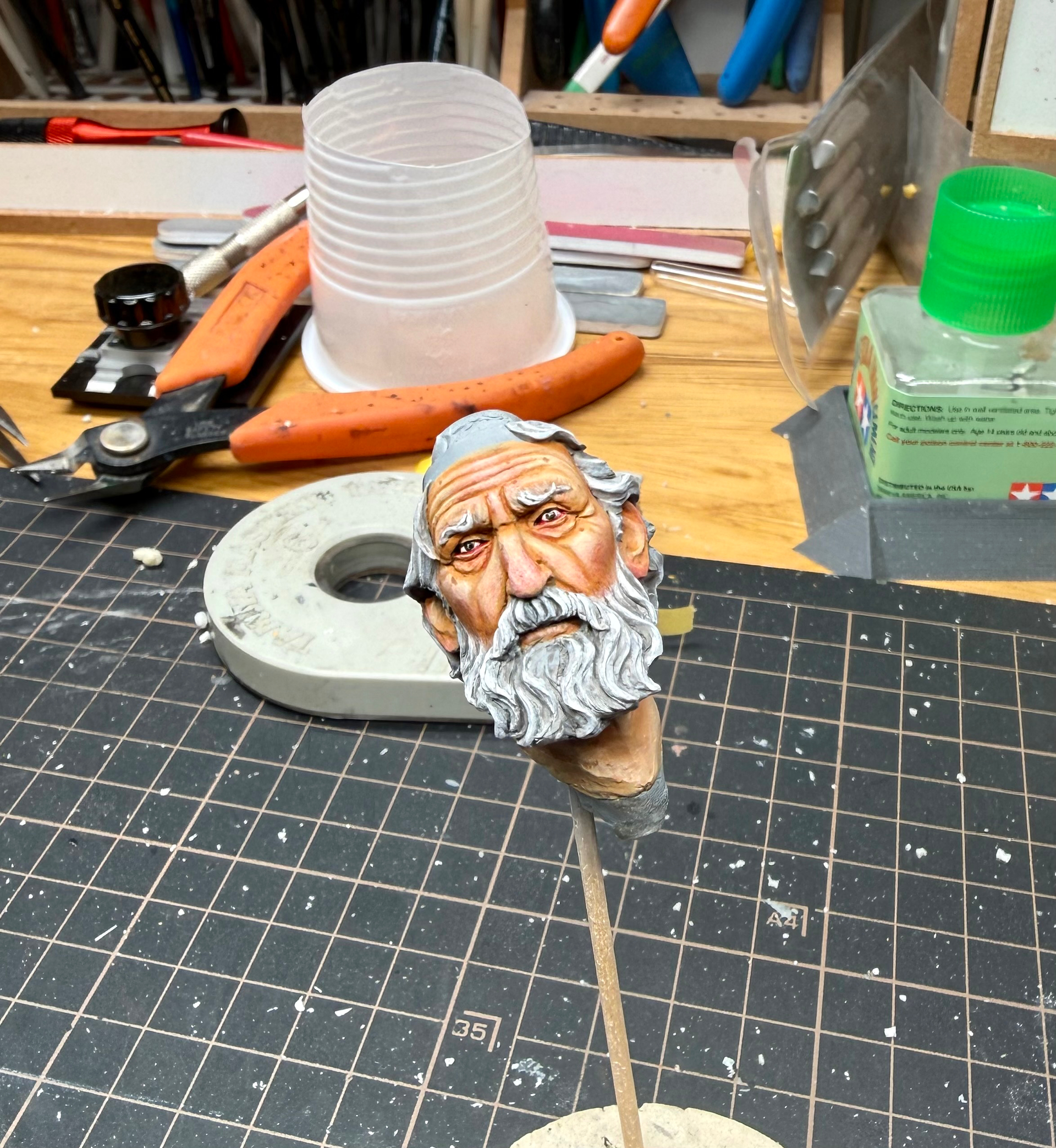

The face is finally done with the completion of the hair and beard.

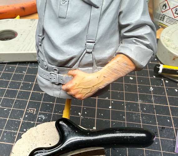

I also had the veins, nails and hair to do on both of the arms.
I’m not very happy with the way the arm hair turned out. It didn’t get off to a great start- I wanted the growth direction to be the same on both arms but messed up on the first stage- the growth on one arm was going opposite to the other! Luckily the paint was very light at that stage so easily corrected. I think my paint strokes are too long and a bit too uniform- I reckon I will have to get a bust with bare arms to practice this technique on. But for this bust that is the flesh and hair all done.

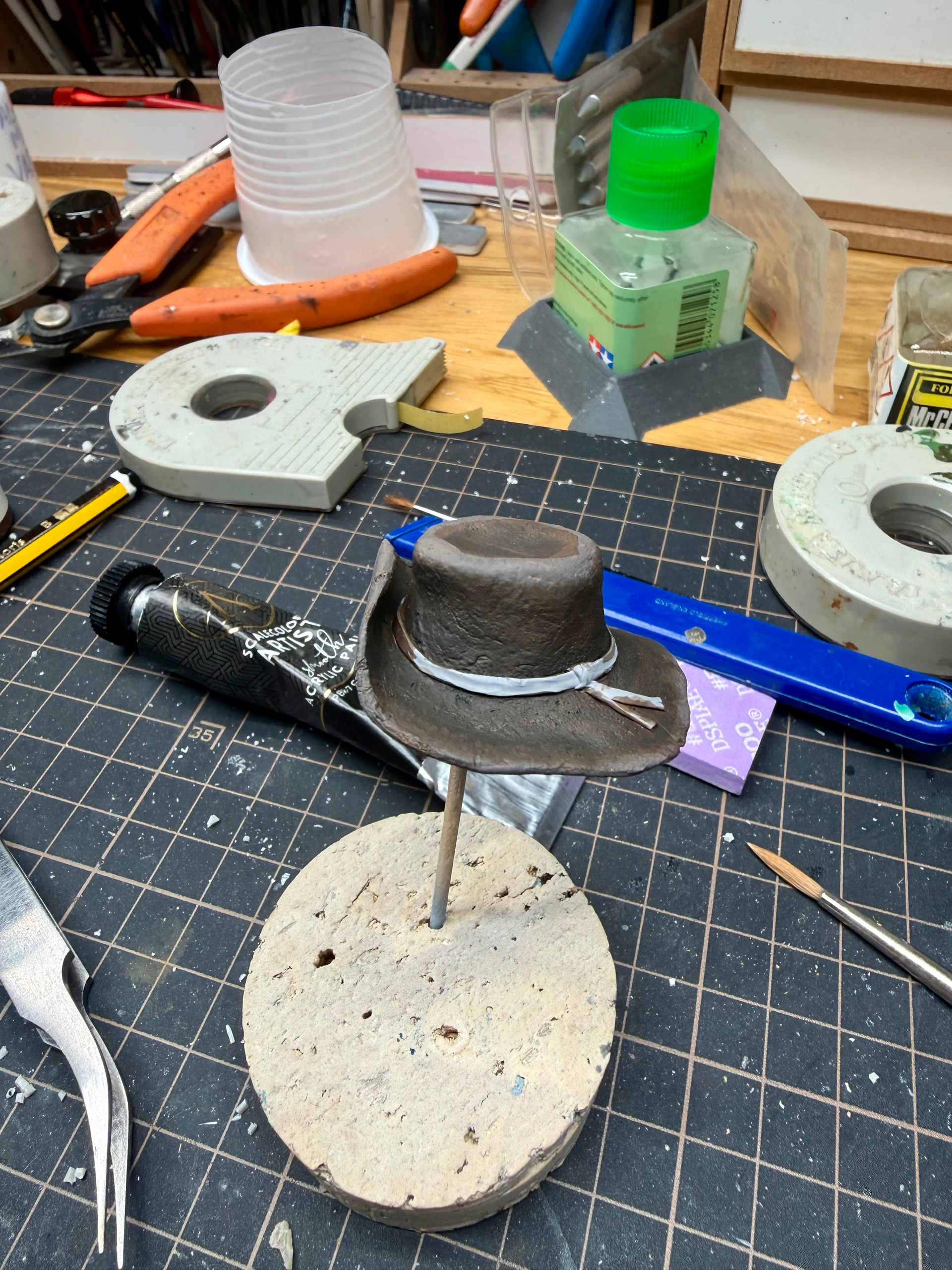

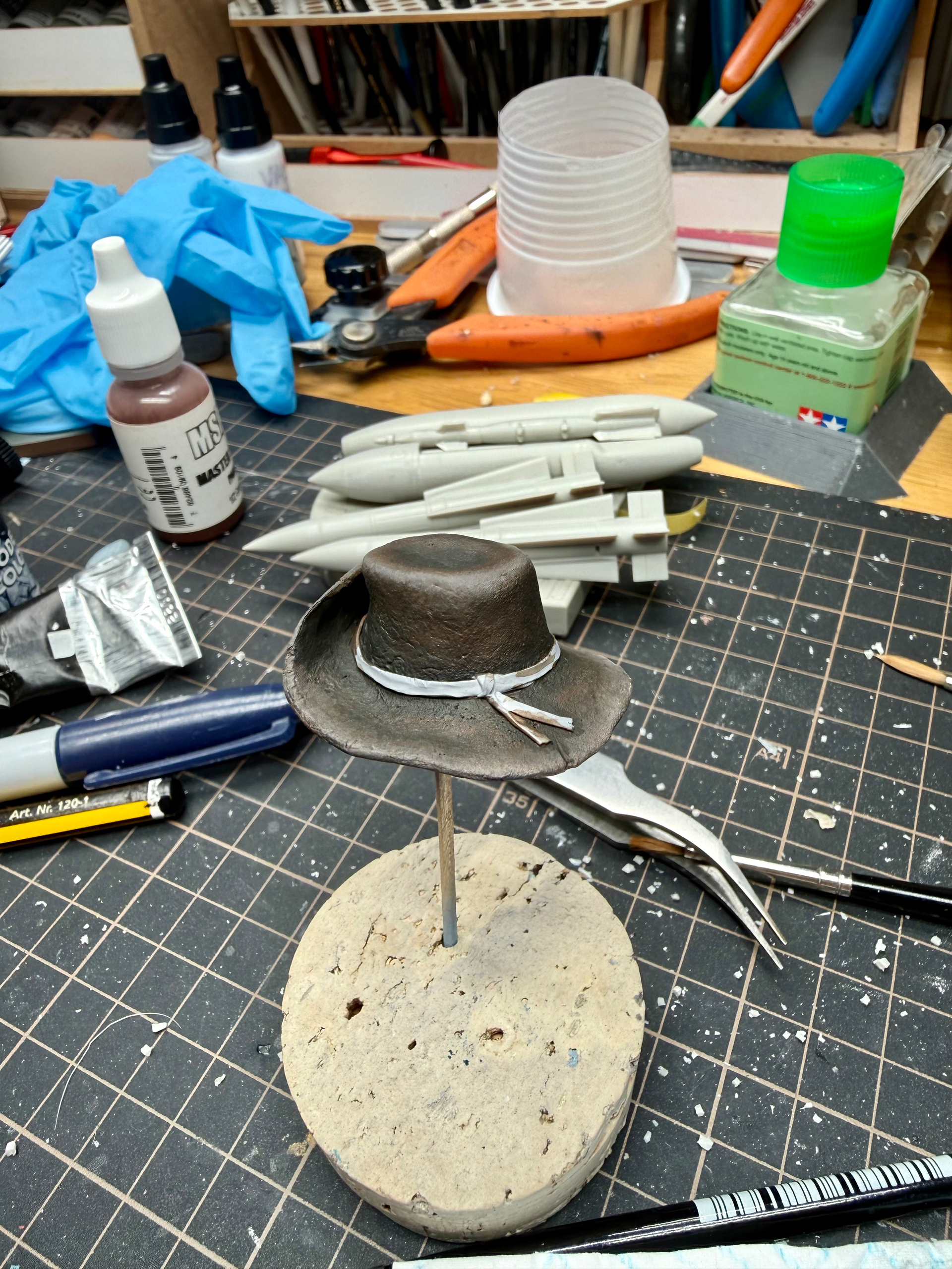

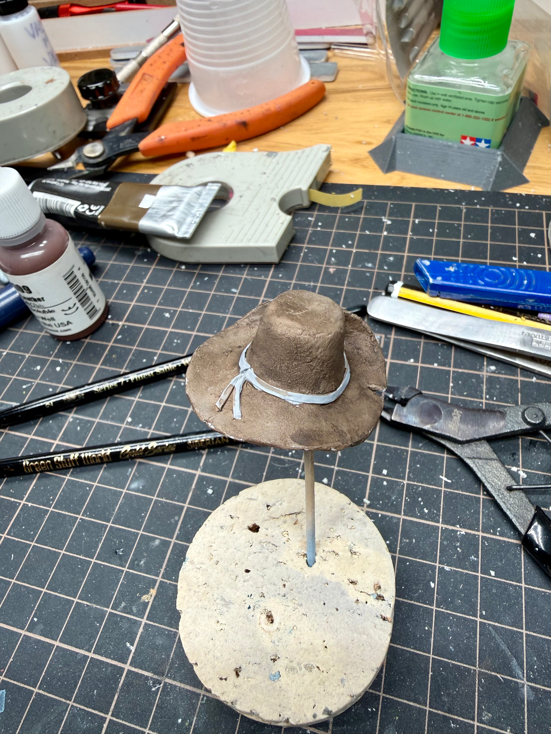

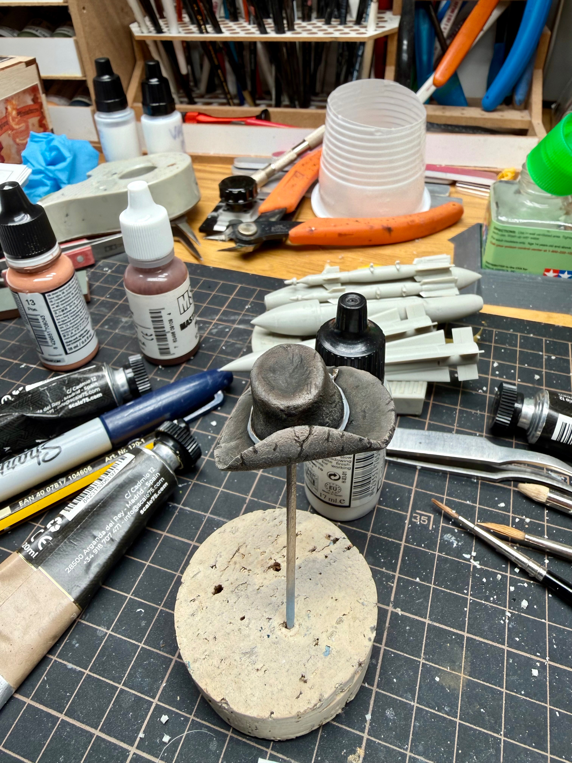

As I added the first coat of brown to the hat, the beautiful moulded texture started to reveal itself.
I find it very enjoyable to paint things with interesting textures.
Here we have both the first highlight and first shadow colors on.
And here is the same area after blending the transitions with a glaze of the base color. The top and the other side have yet to be blended.
Once all the blending was done it was time to add both a 2nd shadow and 2nd highlight.
Usually that would be just about enough for many painted parts but the texture on the hat meant a bit more work was required to really bring out the dried out, damaged and worn look.
First thing I did was use a dryrbushing brush and a light brown color to pick out the high points in the texture, being careful not to obliterate the paintwork already done.
Then it was time to use a very dark brown color, mixed with Vallejo Glaze Medium, to pick out the various tears, splits, dents and scratches and also to darken the area around the hat ribbon.
Lastly I gave it a coat of matt varnish to complete that dusty, dried out look.

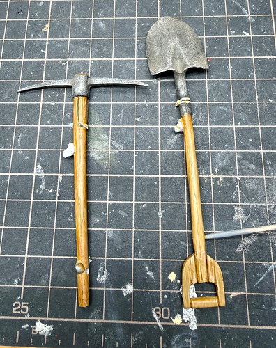

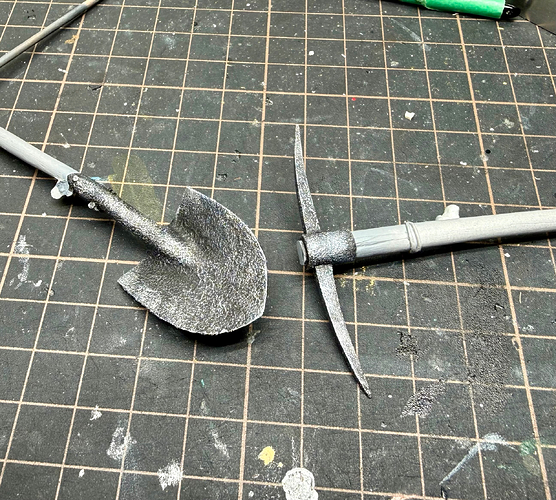

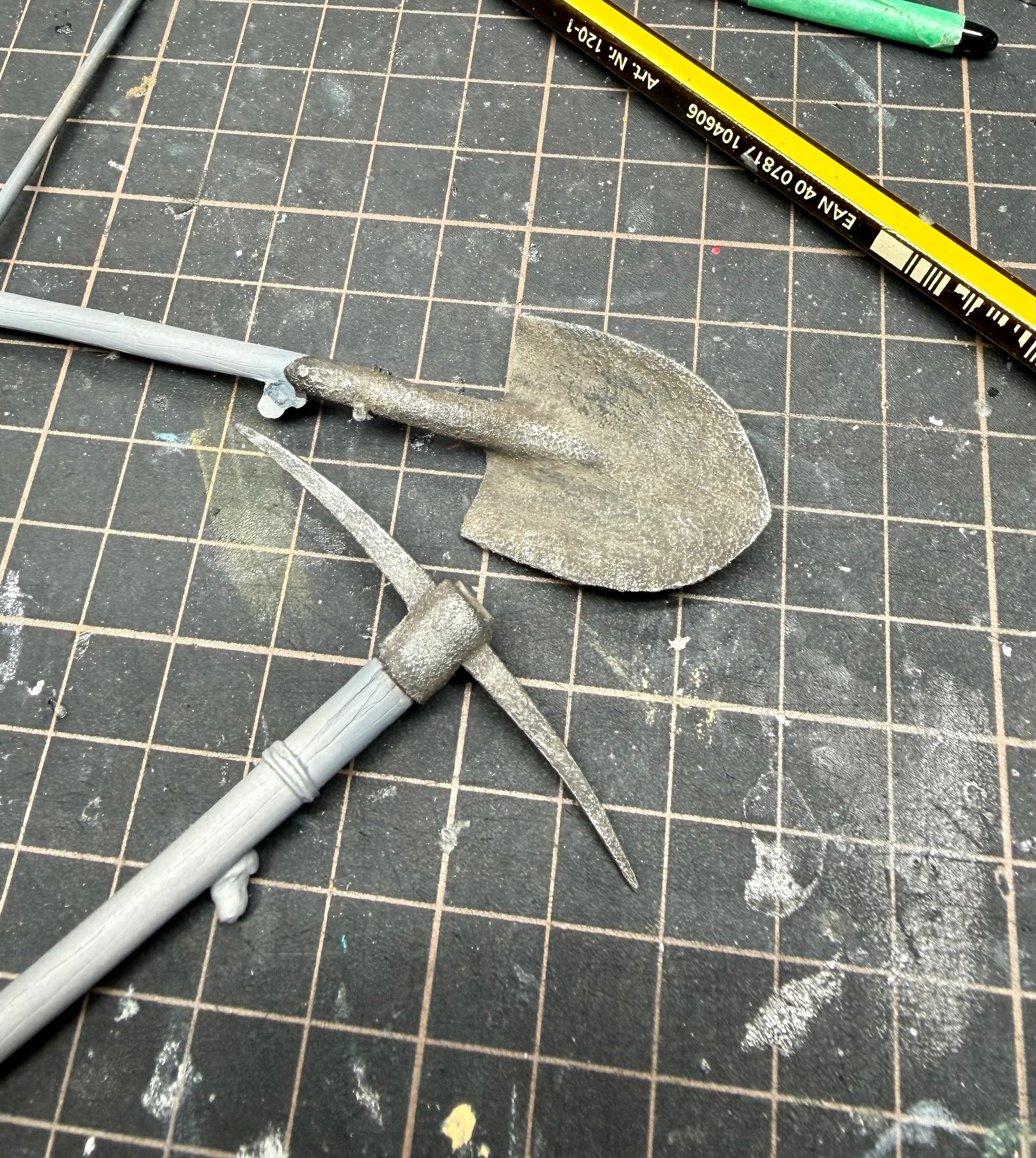

For the tools in the kit I went ahead and painted them but as I did so I noticed they looked a bit flat and nothing I did with either paint or pigments changed that. Instead of looking like heavy, cast iron tools from the 1850s they looked like cheap mass produced tools from a discount gardening store. So as I stripped the paint off I was wondering what could I do to make them look more realistic- I thought a bit of texture might help- perhaps better portraying the rough casting techniques of the period.
The anti-slip was painted on then stippled with a sponge applicator. Once dry it was sanded a little before being primed. Then I sanded it a little more before starting to apply the metal colors.
I was much happier with how it looked as soon as the first metal colors went on. After highlighting and shading I applied some earthy pigments.
Then it was time for the wooden handles. As I mentioned before the woodgrain was already moulded so it was just a matter of painting it.

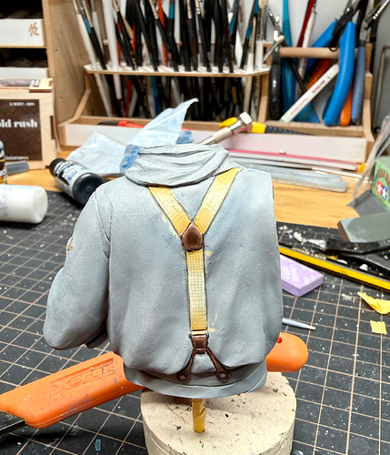

I was also working on the braces to which I added the rough hewn texture by painting it on.
A couple of small bits then, the pistol and holster plus the red hat band.
Then the trousers, gun belt and scarf.
