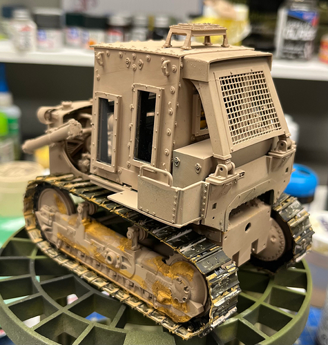

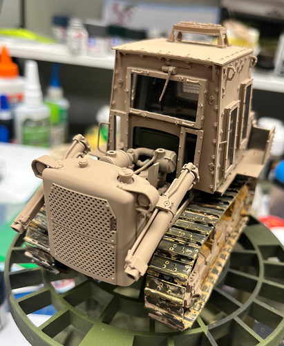

Not only the wrong fuel tank, but the wrong cab floor went into my first attempt. All corrected and the cab is a dry-fit for now
RTFI Den………..

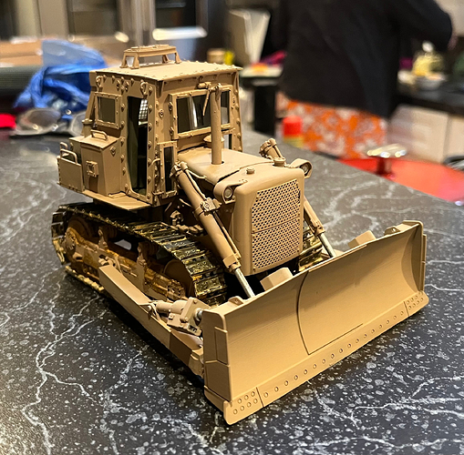

The tractor becomes a bulldozer. The “lip” on the front edge of the engine compartment hood is part ot the panel’s design.

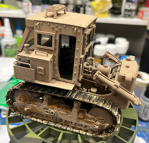

Another step closer.
Lookin’ good!
One thing - that “lip” you’re writing about looks like it’s cracked in your model - I would like to encourege you to fix it. In my experience if you superglue a piece of styrene in that crack, then you can later sand it smooth and after repaint the repair is invisible.
Have a nice day!
Paweł
Hi Pawel, thanks for the input. I agree it looks a little “off” in that pic, but that molded shape of the front edge of the engine compartment roof looks very deliberate once you see it close-up.
It seems to be an additional air intake when seen from the front. Anyway I’ve written to Khang at HL questioning this aspect of the kit piece, and I’ll leave it “as is” until I hear from him.
Thanks again.
Den
Hello!
In my kit it was constant width:
I don’t see a point in other variants for a difference here - but of course I can’t be sure. Let’s see what Khoang says.
Have a nice day!
Paweł
Yep, that front lip is a whole different shape to mine. That said, your cab layout looks different too and the lights in front of the dashboard arent there on mine. Your air cleaner intake is in a different position too. Given yours is a Vietnam-era track, I’m guessing it would be a D7F. The G model (mine e.g.) was introduced in ‘74, pretty much after the Vietnam war era There are probably quite a few other differences between the F and G I’d imagine
Intrigued anyway and looking forward to Khang’s response.

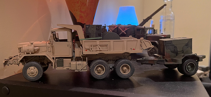

Thanks, didn’t know that they discontinued them. I got one early, before the AFV Club kit came out, and also the Real Model one, altho I haven’t compared them. If you have a project in mind let me know and we might work something out, as I will probably never get them all built. Wayne
Hey Wayne,
Did this last year. Could see another dump on the horizon, provided it’s the HL set!. Maybe an M54 based rig.
