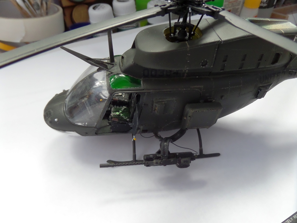

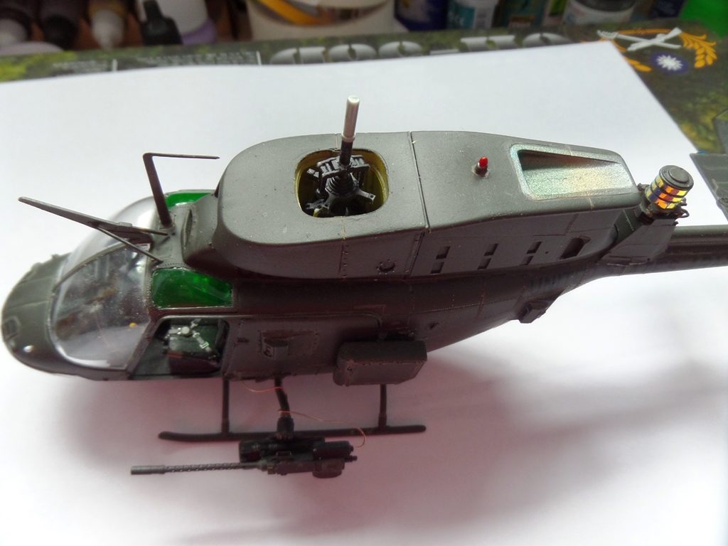

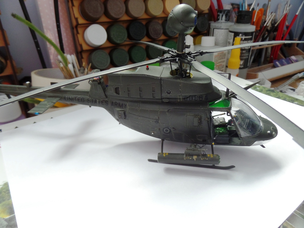

As Robin said it is on the inside or all the way through. On my Kiowa Warrior I used Tamiya X25 sprayed through an airbrush on the inside of the canopy, this then leaves the outside to stay shiny as in the real thing. I cleaned the canopy well beforehand in case there was any residue on it and then built up light coats.
