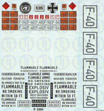

For flammable decals, there is a set by TL Modellbau that includes the “Flammable No Smoking…” markings in white, as well as black.
I used them on my M49A2 rebuild a few years ago. They were very nice.
As to the operationg placards, there are lots of generic placard sets available. I’m sure you could use something that looks like it goes. They are so small you can’t read them anyways. Check here at eBay for some.

Those decals look neat and I see your point about the instruction notices. Reading the thread there seems to be a couple of options for decals. I’ll explore this further.
