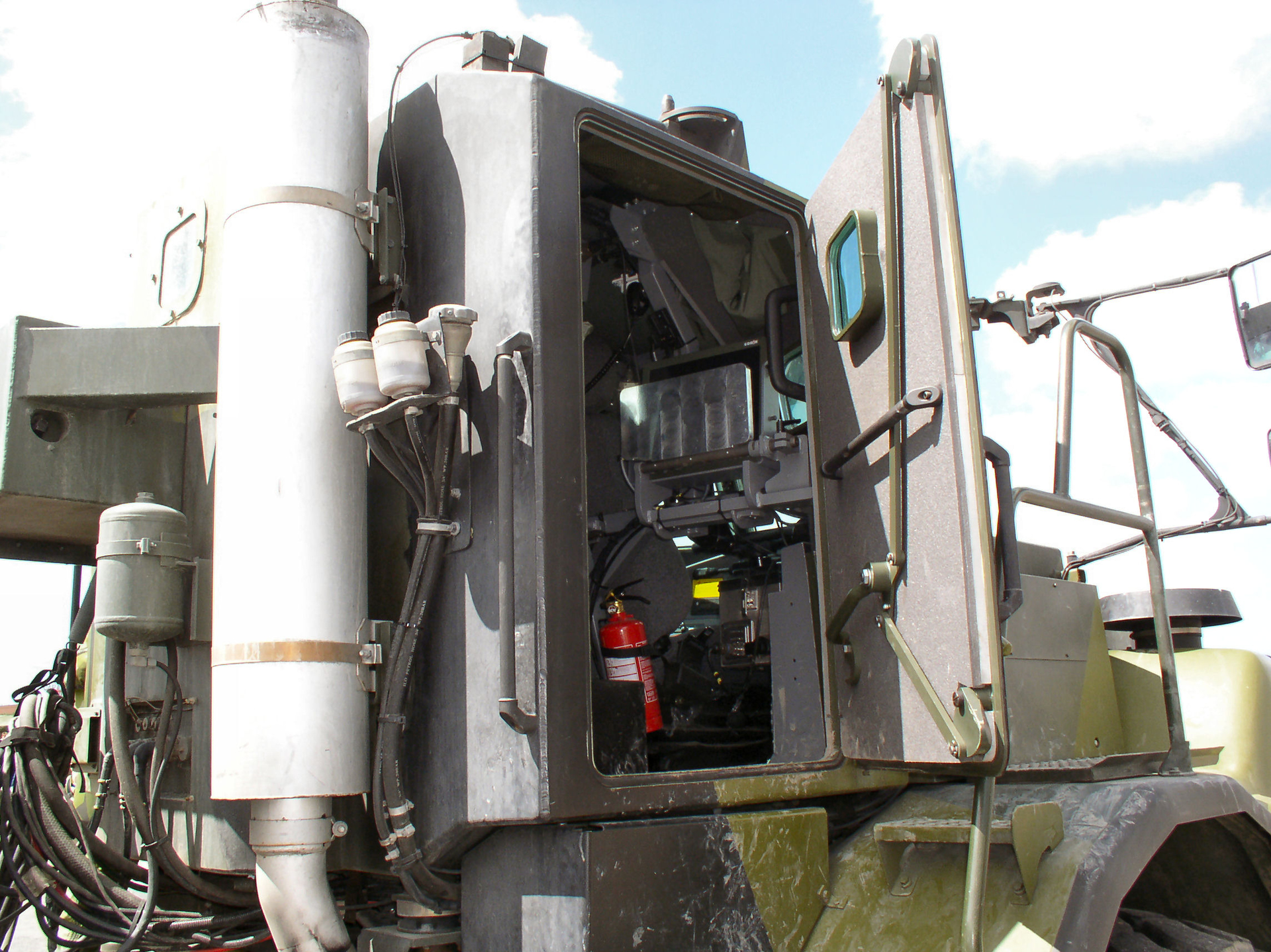

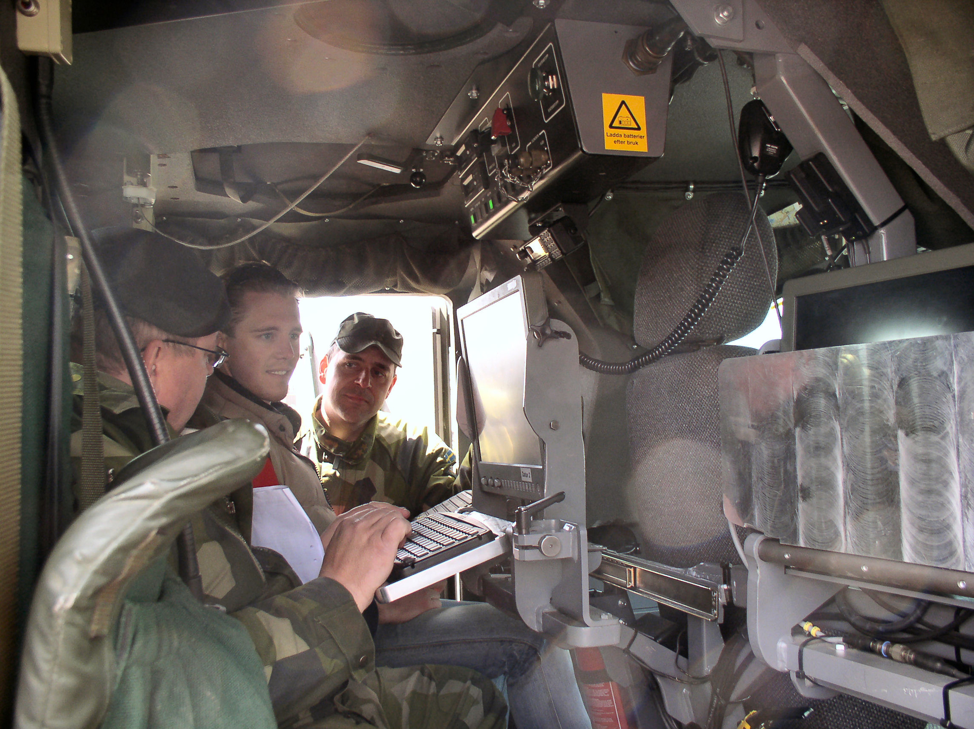

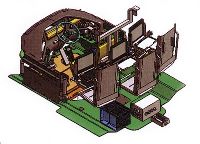

As I would like to detail some areas like the cab interior and the “neck” with e.g. some hydraulic hoses etc. I am looking for detailed pictures so I was hoping someone here on the forum can help ?

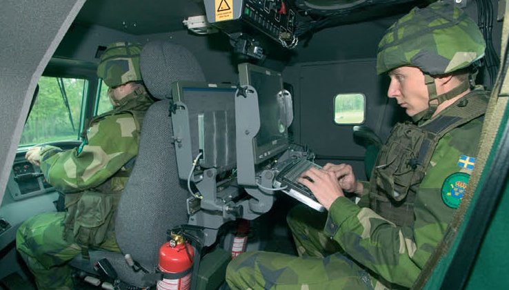

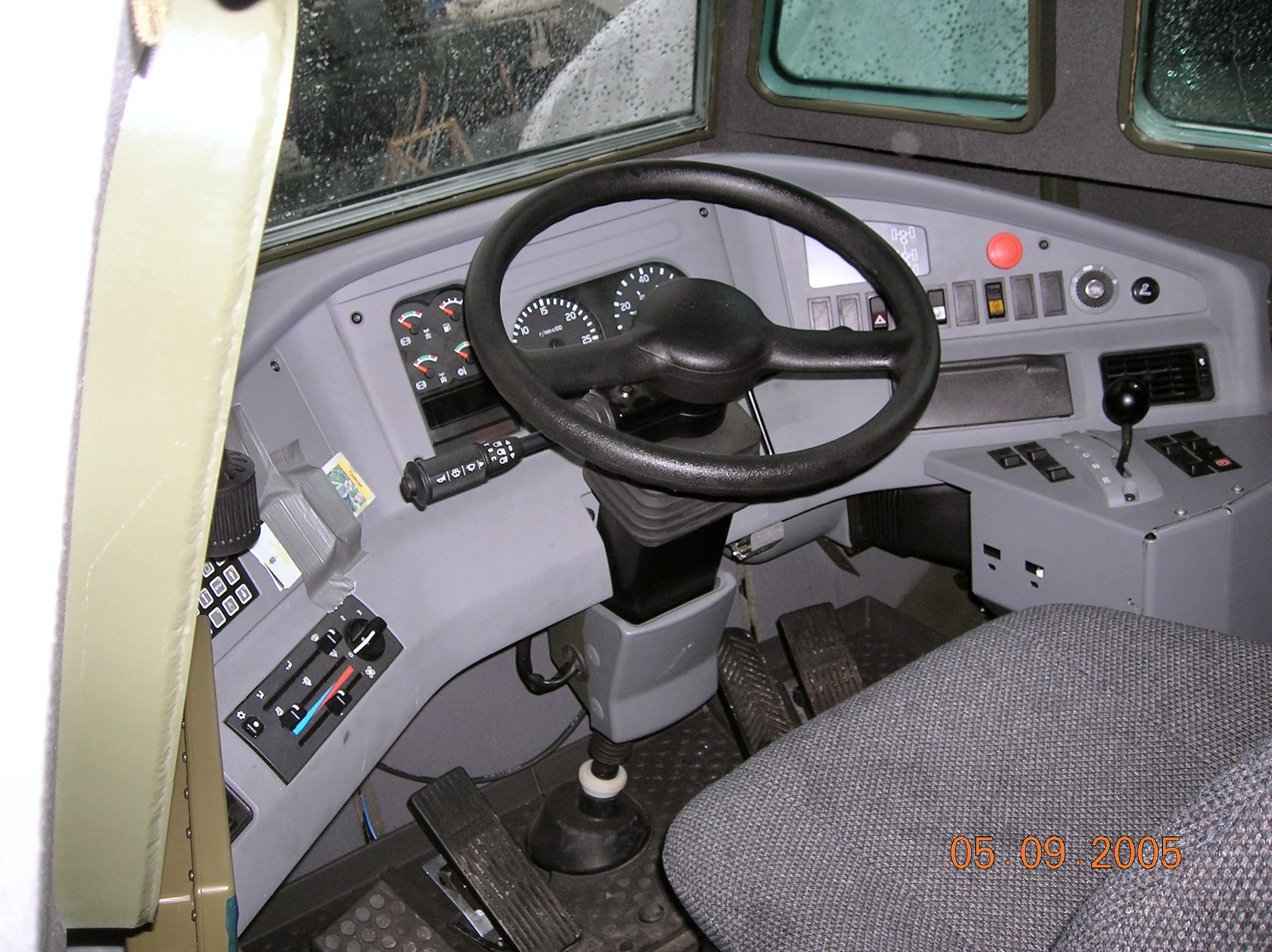

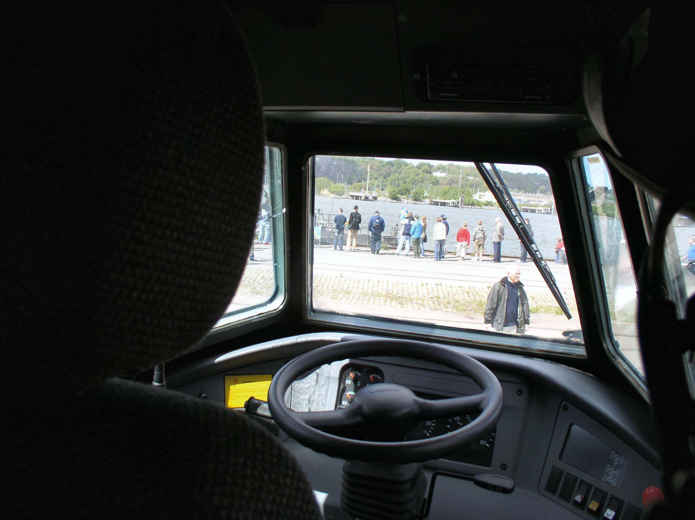

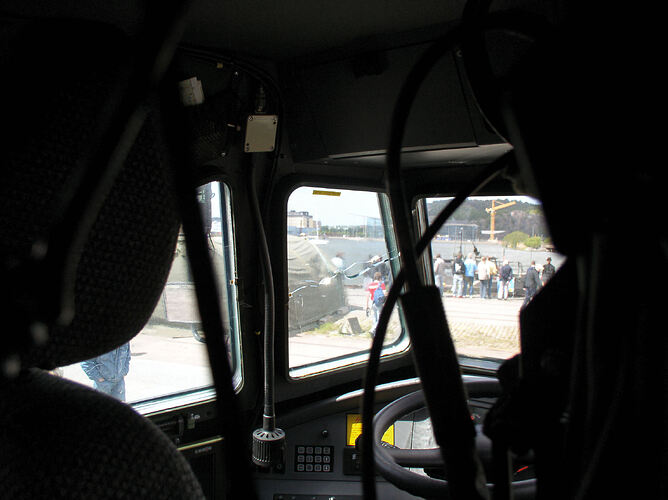

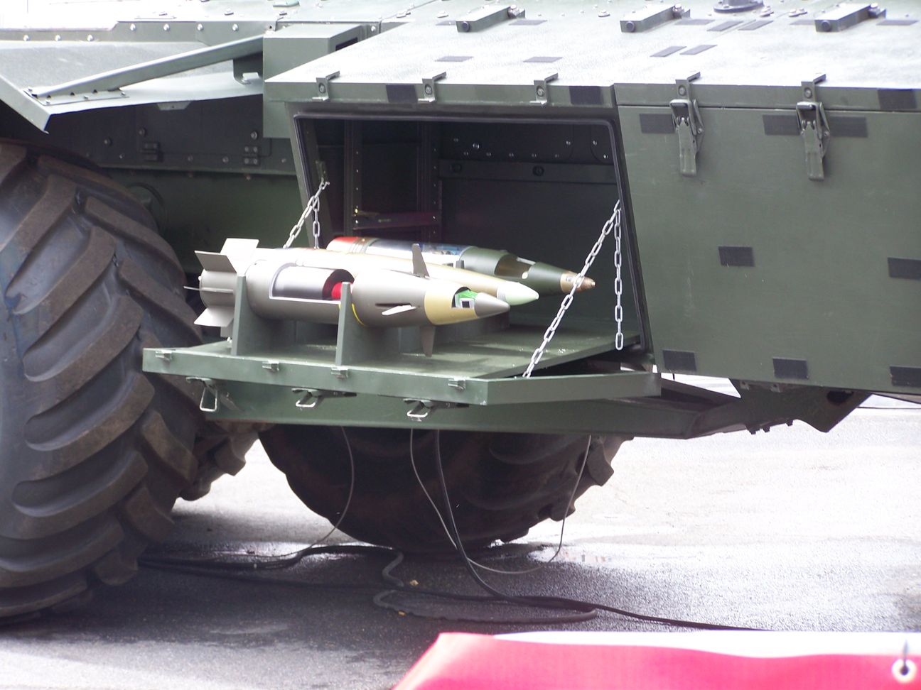

Not much on my HD. Some of the images are from early production vehicles.
Thanks for the input guys.
Also the pictures are very interesting. I didn’t know that the boxes on the sides were actually used to store ammunition.

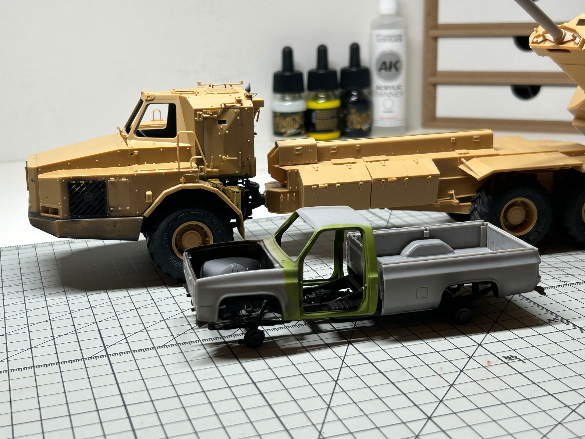

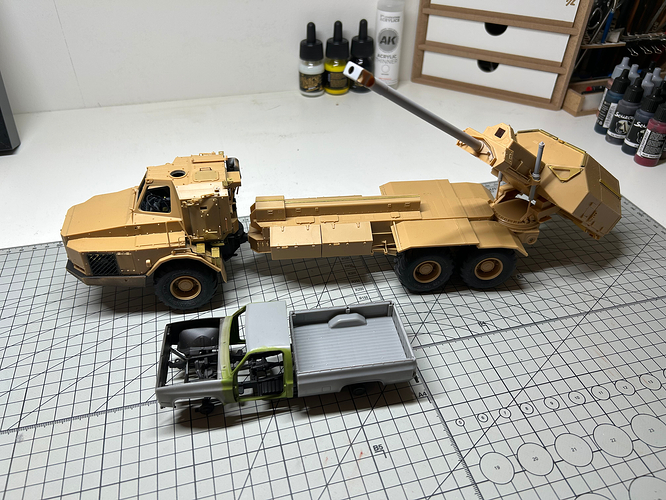

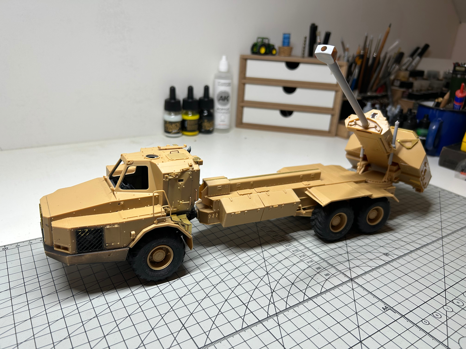

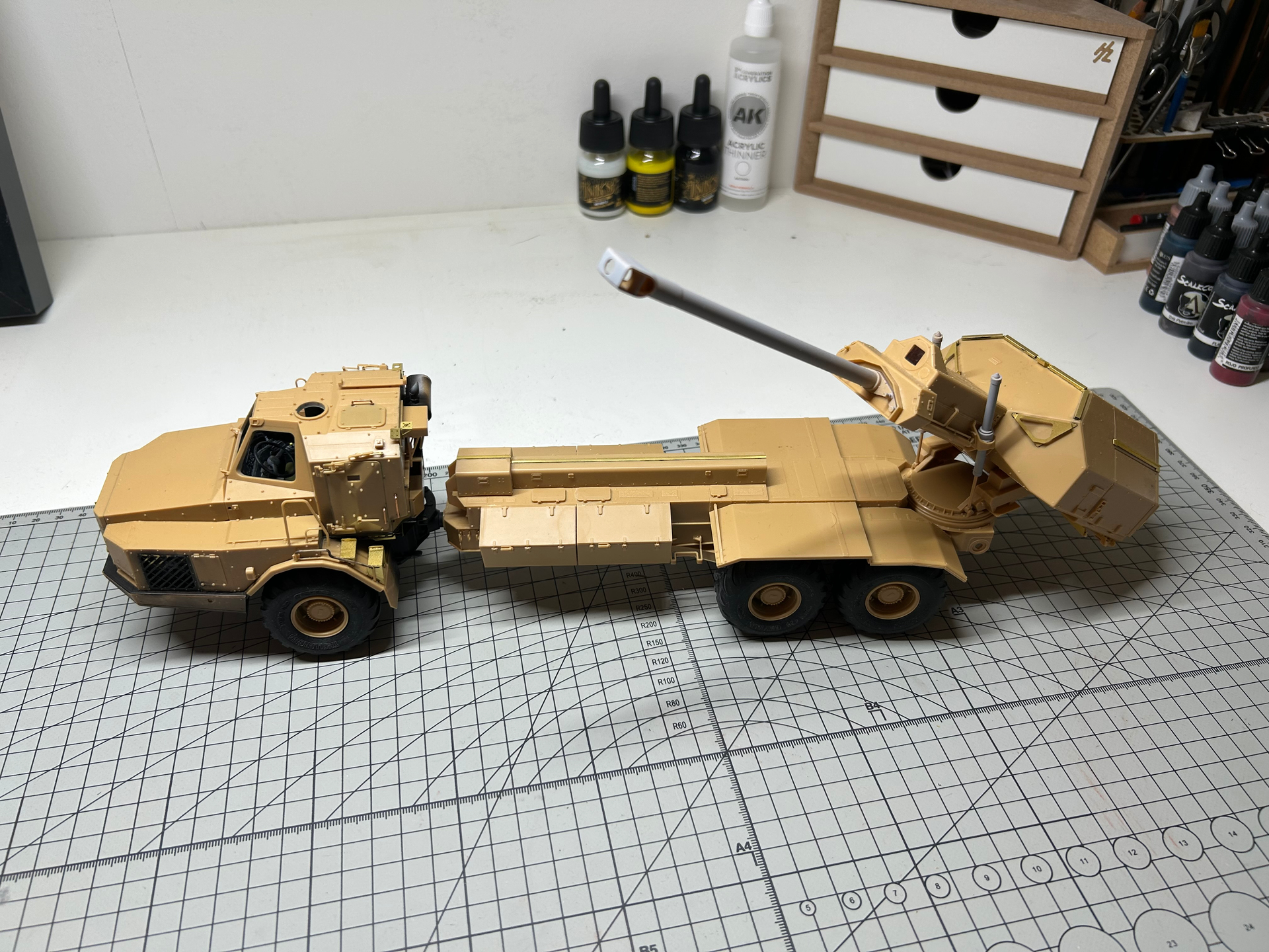

And to give you some in-progress pictures.
Oh and did I mention this thing is huge ?? :innocent:
With the M1008 next to it for size comparison :wink:
It can´t deny it´s heritage from a construction dumper. NOW I put it on my to-build-list.
