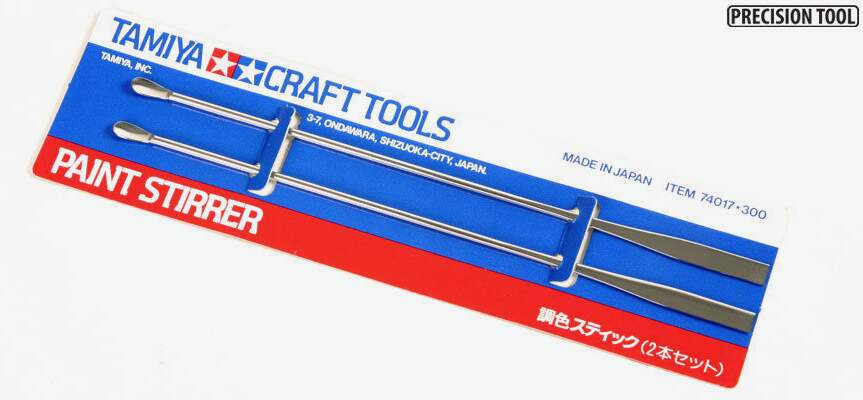

Works well in Vallejo bottles with nib removed. Also handy for mixing paint on palettes, etc.
‘Tamiya Stainless Steel Paint Stirrer (2)’
—mike …:paintbrush:
