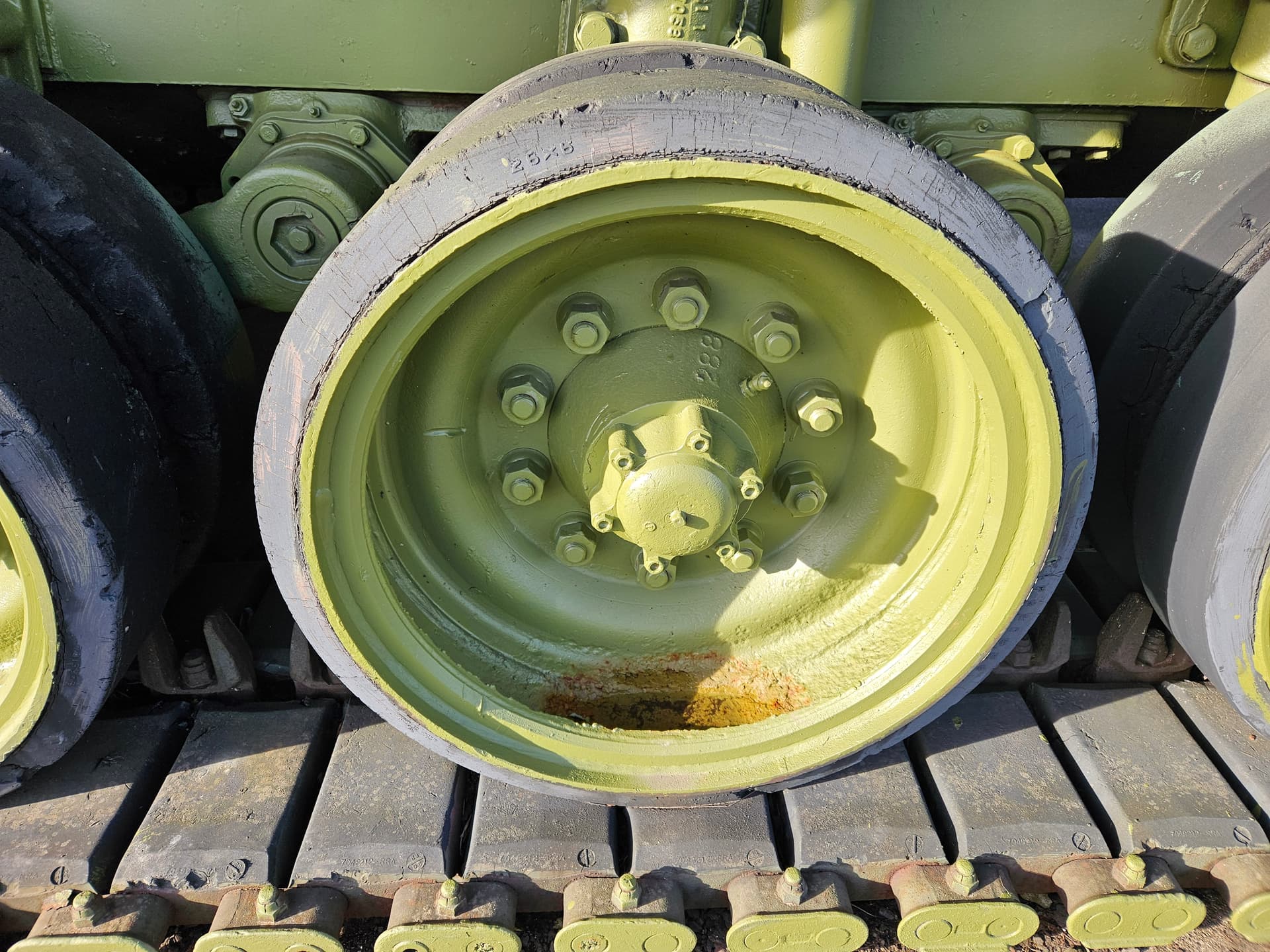

The difference is in the hub, not the wheel disks. In the 1956 SNL the section view shows a hub as on the left, but the exploded view shows a hub as on the right. They have the same part number, so as far as the engineering was concerned, they were functionally interchangeable. It appears that the one on the left has a cast or forged shape and the one on the right is simpler turned cone.

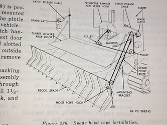

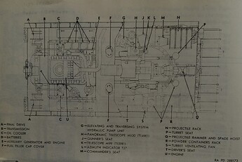

Starting with the first pic, the MG mount mentioned in the caption was not on the roof of the production vehicles, but mounted to the rotating commander’s cupola, as can be seen in the TM illustration that’s shown below this.
In the next two photos, the vents above the drive sprockets lead to the armored final drive covers. Behind the mesh screen, there are the engine and APU exhaust outlets on the right hand side only, nothing on the left (strange, but). The driver’s and, on the right, gunner’s doors had splash rails around their openings on production vehicles.
The turret rear doors had different shapes on the production vehicles, cf the TM illustration. The recoil spade not only lost two crescent braces in production, but also a part of its raising/lowering system: Just one hook with pulley on the right, no tube leading to another pulley arrangement on the left of the turret rear.

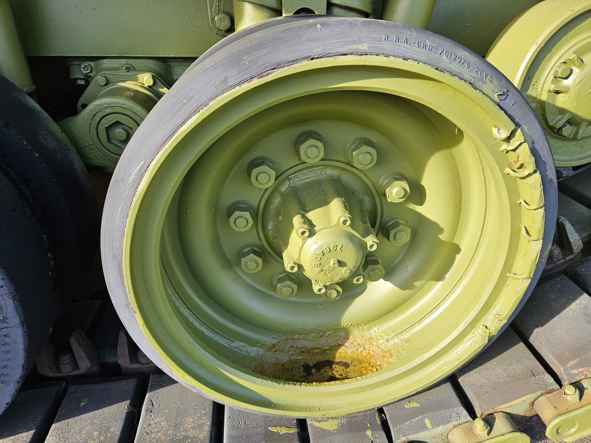

Making some progress on the M53. Here is my effort on a new barrel. I also made a new barrel sleeve as the kit part is overly simplified, to be kind. I used an RB Models German 17cm barrel as basis. I made a 60 mile road trip to visit an M55 in Maybee, Mi. That vehicle has the two different style road wheel hubs shown below. Looks like ILK intended to give the options, but forgot the hub cap on the one. It’s too bad they fumbled the ball regards the gun on this one, as the detail on the rest of the kit isn’t bad. I mean after all, it’s an artillery piece and the cannon is the main attraction.

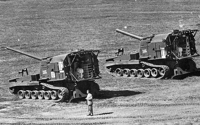

Saw two M53s this weekend.
Those two M53’s you posted identify as M55’s :wink: :grin:

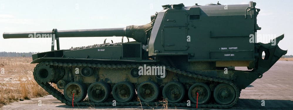

Image below shows an M53 (foreground) and an M55 (background)
Angled gun travel lock on the M55, straight on the M53.
Gun on M53 extends way forward of the travel lock at the front of the chassis
On the M55 the muzzle extends over the front by a few inches and the travel lock is angled backwards to avoid slipping off the muzzle.

To my eyes, ammunition storage inside the vehicles, gun barrels, and travel locks look different.
That as well, hard to see the ammo storage if the rear doors are closed (gate guards, open air museums et.c).

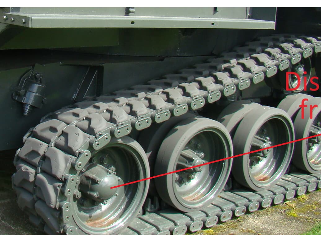

Original photo is here
The photo above should provide a reasonably “close enough” “measurement” for the visible length of the barrel by comparing with the roadwheels.
Approximately from the center of the first roadwheel to the front edge of the “hubcap” of the sixth roadwheel, red lines in the image above.
We have from Hunnicutt that the M53 has a 71" barrel overhang in the travel position. That is the number I used to estimate the barrel length. Ideally I like to work to actual numbers, but for now this will do. At least when the M55 comes out, I have some actual measurements.
