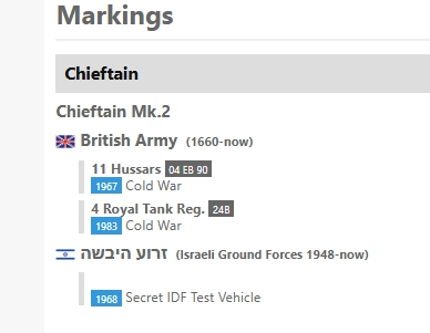

As always great to follow your builds but just a little question in between, how accurate is this one? As it says in the description “secret IDF test vehicle” ?
Can’t be too secret if Scalemates knows about it ..
The IDF actually did a long-term test on two Mk 2’s, don’t think they advertised it. There’s a story about that. There are a couple pics (see above) of them in tan with IDF numbers.
