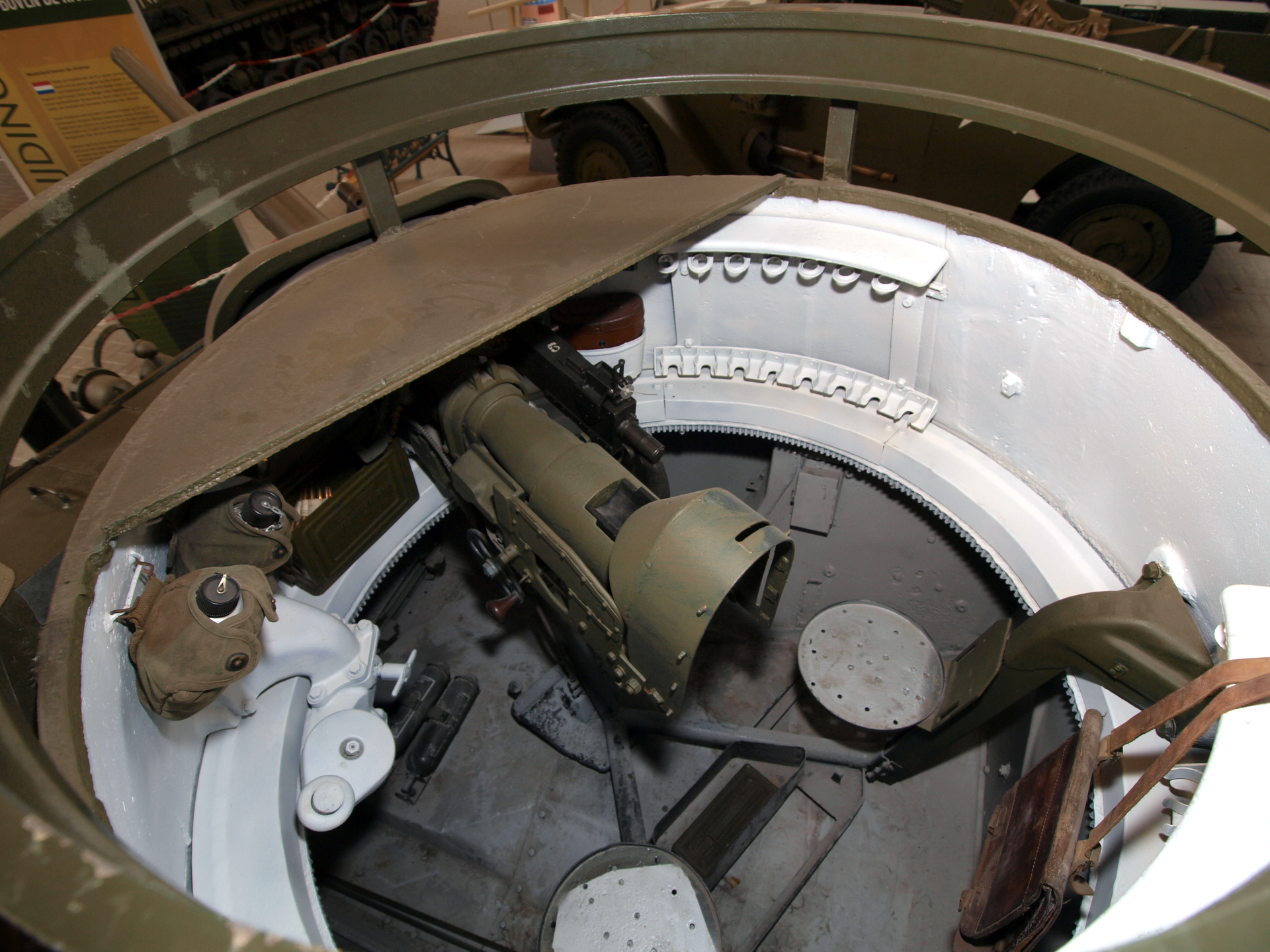

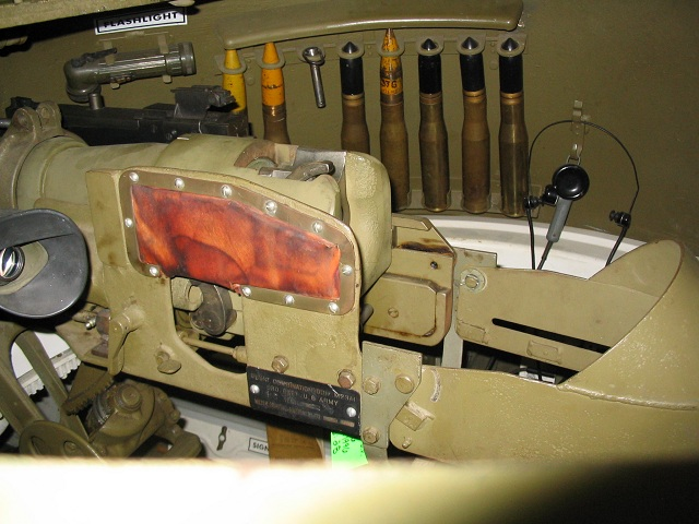

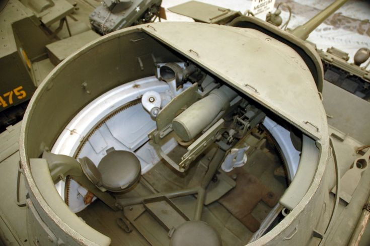

The OD in open areas such as the floor under and inside the turret was used. Areas that were/are open and could be seen were commonly OD so they don’t stand out as much. I have seen ones with the lower turret parts white still and the upper turret and floor OD as well.
A few examples.
Look down from directly above the turret. Anything you can see from directly above should be OD. The forward driver’s area under the roof should be white.
