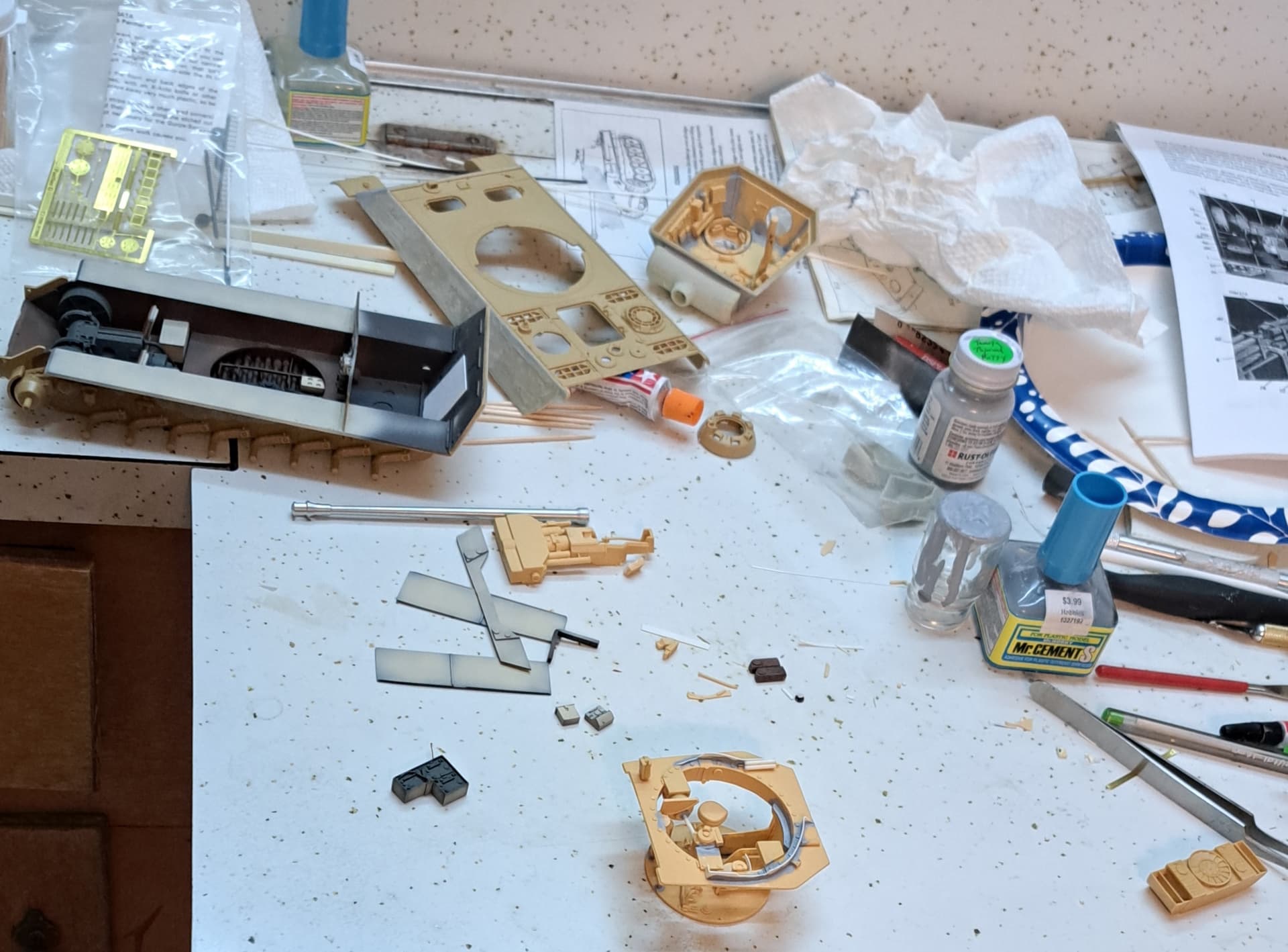

Yesterday, realized that looking at instructions pdf on phone was really slowing :snail: things down. The local library proved very helpful printing out the instruction pdf. That’s definitely helped. Checking off installed parts also helps.

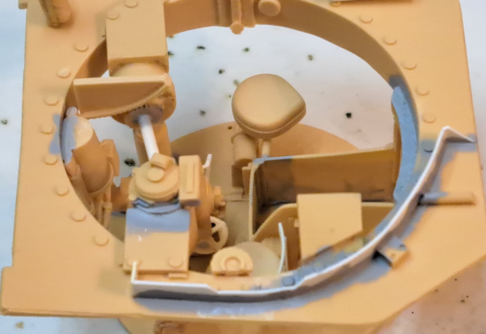

Looking at references to help with part placement, one quickly realizes nearly every part is has the wrong shape.The turret basket assembly is a heart breaker :broken_heart: :cry:. There’s a few tweaks that help slightly.
^^^ Looking from front back toward turret rear. Added white sheet styrene to roughly simulate the missing sheet metal. The MG ammo bag (left) has a holder made from scrap photo etch fret. Made a seat back for the gunner. Both gunner and loader seats are the wrong shape.

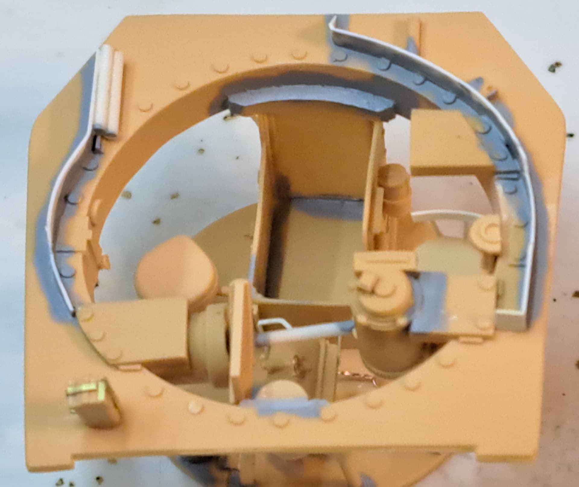

^^^ Left (gunners side) looking to the right (loaders side).

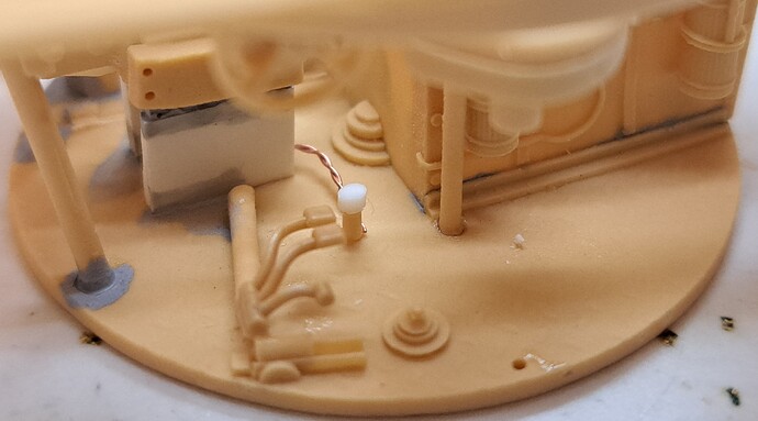

^^^ Floor on gunners side. Added pedals, back up floor trigger for main gun & wire. Raised one of mechanisms for turret traverse off of the floor with white spacer per reference.
^^^ Loader side looking towards gunner side.
Calling the turret subassemblies wrapped. Tweaks remain like adding spare track, commander’s sight, hatches & AA MG.

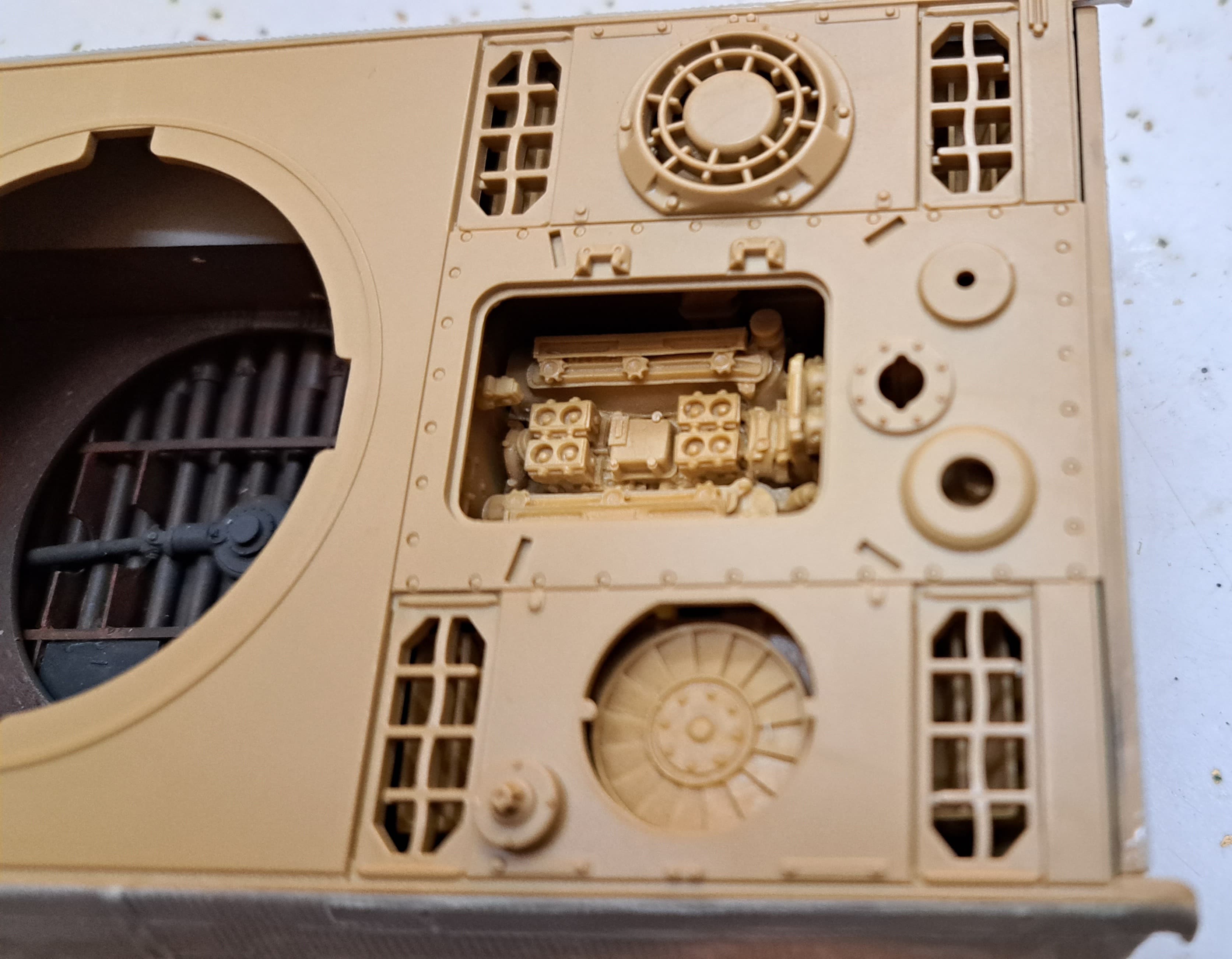

Decided to try and fit the engine box which I’d assumed would be impossible due to all the prior fit issues. It test fit fairly well. Added a platform to place the engine box at desired height.
