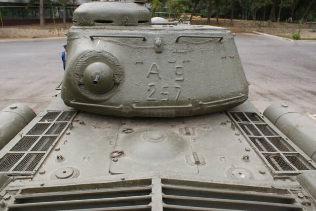

The kit includes etched numerals—their appearance and size have been accurately reproduced based on the original measurements.
All the photos show turrets cast in Mariupol—those numerals are exactly what we need.
The turret numbers should be in this order—

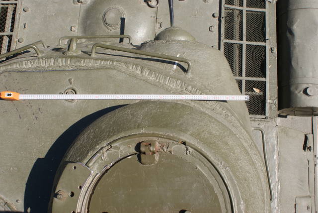

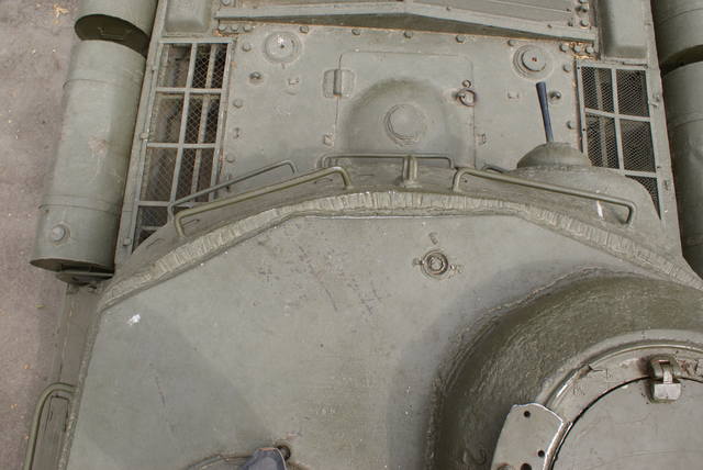

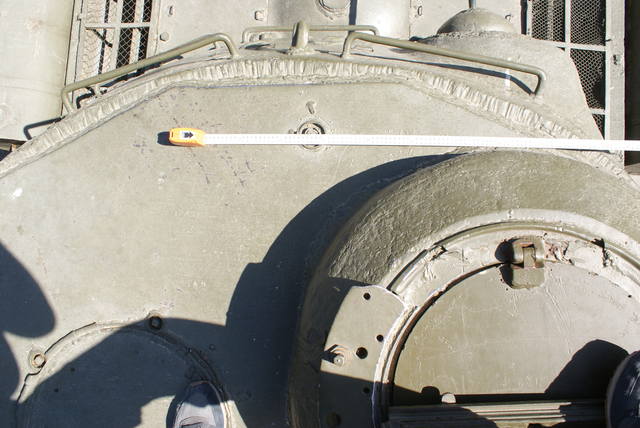

are there any good photos or blueprints showing the angled plate for the turret? hard to determine accurate angles from distant side shots…
I’m the last guy who would claim to know much about Soviet tanks, but my interest in Berlin projects, along with this thread, has reawakened my interest this tank.
I know this isn’t the drawing of the “angled plate,” but am I missing something? Is it a batter of cutting off the roof and replacing the area outlined in red?
to look like this?
Not counting the hull fixes, what elase needs to be done to the turret?
Cut the segments calmly; no one was fussing over millimetres when making this part.

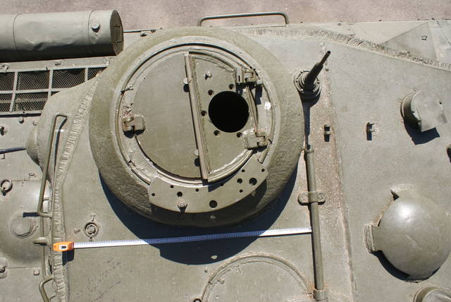

Make the commander’s cupola more oval.
The drawing dimensions of this part are 860x954 mm (tolerance up to 960 mm), but, according to my measurements, the cupola is always longer – around 980 mm.
The commander’s cupola must have a perfect circle at the top, or this circle must be welded on.

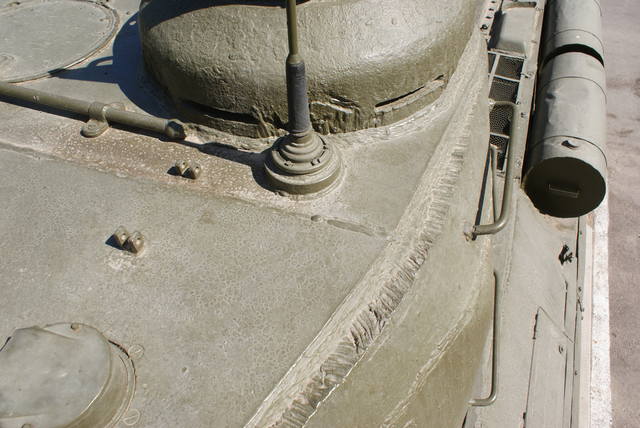

This is the support for the machine gun mount.
Tanks with the DShK must have machine gun mounts on the starboard side
and on the turret roof for securing the machine gun while moving -
Tamiya and RFM have commander’s cupolas that are not oval enough, but RFM has the correct size and placement of the vision slits.
