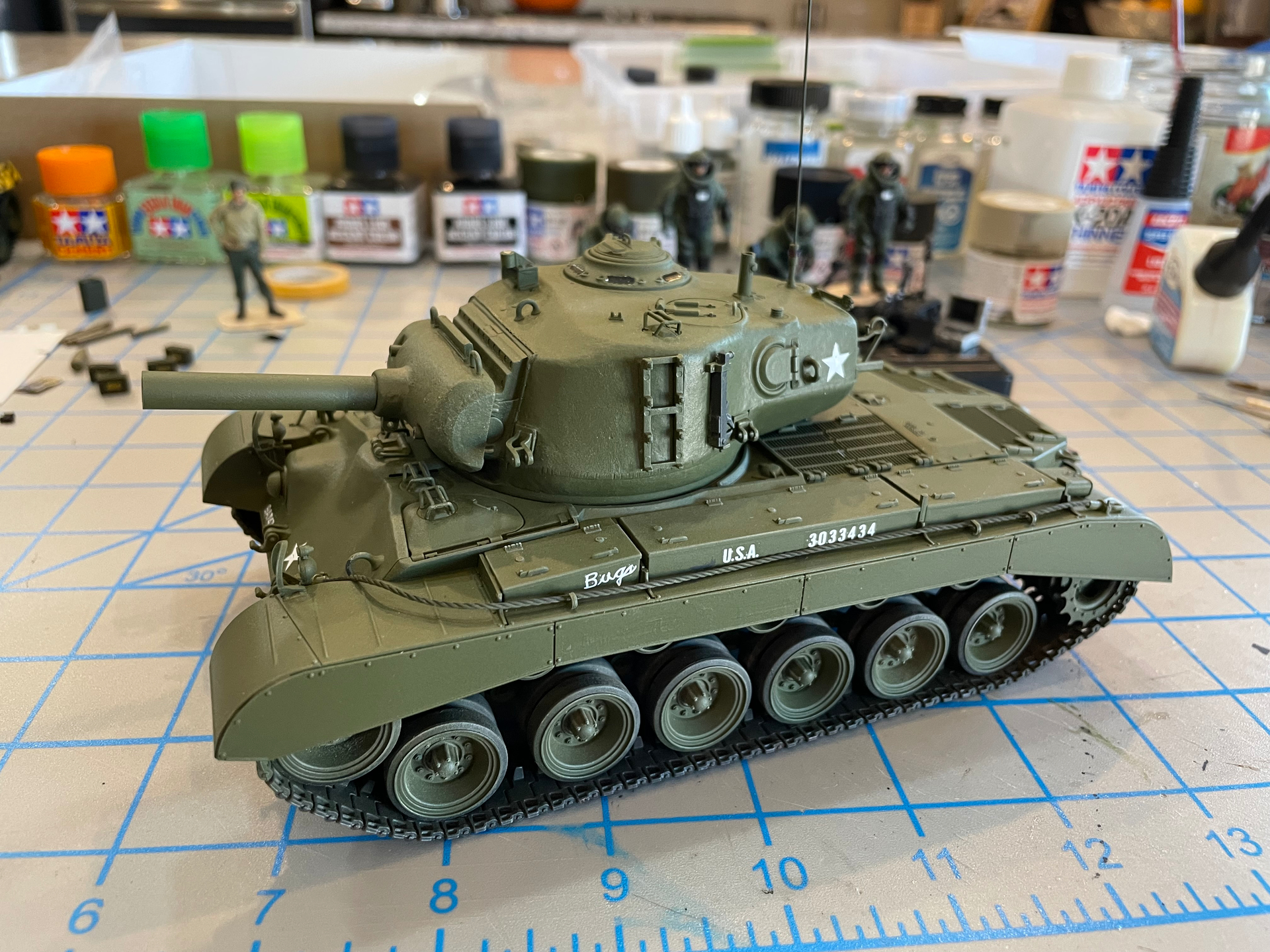

Like I did! With an old Tamiya Pershing
Tell me more about this build?
Edro

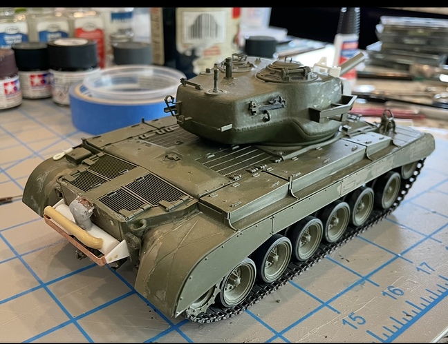

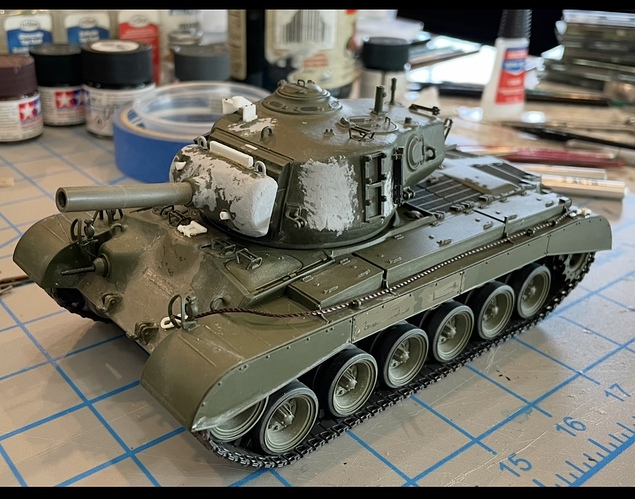

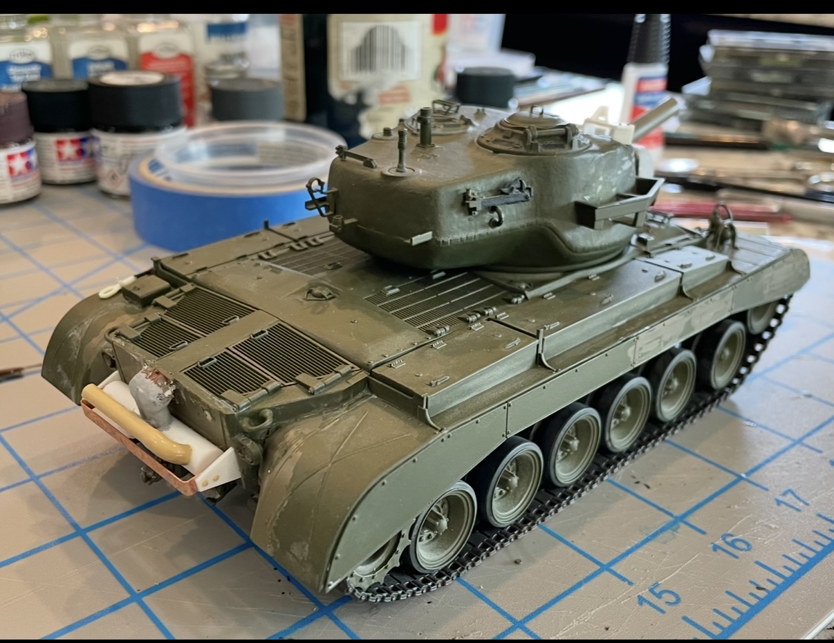

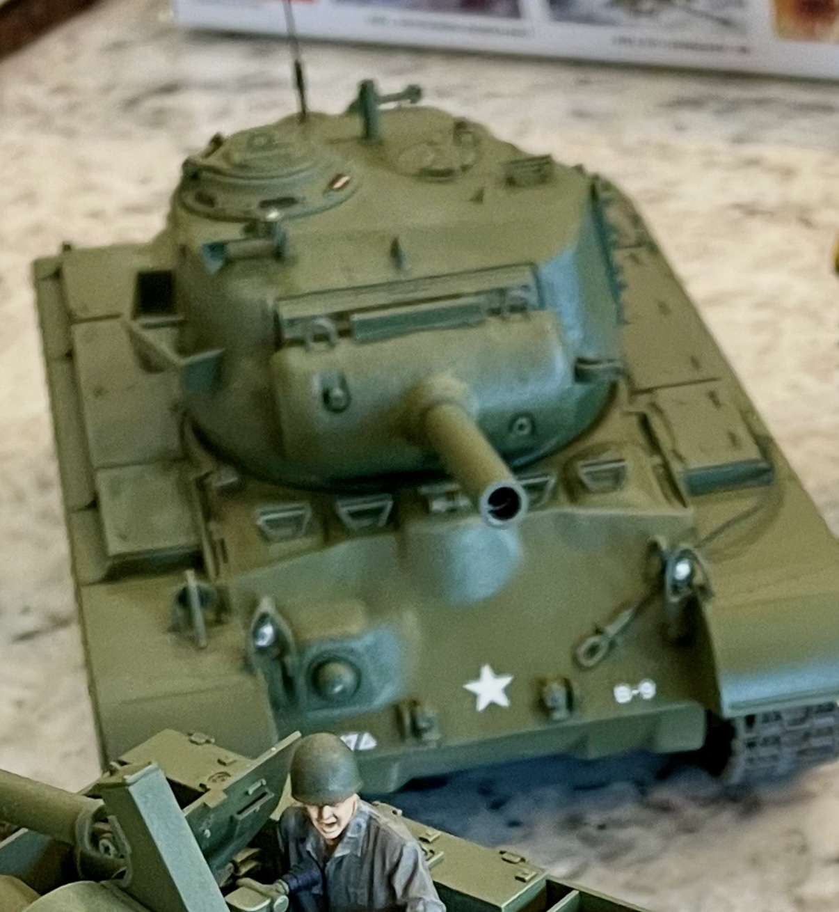

I got bored one day, and already having several M-26’s, I started modifying one into an M-45. (The very one in the top pic)
I stripped the old decals, replaced the main gun, modified the mantlet and exhaust.
Added the gun mount to the gunners site, travel lock under the mantlet, and a few other minor additions.
The tracks are wrong, and the new decals are probably not very accurate, but I’m pretty happy with it and it cost me nothing to build.
Better look at the mantlet.
