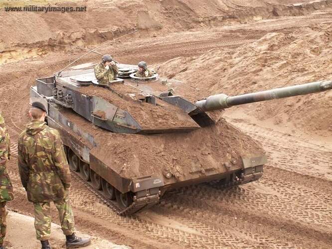

and here is someone who overdid it with the pigments
Was that last one driven through a rampart at speed? Or is it the new “mole” variant?.. :grin:
