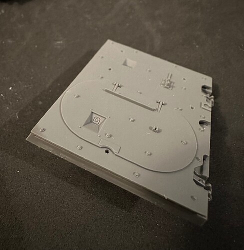

Back at it. I needed to take a break from this one for a bit. I’m replacing the metal plate on the ramp. It never sticks out far enough on kits, and on some is nothing more than a stub.
The plate can be welded on several ways - three welds on the left, four on the right; three welds on both sides, four welds on both sides…
I chose to work off a photo of a specific Linebacker. Three welds on the left, four on the right.
I used a tiny piece or armature wire to apply CA as the welds. It’ll show up better when painted.
I also used metal instead of the usual .010 x .060 as it’s closer to the correct thickness
Soooo, what the heck is that strip for?
It’s a deflector plate.
Like, a bullet splash? I’ve stared at those things so much, trying to figure out if it’s a bullet splash, anti glare for the tail lights, something, lol
It’s for when the hatch is open - ostensibly to prevent rounds from going inside the gap in the hinge area. Never the gaping hole created by the open hatch,

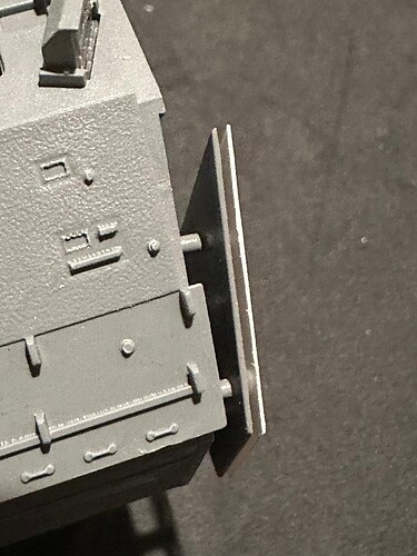

I;ve fixed most of the kit issues. Working on some additions. Right now I have to scratchbuild a Talon to lash to the side of it.
Three fixes in one. The rear plates are now angled correctly, not parallel as they come in the kit. They’s been thinned to proper thickness and doubled up as well. A quick swipe with liquid cement will remove the fuzz from the white styrere.
